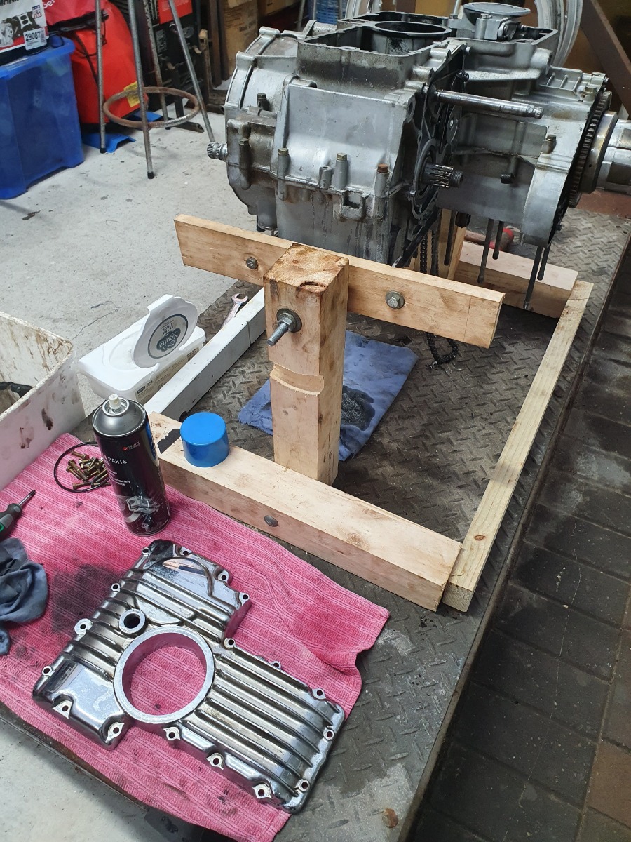

I had a bit of an experiment with the Acme engine stand, didnt quite work out so I went back to the old setup with some extra spacing to spin the engine around 360 degrees.
Got the engine upside down and got the sump off, and found all those little bits of missing cam chain wheel !

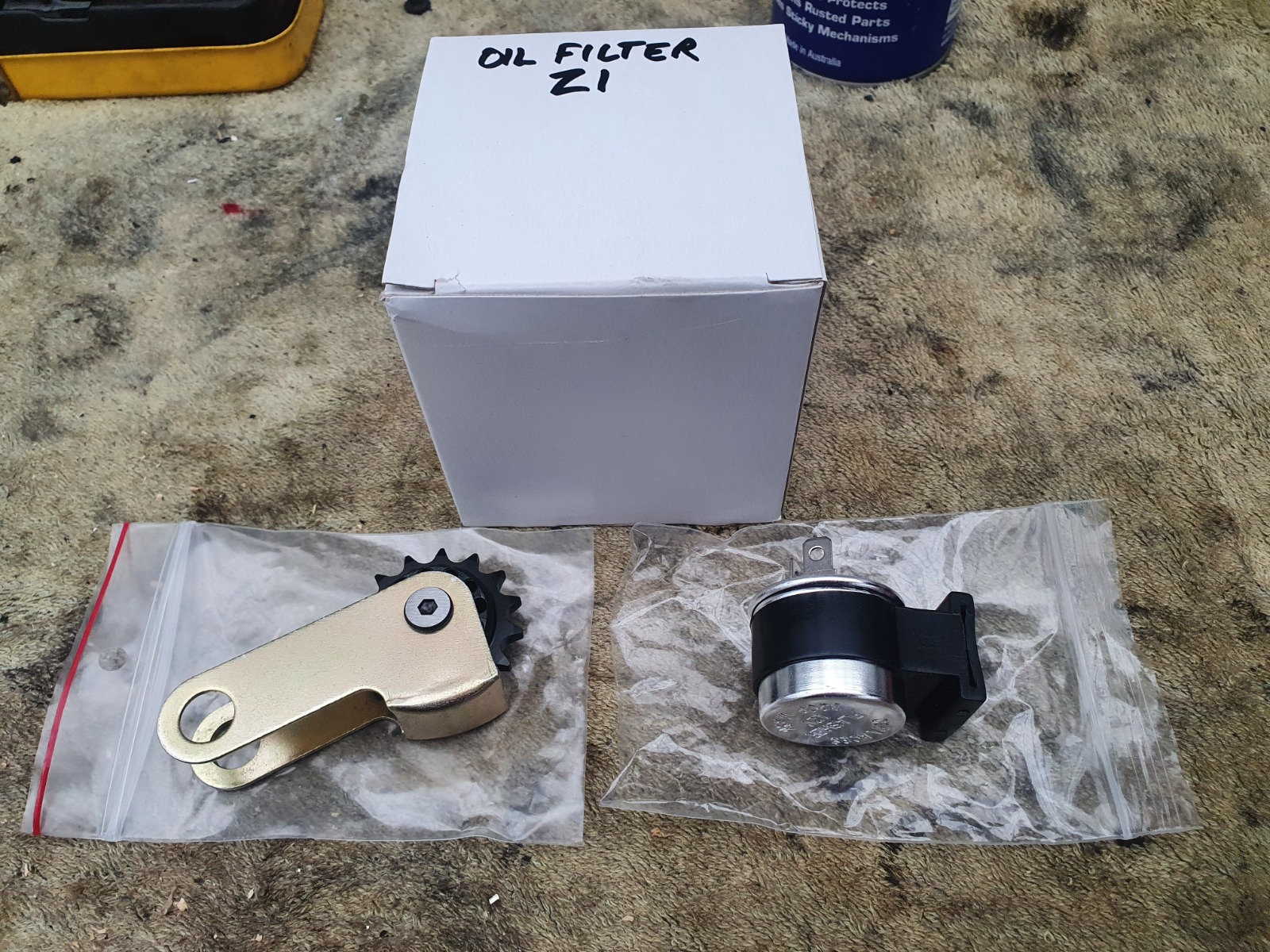

Been busy with the thinners and brake cleaner on the short motor cleaning things up in preparation for the paint.
Found some VHT heatproof black satin after numerous attempts, so I bought 3 cans.
Got some more bits, a Liska camchain tensioner that has a steel wheel (instead of the plastic one that ends up in the oil sump), oil filter and a flasher can for the indicators.

I had the same trouble trying to get VHT paint in Brisbane, Finally got some recently, after more than a year !!

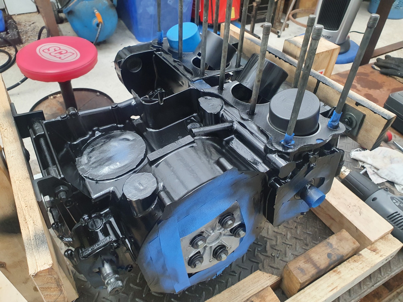

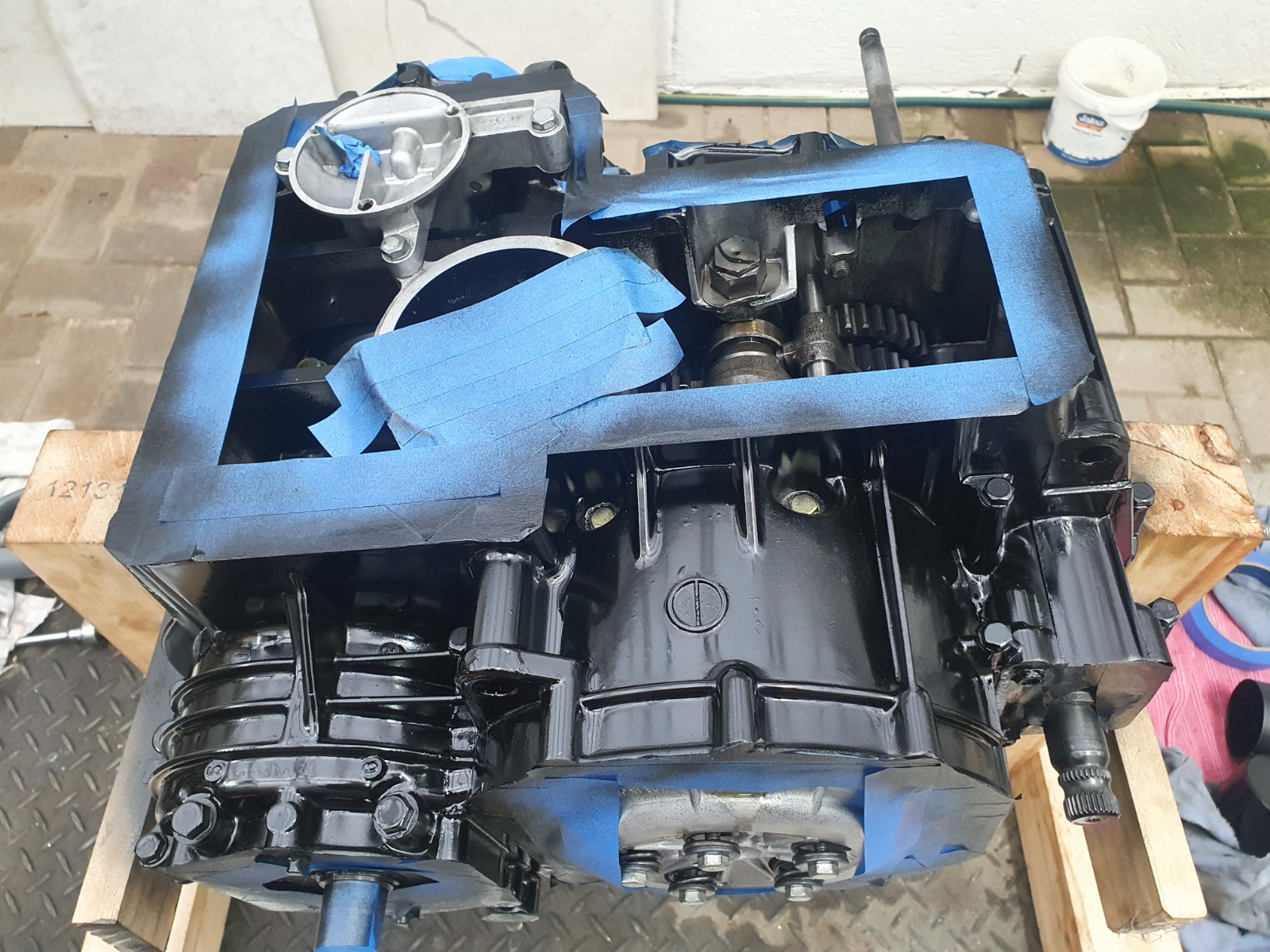

Cleaning the engine and masking up is quite time consuming but its done now.
The short motor is painted with 2 coats of VHT black satin.
Had to crack out the heater and heat gun to keep things warm coz its winter here in Australia !

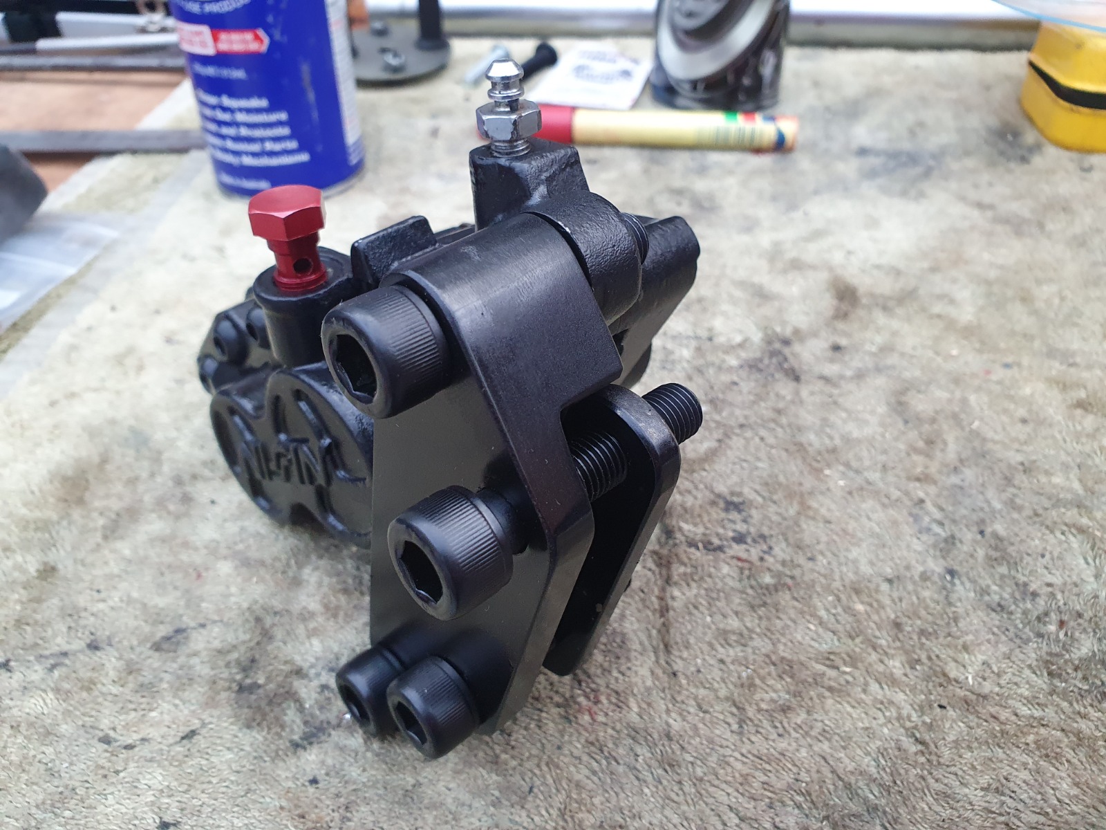

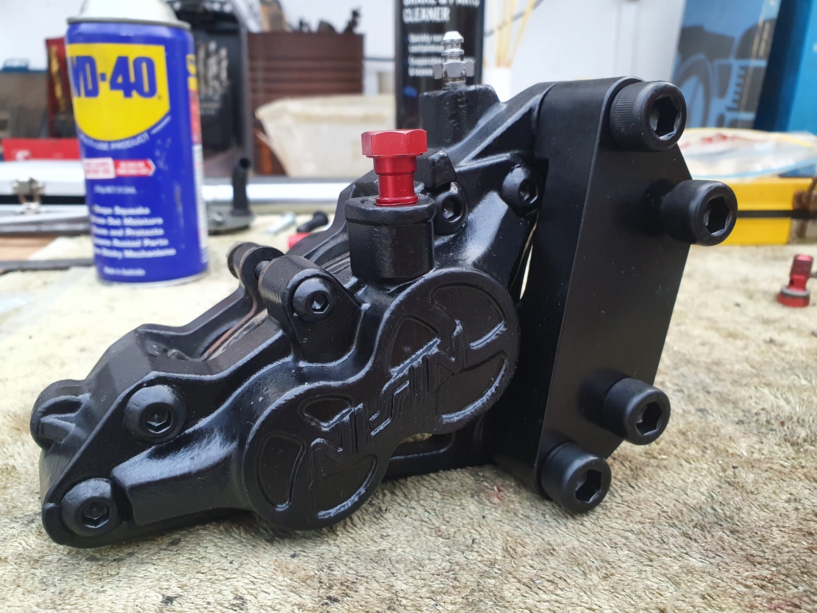

while I was painting the engine, I decided that it I might as well do the front caliper while I was in the painting mood. Out of sync I know !
This setup is a 4 piston Nissin caliper (Suzuki I think ?) with custom made adaptor plates to fit the original fork tube and a custom made disc rotor.
It was all stripped down and pistons, seals cleaned up. Originally it was natural alloy with gold zinc bolts and hard anodized bracket.
I have painted everything in satin black and used new mushroom head and cap head bolts in black to suit, to give it a different look.
Checked the operation of the caliper with the EBC pads in place and using compressed air.

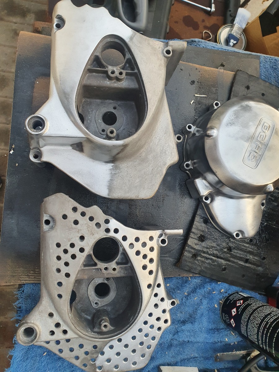

The de chroming is finally done, some of the stuff is staying for re chroming, some of the stuff has been dropped off at the vapour blaster (pressure glass bead/water) and the rest comes home.
Then to separate the remaining into stuff to be powder coated and go with the frame and whats left is the alloy pieces (mainly all the engine covers) to be hand polished. After cleaning the drum brake cover it still has chrome on parts so will need to go back.
The de chroming process leaves a black/grey residue on the parts which needs to be buffed off. Below is a pic with the 2 sprocket housings half buffed, which needs to be done before they can be wet/dry polished and then hand polished.
You can see the dynamo cover in the background that has been buffed out. I already have another polished one with the DOHC background in black paint, both are 73 stamped pieces so I will decide later which one to use.
