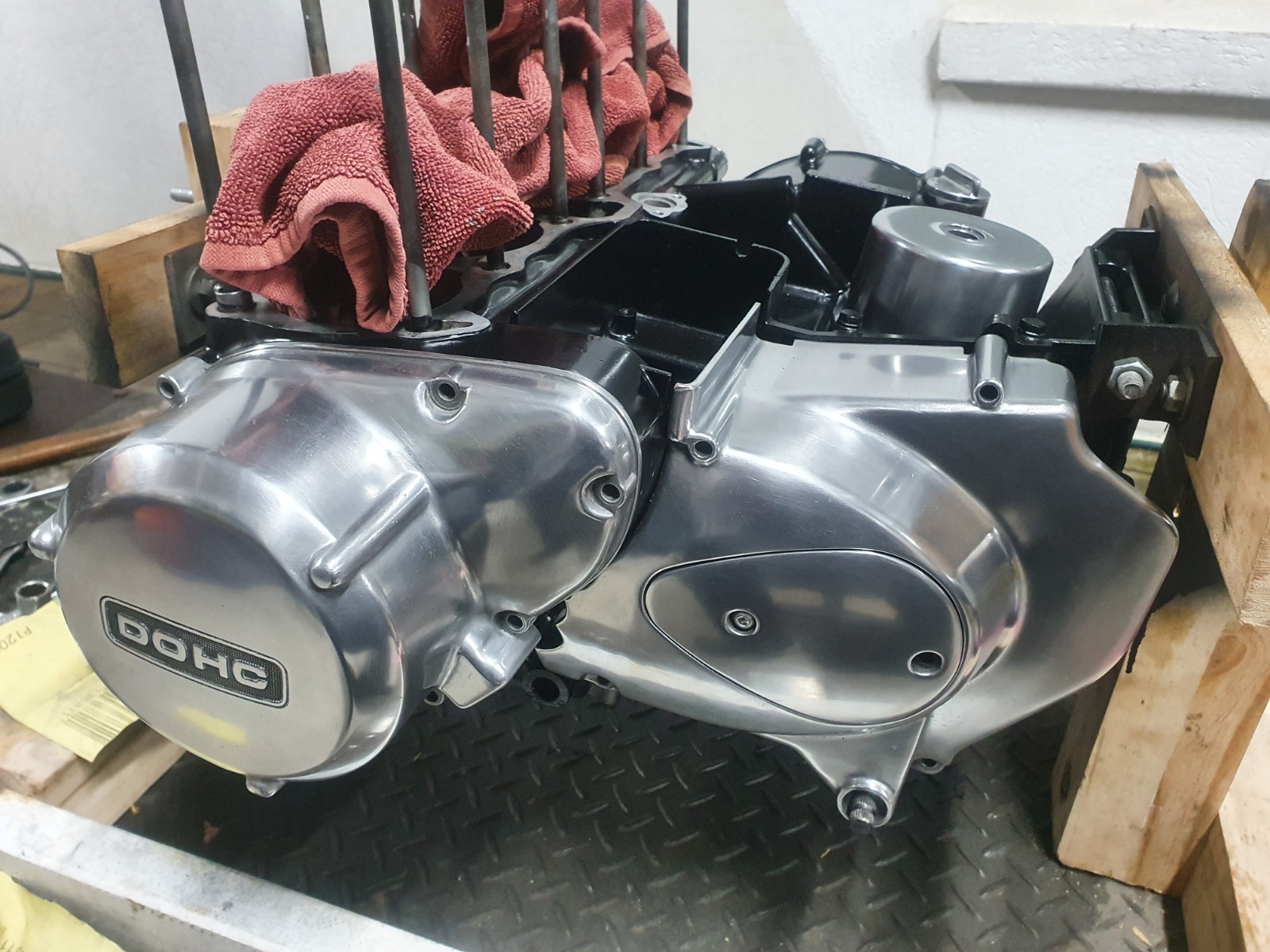

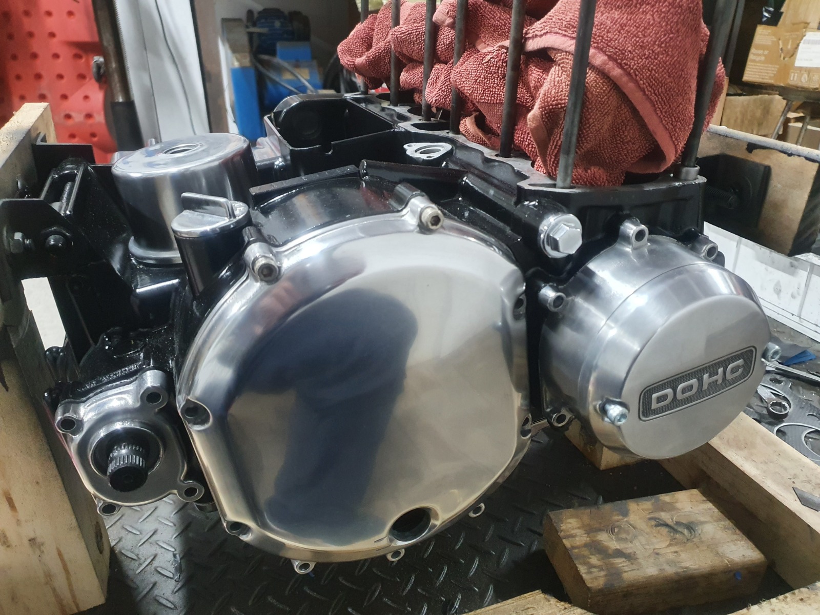

You did a great job on the black paint in the DOHC sections. How did you paint them?
- blackozvet
- Posts: 193
- Thanks: 79
Re: 1973 Z1 rebuild
31 Jul 2022 04:12well I have to admit I didnt paint them, they are actually the original dynamo and ignition covers !You did a great job on the black paint in the DOHC sections. How did you paint them?
I took them off years ago and put chromed aftermarket covers on the engine, and by some incredible fluke I actually wrapped the original covers up and packed them into a box with other bits and pieces. More good luck than good management really !
The covers had some scratches from the bike being dropped, so I started with 80 grit paper to get the scratches out and worked up to 1200, being careful not to hit the black DOHC's .

The bike looks great! Thanks for taking the time to share your project and post up lots of photos!
For what it's worth, when it comes to polishing engine cases, I've found that using a DA sander with 220 grit sandpaper does pretty good to remove deep corrosion pitting. For the nooks and crannies, a dremel with stainless steel brushes works well. Next, a coarse sisal wheel with black cutting compound is used on a buffing motor. I use a car polisher motor. Use heavy gloves because the case will get HOT. The combo of sisal w/black compound will shine up the case very nicely, but the finish will be very close to OEM, not mirror bright. For that, you need to move to a fluffy wheel with fine grit polish of some sort. I came up with this method because I'm lazy. Polishing by hand is way too much work for me. The method highlighted will allow you to clean up a full set of cases in just a few hours of work.

01 Aug 2022 05:31Those covers look great! Good job of matching the OEM finish.

01 Aug 2022 10:59No wonder they look like originals!!well I have to admit I didnt paint them, they are actually the original dynamo and ignition covers !You did a great job on the black paint in the DOHC sections. How did you paint them?

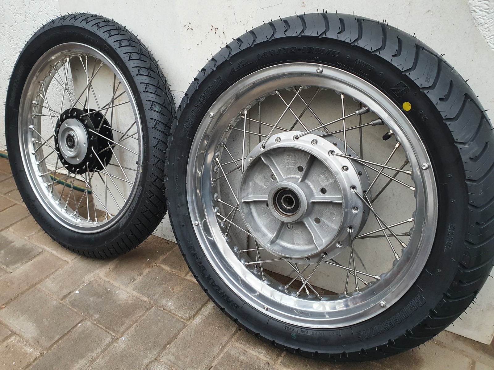

The wheels are back, having been re-spoked with stainless spokes, and fittingly the old battlax gets some Bridgestone Battlax tyres (BT46)
1973 Z1 900 Kawasaki

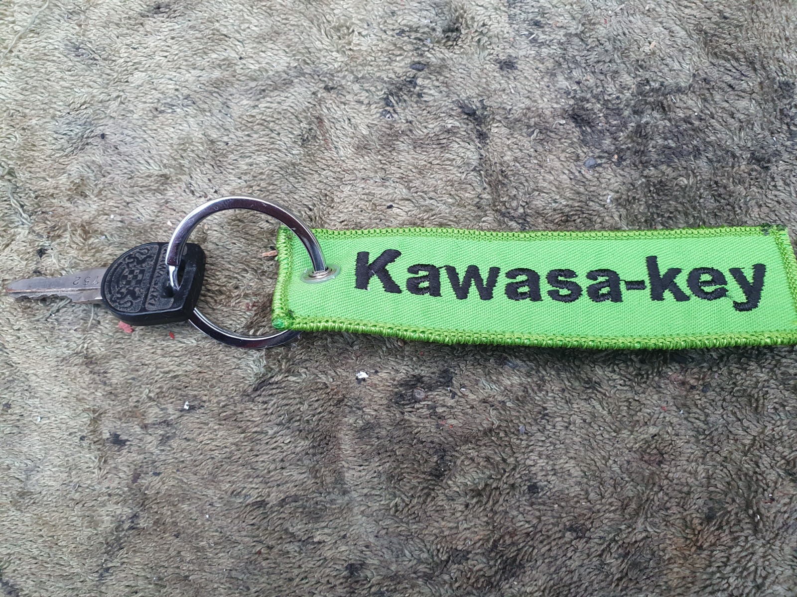

Is that rear rim a Takasago? The key flag may have come from a KLR. I had one with mine.
