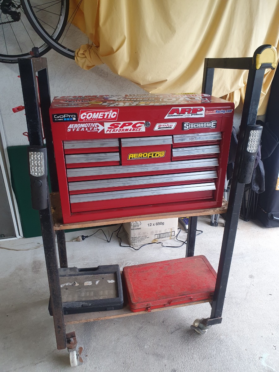

Does that little red box on the bottom shelf say "Kawasaki" on it?

22 Aug 2022 17:05its an "ETC Industrial" socket set.Does that little red box on the bottom shelf say "Kawasaki" on it?

Ahh....OK. I thought you might be the proud owner of a set of Kawasaki special tools.

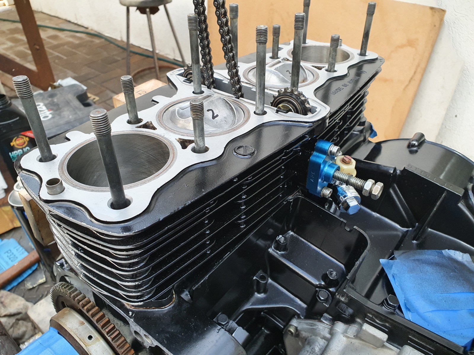

I had a mate of mine who is a recently retired Engineer give me a hand with some engine stuff.
Now normally retired engineers arent much use and you usually just have to throw them away, but I have found a use for them and helped the planet by recycling !
We cleaned up the barrel, pistons and surfaces and fitted it all up along with the camchain wheels and tensioner etc.

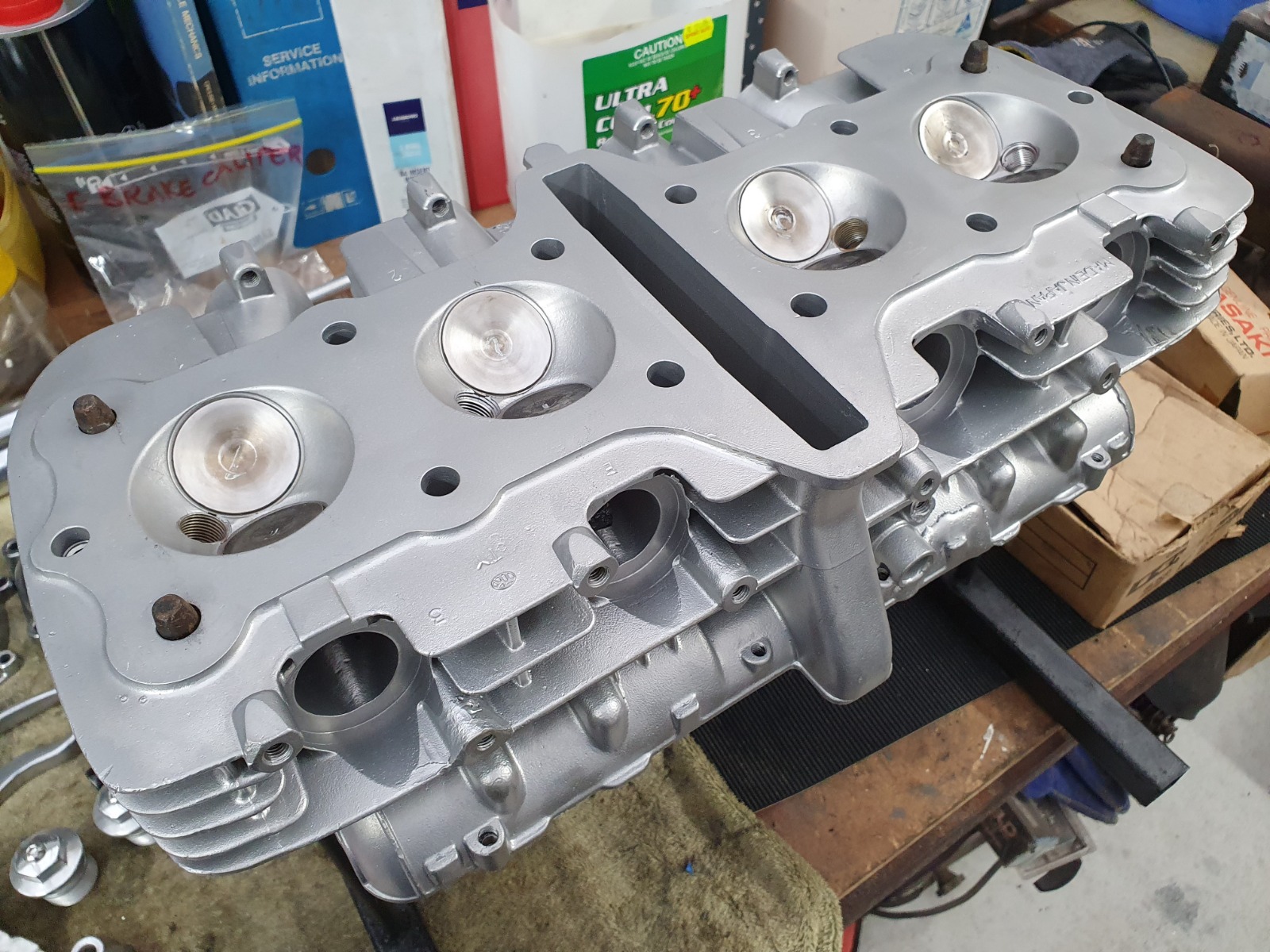

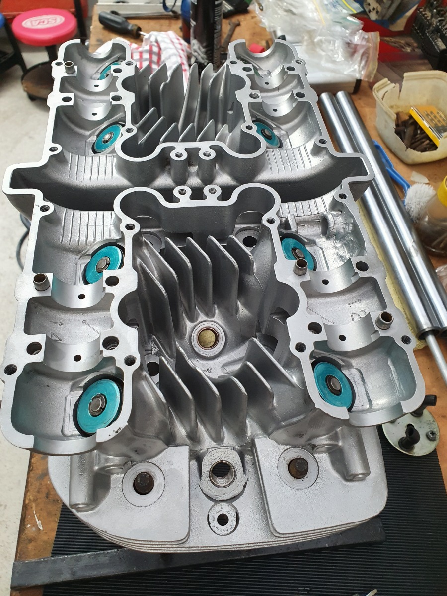

The head was cleaned up, all galleries, holes and threads cleaned out.
New plug helicoil inserted.
The Ferrea stainless valves, APE valve springs and titanium retainers and new stem seals fitted.

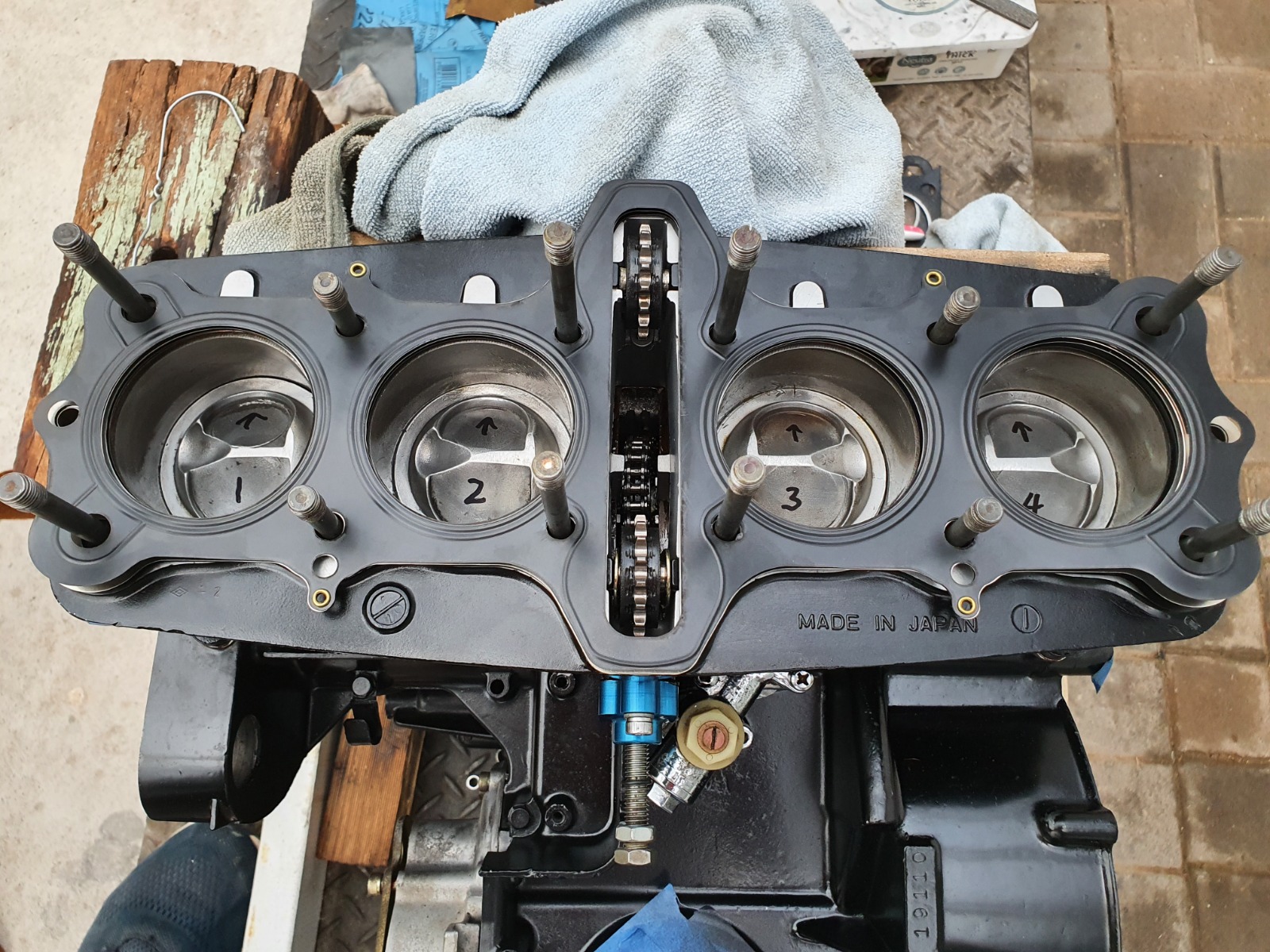

Sleeves O ringed as well, you using a copper head gasket ?

24 Aug 2022 19:33I'm using a Cometic MLS head gasket. It has embossing on it and the steel sleeve O rings just happen to fit inside the cylinder embossing, not sure if it was good luck or good management !Sleeves O ringed as well, you using a copper head gasket ?
Good progress, bloody fast actually ! I'm lucky enough to have an mechanical engineer help with my engine, even better is that he specialises in motorcycle engines .....
I have never had any luck any with copper head gaskets, they always seem to leak. I found 2 used sets of them in my gasket collection recently and promptly threw them in the bin.
