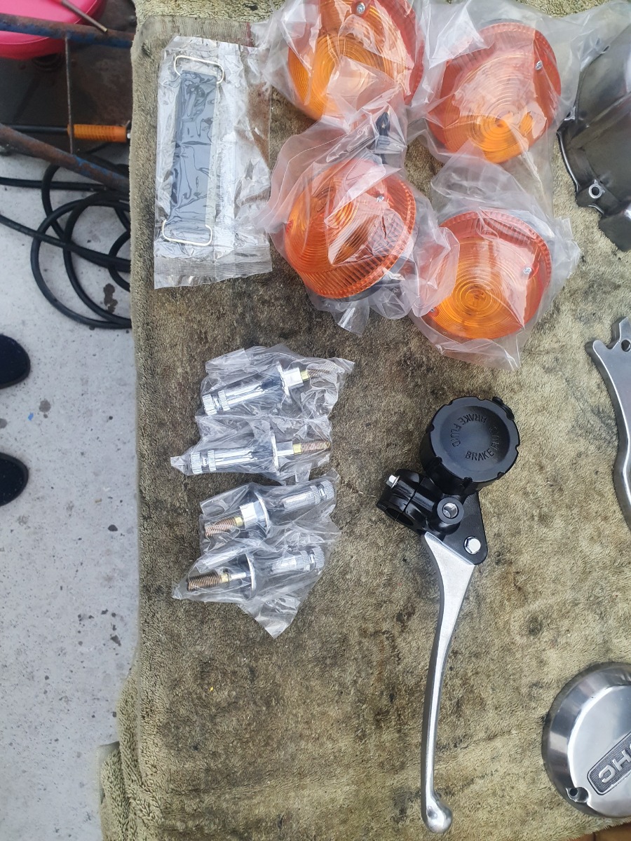

Got some more bits today, a new 5/8 master cylinder, a complete set of short stem indicators (or blinkers or whatever you want to call them !) and a oil tank strap.

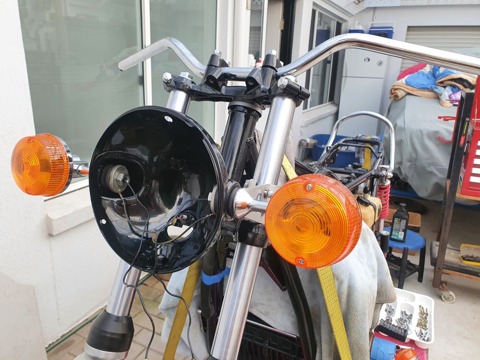

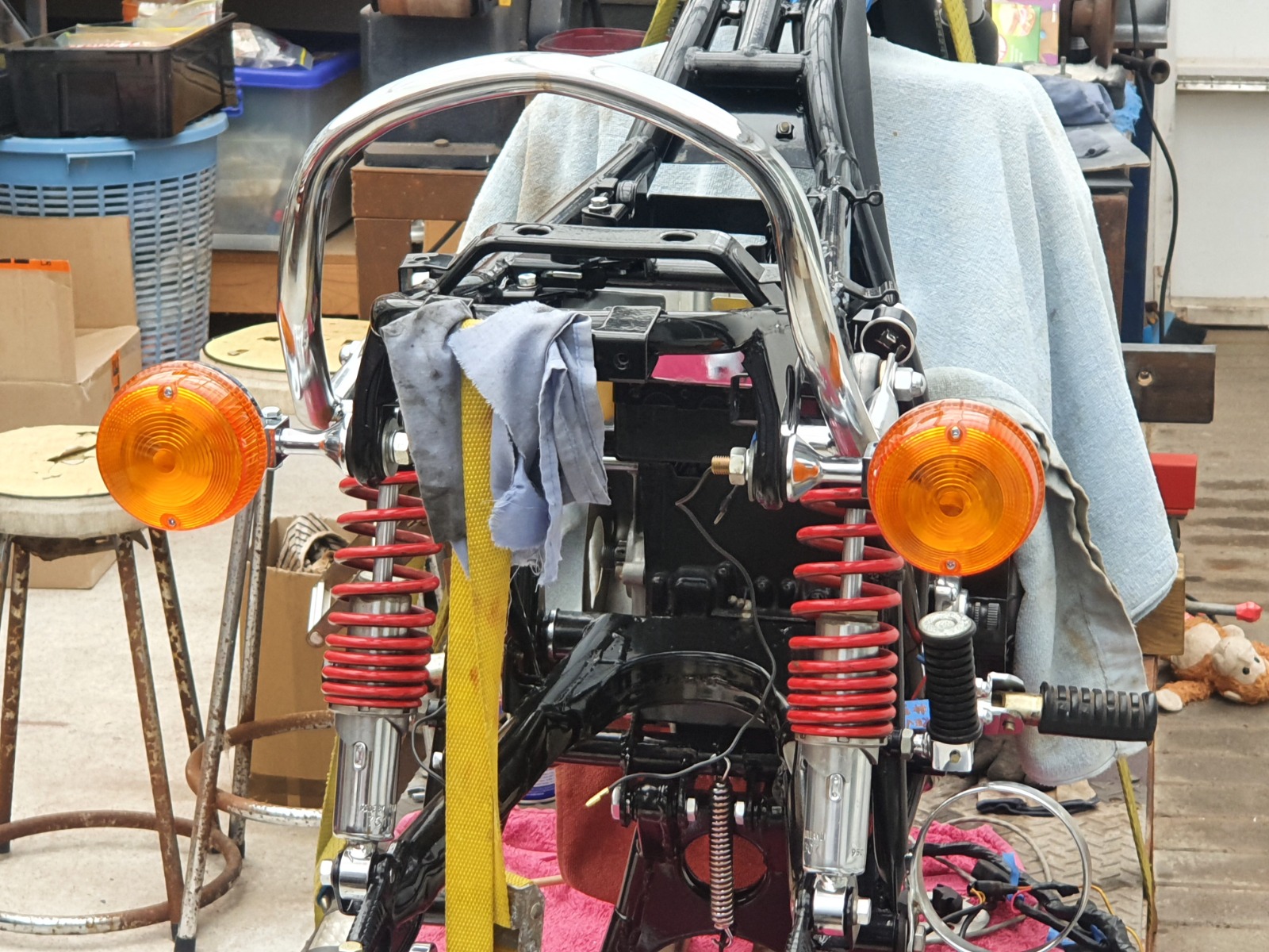

Re: 1973 Z1 rebuild
13 Sep 2022 01:44
I couldnt resist the temptation to do a test fit of the indicators (or blinkers, or flashers or turn signals or whatever you call them
I went with the short stems as other things on the bike will be short (mirrors, handlebars, and the bike itself is 2" shorter)
Retro fitting the blinkers was always going to be fraught with danger, and I soon found out it was going to be one step forward and 2 steps back.
Firstly I found out that I only have 2 of the specially shaped rubber bushes, so will need two more.
Because I dont have the original headlight brackets I had to modify the alloy aftermarket ones to get the diamond shape of the stem thru them.
Now to the rears - I need the earth wires that have a metal and rubber bush.
I layed the wiring loom down under the bike and searched for the wires that the power and earth feed to without success. I got the wiring diagram out and eventually cut away the plastic cover from the tail light loom and found the wires had been cut and buried in there.
A quick look at Z1 spares shows that a new rear loom is $20 aud and pair of earth wires and fittings $18 aud. For $38 I wont even attempt to fix that old mess. The order is in.
Luckily I found the feed wires for the front indicator at the front of the loom. Also found the feed wires for the relay in the middle. Not so bad, things could have been worse !

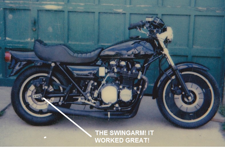

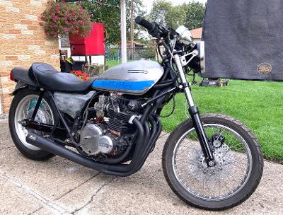

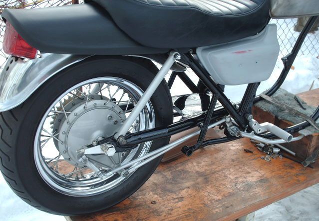

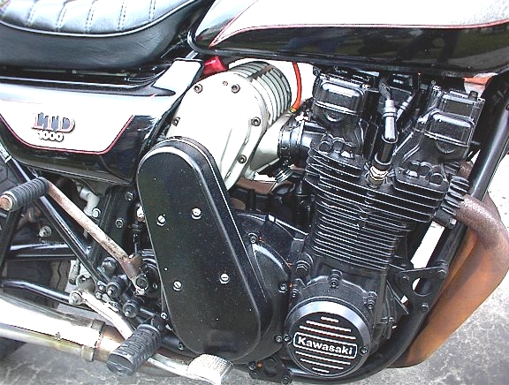

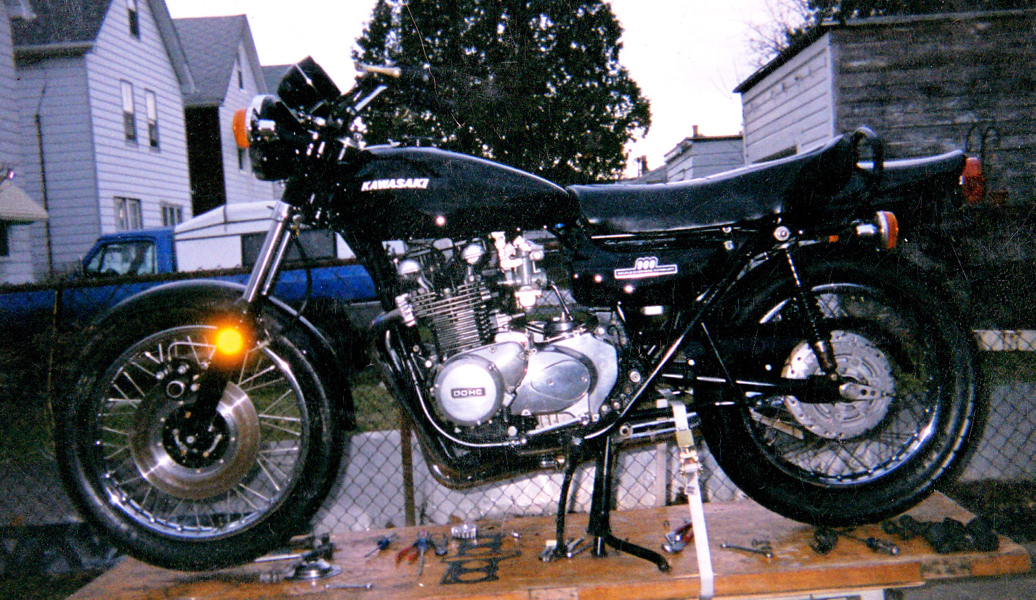

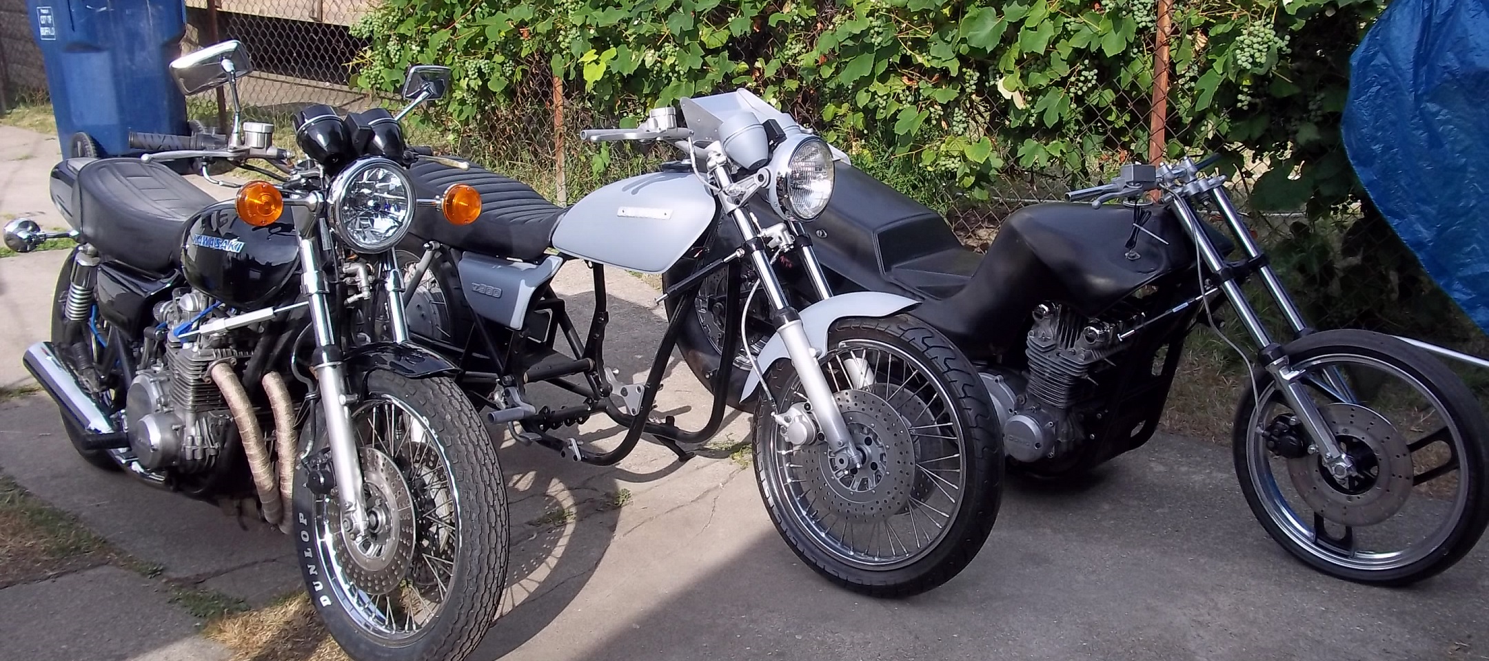

- z1kzonly
- Posts: 2815
- Thanks: 527
Re: 1973 Z1 rebuild
13 Sep 2022 12:14
WHAT?? I did it all! Cut stock ppes off at rear of pegs! Threw out center stands! Cut stock air boxes in 1/2 just to remove! But Z1's / KZ900's were only $100 -$400 dollars all day long!And you all know the rest! Every one tells the stories. But I lived them!
Going thru some old files. I have over 25,000 pictures on a hard drive. Come winter I should save all the Kaw Z/KZ pics. Hope file is useable?
