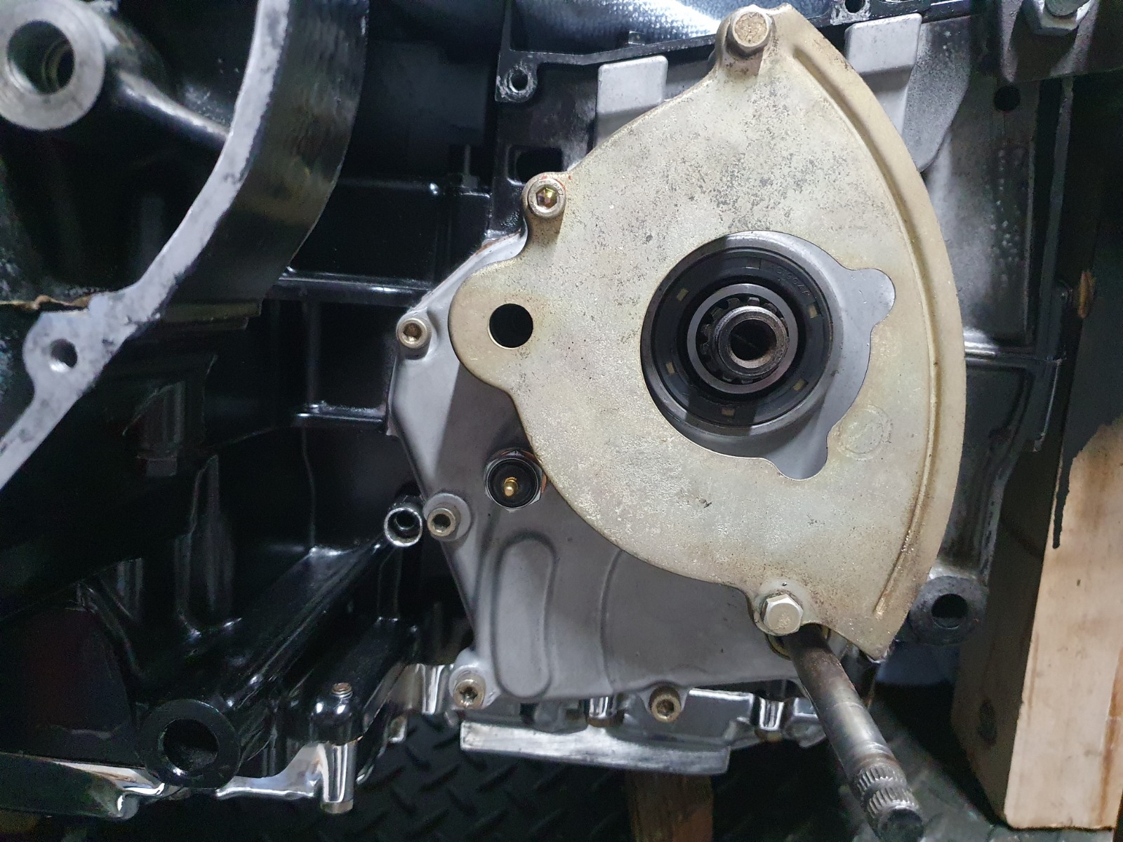

While I am waiting for parts at the Powdercoater and Hydroblaster I have tried to give the alloy polishing a break for a while to allow my fingers to recover, so I have started doing what needs to be done behind the engine covers.
First up, the inner sprocket cover needs the 3 seals punched out and replaced with new ones, a clean up and sorting out some fasteners, then screwed on with a fresh gasket. The new neural switch gets bolted in too.

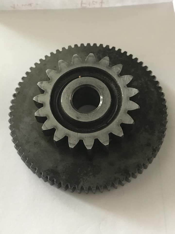

Now while I'm peeking behind the dynamo cover I realise that to re fit the starter I am going to need the starter idle gears (that connect the starter gear to the ring gear) and they were probably thrown out years ago.
I put a call out on the FB Z1 group and someone local to me actually has a spare one in their shed, so I make a visit today and a starter gear is obtained, good score ! I had to order the connecting pin from the local Kawasaki dealer and that will be a 4 week wait.

There should be a thin o ring on your final output shaft, on the outboard side of the bearing.

I was just thinking of mentioning that o-ring, between the bearing and the sprocket spacer. Good call Hardrock.

10 Aug 2022 20:05well you learn something new everyday, over the years I never knew there was an O ring in there !There should be a thin o ring on your final output shaft, on the outboard side of the bearing.

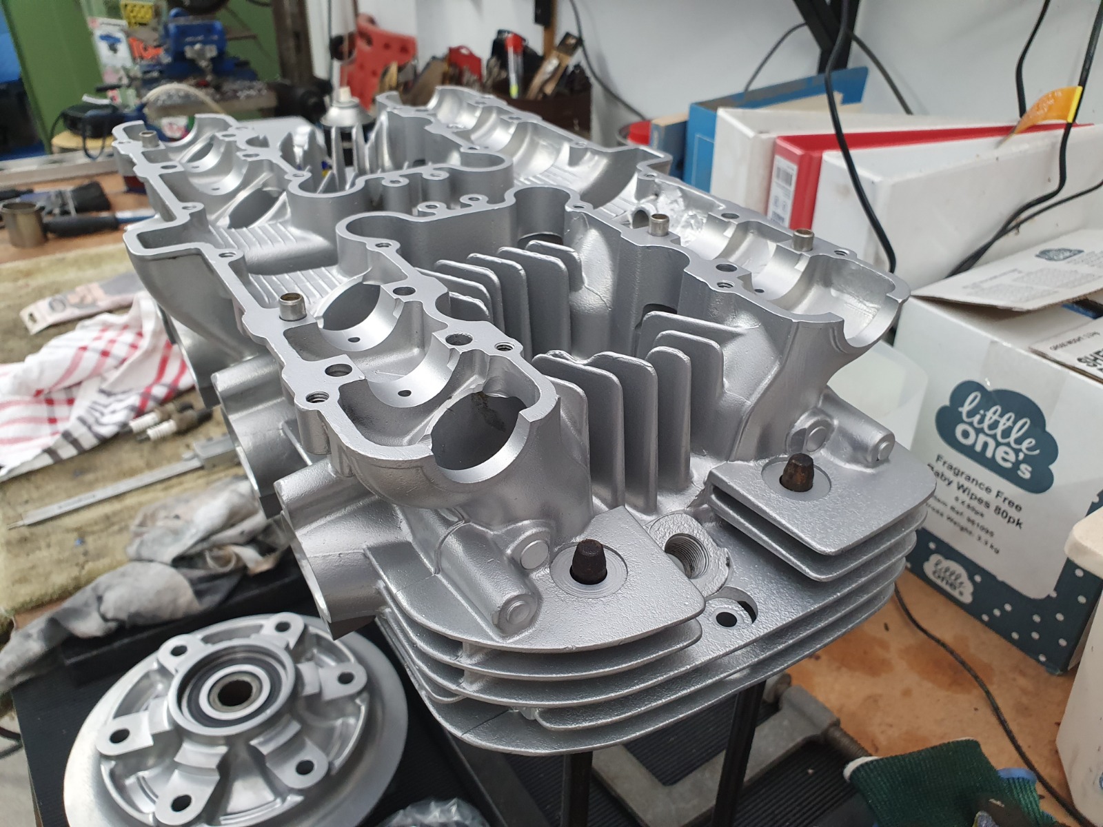

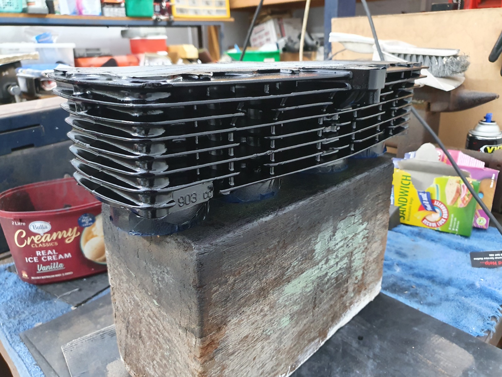

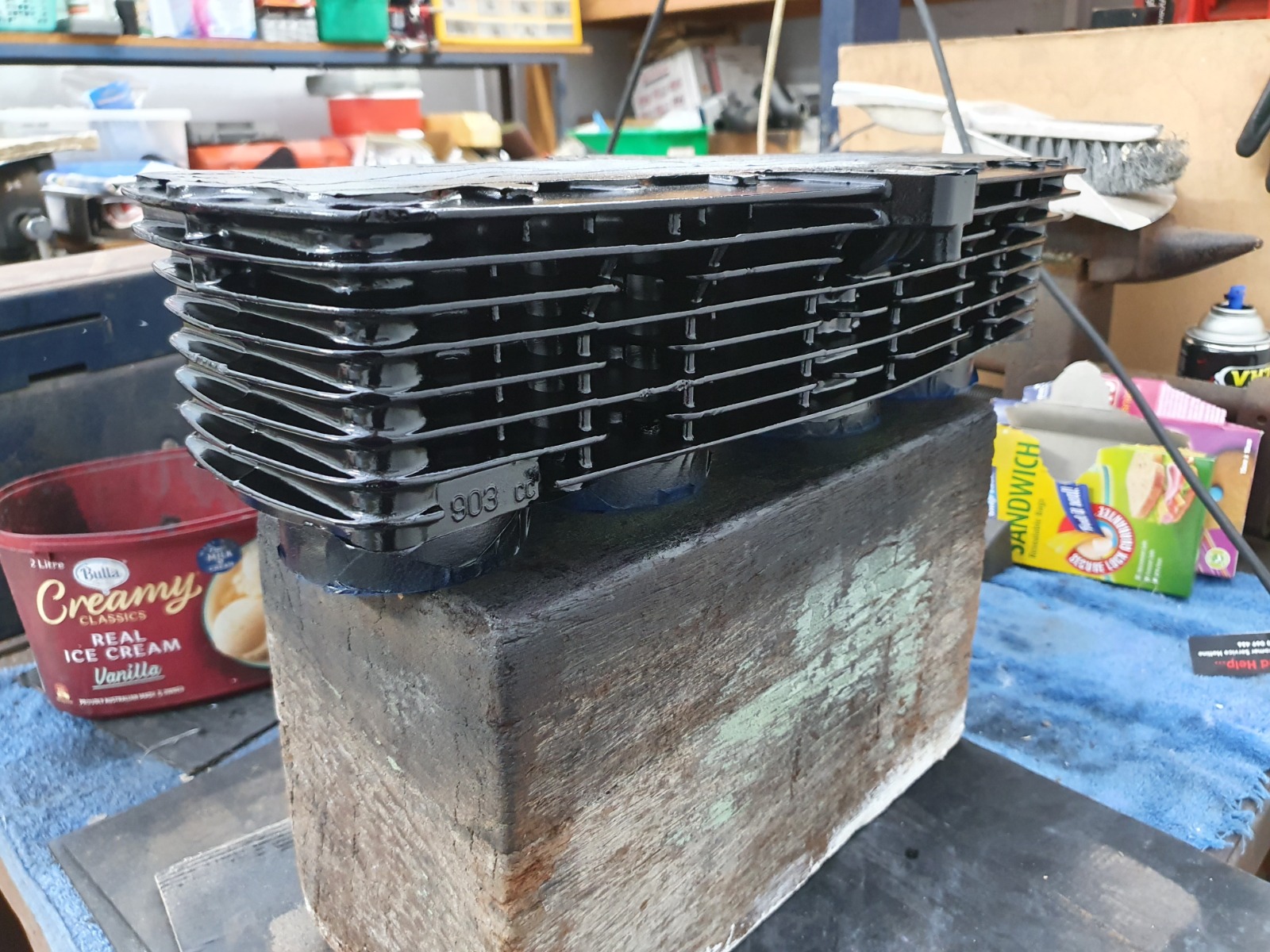

Its been all go today - I also got the head and barrel back from hydroblast.
I have already masked up and painted the cylinder barrel in black satin.

Don´t forget to flush an clean the oil transfer ports in head!

17 Aug 2022 22:14yes, the final clean will have to wait coz I pulled the helicoil out of one of the plug holes.Don´t forget to flush an clean the oil transfer ports in head!

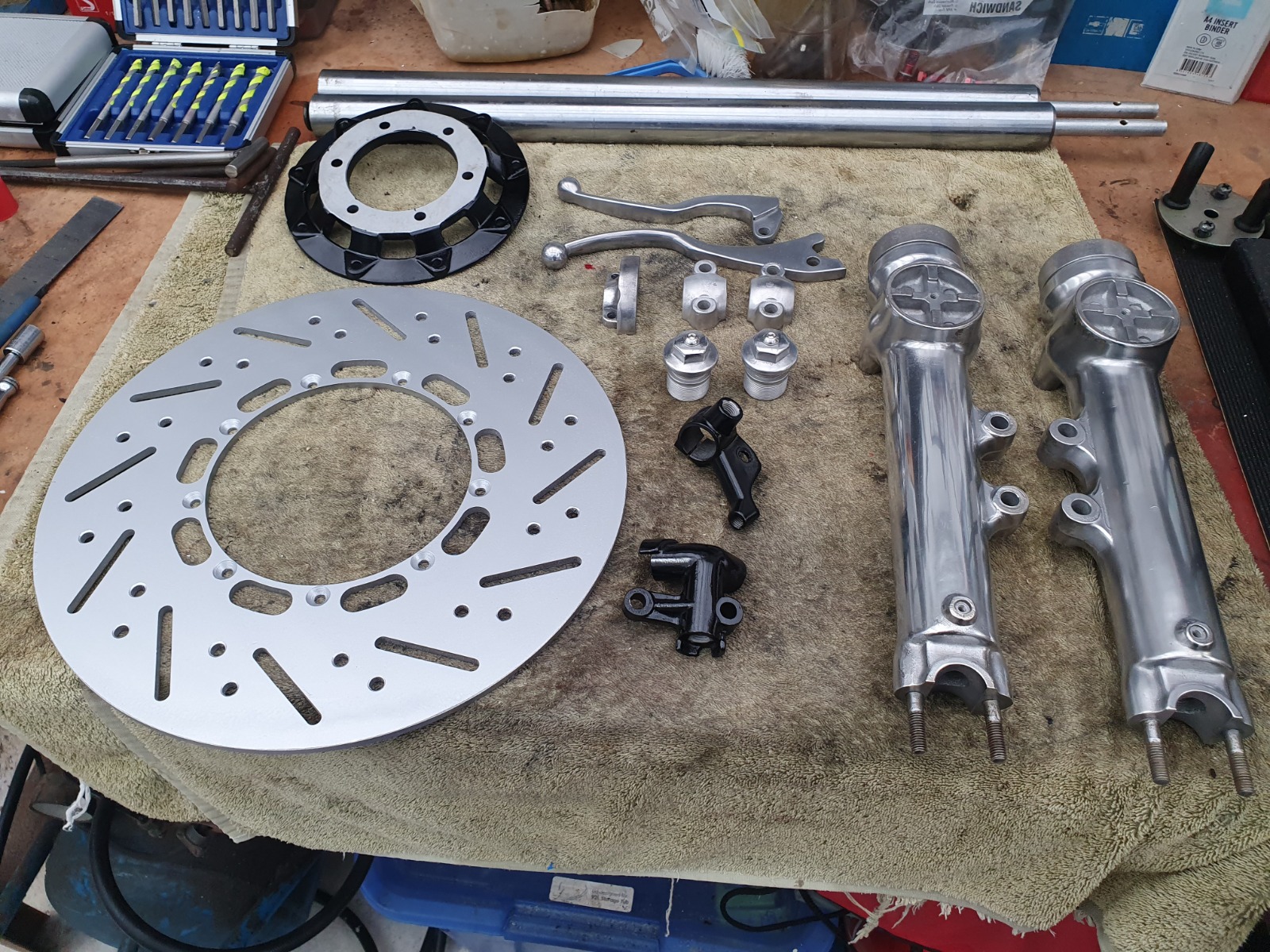

I have been a bit distracted with other stuff (the hillclimb car) but have still managed to get some parts polished and painted.

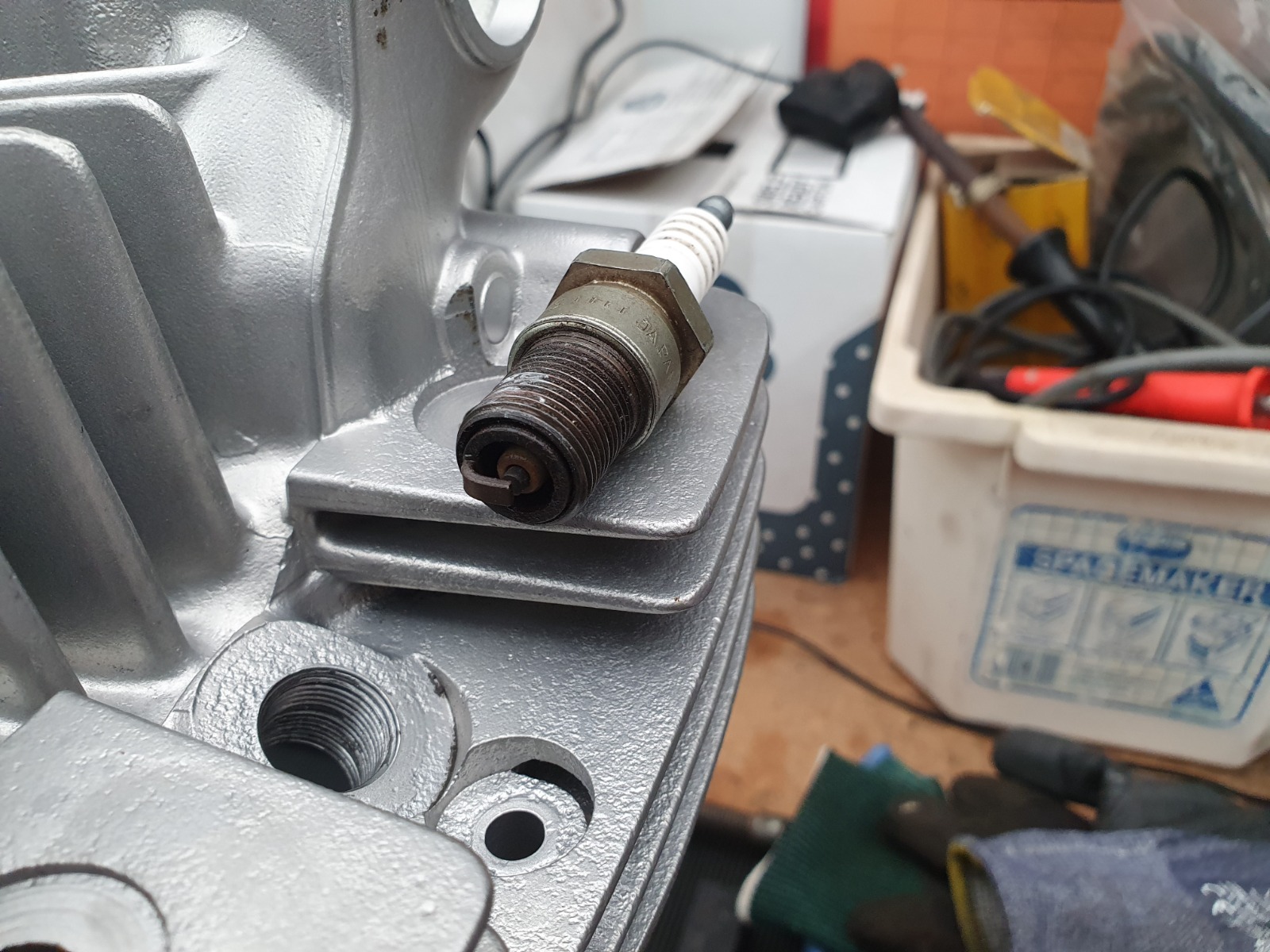

When I got the head back from hydroblasting I realised that when the end spark plug was pulled out it took the helicoil with it ! I didnt have any 14mm inserts so I ordered a spark plug repair kit - when the kit arrived it had very short inserts so that was a waste of time. Will have to drive down to the industrial bearing place to get the correct length ones.

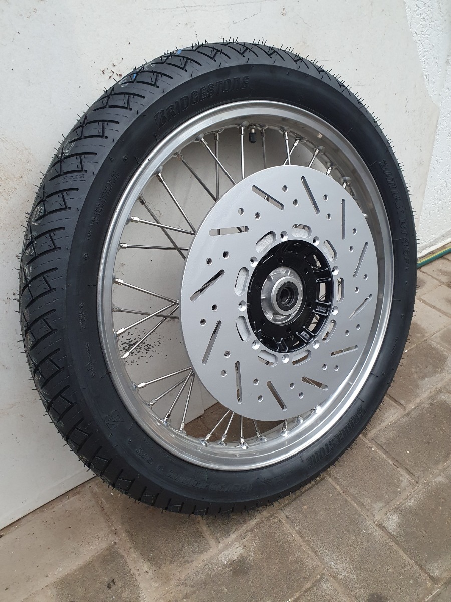

I cleaned up the front disc, it was a rusty piece of junk, and gave it a coat of high temp silver.
dropped the adaptor and disc on the wheel just for a self satisfying look.
