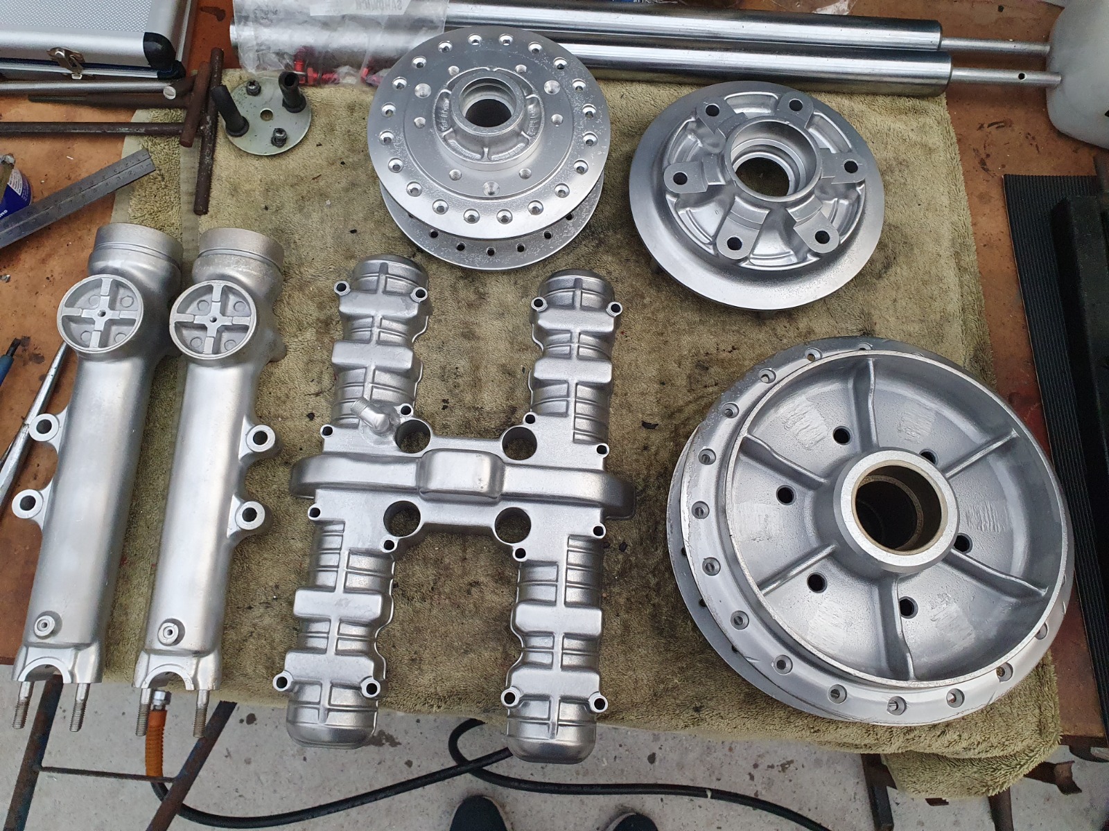

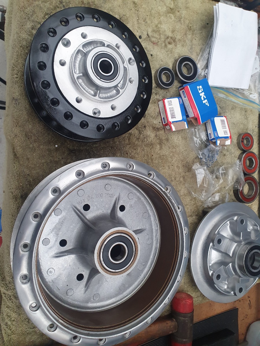

I have got the bits back from the Hydroblast (glass bead and water) treatment.
Now you would think that parts that have been de-chromed AND hydroblasted would be good to go, but not in my world.
another 2 hours just to clean up and polish the rear hub.

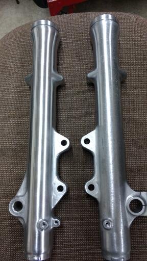

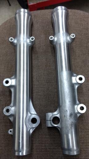

29 Jul 2022 15:48 - 29 Jul 2022 15:49Not sure where you're located but I had a set of aluminum rims refinished by TCR in Cali. I did all the straightening/removed big scratches, they polished and clear anodize.I was going to have mine tigged up, I did think about some black allen head bolts trimmed down on the inside, but I think I'll have them welded up ..

I did the fork sliders on our 80' Suzuki GS1100E with a 6" course flat file and 400g, that's it. I wanted a factory looking finish.

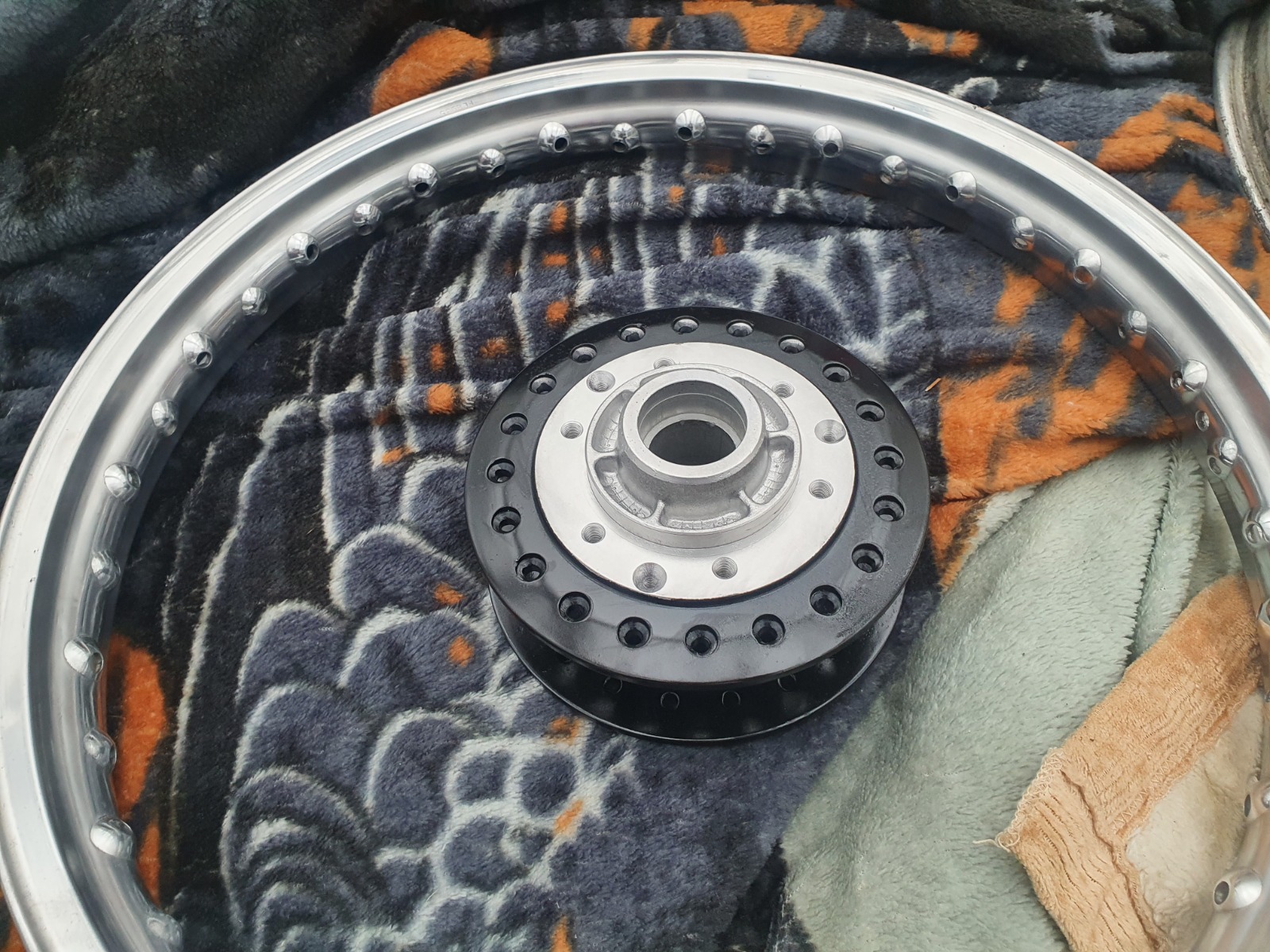

I have cleaned up the rear hub a bit, and painted the front hub.
Started putting the new wheel bearings in, so that everything can go to be laced up.

30 Jul 2022 01:22I did the fork sliders on our 80' Suzuki GS1100E with a 6" course flat file and 400g, that's it. I wanted a factory looking finish.

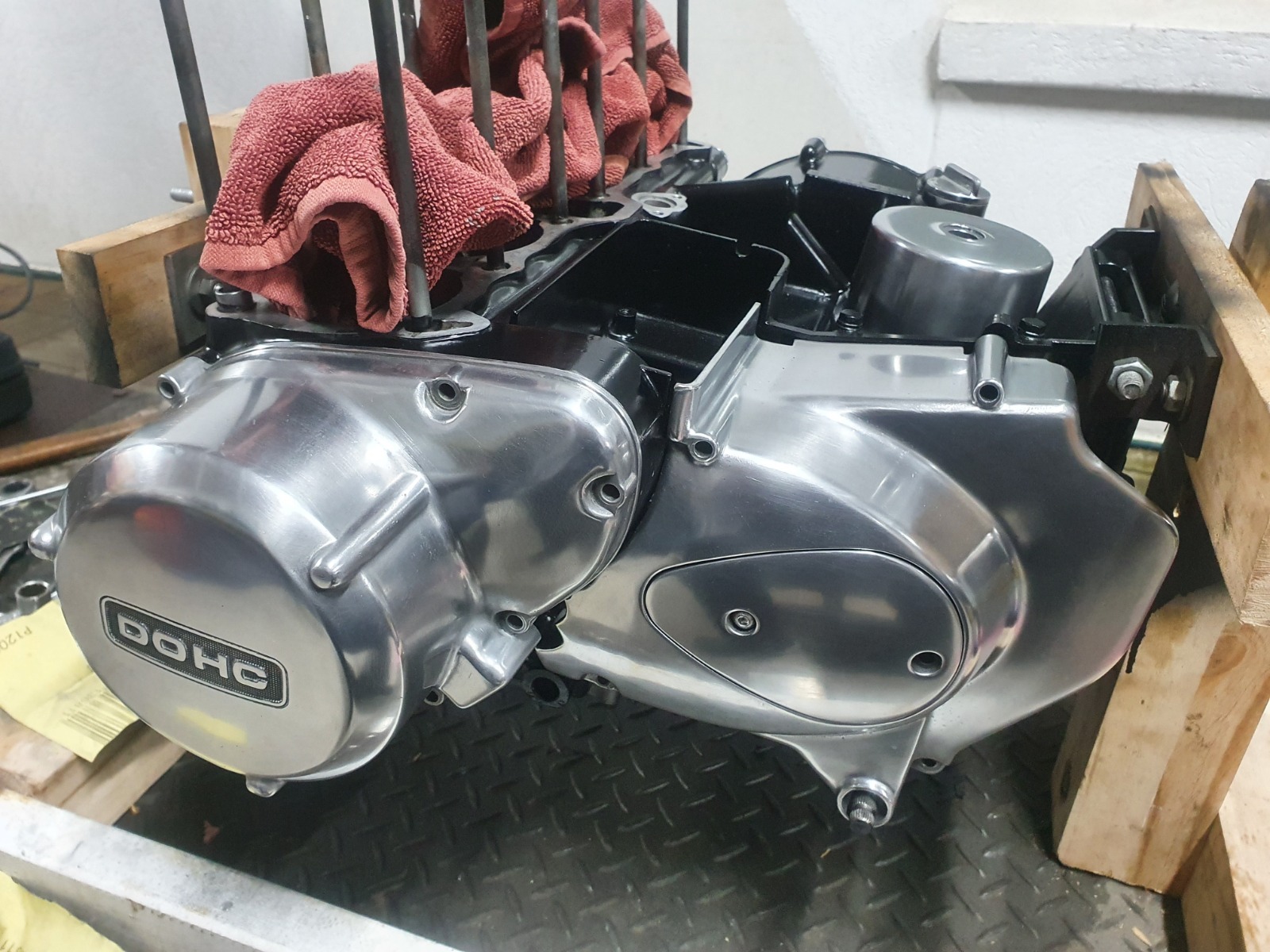

31 Jul 2022 01:46

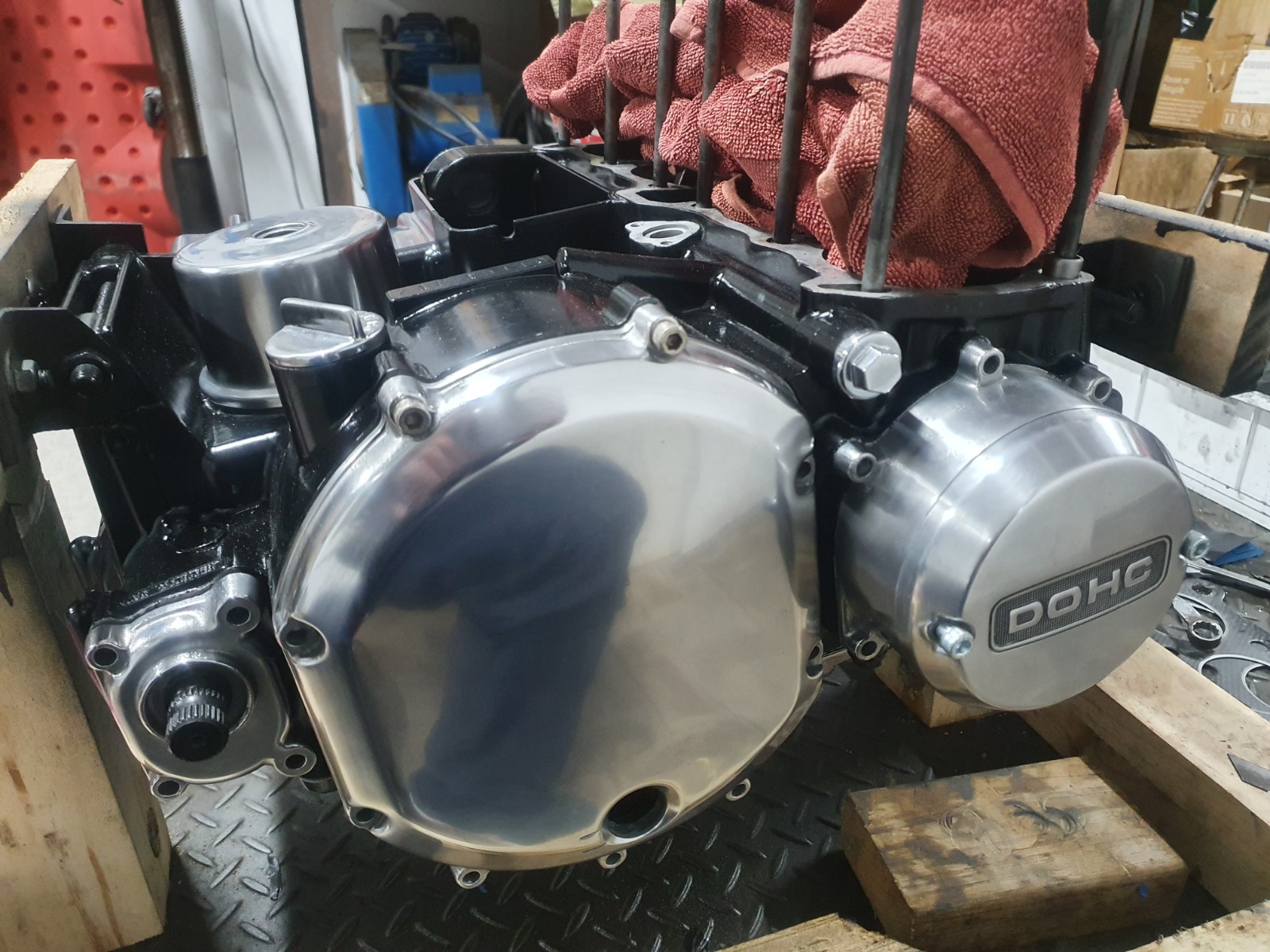

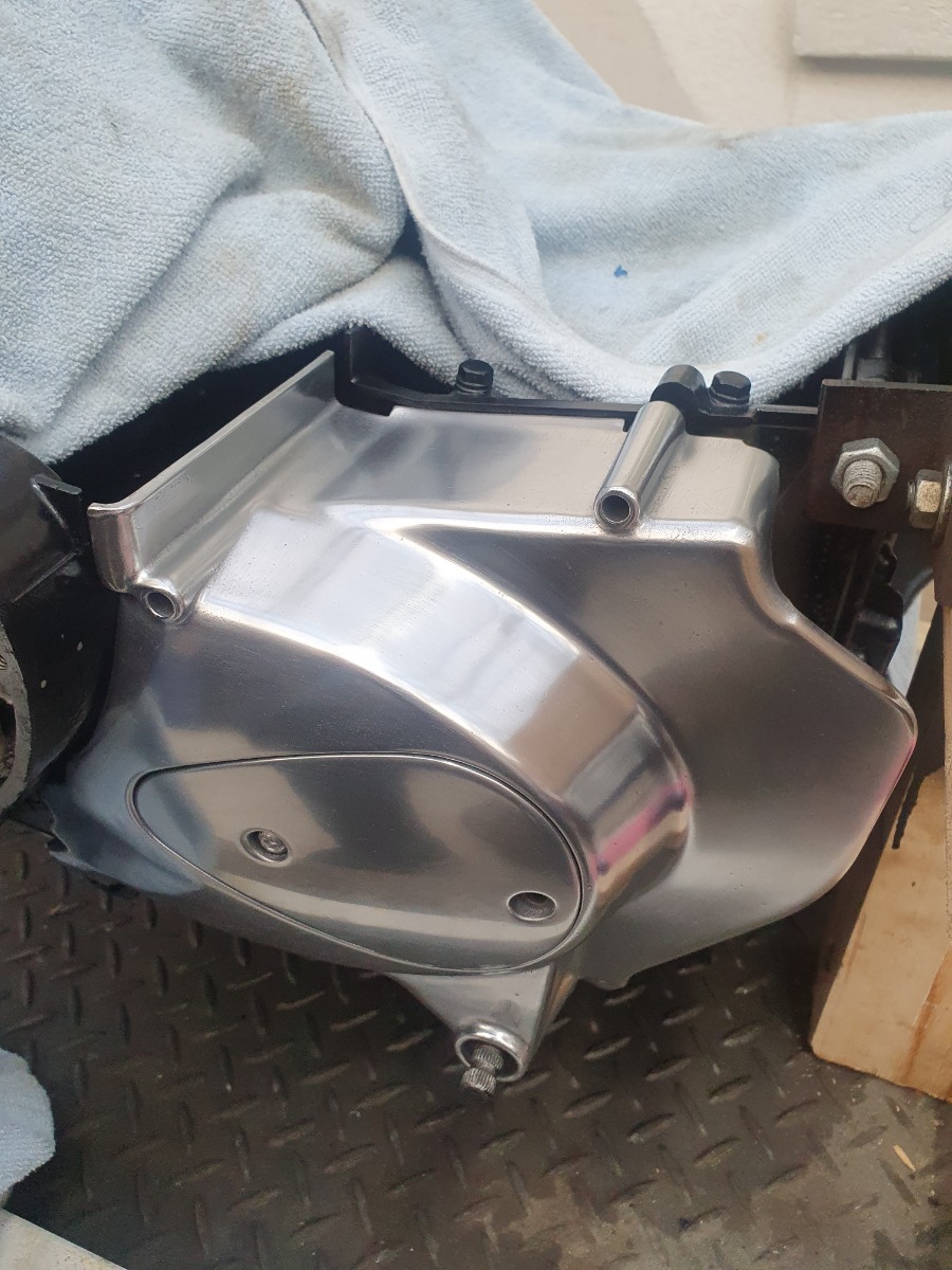

if they had alloy polishing at the current Commonwealth Games I think I would be in contention for a gold medal !
The engine covers are done - now I can take them all back off and get on with putting things together.
