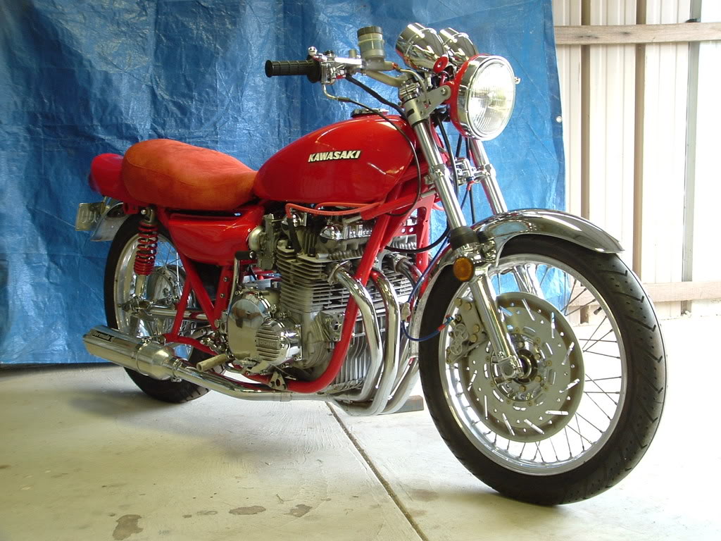

The paint on that set is indeed beautiful. I can’t help but wonder what a matching color on the frame would look like? Black is universally acceptable but what if… ?
What type of red paint is that on frame? Rattle can? It has held up well.

28 Jun 2022 03:32The frame was powdercoated - its over 25 years old and it is still in perfect condition. Its actually a bit grimy because I have been man handling it while stripping the bike. If I polished the powdercoat it would shine right up.The paint on that set is indeed beautiful. I can’t help but wonder what a matching color on the frame would look like? Black is universally acceptable but what if… ?
Im going to have it stripped and powdercoated gloss black.
What color where you imagining ?

28 Jun 2022 05:46The frame was powdercoated - its over 25 years old and it is still in perfect condition. Its actually a bit grimy because I have been man handling it while stripping the bike. If I polished the powdercoat it would shine right up.
Well I’m a "black frame" type of guy but for some reason I like that particular red on your frame. The red won’t go with that paint set so I was thinking a matching orange frame (or possibly matching root beer) but if it were mine, orange.
I know getting exact colors with powder coat is either difficult or impossible.

28 Jun 2022 06:30
The red frame worked with a red bike.
im not sure about the candy orange frame with the Jaffa paint tho ?

Maybe Rootbeer frame and highlite it with some Orange pinstriping

The red bike in its glory days was gorgeous. It still is.
Plus, KTM seems to do alright with orange frames.
But let’s keep this going guys, he’s thinking about it.

100% Black frame !

I think I'm pretty much settled on the black frame, I want to return the bike to looking as much like a 73 Jaffa as possible, so after de chroming is done, alloy items will be hand polished, some steel will be chromed (mudguards, headers etc) and other steel items (swingarm, front hub etc) back to black again.

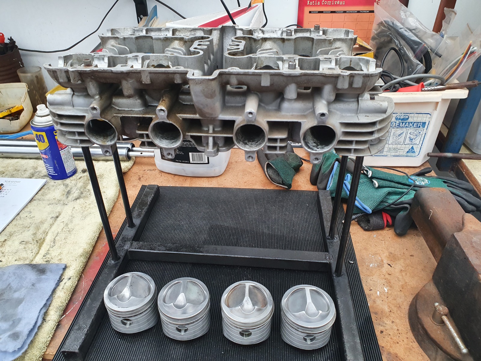

I have dropped the barrel of at the engine place, the MTC sleeves have metal O rings in them that need replacing and it will require a light hone to clean it up. As with most things mechanical these days there is a waiting list, in this case 6 weeks, but I still have plenty to do in the meantime.
I have stripped the head completely down ready for a hydrablast clean up but will have to wait for the barrel to come back so I can get that done at the same time.
The pistons are cleaned up and all shiny, when I was measuring the pistons and bore, these pistons are actually 72.5 mm, giving a displacement of 1090 cc.
