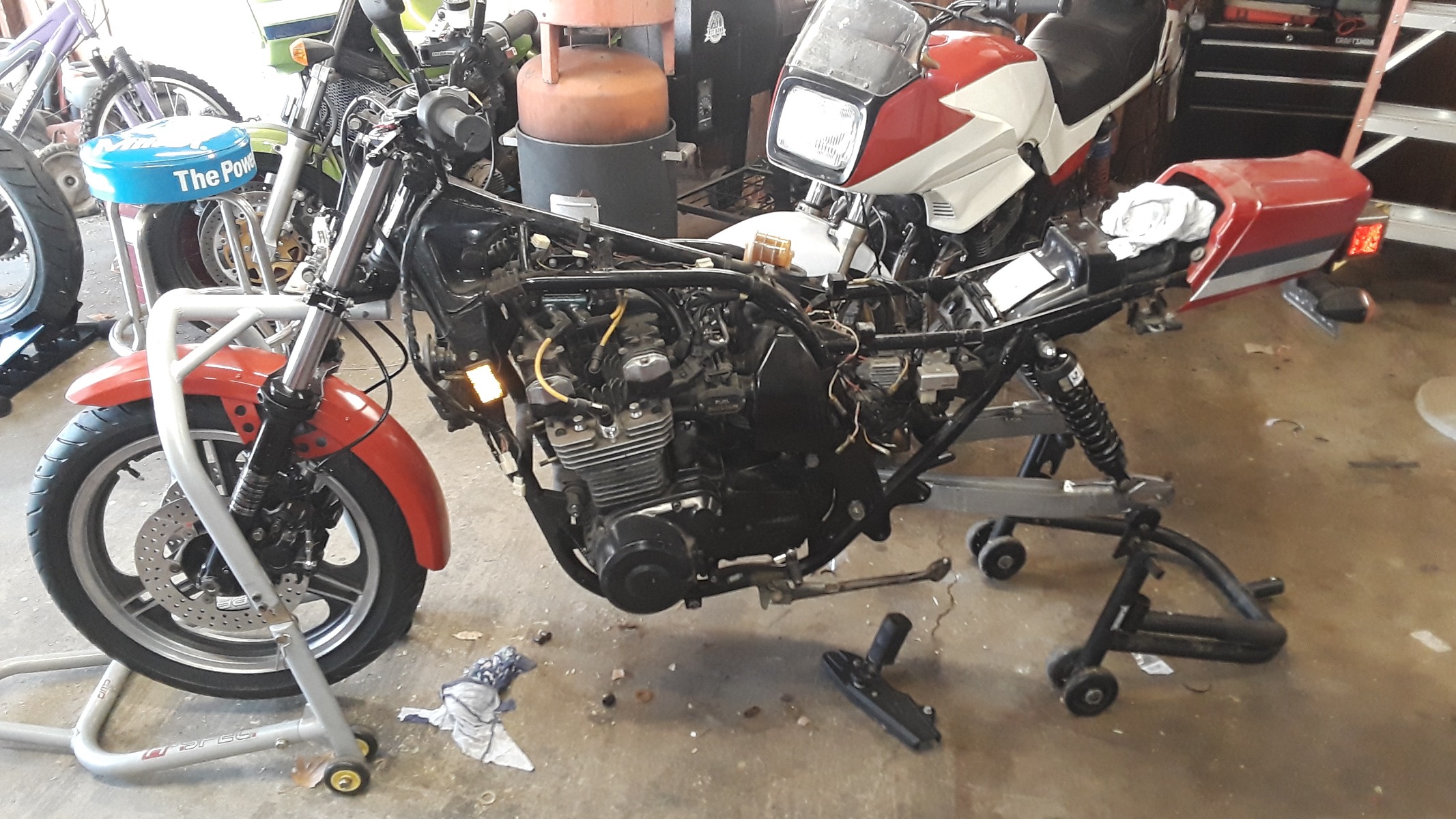

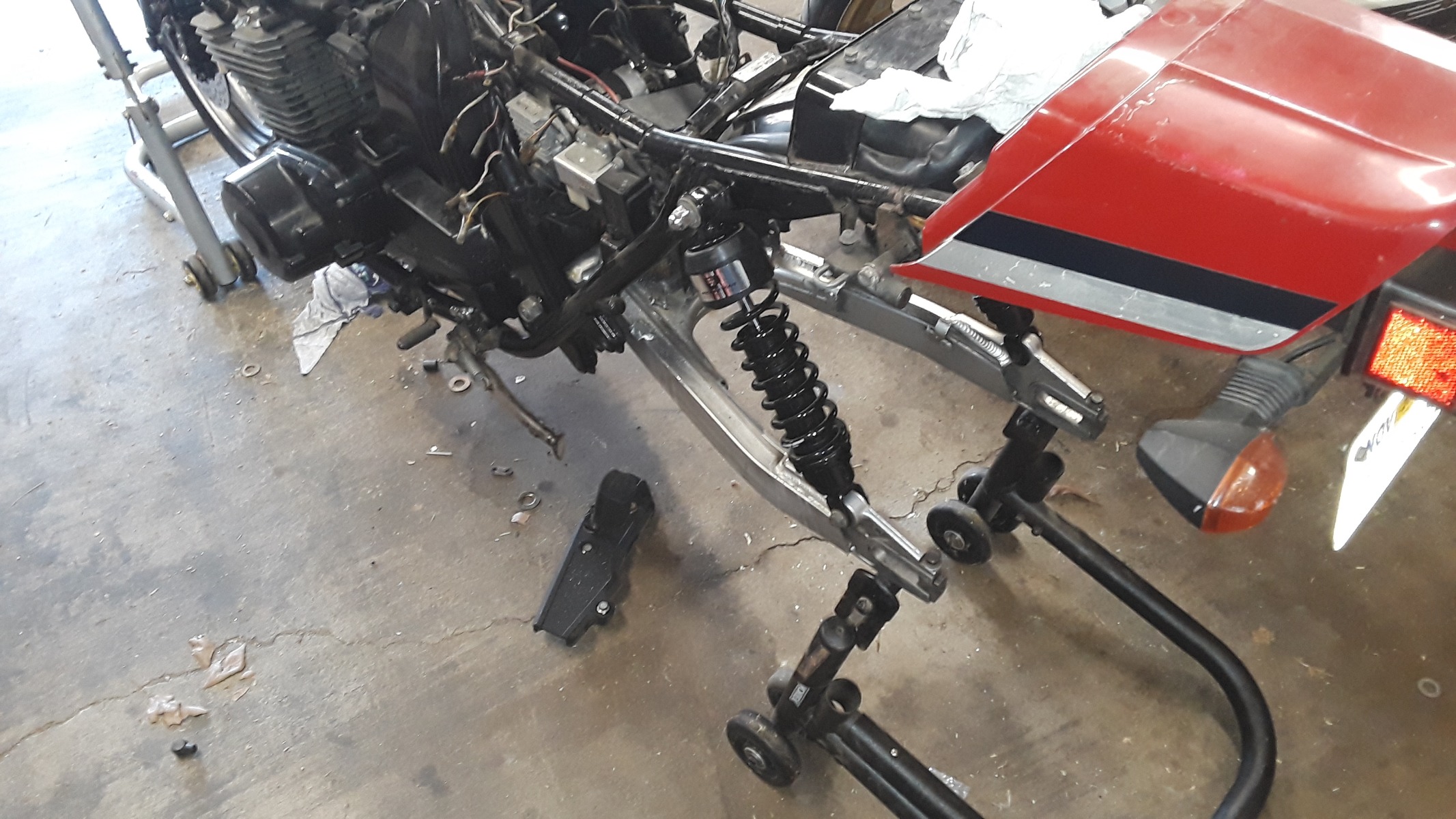

Small update... the Suzuki swingarm is firmly mounted to the GPz for the first time. Wheel bearings have arrived to accommodate the larger Suzuki axle. The wheel has been disassembled and I'm headed to the fabricator's shop Saturday morning to make up spacers for inside & outside the wheel & get the wheel centered in the swingarm.
And I started bleeding the front brakes... a tedious process with stone age tools & a completely empty system.

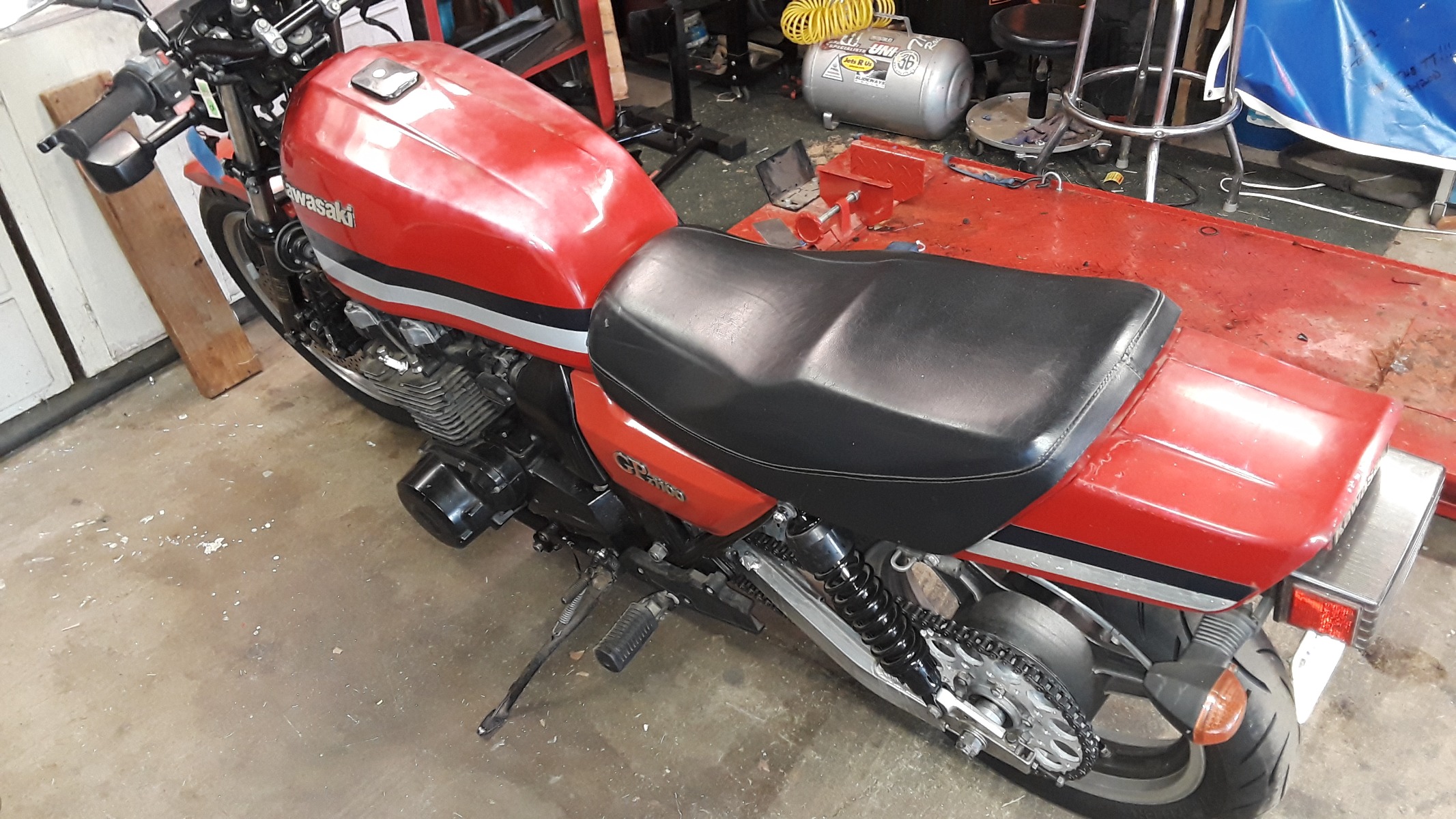

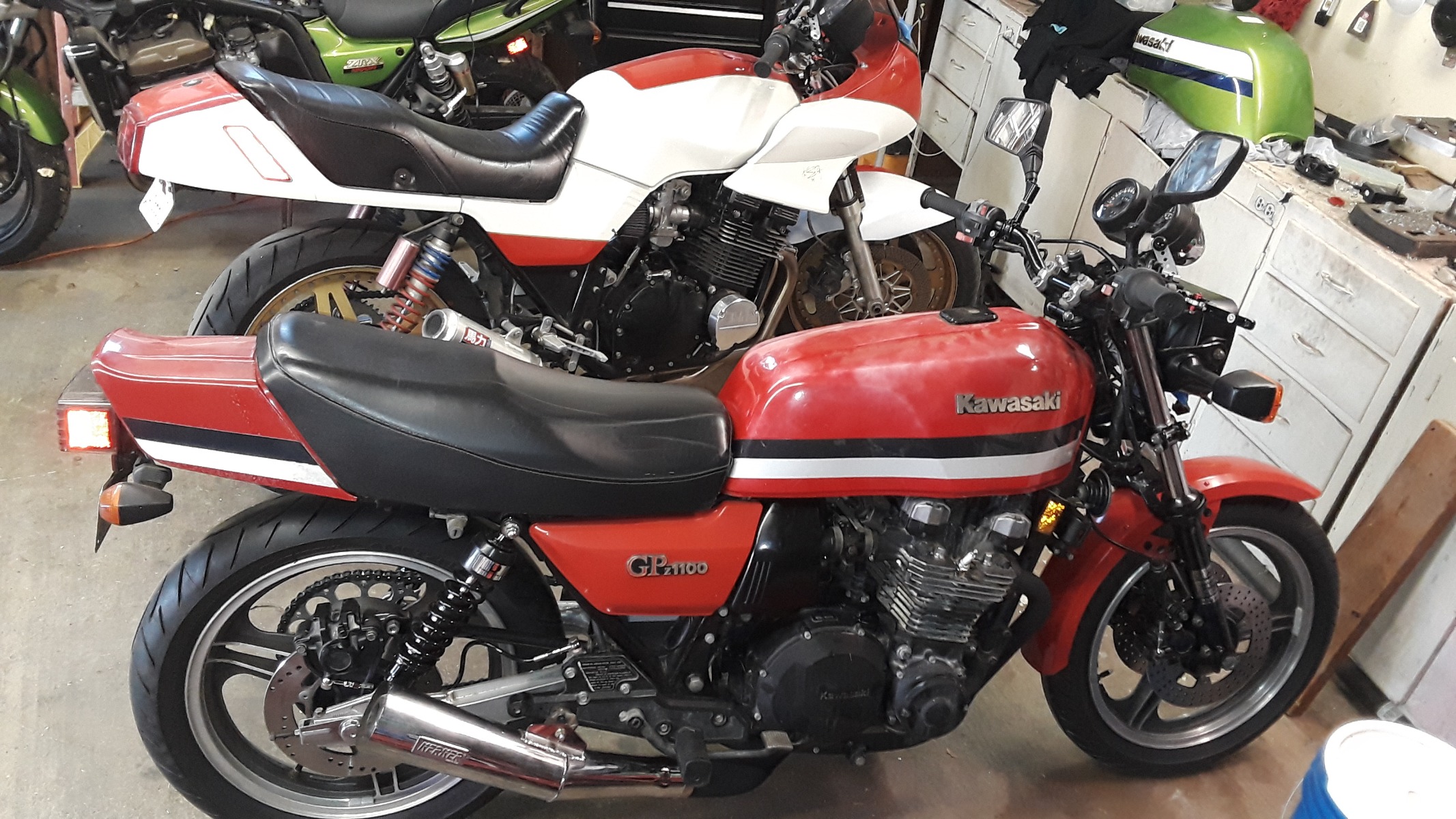

I figured with spring coming, I better get cracking on & not posting, so time for a proper update.
Wheels & swingarm finalized, centered & spaced. Brakes finally sorted. Kerker with fresh coat of paint. Gauges mounted, (wiring still to finish) and fuel injection flow meter & harness reinstalled. Fresh HP & LP fuel lines, fresh filters all 'round, valves checked & found to be in spec(!) & of course, an oil change

Sadly, I still have some FI gremlins to shake down, but she started yesterday for the first time in 5 years!

Looks great. Love the wheel swap. Bikini fairing would be icing on the cake!

I'd be perfectly happy to have both those bikes in the garage..!

Thanks Doc,
the fairing is still hanging on the wall awaiting me completing the harness for for the speedo & idiot lights. Then the headlight can go in, and FINALLY the fairing.

15 Apr 2021 06:50Thank you Sir. Next up is the neighbor's XR50, cuz racing season starts this weekend and with any luck I can get the ZRX going as well!I'd be perfectly happy to have both those bikes in the garage..!

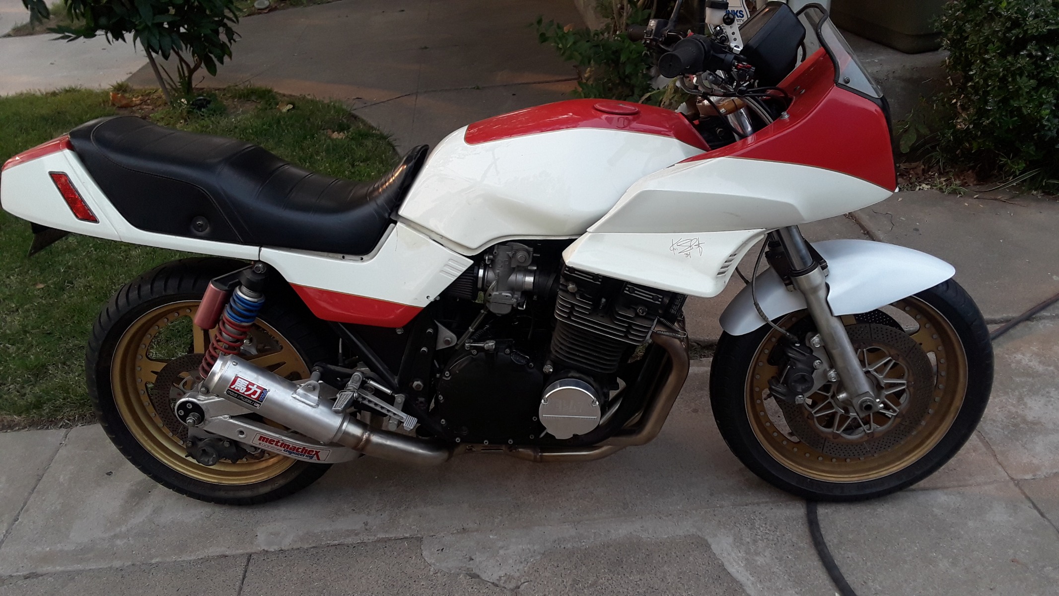

My eyes keep going back to the Suzuki! I had an '83 GS750E that I put almost 60k miles on. Can you spill some info (without going too far off the topic).

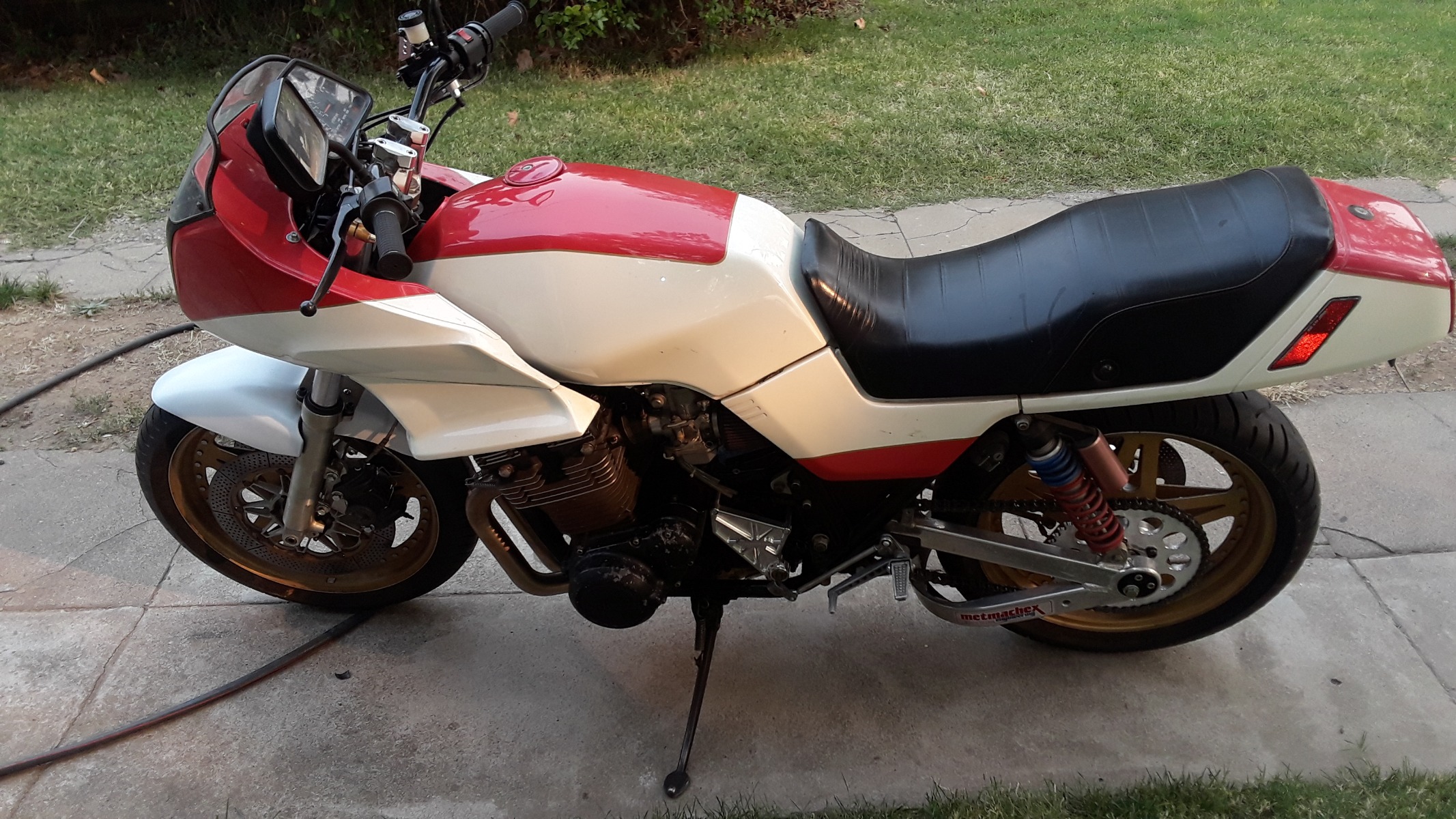

16 Apr 2021 06:49Sure skidmark,My eyes keep going back to the Suzuki! I had an '83 GS750E that I put almost 60k miles on. Can you spill some info (without going too far off the topic).
1983 GS11es with some "period correct" upgrades. Astralite wheels, Fox Shox, Sandy Kosman rotors, Spondon calipers, Metmachex swingarm, 35mm Keihin CR Special carbs, Motogpwerks exhaust and RaceTech GSXR11 forks recently added

I like it, they have brilliant engines, I see you also have the later version of the Astralites with the extra rivets, Nice...
