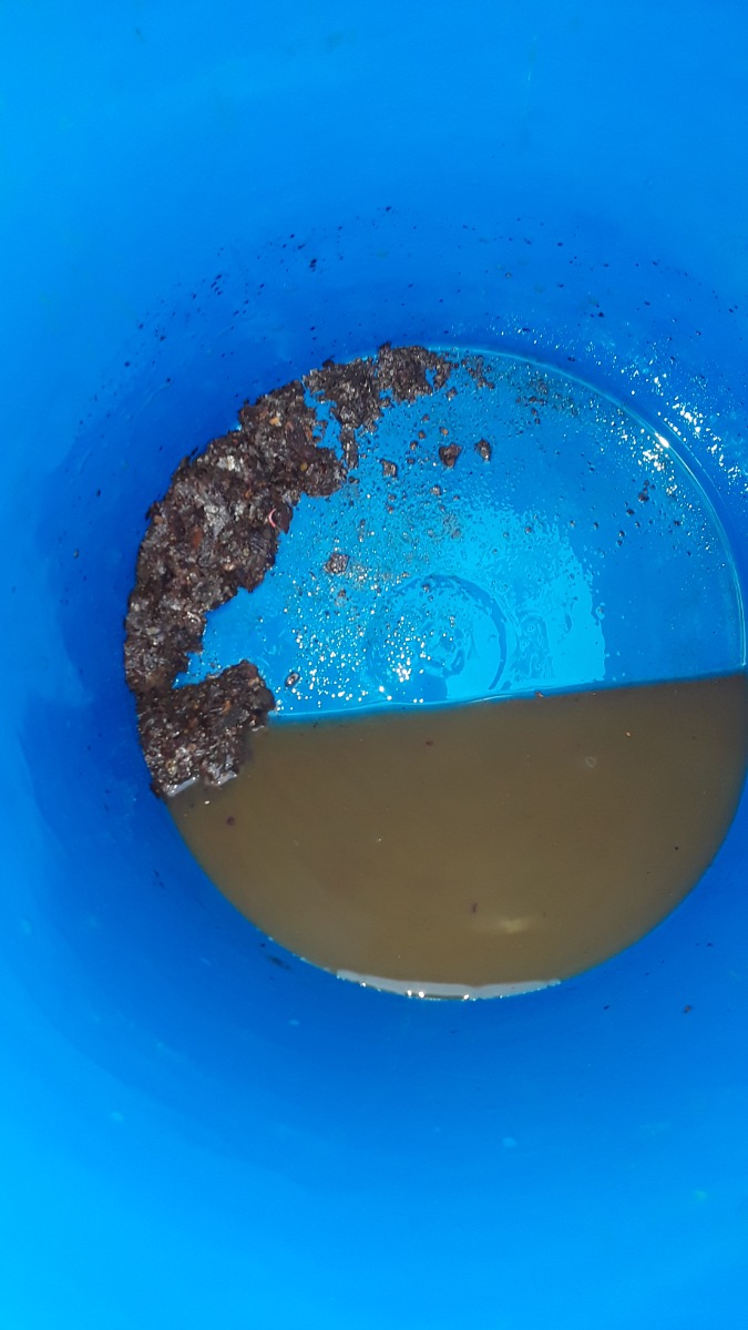

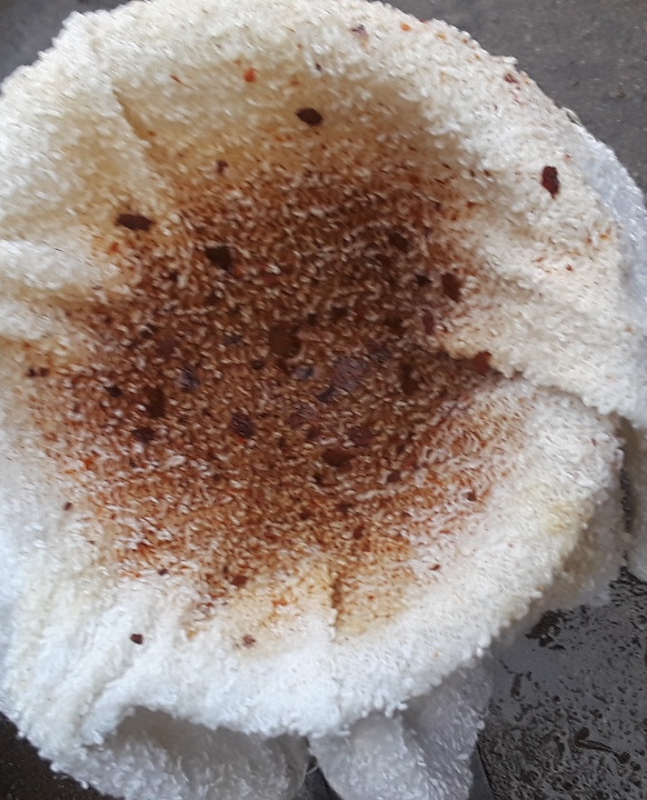

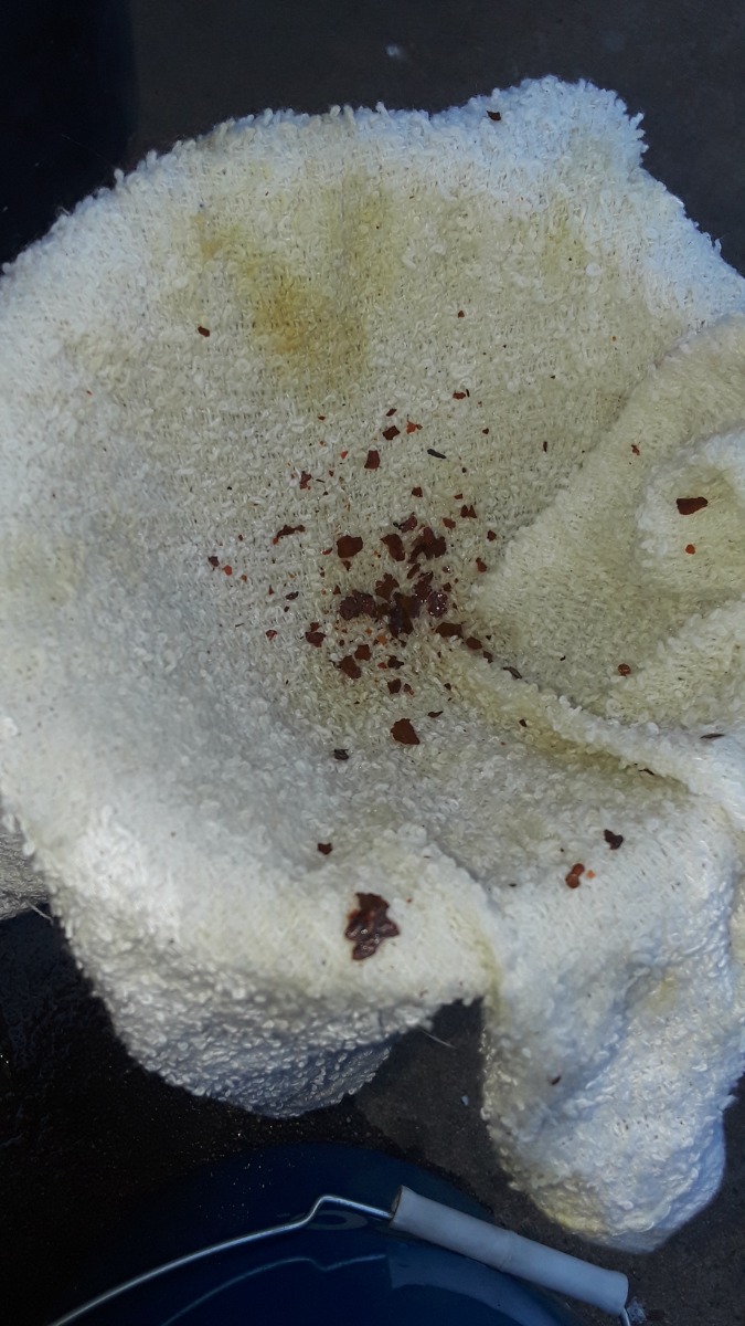

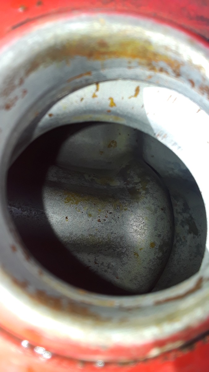

In the end, I ended up using a $.59 cork from Ace Hardware to seal the petcock location. All in all I had a positive experience with the vinegar treatment.
No chain, nuts or ball bearings, just vinegar all the way to the top of the tank for about 24 hours. Shaken a couple of times during the day for agitation. I want to borrow the borescope from work to check the deep part, but based on the pictures, the vinegar works great.
After looking into the tank:
Not horrible, but this was the "floating" debris out of the bucket.
I saved the vinegar for a second wash if needed, and filtered through a shop towel...
First pour out of the 5 gallon bucket:
After a couple more pours:
and the bottom of the bucket after poring it all out!

I should have mentioned that I used a half a pound of baking soda in a gallon of water as a first rinse.
Plain water as a second rinse, and the shop vac running in reverse to "blow dry" the interior.
After most of the moisture was removed a solid squirt of WD-40 in the tank, until I ran out of WD-40.
Next best option was some 2 stroke gas to try to "protect" the inside of the tank.
Be safe guys.
Be safe guys.

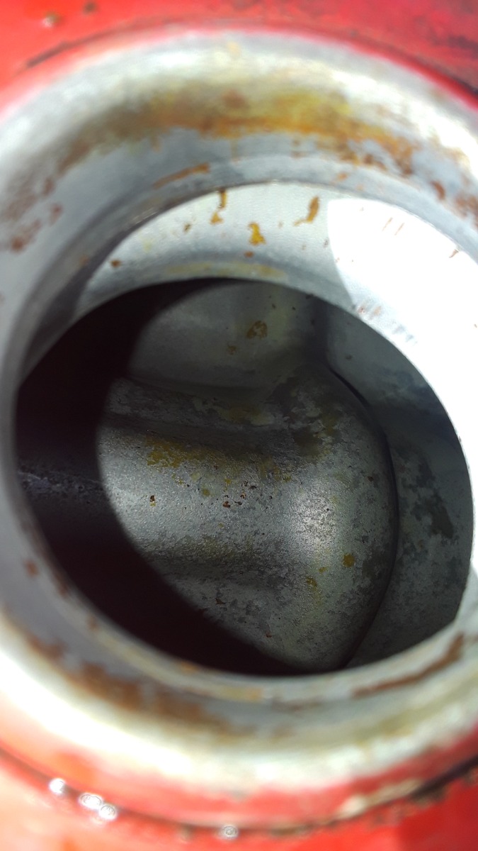

I have access to a very high tech bore scope at the plant where I work. I had one of the mechanics fire it up so we could take a look inside the tank for "peace of mind".
It looks fantastic inside! 24 hours of vinegar with out any agitation or nuts or chain and it came out clean as a whistle!
I can now feel much better about re-installing the tank & getting the old girl back on the road!
