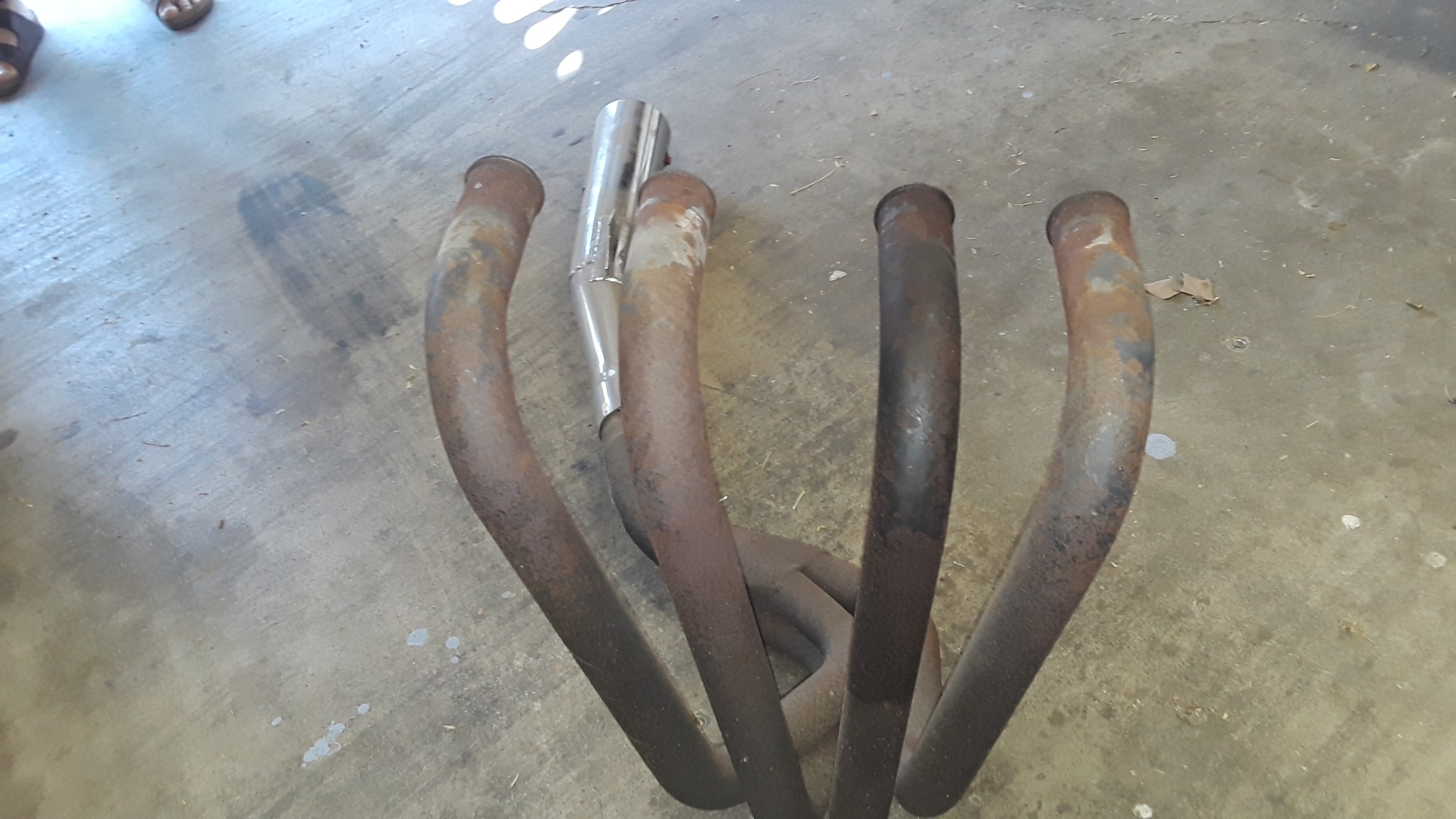

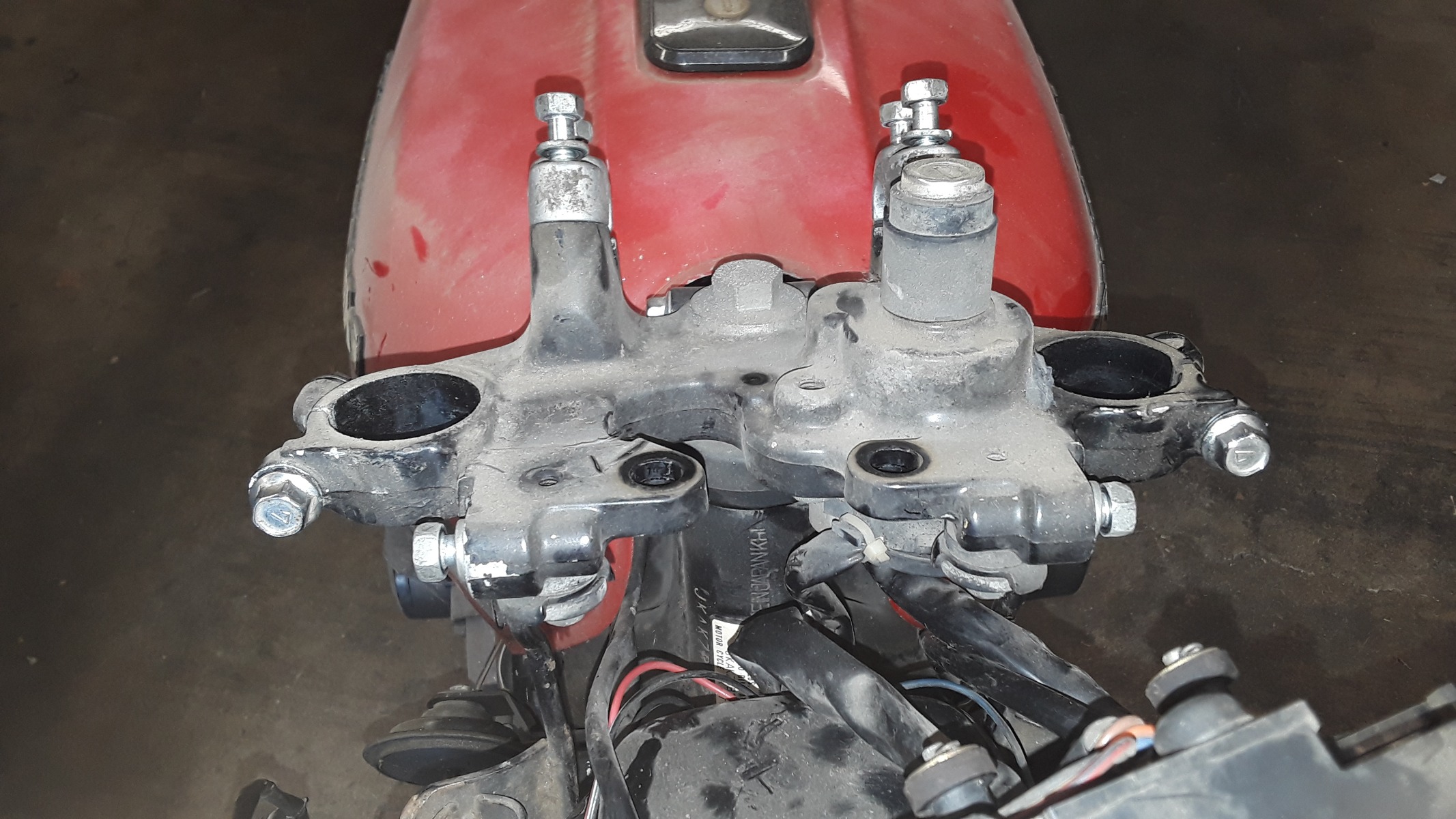

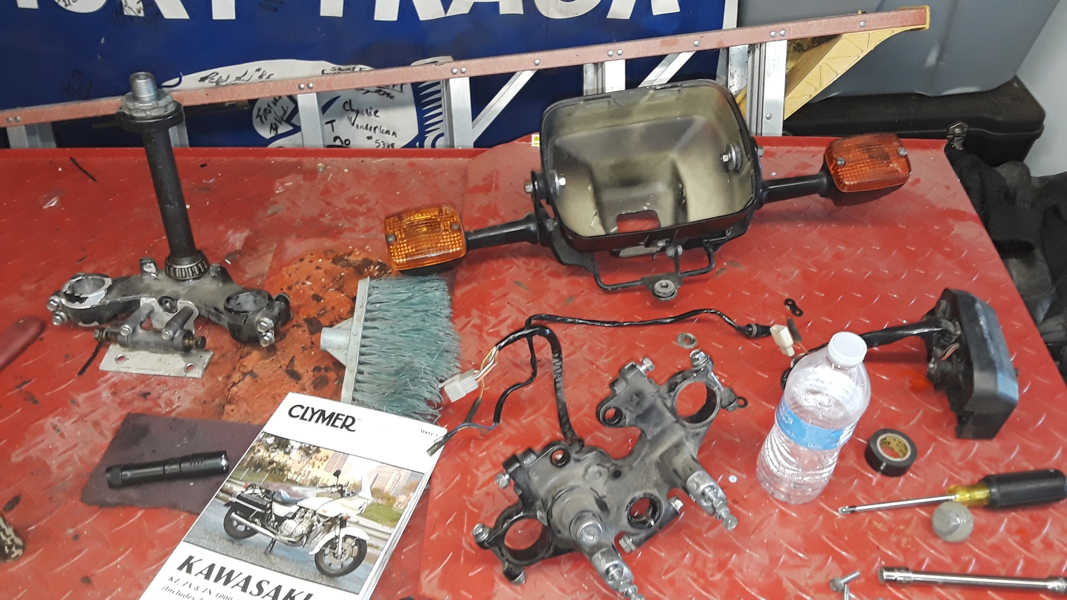

As the dis-assembly continues, I find more & more really ugly stuff. Sunday morning, after feeling the horrid condition of the steering stem bearings, it was removed along with the balance of all other components on the front of the bike.

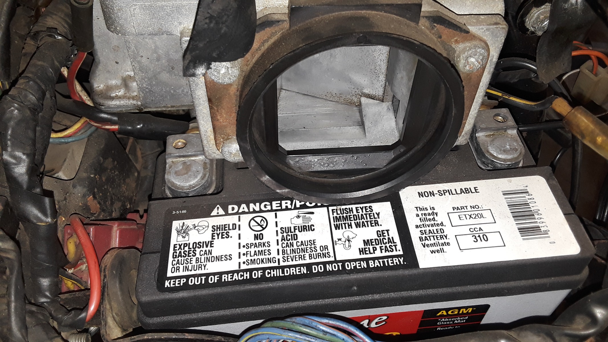

Started with the remainder of the gauge cluster and moved on to the battery, but first the air flow meter needed to get out of the way
Soon enough it was to the point I was satisfied... for now, including the ugly, miss-matched Kerker pipe

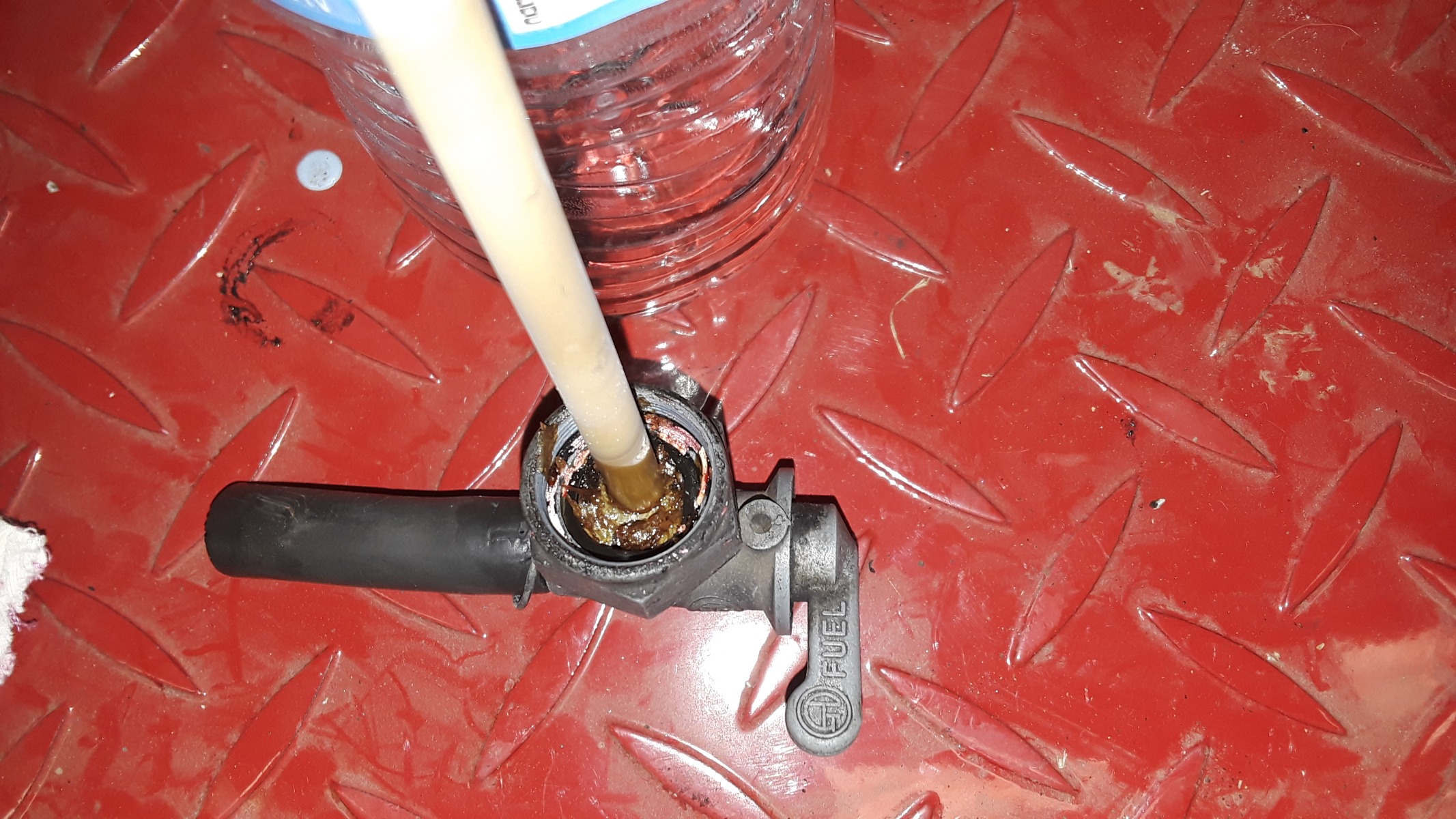

The "coup de grass" however was the petcock! Holy crap! What a nasty surprise!
EDIT to add: The steering stem bearings were completely devoid of any grease. Nothing surprises me any more...
