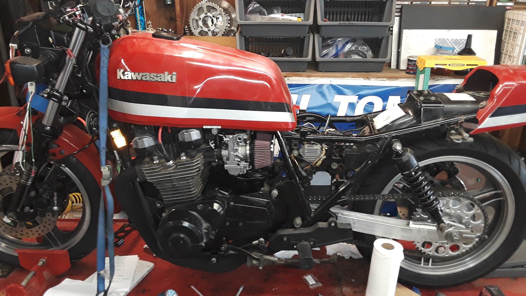

So it turns out that during the 5 year hiatus the intake flow sensor has shat the bed......
Ebay to the rescue, again. Incoming intake boots, Mikuni RS34 pumpers, Motion Pro push-pull cable set and K&N filters

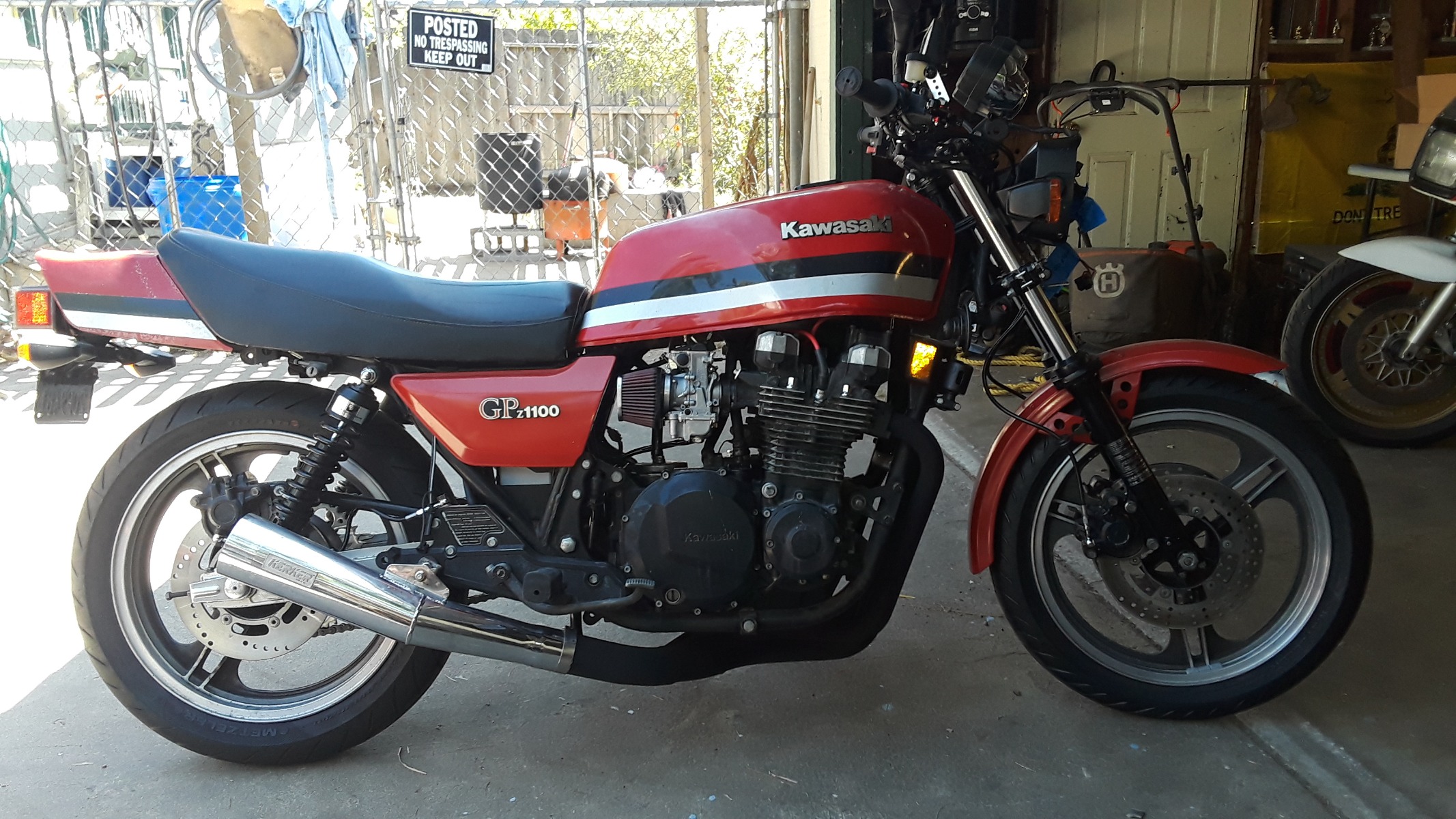

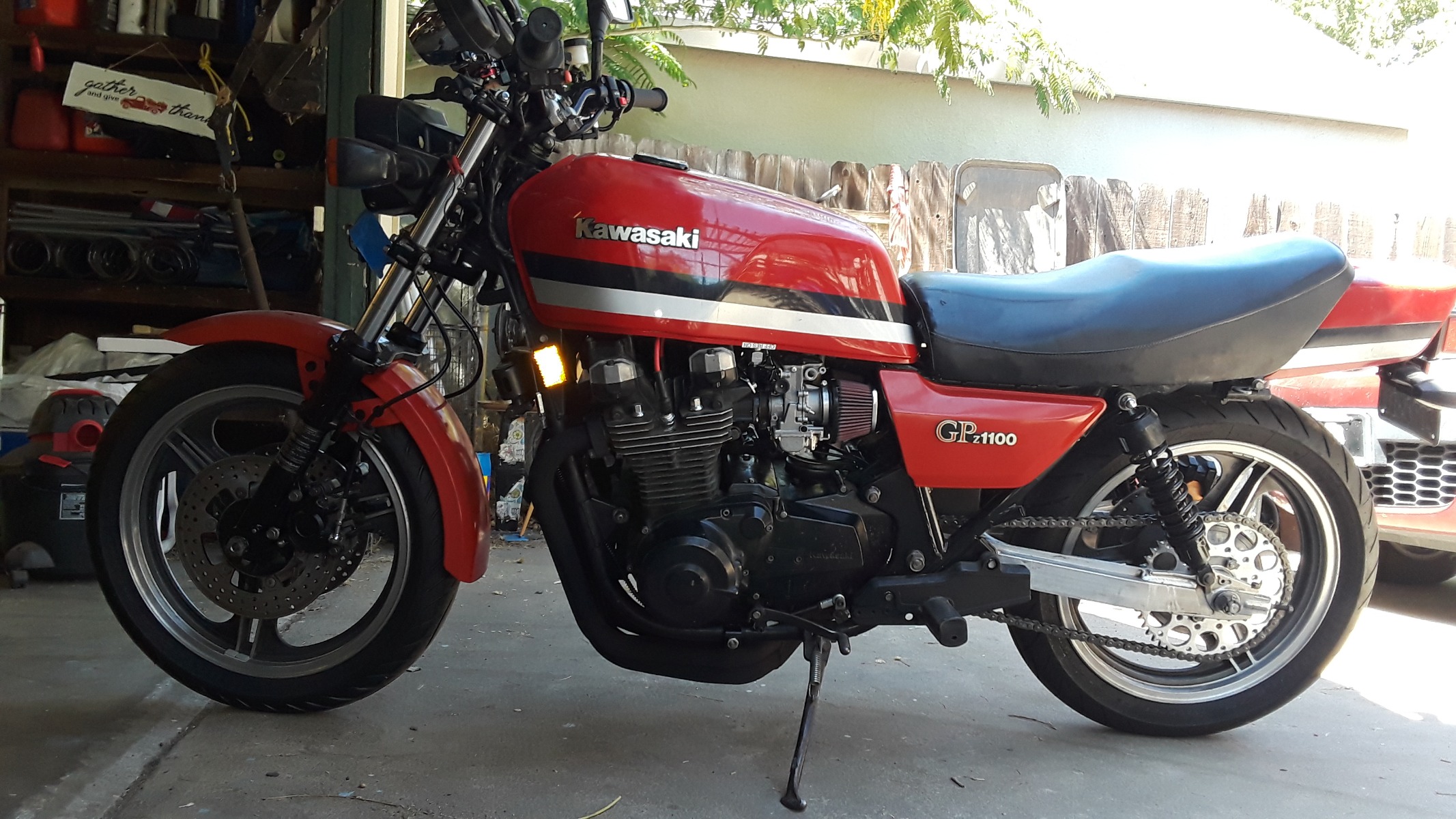

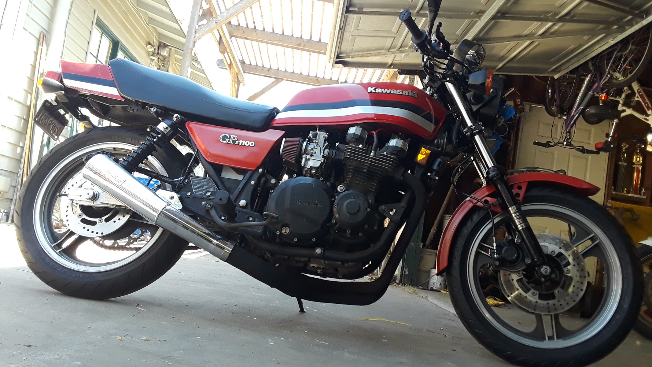

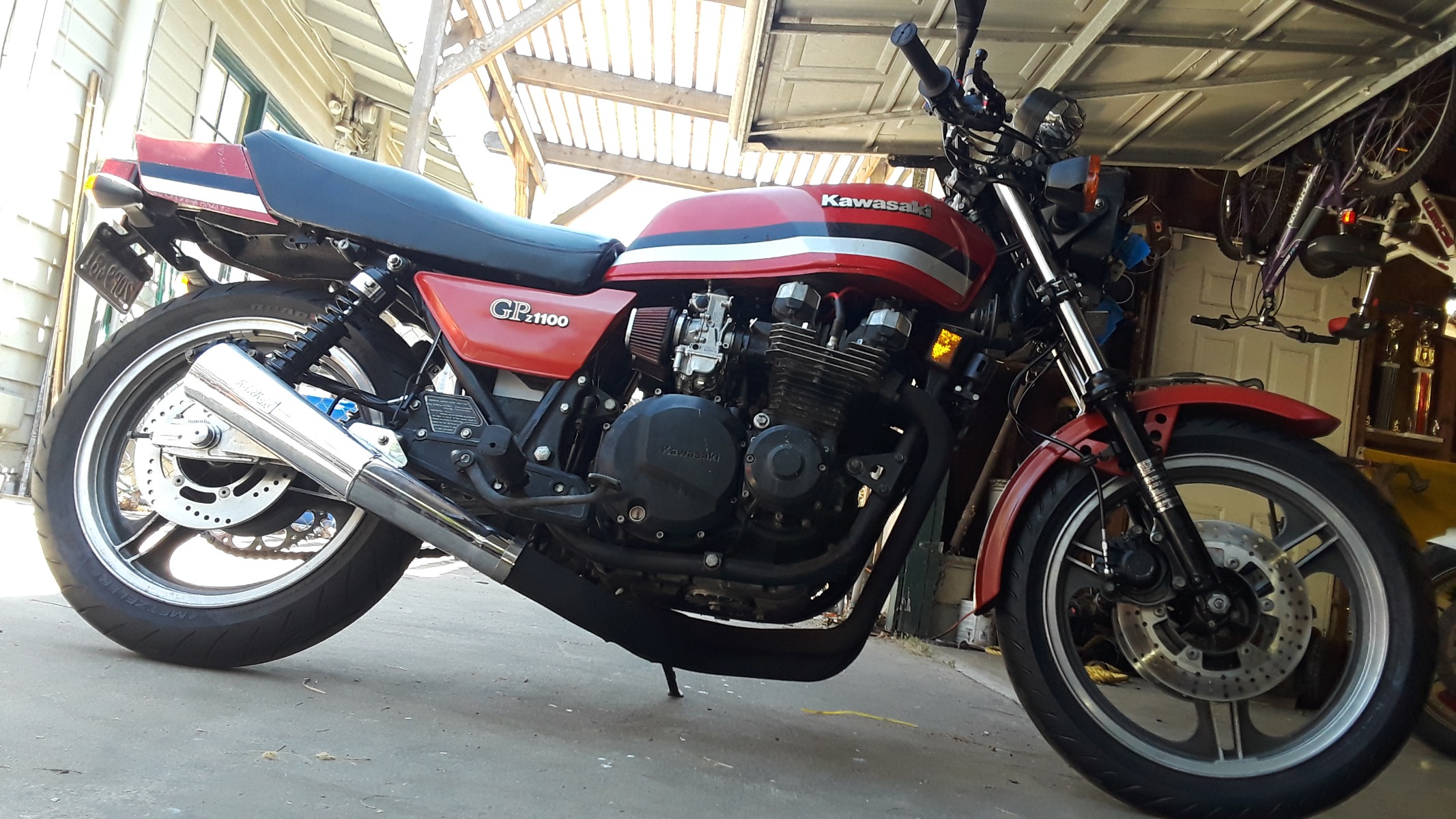

Wow. What a difference in performance from front to back. At this stage of the project, it is back on it's wheels, carbs & intake system installed & time for a first go at the starter button
It started right up & was on a low idle within minutes. The folks at Mikuni know their business when it comes to carburetors. The only adjustment to it was to up the idle just a smidge
The first trip around the block proved very positive. Brakes like it never had before, and pumper carbs are very responsive.
Idiot lights, turn signals and a headlight to complete the project... oh, and Mrs slayer has to deal with the DMV to get her tags

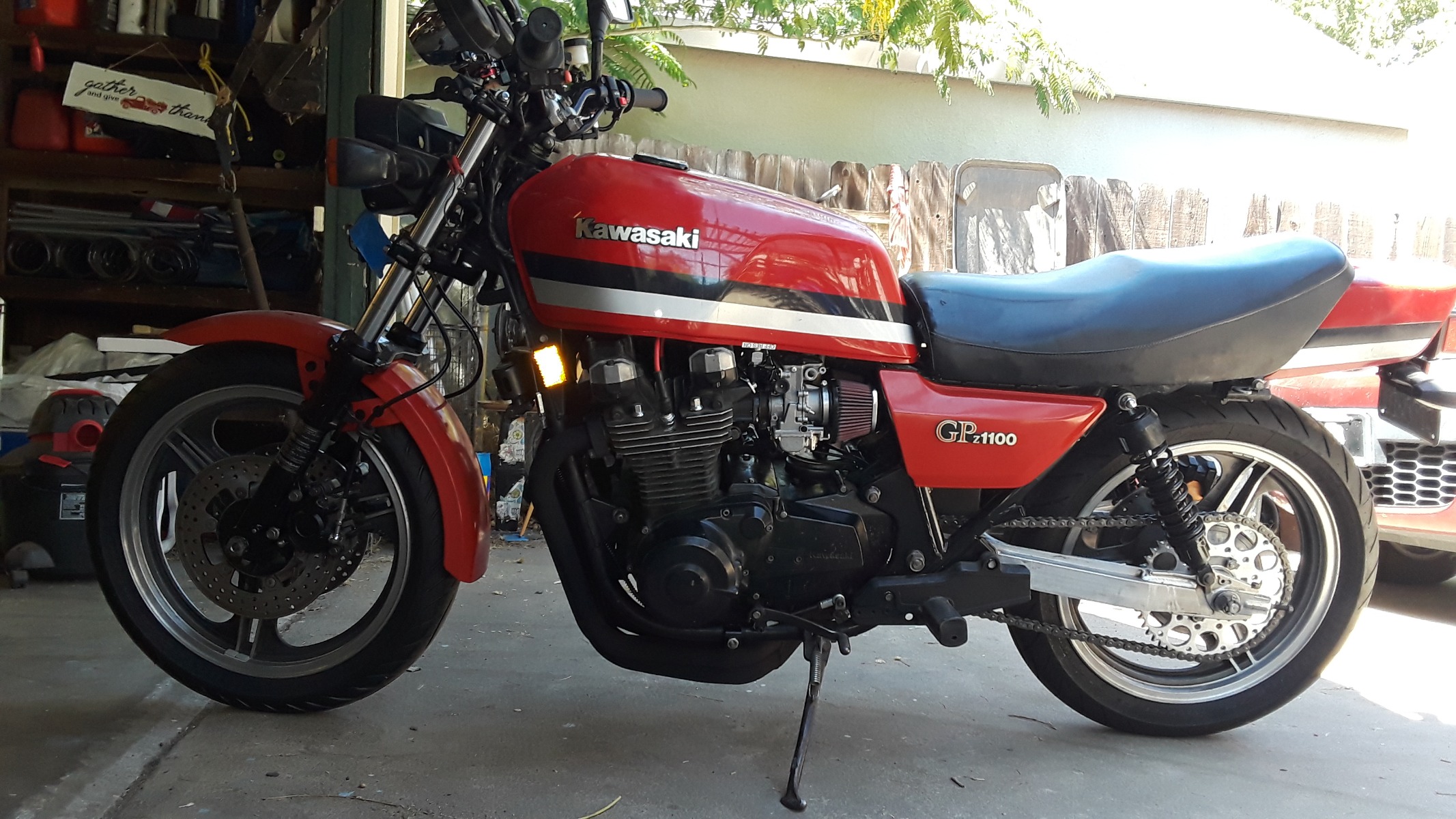

Great job. I’m not a big fan of three spoke mags, but them there look like they belong. Good choice.

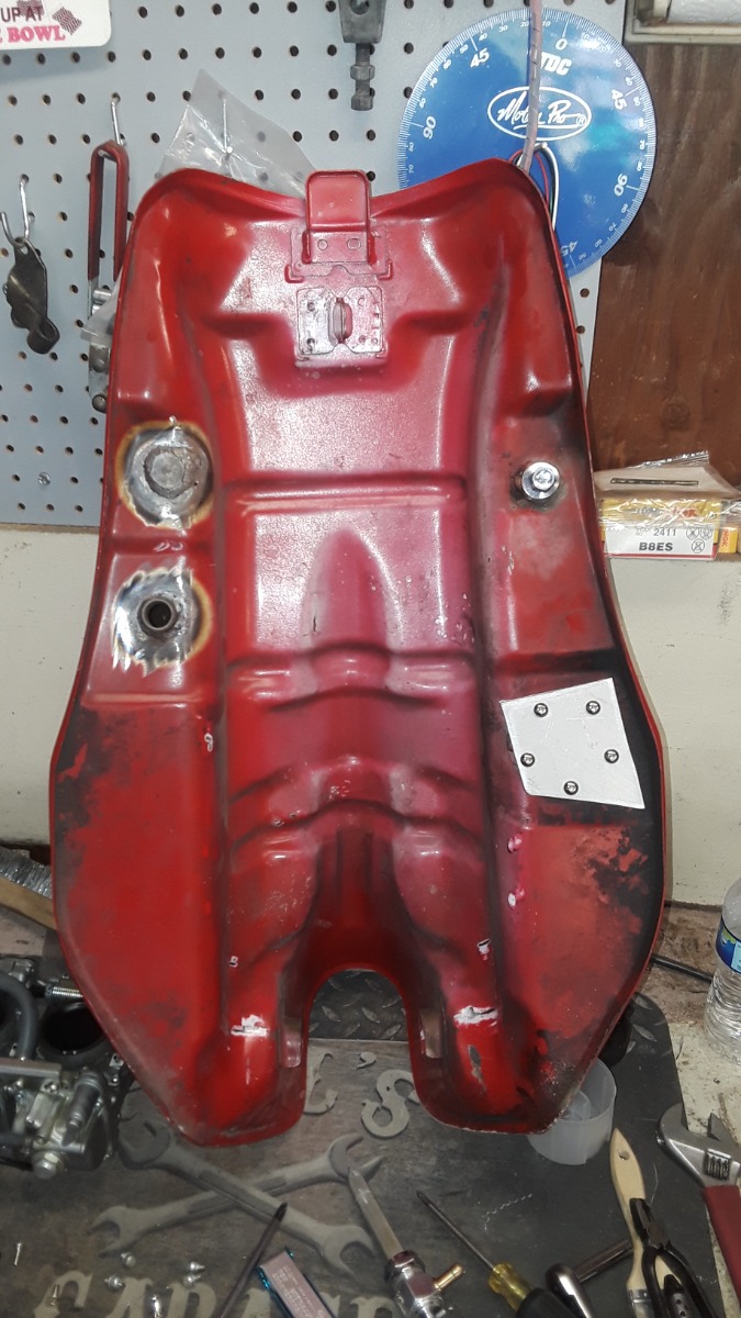

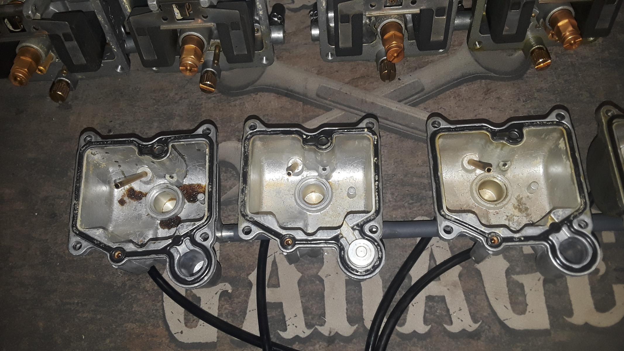

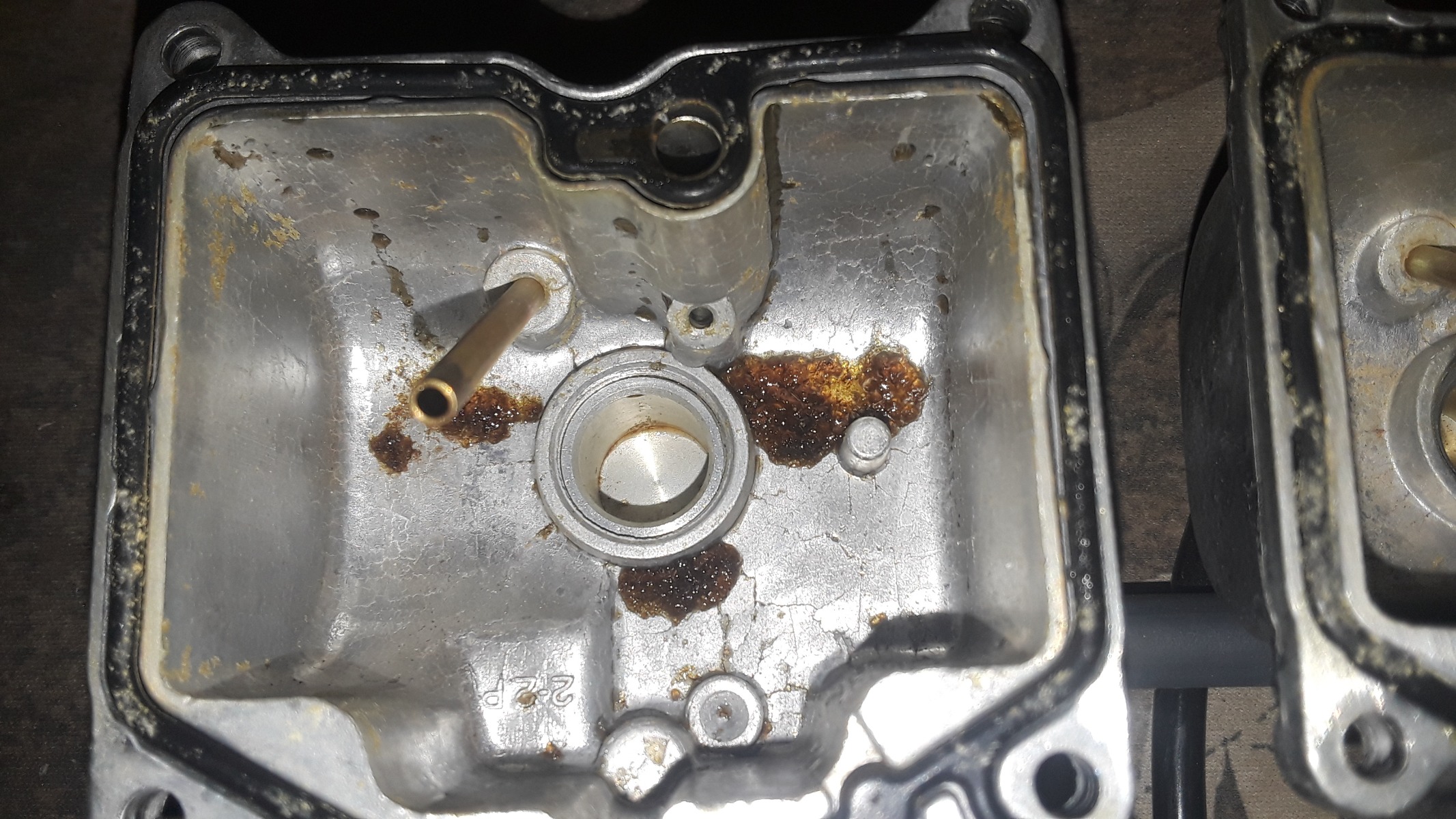

It turns out I have some more cleaning to do on the gas tank. When I recently started it back up again, it didn't have the same response it once had. It only wanted to run on the choke... dammit.
Off with the carbs & float bowls.
Yes Sir. New carbs, new gas and some crap in the bottom of the tank..... so...
Off with the tank and plug the open holes as needed
Then it's off to get vinegar and other crap to clean out the tank with... AAaaarrrgghhh!!

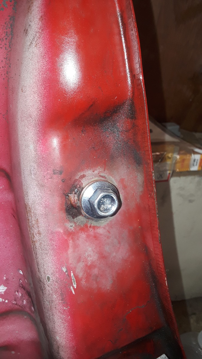

The gas tank was sealed up tight... except for the petcock. I tried using a baggie and a couple layers of electrical/duct tape, but no love. It started to leek after a couple of minutes.
Mrs slayer's amazon account to the rescue. jeff bezos has 4 packs of caps to fit the petcock thread delivered for $12 or some such thing... should be here tonight, and the gas tank cleaning project can continue.

I would not completely seal the tank. Set it upright on the bench in its normal orientation and fill to the top and not close the fuel cap. The couple times I used this technique it was bubbling and I’m sure if sealed would build pressure. Did you toss in a handful of screws into the dry tank and shake shake shake, it’s helps break up the rust.
