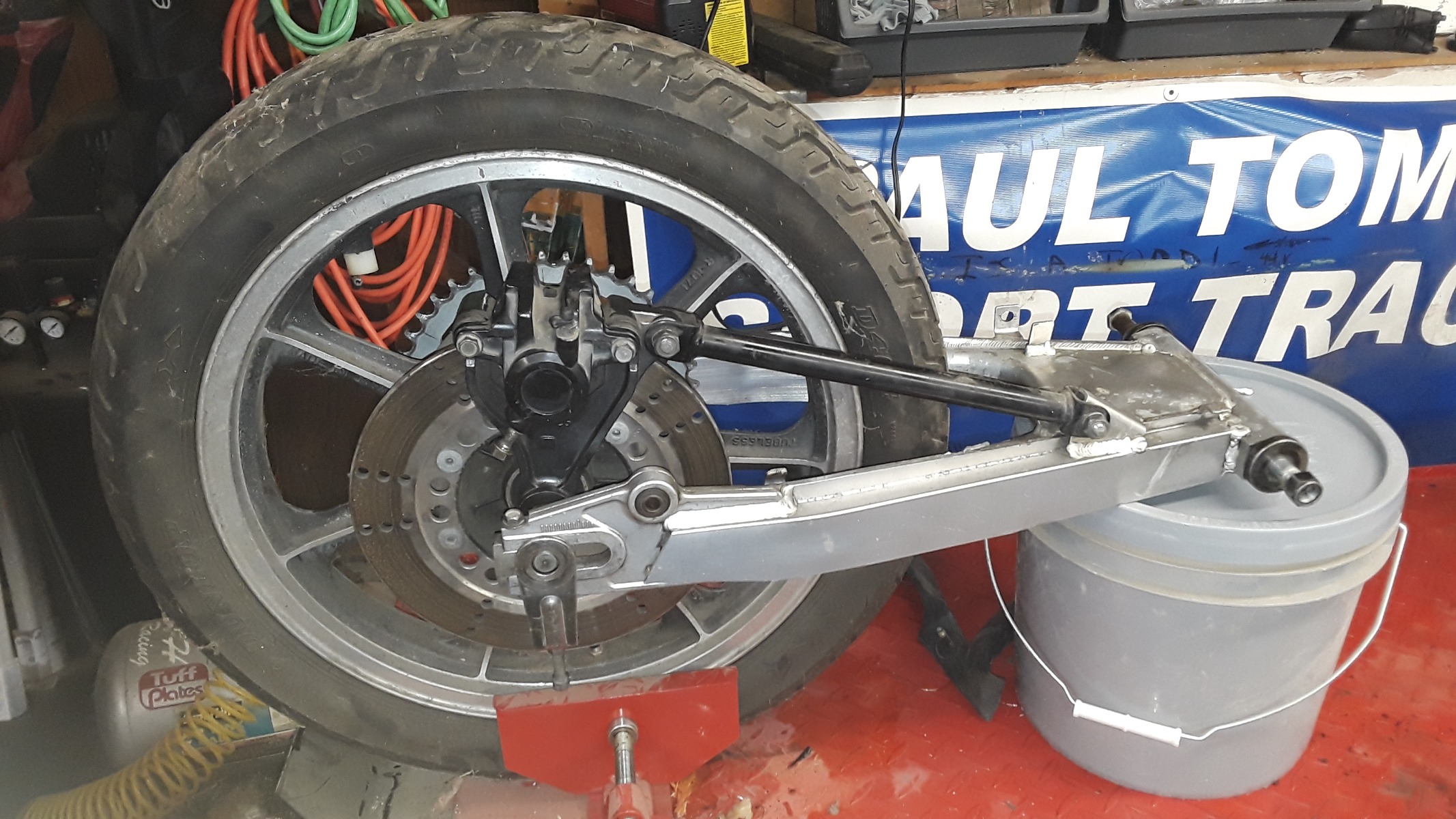

23 Oct 2020 08:15So the longer Suzuki axle arrived last night, it is too big to fit through the wheel! WTH. I thought this was simple bolt-on upgrade?
Whatever... the search continues. Pause to consider... Keep the OEM wheels & put the Suzuki axle in the lathe to trim off a half a millimeter? Or consider other/OEM/Non OEM wheels?? :blink: :dry:

I had that issue with my cafe bike. I purchased new wheel bearings with the correct ID.
Jim

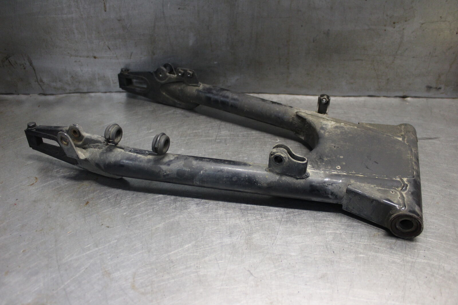

That's one of the many reasons I went to a late KZP swing arm. Still had to fit it and extend the fender.

Replacing the bearings is the easiest way to fix it but I thought the Kawasaki's used the same axle size {20mm}? I don't have my Suzuki swingarm here at the moment but I had a Z1000P rear wheel and i'm sure it fit straight on.... Anyway, just get new bearings, its a cheap fix and you get the piece of mind knowing the bearings are new...

They are indeed both 20mm. ditto for the GSXR axles i recommended. there is something up with your wheel bearings if it wont fit.

Thanks for the input guys. I had the calipers on loan from the reloading bench, out in the garage & found that the KZ axle was .775 inches & the GS axle was .778 inches or some such thing. I buddy is going to put the GS axle in the lathe & take the needed .003" off of it.
Regarding the GSXR axle, Ebay didn't have one at the time I looked & so I went to the GS axle as it was OEM to the swing arm.

26 Oct 2020 07:09DOHC wrote: Did you try the kawasaki axle with the GS arm?
I did. The KZ axle is about an inch shy of working. It is flush with the axle adjuster and no way to get the nut on.

I'm surprised it didn't fit. About 10 years ago I mounted a GS swingarm on an 80 Kz1000 LTD. I don't remember all the details, but I know I didn't need to do anything special with the axle or bearings. I do recall making spacers for the pivot so it fit tight in the frame.
