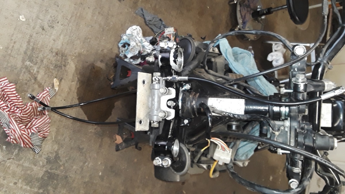

09 Nov 2020 16:12 - 09 Nov 2020 16:15I know this might be a bit late but my Frankinstein GPZ1100 has GPZ900R front end. I used a radial GTR1400 master brake assembly (cheap on ebay) and the brakes are nothing short of incredible, on par with the Yami blue spots (for general road use)slayer61 wrote: I like the idea of the 3 spoke wheels, so I've been scouring fleabay for some "modernish" replacements. Something from the second half of the 80's!
The Swingarm is officially on it's way out, as an aluminum replacement from a Suzuki is inbound from a member on GS Resources.
Brakes will have to wait until I find out exactly what wheels end up on it. I can recommend the 16mm radial brake MC from Braking. I have one on my bike & I like it a lot.
Thanks for letting me share fellas.

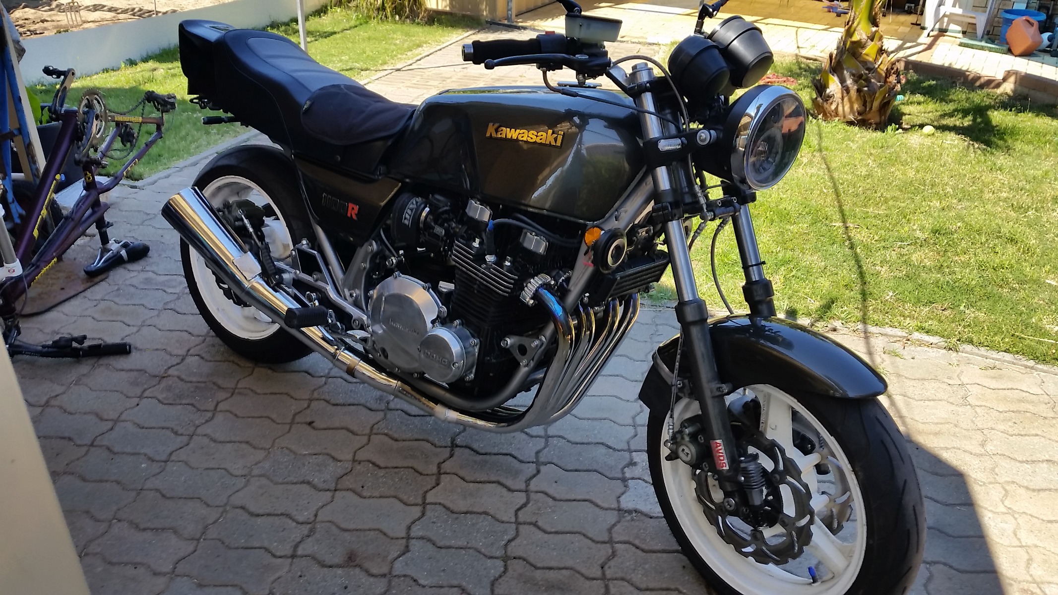

Thanks Bozo, but I'm firmly stuck on 18" wheels. They are difficult to find & not very popular, but that's what I'm after. The OEM forks have all the needed parts for a refurb. It's just shop time now.

If you're stuck on 18's, the 1988 GSXR1100J model {last of the slabbies} has 3 spoke 18x4.5 rear and an 18x 2.75 front, they are a little hard to find but they are out there and would do the job well..

10 Nov 2020 18:50750 R1 wrote: If you're stuck on 18's, the 1988 GSXR1100J model {last of the slabbies} has 3 spoke 18x4.5 rear and an 18x 2.75 front
The '86 and '87 also had 18". The 1100 are 2.75" front and 4.0" rear, and the 750 are 2.5" front and 3.5" rear.

10 Nov 2020 22:18DOHC wrote:750 R1 wrote: If you're stuck on 18's, the 1988 GSXR1100J model {last of the slabbies} has 3 spoke 18x4.5 rear and an 18x 2.75 front
Also, truedisk does excellent work.
Yes, all the early gixxers have 18's but slayer specifically mentioned 3 spoke, and the 1100J is the only one with 3 spoke 18's...

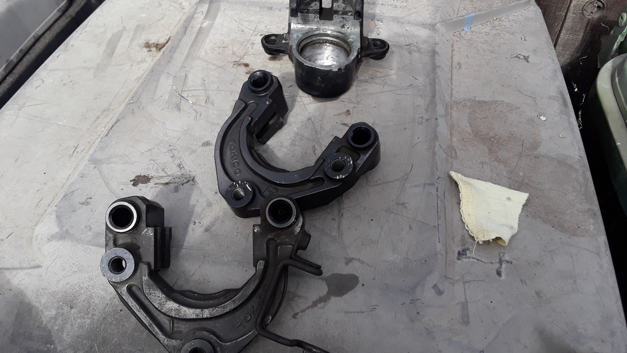

The hunt for suitable wheels continues, but I soldier on with OEM for now. Forks rear wheel/axle handed over to my machinist friend who will refresh the forks & knock up spacers for the rear wheel in the GS swingarm.

Also with an 18in rear is the 1988 Kawasaki ZX10 tomcat 4.5in wide. I have that on my 900 with a 160 tire. (3 spoke)

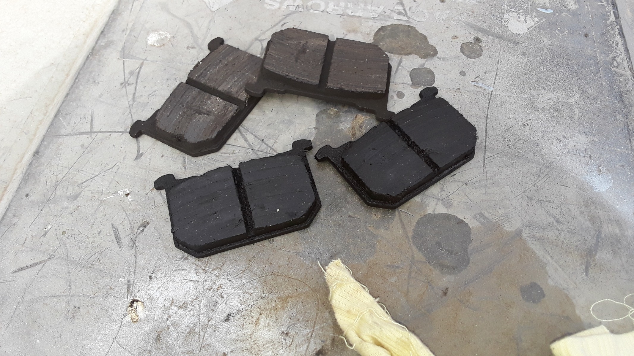

So this morning I placed another order with Partzilla for some more brake bits & bobs. Consumables & such. Ordered brake pads for the GPz & the GSes, also Mrs. slayer liked the radial master cylinder I put on the GS, I ordered one for her bike. She has stubby nubbins for fingers & likes the idea of an adjustable lever
