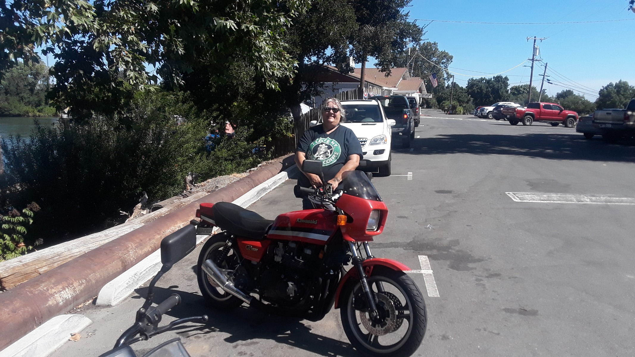

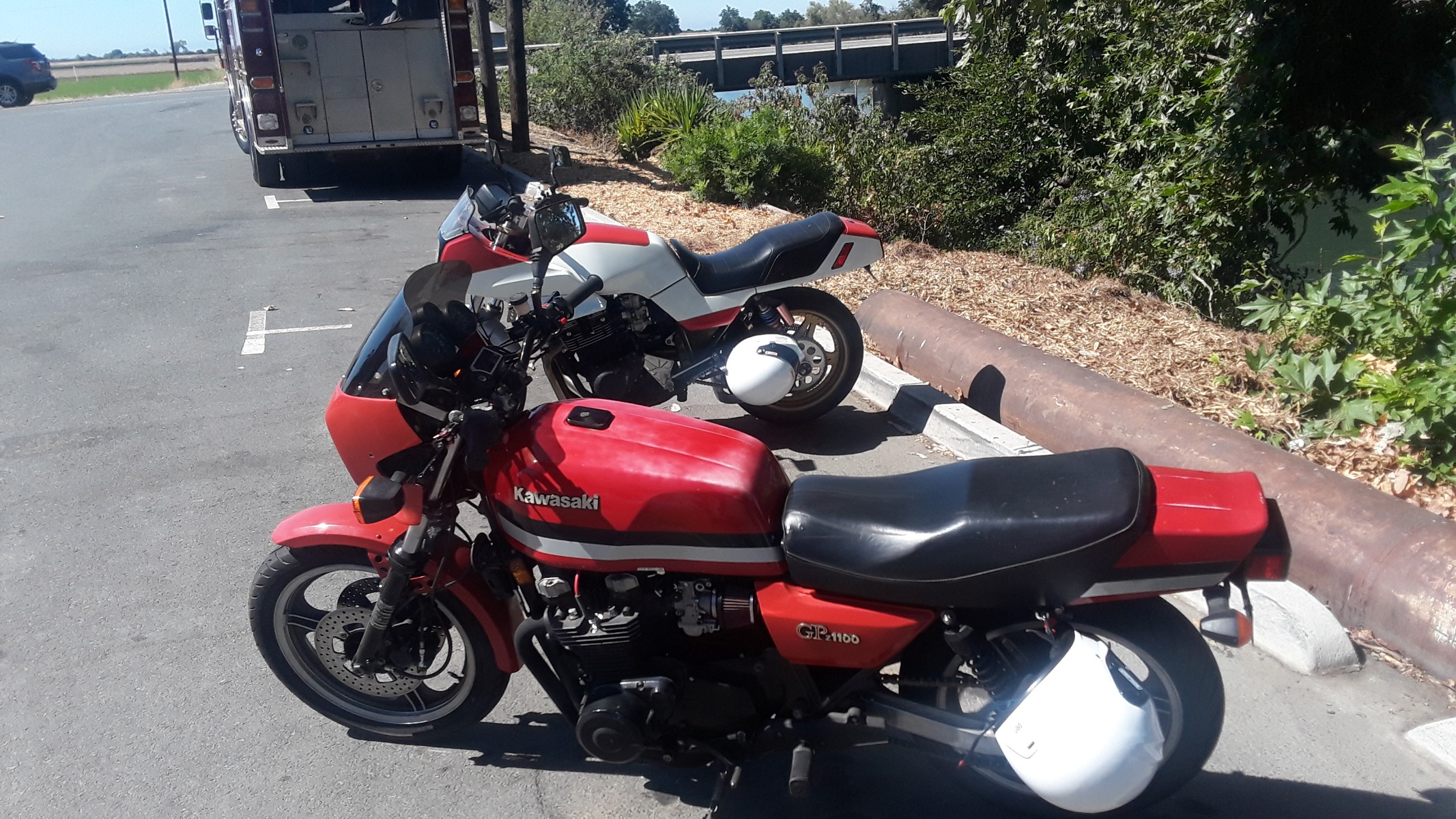

So the maiden voyage of Mrs. slayer's newly refreshed '81 GPz1100 was a success on most every front! After stripping the bike down to the frame I left a few details to be wrapped up:
1). The left side mirror wasn't snugged down properly
2). The shifter lever was a little too low
3). The throttle return spring on the flat slides is too stiff
Ya know? After a complete revamp stem to stern, touching everything except the bottom end of the engine... I'm pretty happy with it. Items 1 & 2 can be solved easily!
Be safe everybody & enjoy riding season!

That is AWESOME! Glad to see you and Mrs. Slayer out on the vintage bikes. You did a great job to have such a short list of adjustments to make. Quite an accomplishment! Kudos to you!

Agreed^^ it turned out awesome! Easiest way i have found to negate the heavier pull of the RS carbs is a smaller diameter pulley on the throttle sleeve. the sacrifice is a longer pull to WOT.
