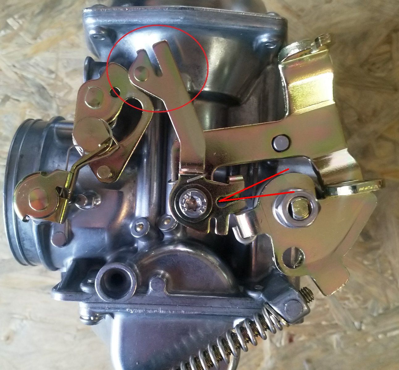

The thing is, it's the bent one that works properly. If yours looks like mine does, then when you put a bit of choke on, nothing will happen. It should be opening the throttle slightly from none to half choke. I assume the cut-outs in the bottom part of the linkage are there to be bent into place, but can't find anything about it.
Page 152 in the manual shows how it is supposed to work.

Yes , you are right. You have to open the cut-out in the bottom part of the linkage.

Thanks. I guess I need to separate the halves again. I don't think I'll be able to get at it from the front.

So I 'fixed' the fast idle - works perfectly now. Replaced the floats with the ones from my spare set as they were in better condition. The levels were OK except for one. I bent the tab a bit and now they are all at 5mm. This is within spec but given the accuracy of the clear tube method they may be between 4.5-5.5mm. Should I worry about this? Is it worth trying to get them all to exactly 4mm?

My fast idle fix wasn't the best - Revs went through the roof with the choke on! Pulled the carbs apart again and bent it back a bit, seems pretty good now (will know for sure when I do a cold start tomorrow).

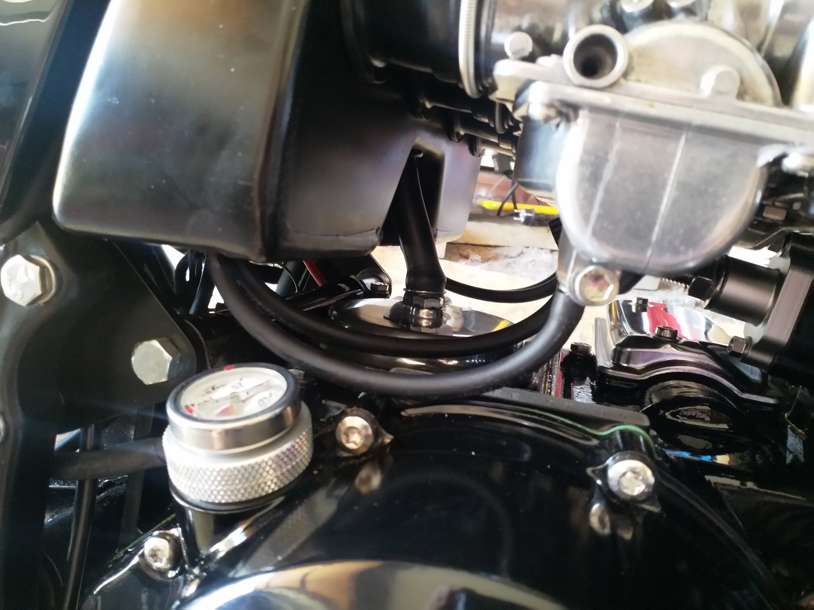

Final bit of work was the overflow tubes for the carbs. They go to the air box and I routed the airbox drain tube down the swing arm so anything that comes out should miss the rear tire, exhaust and brake disc.

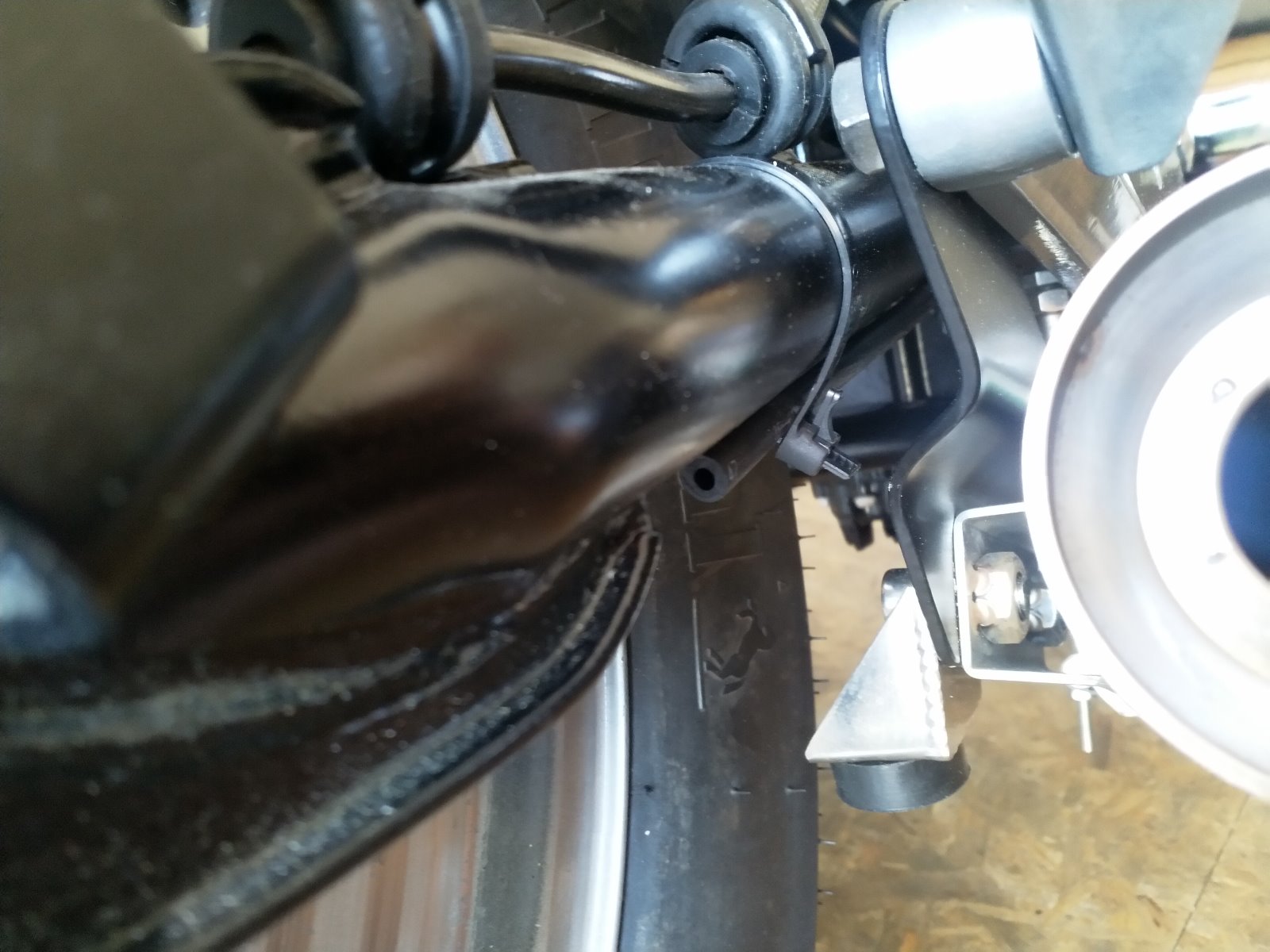

Get yourself a pair of "flush cut" dykes or wire cutters. They are beveled on one side only, and will trim zip ties flush to the housing. No more scratches or cut arms from those sharp tangs hanging off your zip ties. Not that I notice the little things... B)

Skidmark wrote: Get yourself a pair of "flush cut" dykes or wire cutters. They are beveled on one side only, and will trim zip ties flush to the housing. No more scratches or cut arms from those sharp tangs hanging off your zip ties. Not that I notice the little things... B)
Ha :laugh: I hear you - I actually left them like that on purpose so it's easier to get them back on - they're removable zip ties. I may put some permanent ones on but I don't have any wide ones lying around.
Edit: I will be turning the one in the picture around though B)
