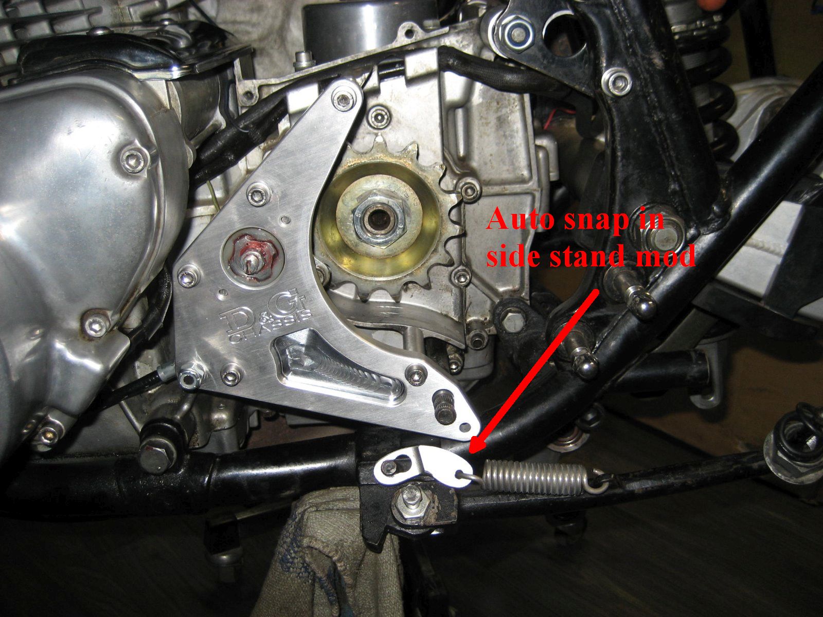

To repley to your probs to the MOT, yes you have to modify your side stand mechanism to snap in if unloaded weight from the ground or do some electric switch lock to interupt the ignition to prevent start up in gear or if the clutch was engage in gear.

Thanks for the picture. Did you machine that plate or is it available to buy somewhere? I am still a bit unsure and may wire in a relay to the 20A fuse output, but getting a switch rigged up will be a bit of a PITA.
Definitely will only wire the main power line to the stand and neutral switch, I'm not running a wire up under the tank to cut off the coils - the harness is done and is not to be touched
