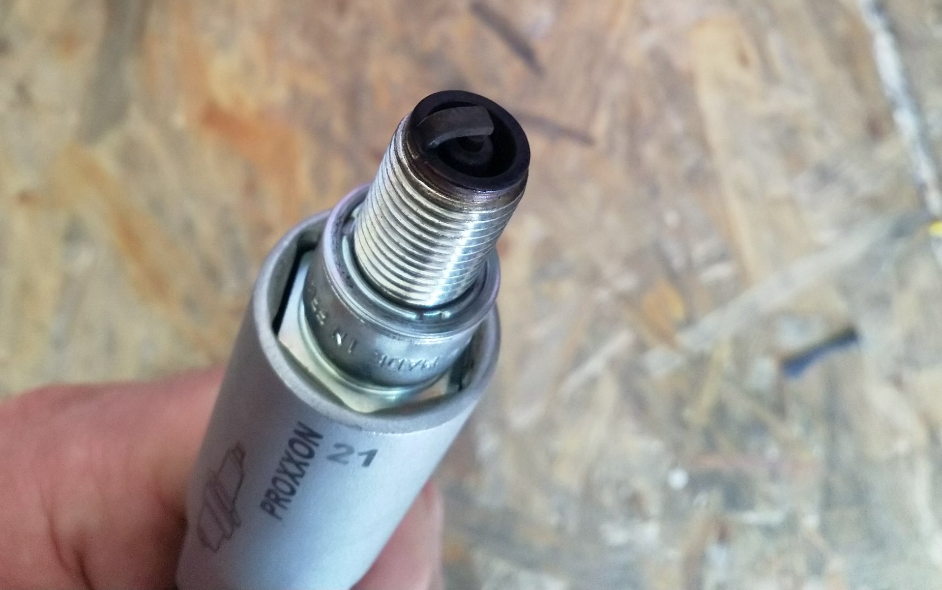

Thanks Ed, that was pretty much what I was thinking/hearing. I checked the idle today with the digital tach, it was about 1300. I attached the tach to the coil -ve instead of winding around the plug lead as I think the sheath was causing some problems last time (it seemed to be missing signals and the values jumped around a lot) - this gave me good stable rpm readings.
The idle screws are another matter, they are giving me a bit of grief
Went for a short ride at 2 1/4 and it felt sluggish under 3000 rpm (was fine above). Checked the plugs afterwards and 3 and 4 were clean, 1 and 2 were as shown below.
I have a funny feeling that I either have a very slight vacuum leak (couldn't find any with wd-40) or one or more of the idle circuits is slightly blocked. All the idle screws were replaced, but three of them have 800km on them and one is new - shouldn't really make a difference, though. Headers are all about the same colour so I have been assuming that all cylinders are generating roughly the same amount of heat. I'll check the temperature next time I go round the block.
I decided to get a colortune plug so I can see what is going on. I don't think I'm going to have any luck with all the idle screws on the same setting and the colortune plug will show me if the idle mixture is correct. If it still hangs a bit then it must be a vacuum leak - or am I missing something?
Anyway, it is more than rideable so first stop is getting an appointment for the MOT. Then I can put a few miles on her before I start obsessing over this
