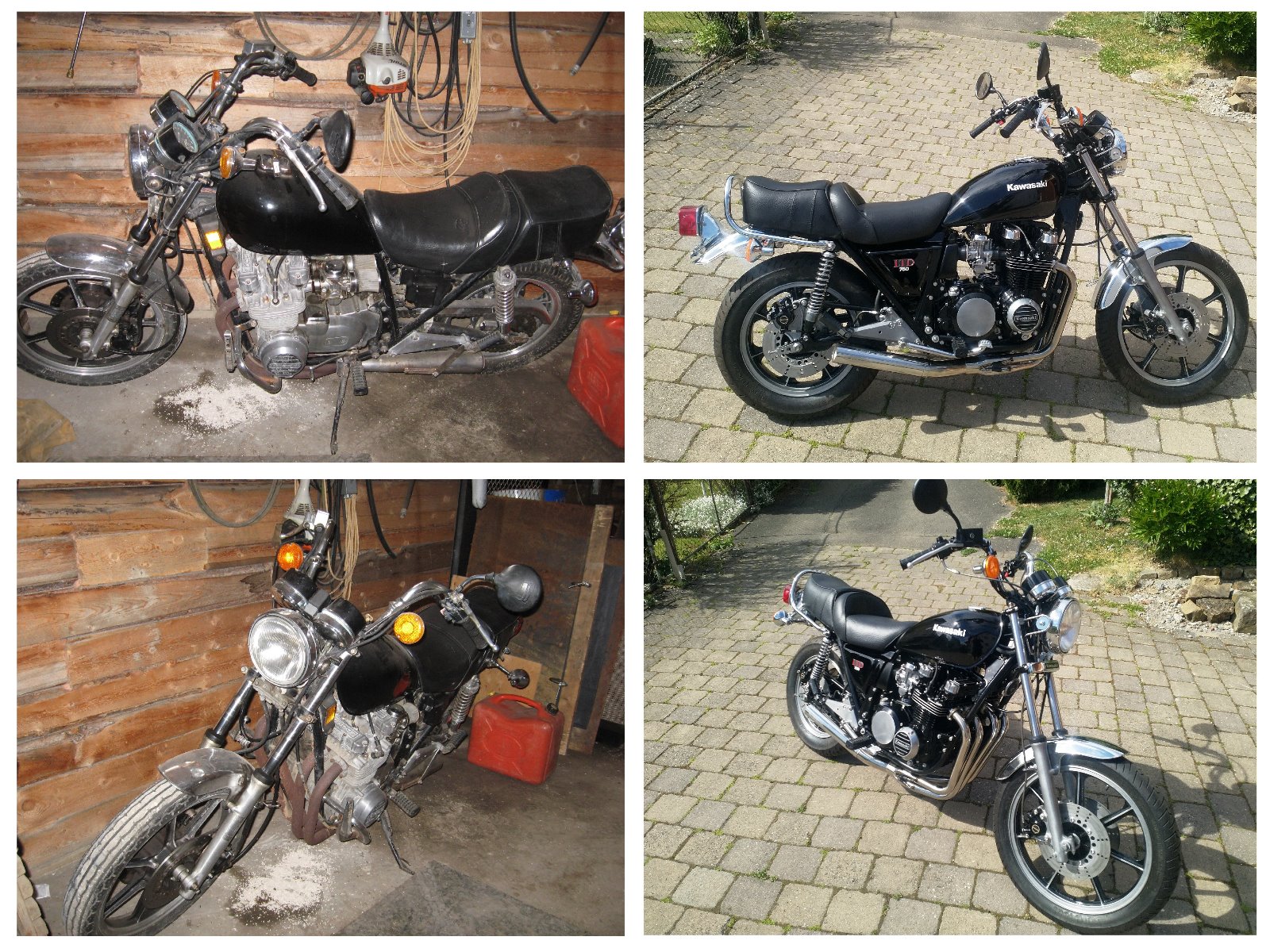

I was just going to post, “finish this beauty so it can be suggested for BOM”. You beat me to it. Nice job!
- hammmy
- Posts: 13
- Thanks: 2
Re: KZ750H Restoration
03 May 2020 12:25 - 03 May 2020 12:26
That blacked-out engine looks so good with those highlight fins and polished covers! I am tempted to do the same to my H1 although my aesthetic sense says it would be even better suited to a non-LTD variant. I'm a big fan of the Honda CB700SC so the black engine combined with a sporty, or in the case of the 'base' KZ muscular, stance just rings my bells.
Your paintwork is amazing. Do you have a background in it? I see that you rented space so I assume it's not your day job.
Is it just me or do the LTDs look the best from behind, where you can see those gauges and the bighorn bars just begging you to vault on and go?
03 May 2020 13:15
Thanks guys!
@Mikaw: I'll be heading out next week to take some more pics, then I'll send some off to Dave
@hammmy: Original plan was to keep the aluminium engine, but the crankcase had taken a beating up front and it would have been hell to keep clean. That's why I opted for the 750E paintwork. Quite happy with how it turned out, especially like the combination of the engine paint and the jet black tank.
No background in painting, only painted a couple of parts before this project. TBH I'm amazed how well it all turned out! Really surprised myself.
03 May 2020 14:25 - 03 May 2020 14:25
That bike must be REALLY happy that you bought it because you made it look much better! Nice work! Ed
04 May 2020 11:50 - 04 May 2020 15:01
As my goal was to get this bike as close to original as possible (or rather reasonable with respect to taste, riding, maintenance), I thought I'd record the non-original parts etc. on the finished bike.
Non-original parts:
Replica Parts:
Changes:
Damage/Missing stuff:
Everything else is original except for maybe the cams - still haven't been able to confirm that.
I originally thought the engine paint combined with the exhaust would be a little out of sync with the Ltd style. As hammmy said, it is more of a sporty look. However, whenever I'm standing next to the bike with a big grin plastered all over my face, it is the furthest thing from my mind :laugh:
Non-original parts:
- The shocks are from Hagon. The style is in line with the rest of the bike and the shocks and fork springs were never going to be original (don't want to ride on 40 year old suspension!).
- The Delkevic exhaust was the best option I could find when I was looking at the start of the project. I still haven't found a decent exhaust here in Germany and I definitely wanted stainless or chrome pipes and not black ones. Still wondering about the megaphone option from Delkevic but quite happy with it as is. The bike had an aftermarket 4 in 1 on it when I got it.
- NGK plug caps and Dyna coils (the original coils died on me as can be read a couple of pages back).
- A lot of the connectors on the wiring harness I made are econseal connectors. I only used the original ones in the headlight housing as space was tight. All the wiring is correctly coloured.
Replica Parts:
- Headlight (the housing is still original, but the headlight is aftermarket).
- Tail/brake light
- Indicators (surprisingly hard to find these - most of the replica ones are the 650 version with the bigger lenses).
- Rear indicator mounts.
- Shift lever.
Changes:
- Seat was reupholstered in the same style as when I got the bike. This was more of a cost thing and I personally quite like it.
- No pinstripes on the tank as I couldn't find the original colours.
- Engine has the 750E paint scheme as I didn't want to be permanently trying to keep the crankcase clean behind the headers.
- Speedo and tacho bezels are black instead of aquamarine (really don't like the aquamarine for some reason).
- The stripes got sanded off the airbox as I quite like the look of it (like the airbox covers found on other models). If the stripes weren't so chewed up I may have kept them.
- The fork emblem is from an 81 model - the '80 one is black (I think...)
- Tank has a huge dent that has been 'expertly' bogged by me
- Left the side reflectors off as I'm not prepared to pay $100 for some NOS ones.
- Text on the ignition is missing as it was almost gone so it got painted over. Haven't found a decent decal for it yet.
04 May 2020 20:54 - 04 May 2020 20:54
No criticism intended! I have the original look and it's such a mishmash of polished chrome, dull aluminum and yellowed lacquer that it is a disservice to its original aesthetic. I think you chose correctly.
What does your father think of how the restoration turned out?
05 May 2020 01:45 - 05 May 2020 01:49No worries, it was just the exact same thing I was thinking as I was making the decision on the paint and exhaust.hammmy wrote: No criticism intended!
Thanks, it's always good to hear this on a major (irreversible) decisionhammmy wrote: I think you chose correctly.
For the record, the old man is impressed and thinks I should be looking for the next project. My wife respectfully disagrees :laugh: :laugh:
