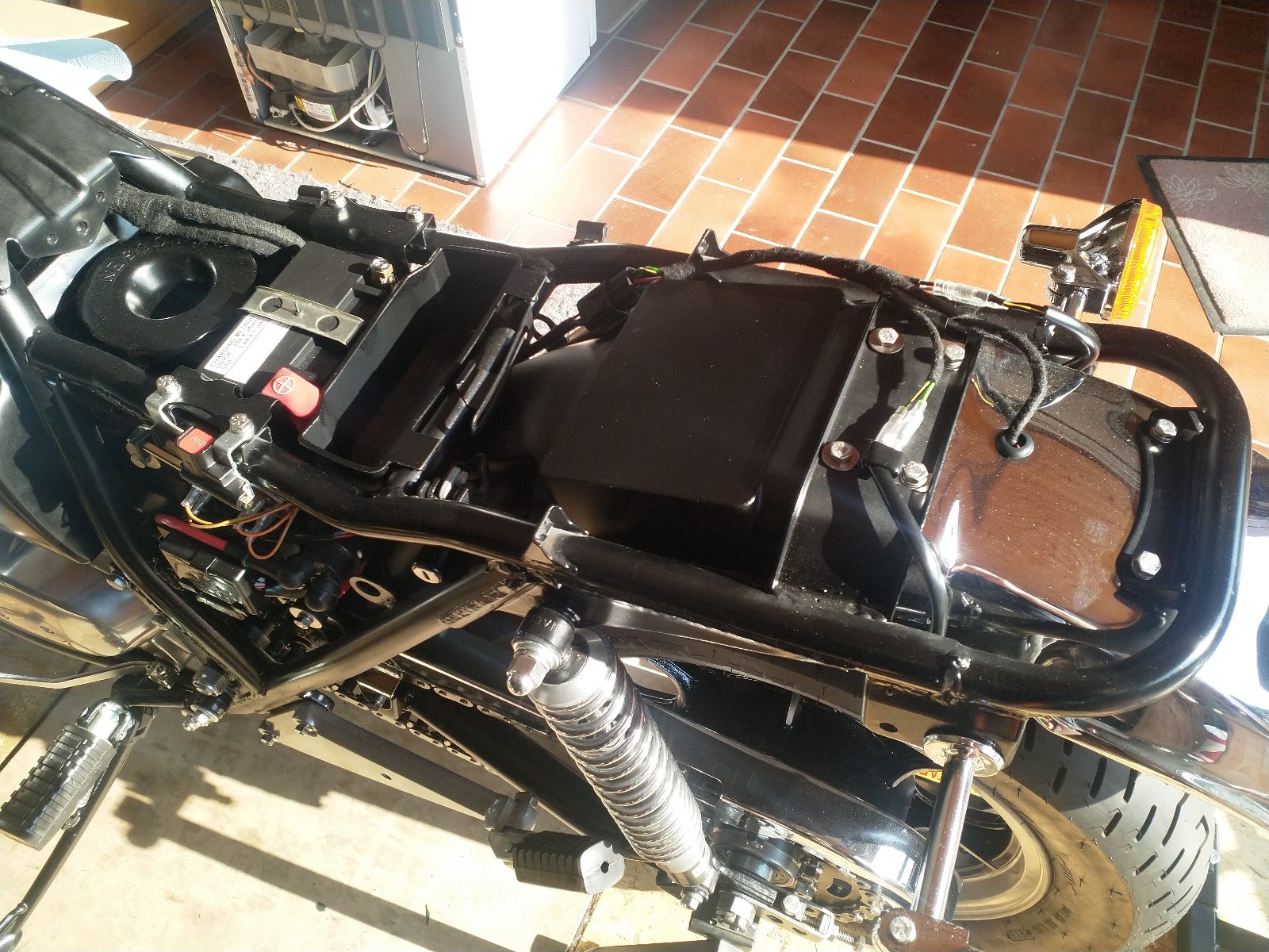

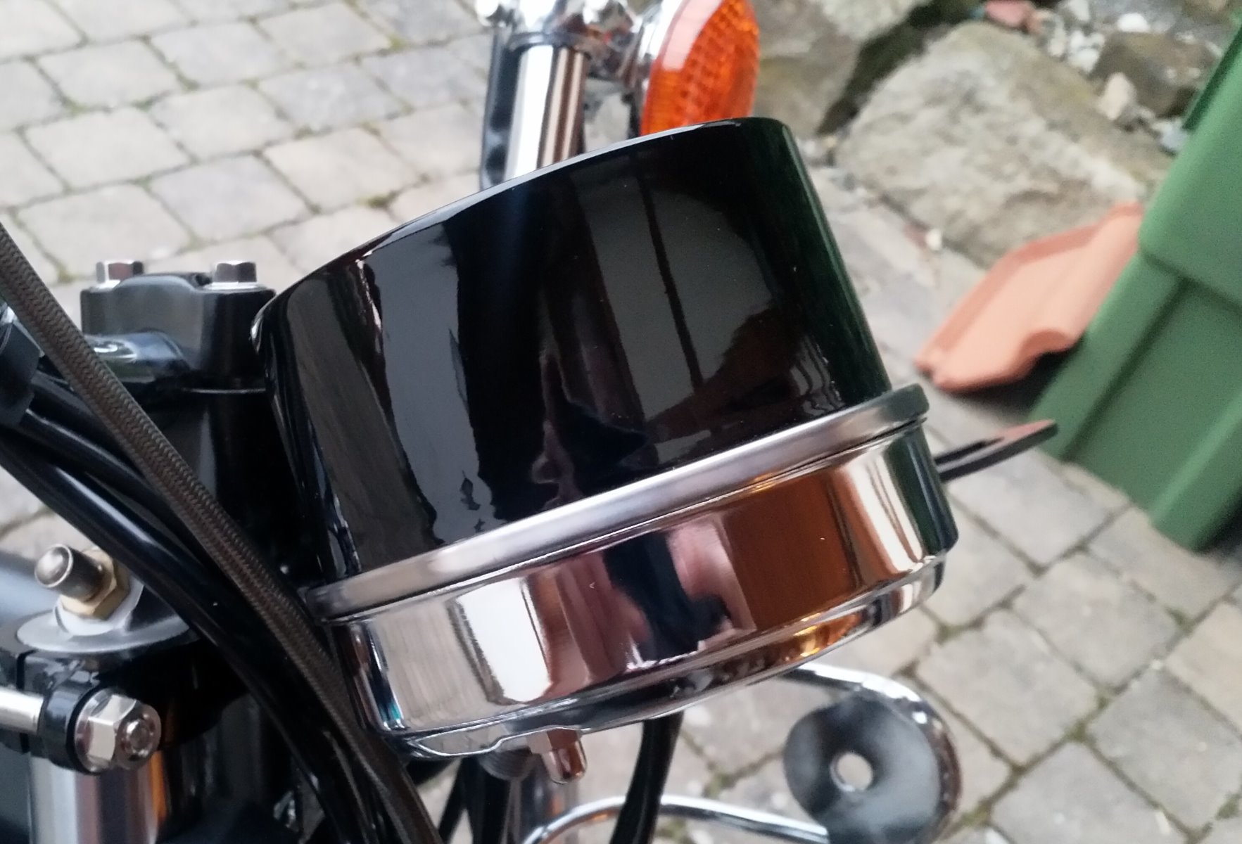

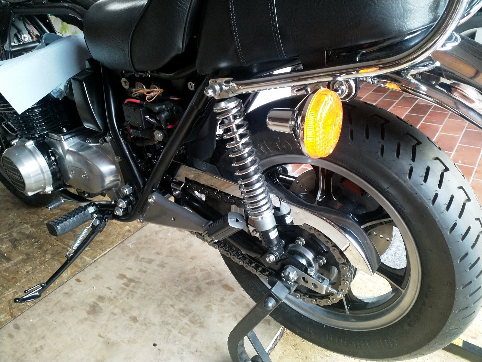

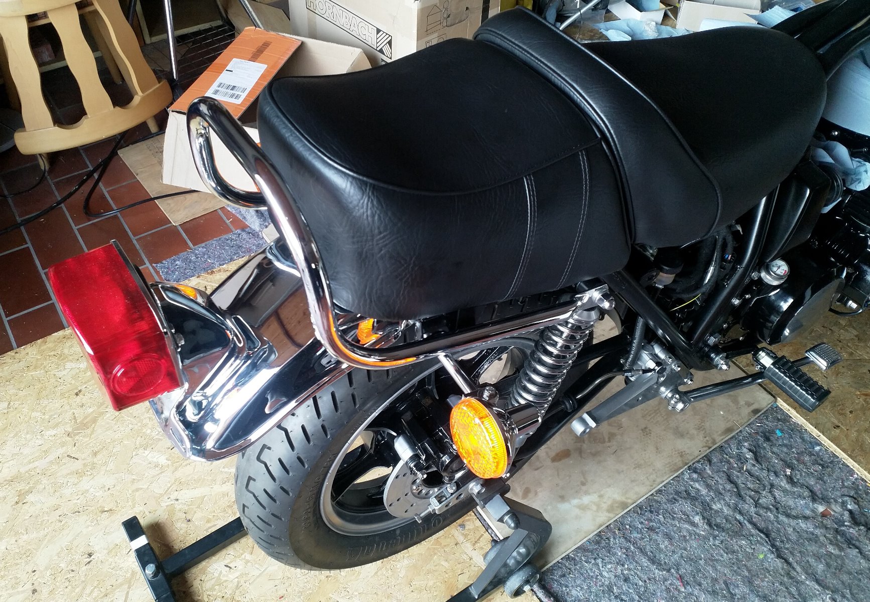

Did a bit more painting today. Got the speedo/tacho housings done and the clear coat on the control housings. Tried to do the side covers but am having real problems with contamination on one of them. It seems no matter how much I sand and clean I still get bubbles in the paint. Did another lot of sanding tonight and covered it in rattle can filler. Will sand it back and keep coating it until it's covered in the filler, then I'll have another go with the 2k base coat.
Got the grab rail, chain guard and pillion seat on as well. Rear mudguard and tool box have had a coat of paint recently too (cause that's what everybody looks at :dry: ). The front seat is just sitting on the frame in the picture - I still need to mount it properly.

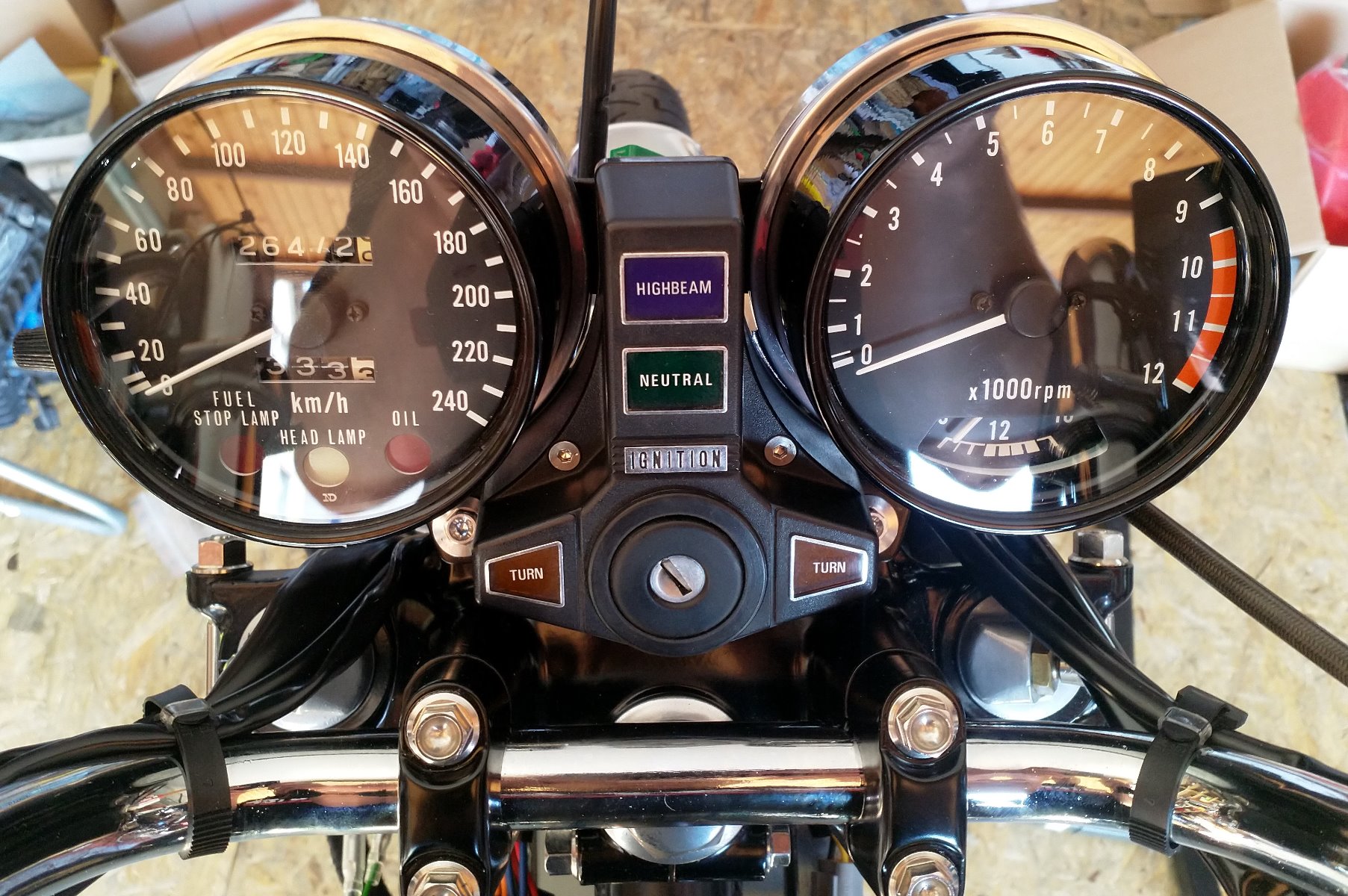

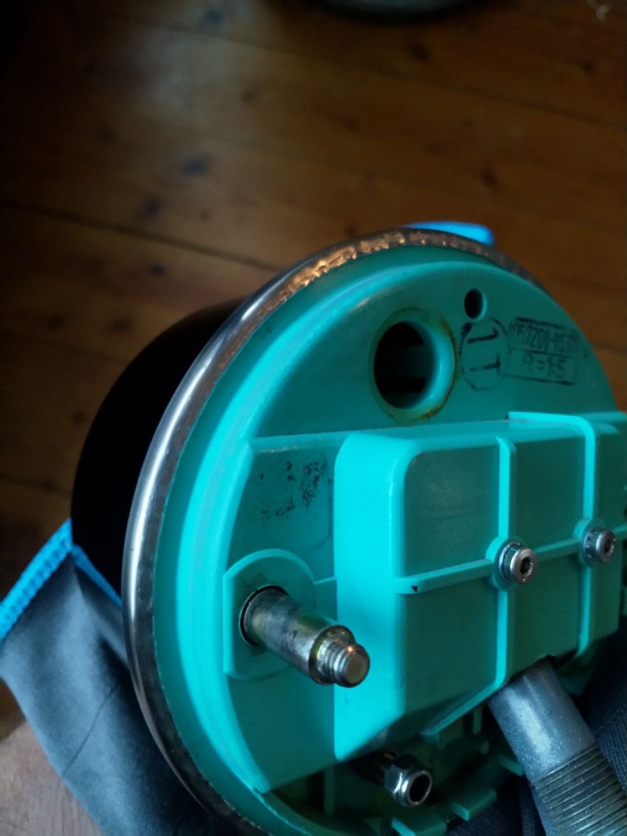

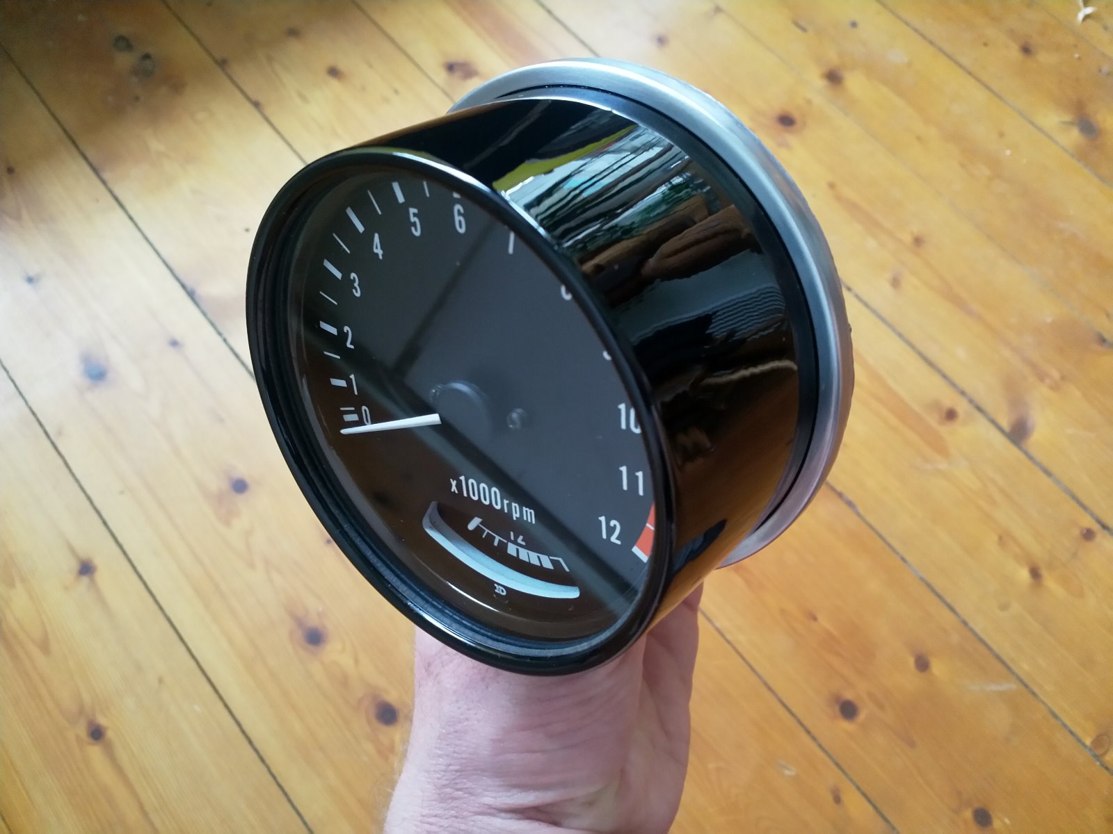

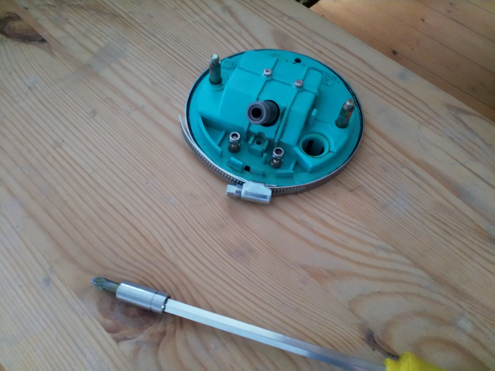

Put the tacho back together today to see how it looks. Still need to crimp the ring (have a board with a 105 mm hole and a large hose clamp - we'll see how that goes tomorrow). Speedo still needs a bit of cleaning (100 m rings are pretty yellow).
Realised last night that I completely forgot the actual switches when I clear coated the switch blocks, another job for tomorrow.

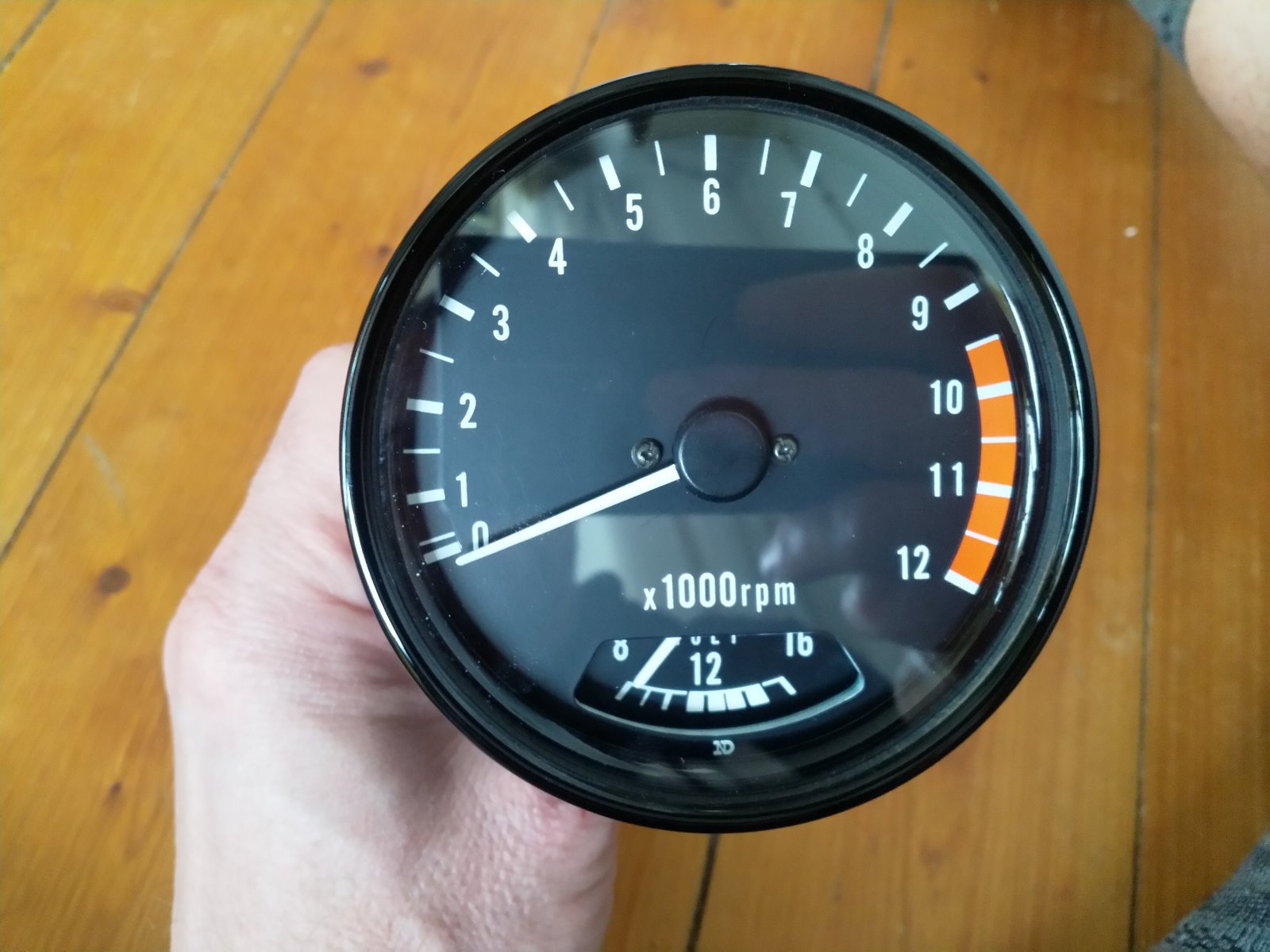

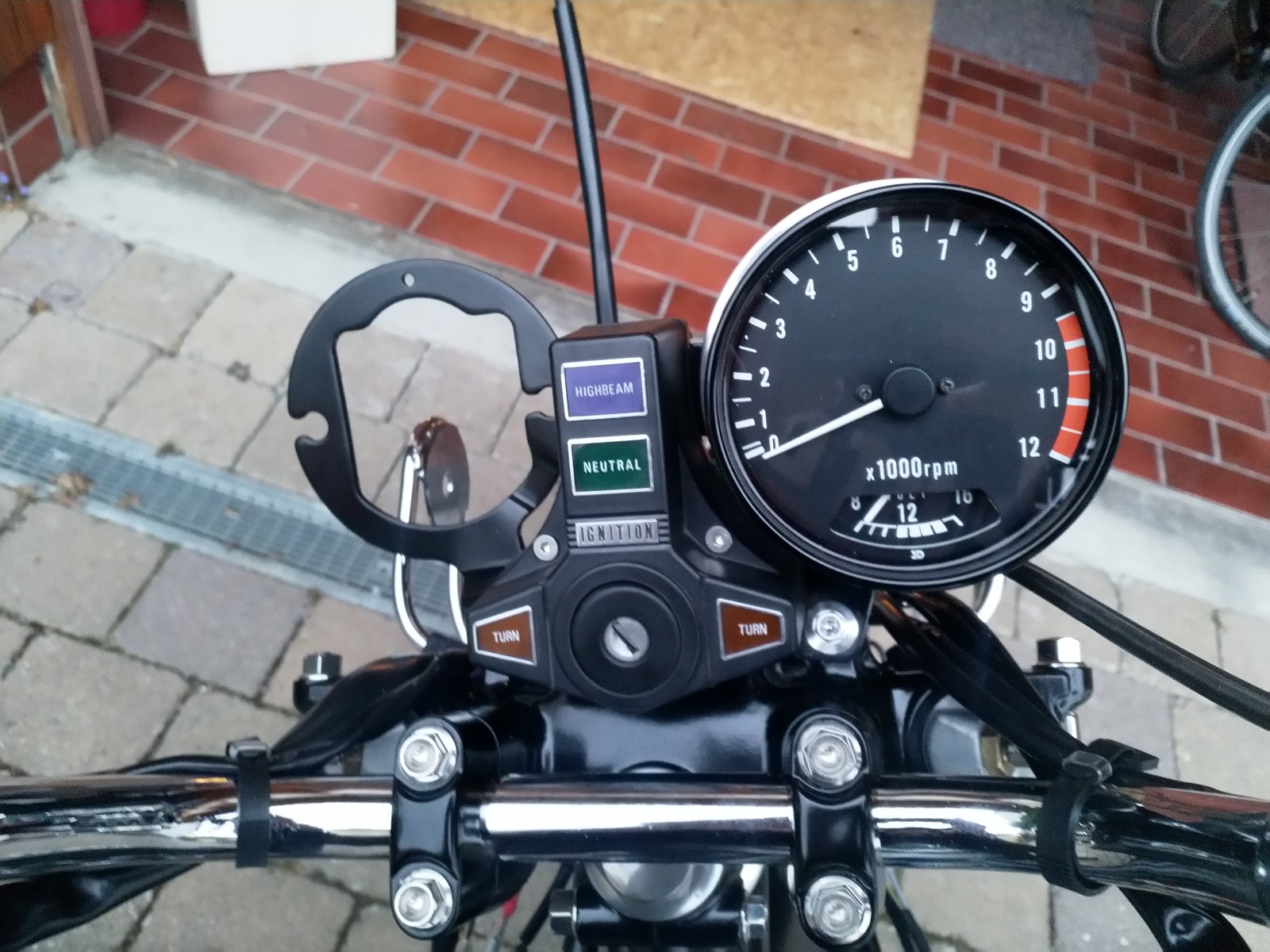

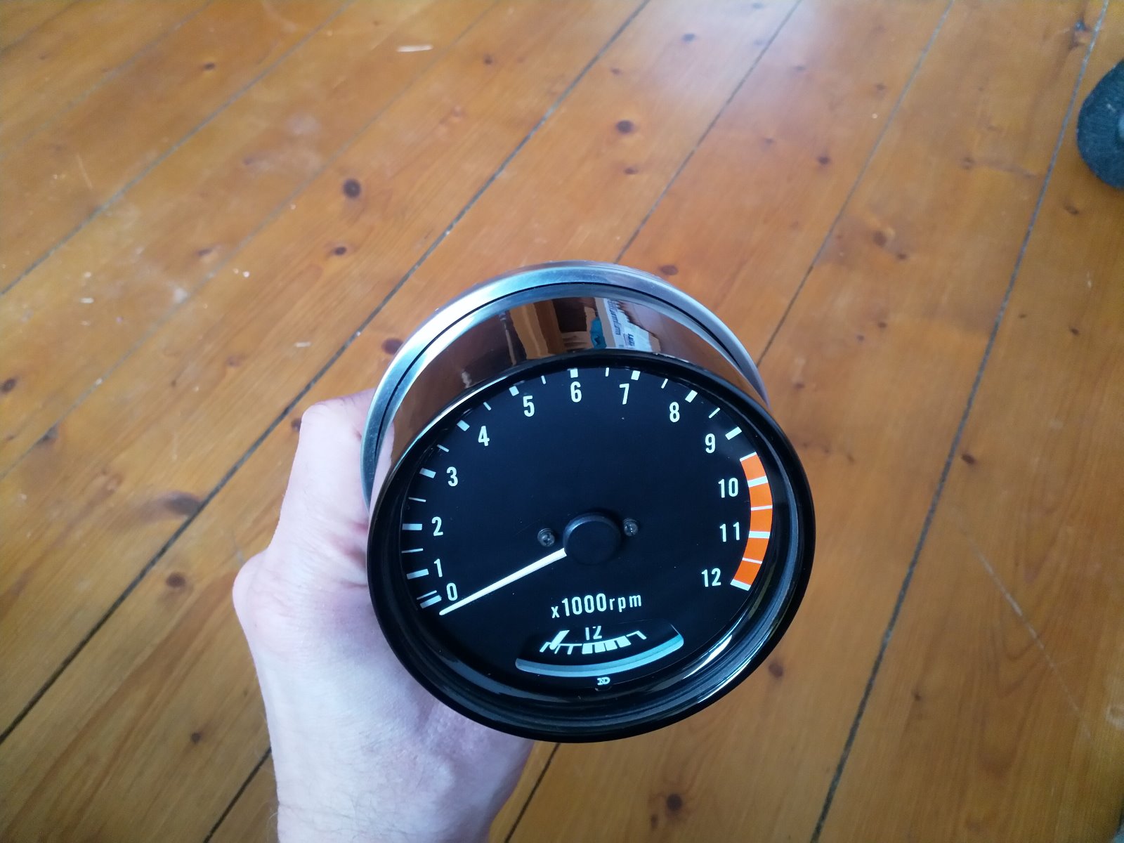

Decided to get the tacho finished. Used pliers with tape on the ends to start the crimp (the entire housing was also masked up). Then stuck the whole thing in a 105mm hole in a board I had lying around. Hose clamp around the crimp ring and finished it off with a small drift.
I wonder how long the speck of dust at 2700rpm is going to annoy me
I cleaned the glass and the face so I assume that got dislodged when using the drift on the crimp ring. Hopefully it'll fall off over summer
The rev count will be slightly off, too. I thought I put the needle back to the exact same position as before but looking at this picture I guess I messed it up. Only about 100-150rpm and I'm not even sure it was properly calibrated, so no biggie - except when they do the noise test for the exhaust at 5000rpm
