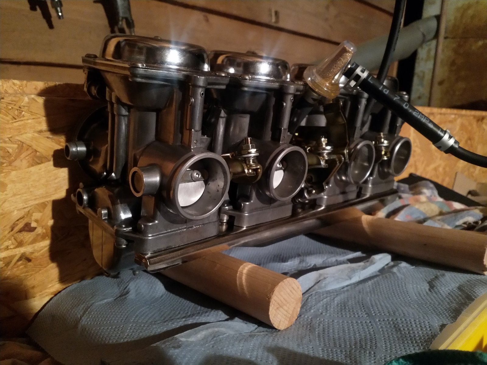

Swapped the leaky float bowls out with some from the spare set today. Set them aside so I can repair them when the brass tubing gets here. Hooked them up to an auxiliary tank and stuck them on the workbench in the carport so I can keep an eye on them. Five hours later and the paper towel underneath the float bowls is still bone dry. Ran my finger over the end of the drain nipples and all but one were dry - just got a tiny bit of gas from float bowl #1, just enough so I could see it glistening on my finger.
Will leave them overnight but they should be fine. Will put them back on the bike and check the drain tubes periodically, but at that rate the fuel will evaporate before a drop can form. Next time I pull the carbs I can swap it out with a newly repaired float bowl.

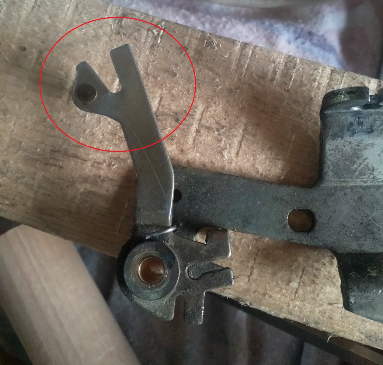

So, got the leaks all sorted by swapping out the leaky float bowls. As I said, I'll fix the overflow tubes and put them in the spares box.
Was about to put the carbs back on the bike and thought I'd double check the float level beforehand. They were way out (3-4 mm too high). Strange, as I was pretty careful when I checked them before, only thing I can think of is I may have had a brain fart and turned the tap off on the auxiliary tank when the bowls were full. That would mean that the float bowls wouldn't have been topped up after the measuring tube was filled with gas. This would give me a low reading.

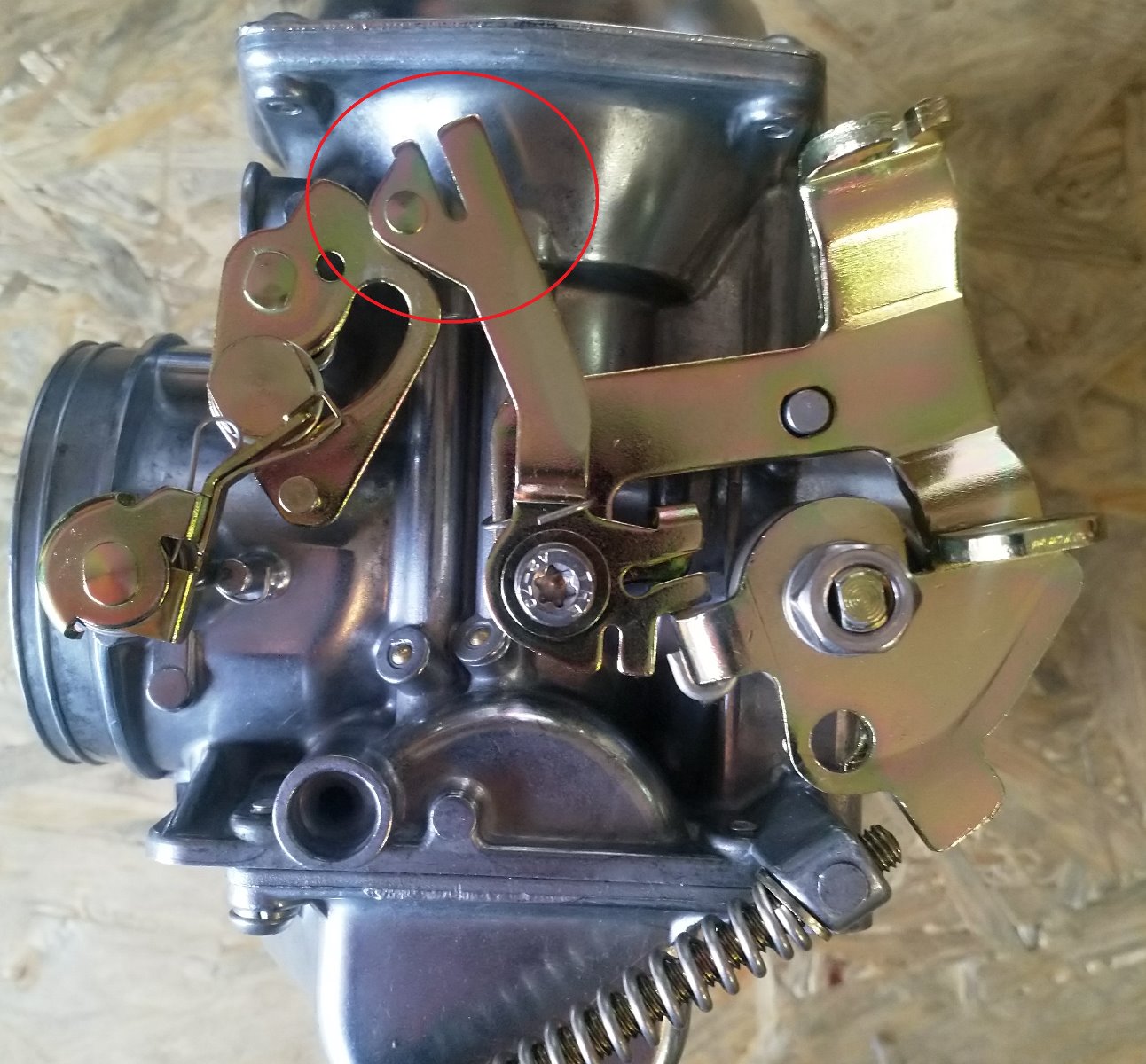

Another thing I have been curious about is the fast idle function on the Keihins. Basically, when you start applying choke, the throttle will be cracked open by the linkage on carb #2. This isn't working on my carbs but works on the spare set. I had a look at the linkage on both and it looks like someone has been bending stuff. Is this the normal 'adjustment'? If anything I'd have thought the other end should be bent (the part resting on the throttle pulley).
Here's the linkage from the spare set:
And here's the current situation:

Mine looks like the second picture (less the pretty plating!). What comes to my mind is how the part got bent. Linkage binding and force applied? Or someone else had meddled with it? Needs to be fixed, for sure.
