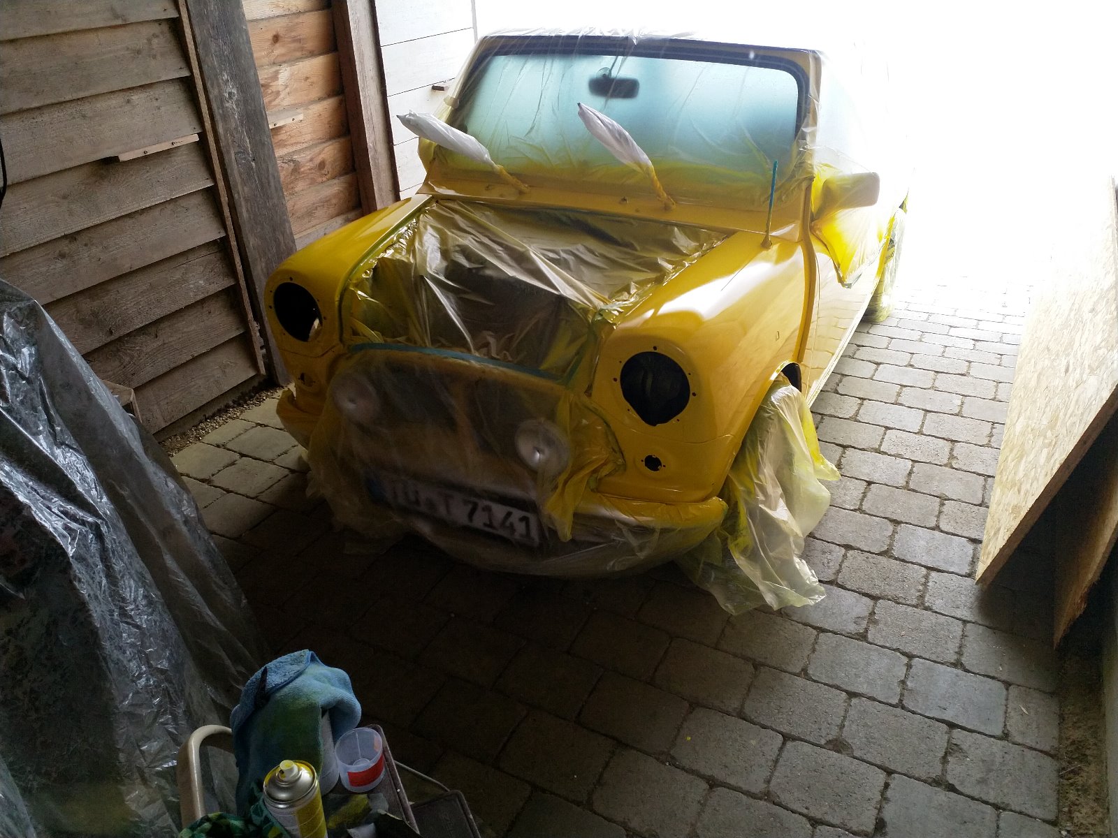

In other news, the gearbox on the mini has been rebuilt and I took care of the rust as well. Should be back on the road on Monday.

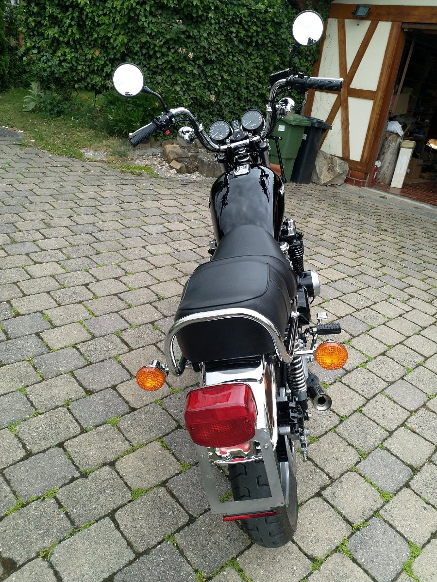

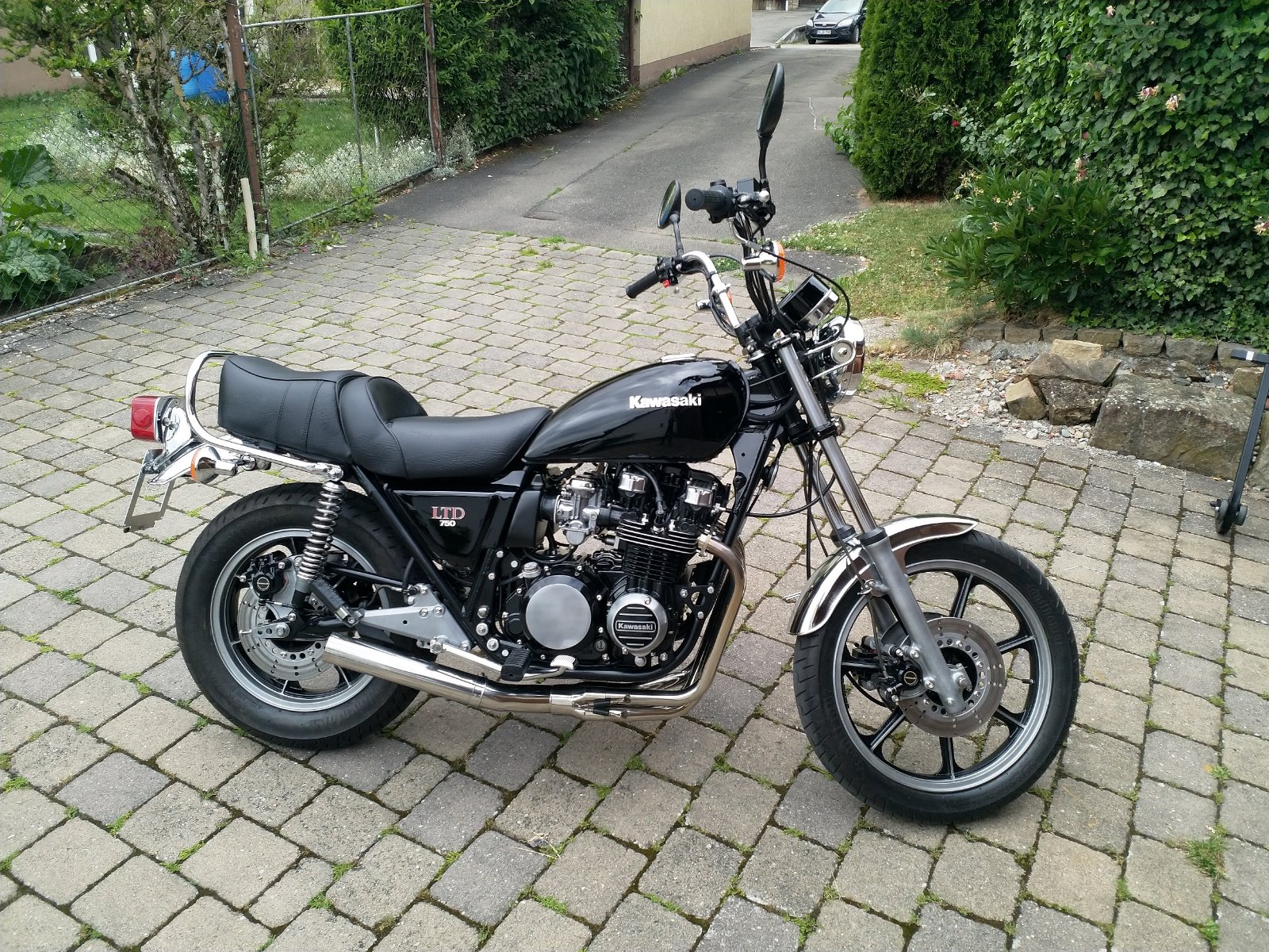

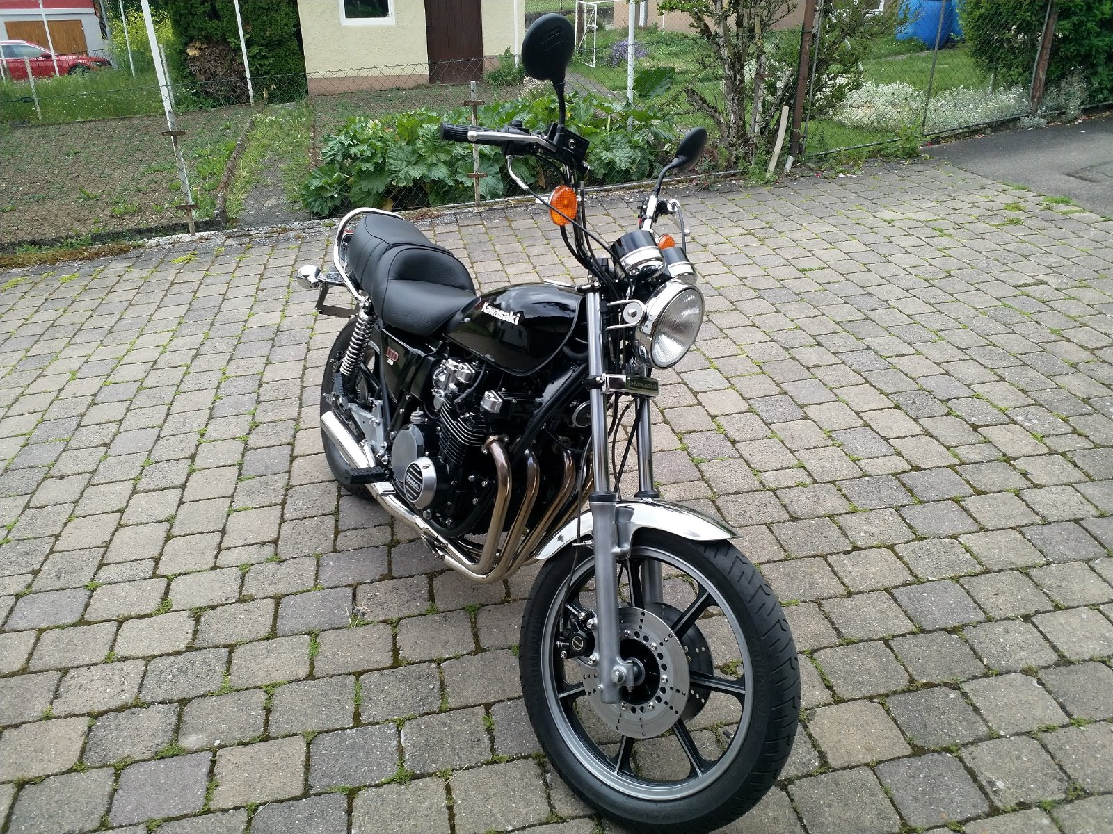

Put on some new bars today.
I originally wanted to ride out the season on the stack bars and see if I got used to the handling at low speeds (they are really narrow). In the end, however, German bureaucracy forced my hand.
[long-winded explanation]
Here in Germany almost all modifications to a bike require some form of paperwork (I even have papers for the footrests on my Hornet). There are a few different options:
- The manufacturer provides paperwork for your specific model and year (you need to carry this with you when you ride).
- The manufacturer provides a general "this is for a motorbike" piece of paper and you need to take the bike to a testing station, get it approved and then get it entered in the registration papers.
- No paperwork and you need a full test and then get it entered into the registration papers.
All the bars that came into question fell into the second category. If I mount them now I can get them approved at no extra cost when the bike gets tested next week. If not, it'll cost me about €50-60 next year (and a trip to the testing station and the DMV). I figured I can always switch back to stock, although having put the new bars on that seems unlikely.
[/long-winded explanation]
The new bars are almost exactly the same size as the old ones, just turned up and out. Made routing the wiring etc. easy as everything was the right length. You can also see the new license plate bracket in the photos. I got this laser cut as that little red reflector at the bottom is compulsory in Germany :pinch:

Thanks, they wouldn't leave enough room for the German plates, though. They are 180 x 200 mm (the same size as the rest of the bracket in the photos).

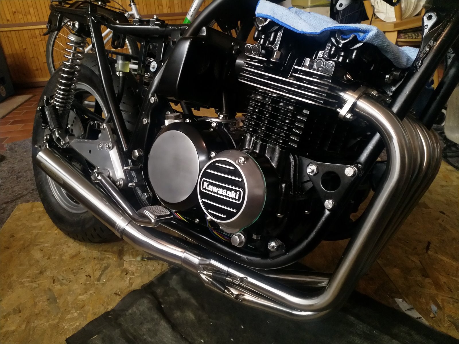

How close does your exhaust system tuck up to the sump? Looks pretty close in the video.
- calum
- Posts: 1144
- Thanks: 415
Re: KZ750H Restoration
06 Jun 2020 00:44 - 06 Jun 2020 00:45
Yeah, running a lot better with the new coils and a bit of work with the colortune plug (still my favourite tool for someone without a lot of experience with carbs).
Exhaust hugs the frame pretty tight, probably best seen in the photo below (don't have any pics of the oil pan clearance). I can still get the filter out easily and I can get the oil pan off and back on if I use a spanner instead of a socket on the right hand side (did this once and never again - easier to just remove the exhaust).

Is that the Delkivic header?
Retired gearhead
'81 KZ-750 E2
'81 KZ-750 E2
- calum
- Posts: 1144
- Thanks: 415
06 Jun 2020 09:16
Yeah, it's the Delkevic with the classic straight muffler:
