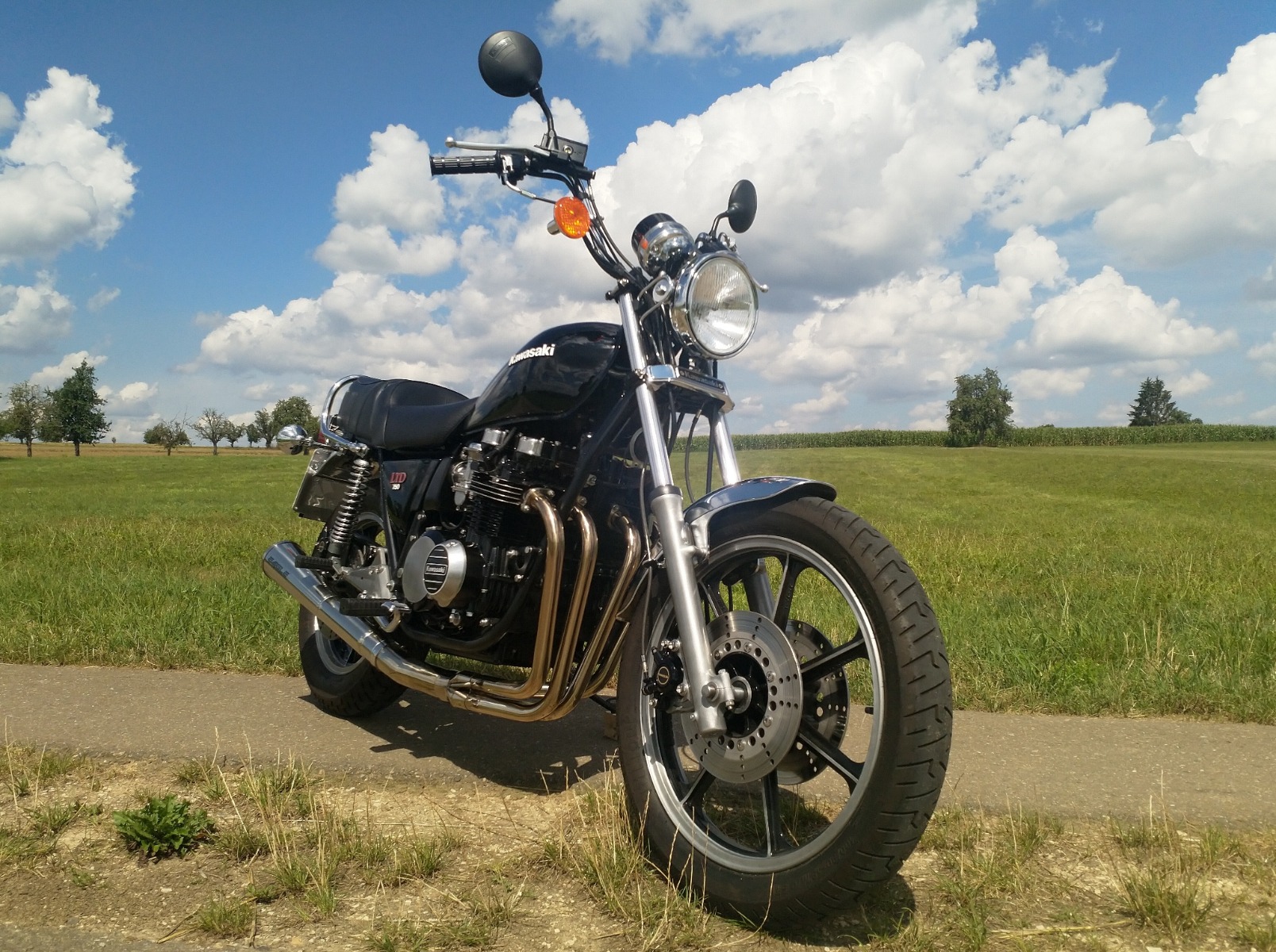

Thats a bike to be proud of, well done!
Re: KZ750H Restoration
30 Aug 2020 12:41

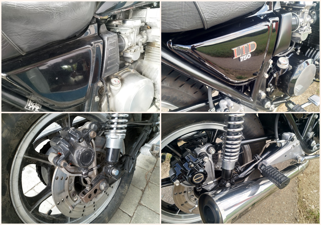

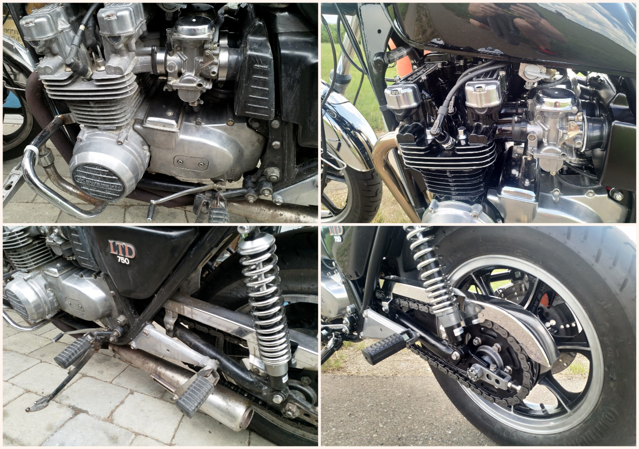

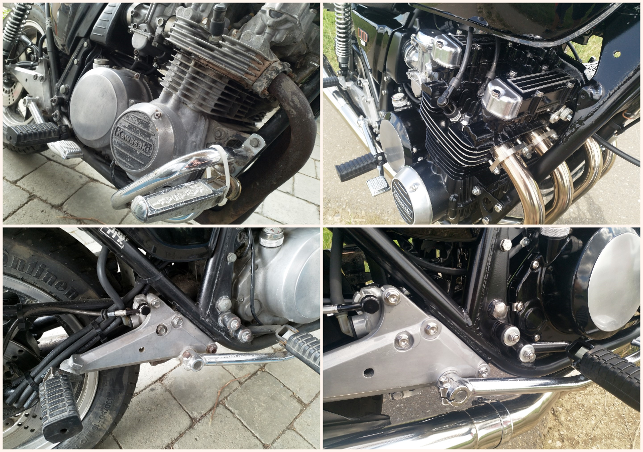

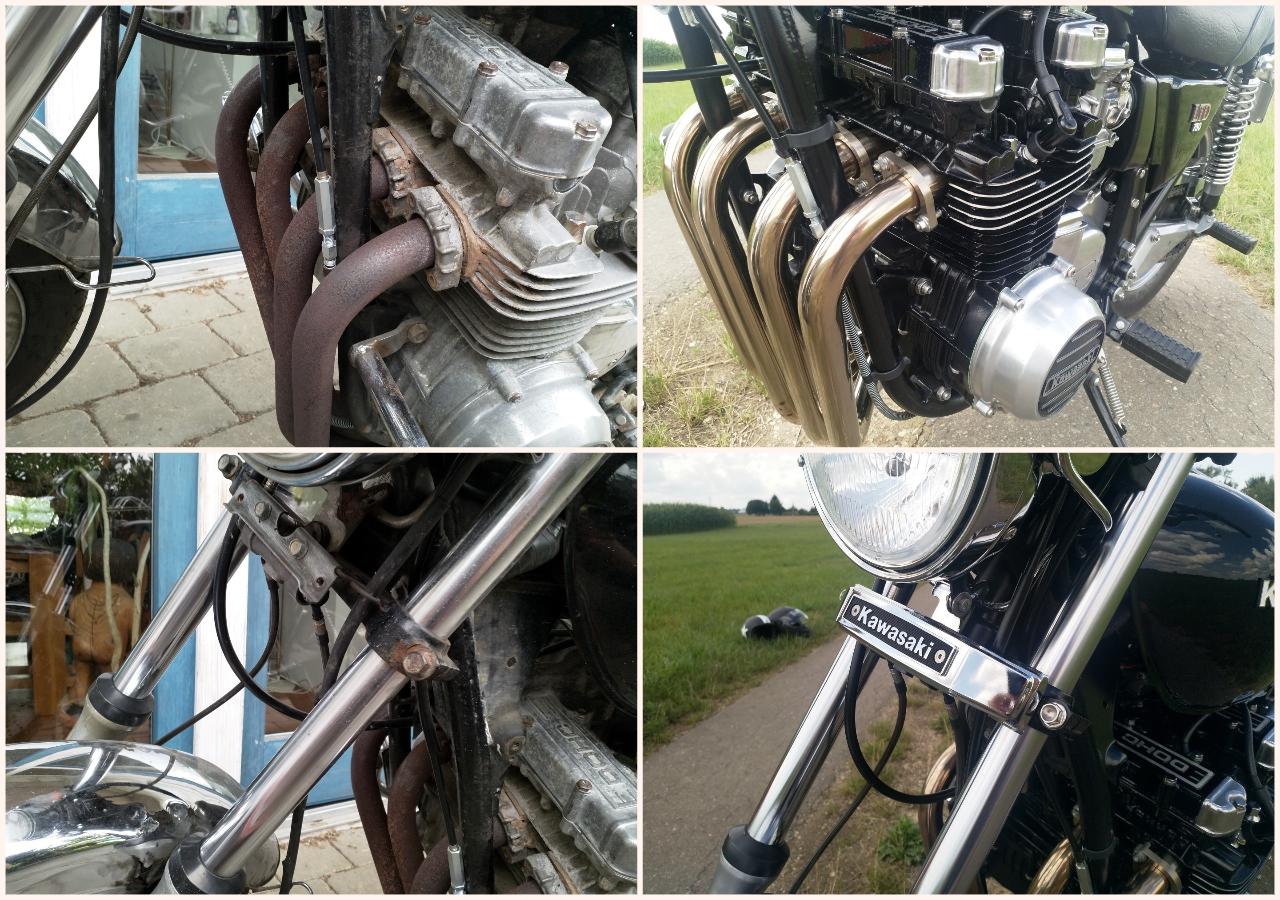

Wow. The side by side really shows how much work you did. Real nice
30 Aug 2020 13:30
Looks good! Ed
