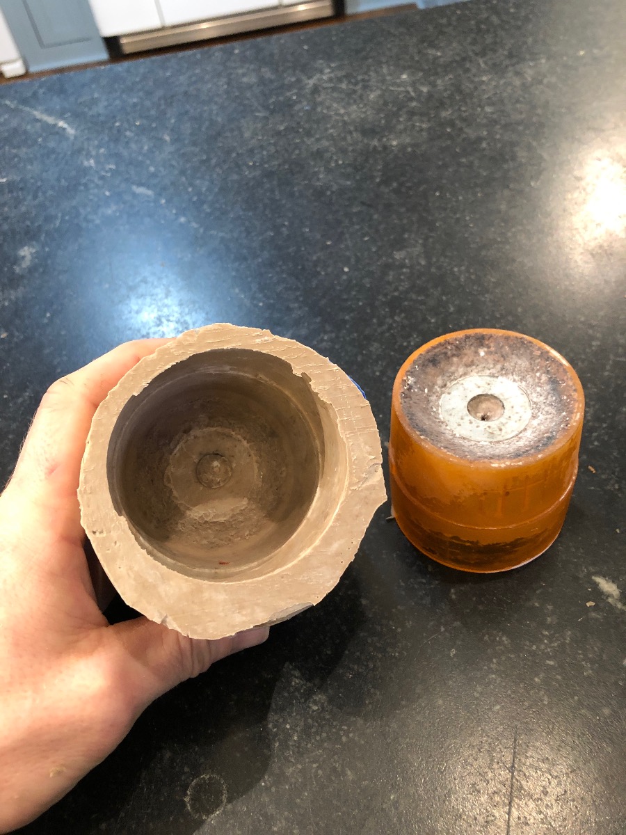

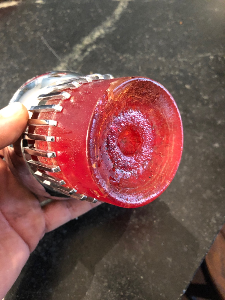

Finally! now I can tell you what was finally successful for me to make a simple mould.I used this formula 1 part cornstarch
1 part full tube of 100% silicone from any hardware store
Then get a 1/4 cup of water and a quarter size squirt of liquid dish soap ( )
and a squirt of water based paint(this helps to see if you are fully mixed) ( mix these together )
I used a piece of junk plywood as a mixing board I first spread the cornstarch out and made an equal layer.Then I used a caulk gun to make rows of silicone to equally spread out over the cornstarch, then folded the cornstarch into the silicone with a body filler spreader.After mixing for about 20 seconds I then spread out the mix like a dough and dumped the water/paint etc mix in the middle,HURRY NOW! you have 30 more seconds to knead in the water mix and get into your mold. Maybe another 30 seconds of working time and then boom... sticky.
The concept is that the cornstarch soaks up the moisture (which helps the silicone dry internally)and the soap helps it not stick a little to objects but get a detailed finish.

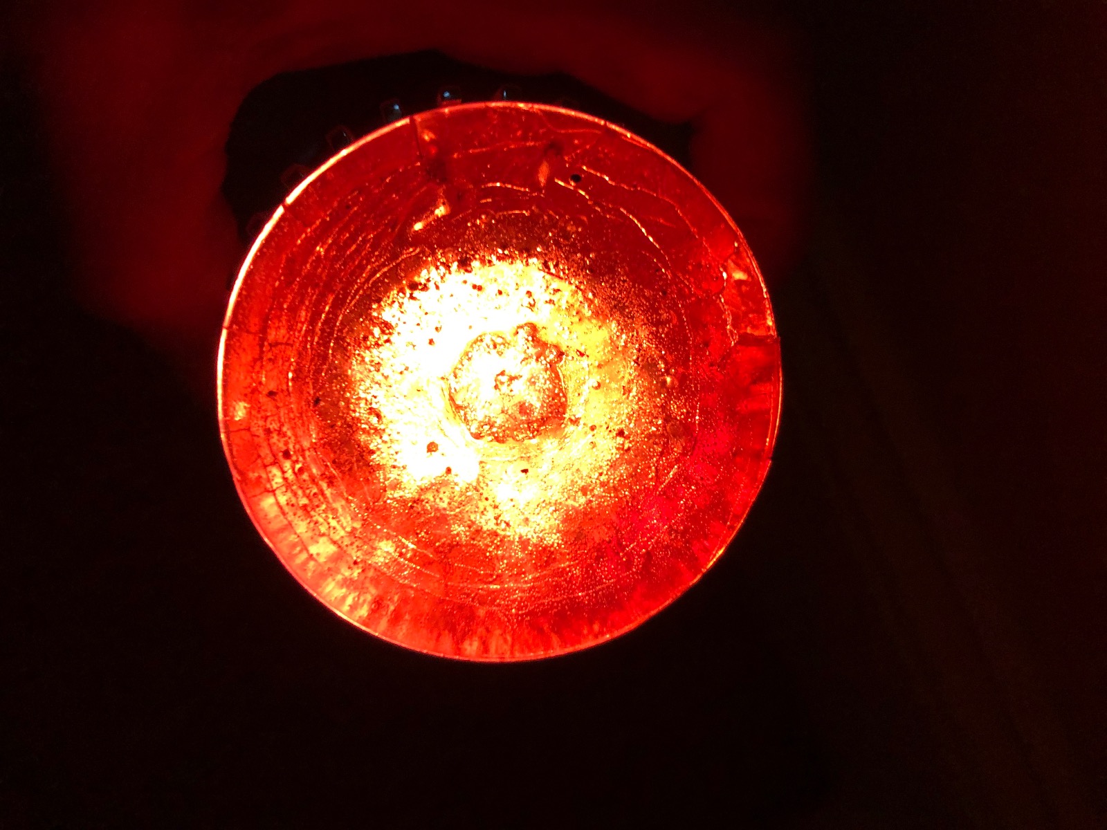

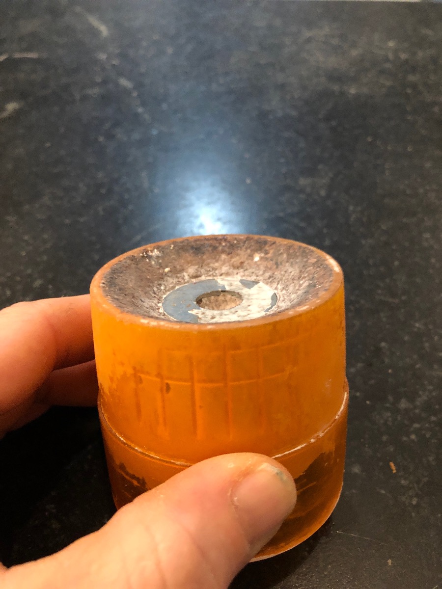

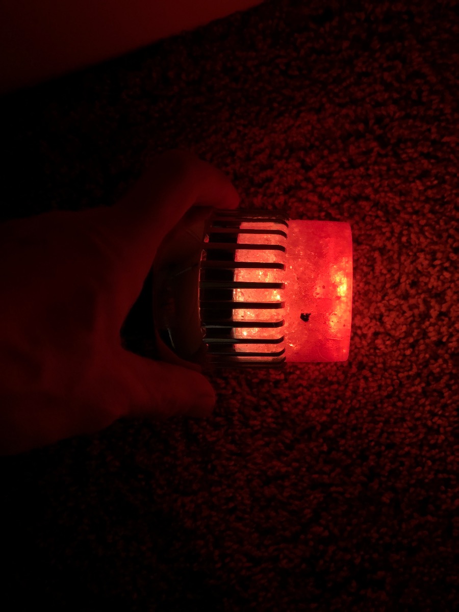

The over 1 year old epoxy was a bit thick, and for table tops(not for thick applications really).I mixed 1 drop of house of color cherry kandy concentrate to get an idea of how much to pigment when the good epoxy arrives.I only poured 3/4 full to see get and idea. I like it.looks great with a flashlight behind it.Also the CHROME showed up in awesome condition!

Are you planning on degassing the epoxy? It will help with the bubbles. I am impressed with your DIY approach to pattern making but Smooth-on products aren’t too expensive and give amazing results for hobbiests. Takes some of the guess work out for us onesy-twosey guys

My next step was to purchase a mould kit if unsuccessful.I enjoy messing with stuff as it usually helps me learn/understand and helps later on in life on some other project.I have only used epoxy as more of a topcoat until this.With some fresh deep pour epoxy I should be in.I still have the modified final version of the lens so I can re cast a new mold if I jack something up before I get 4 good lens poured out. Thanks for the heads up though,this must be finished this winter!

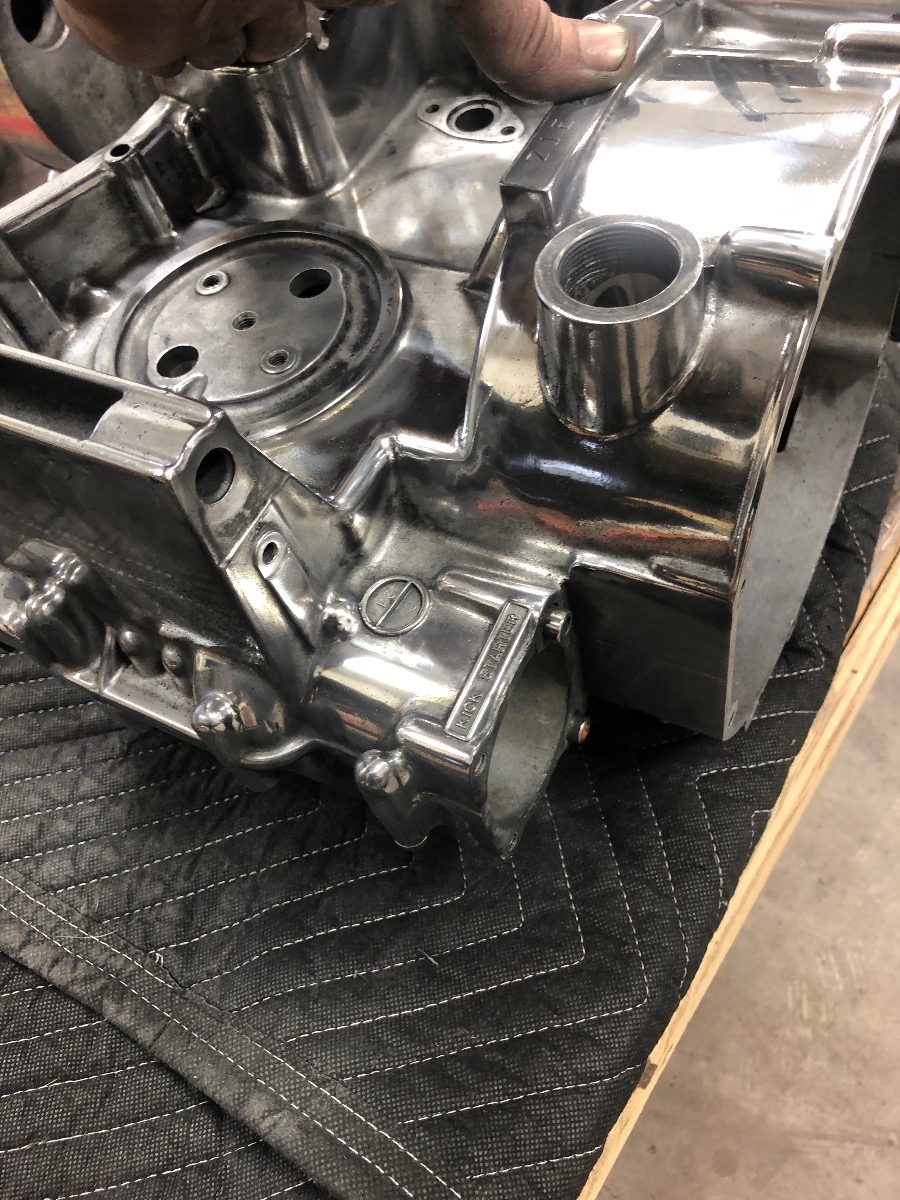

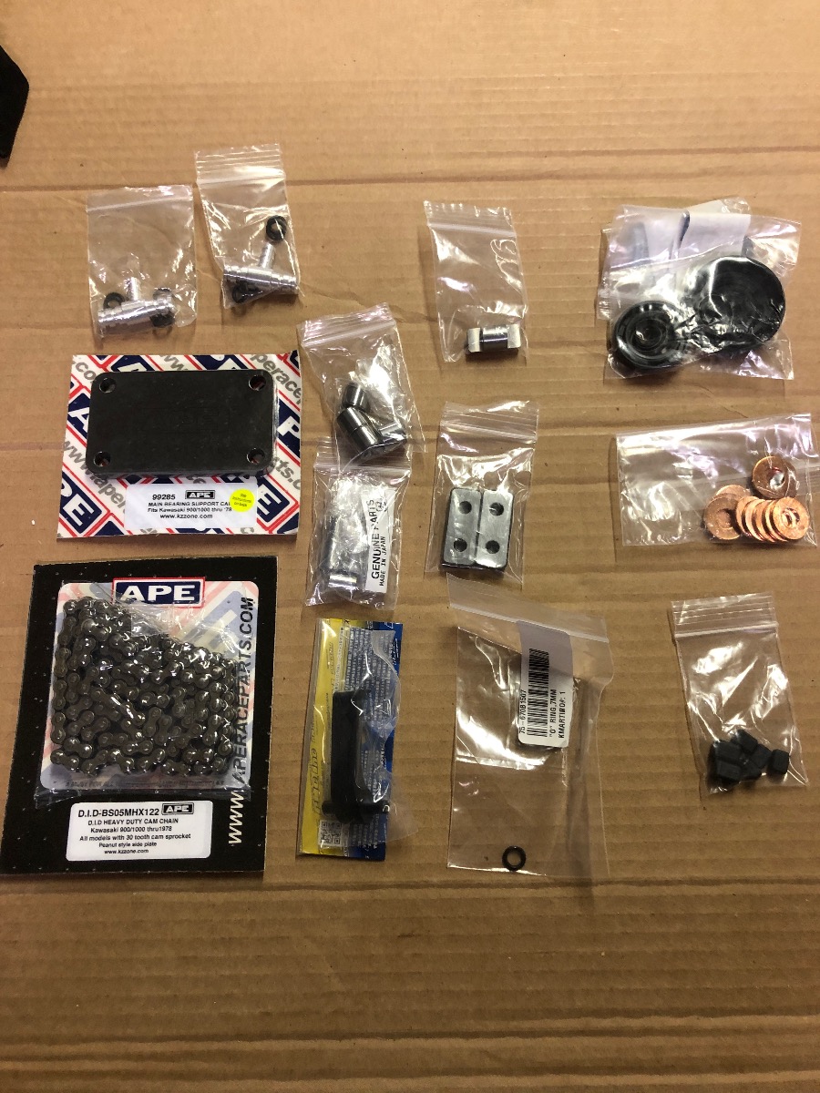

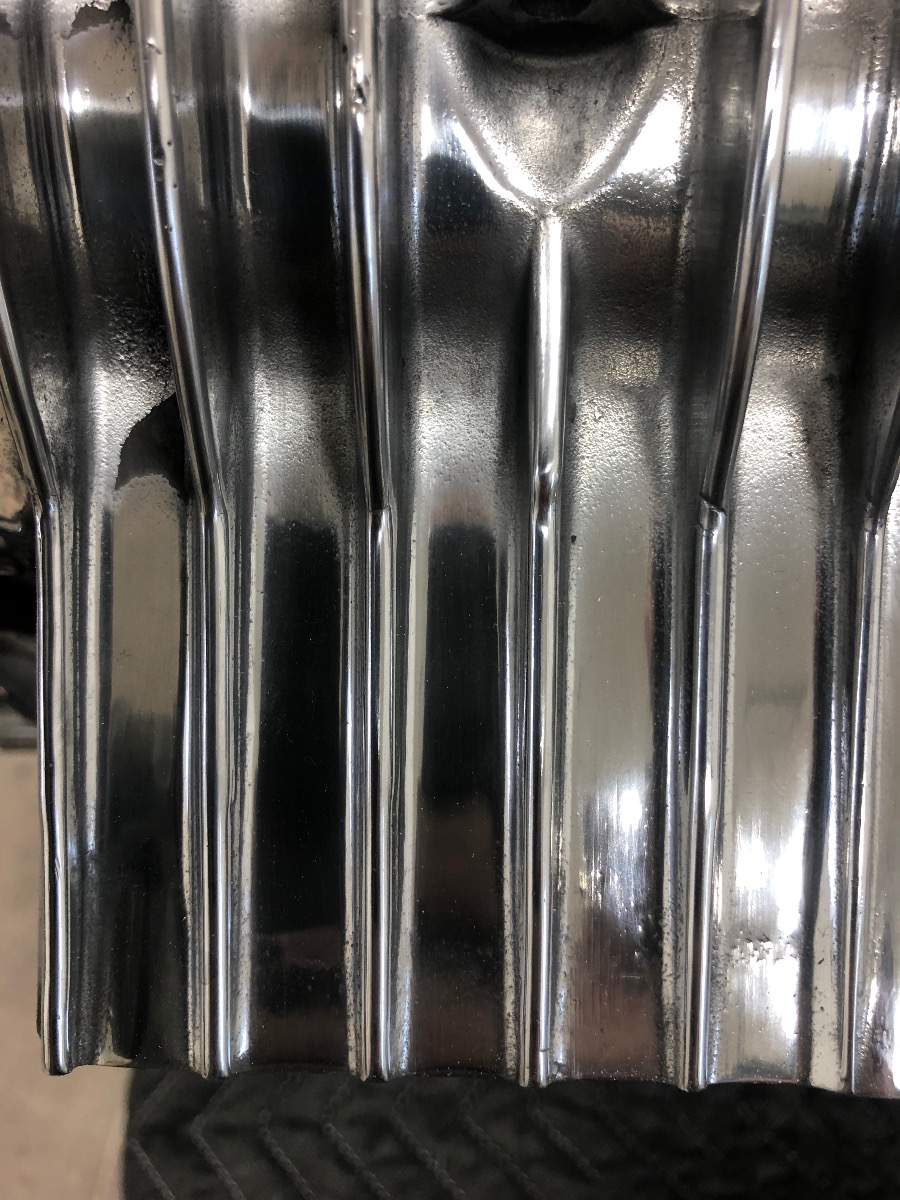

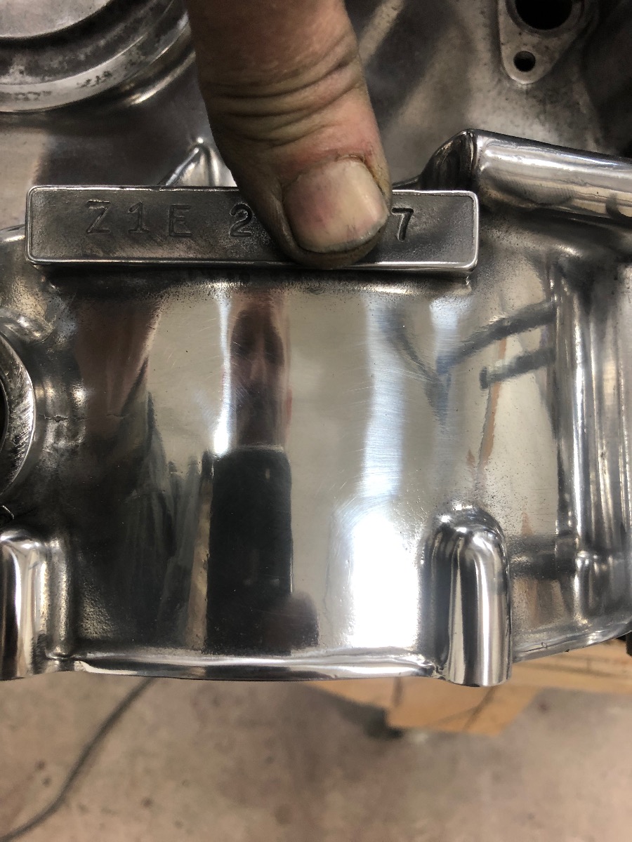

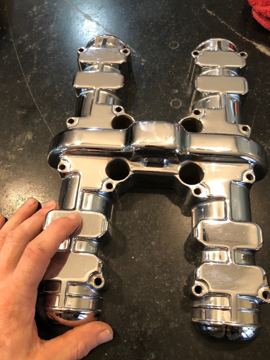

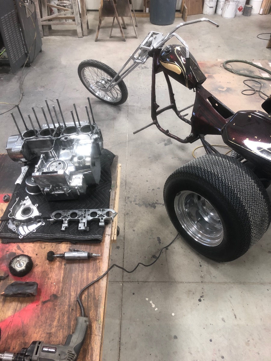

Got most of the lower cases ready, waiting on a couple small rubber parts.I started to look at her and make a final assembly plan. I'm going closer to full polish on this gem. here she is in rough buff with dirt and crap everywhere.tomorrow I'm getting in bathtub with the cases add some 1200 grit and then 2000. Wash with dish soap and brushes.I run 200 ft of air hose in through the bath window and have my blowgun ready to blow out oil galleys.After final buff and wash I have some long pipe cleaners that I will clean all oil galleys I can (again).Then I think it will work.

That’s awesome...!!!

Im not sure if the pics show the difference but she shines.I still have to clean and hand polish before case re assembly. Having issues with pics not wanting to load full size, And yes I inserted them but they come out as thumbnail.Is it me?

Nice shine.
The picture problem is not you. Bill is looking into the glitch.

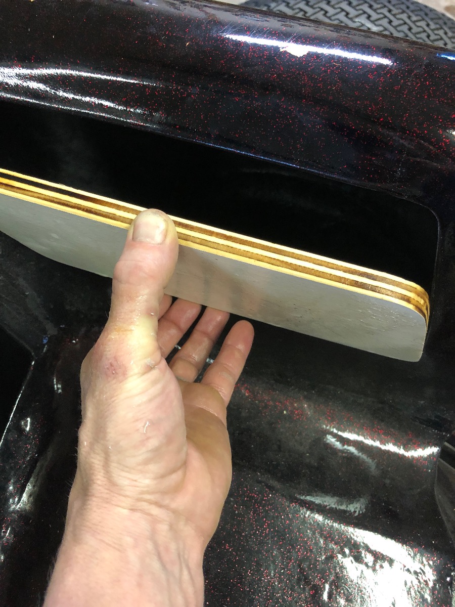

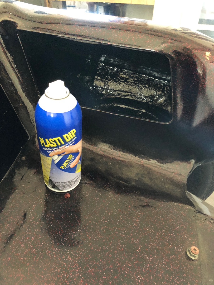

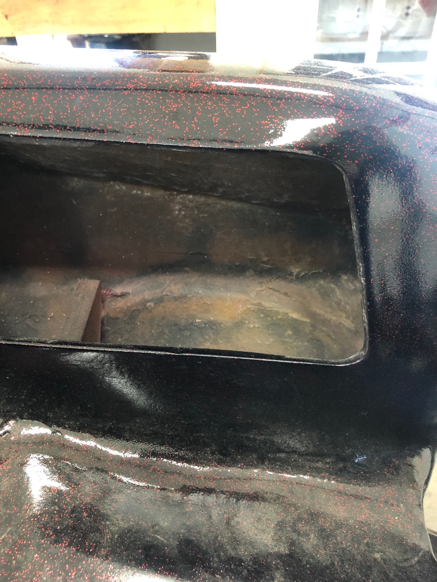

I decided to try "plasti dip" for coating the inside of the tub.It has a nice soft feel and seems good after 3 coats(2 cans).started the side panels, they will get some speakers and some black leather suede. Going to have the same black suede and black hair on hide sheepskin for the seat. if you have ever sat on a sheep hide its awesome, the hair lets your ass breathe so "sweaty butt" on long rides.

I fixed your pictures
I like the plasticote idea
