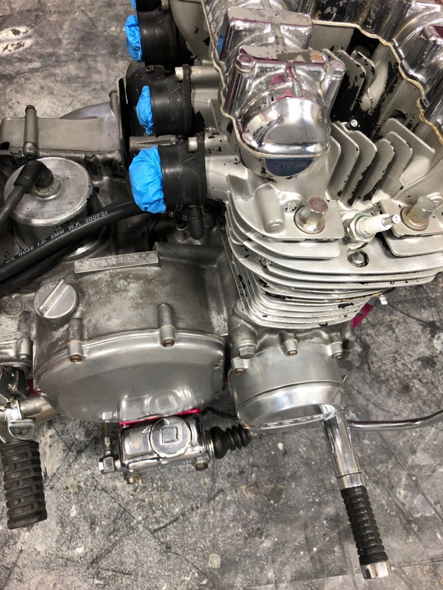

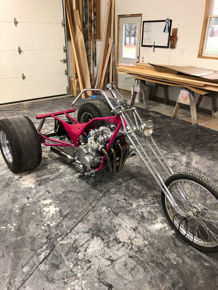

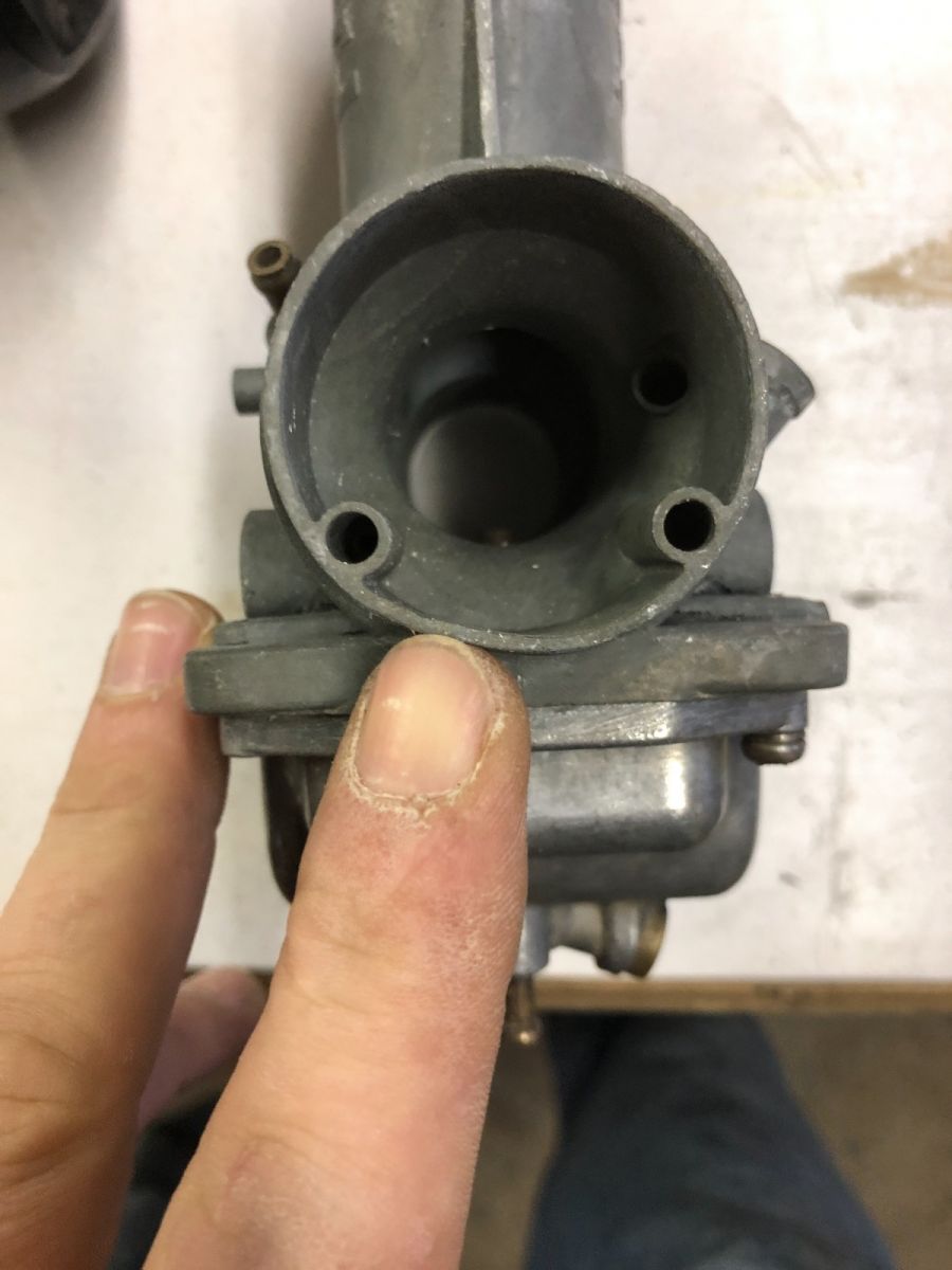

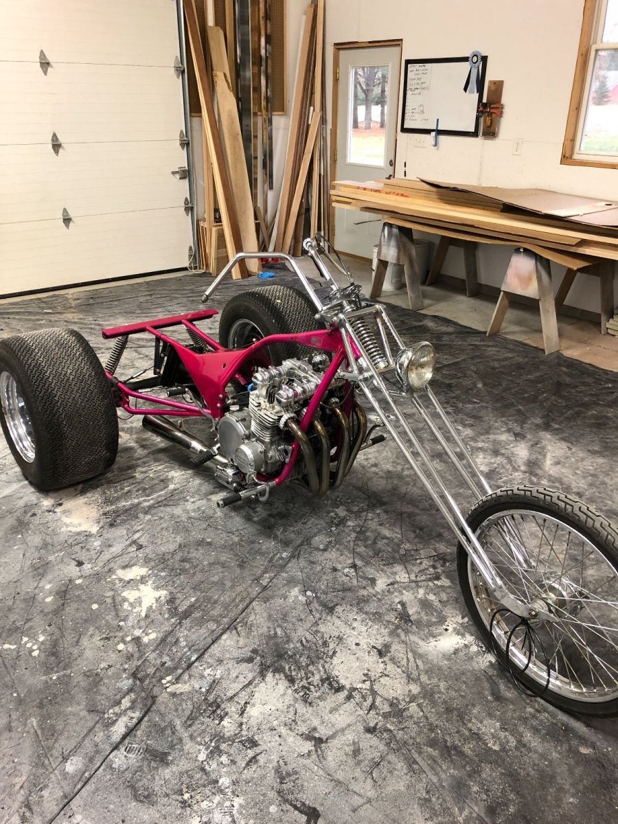

All right I did the new member thing. Now lets get into this beauty. I am a chop guy and this will be a full rebuild of engine and frame mods fiberglass rear and total paint. Got it and she was fast around the block once! now she's tore down. I'm into the carbs pulled them and started washing off engine. half the paint came off with a HF electric power washer. Hope to pull motor by next week and start on chassis. The rear was designed by and idiot because its solid due to the triangle jam its in. I am thinking air bag. Its as though a great builder did 85% and the owner ran out of cash and then some local car guy had his mongrel hands on her after that.The electrical had 3 splices per foot and duct tape no solder. The girder, the stance, and the frame look good( will blast frame to bare metal to check). some pics to start this now.

Not my type of thing but we can certainly help you with mechanics and electrics.

Welcome to the site . Dont worry about the haters . We love anything with a motor here . That things BAD ASS .

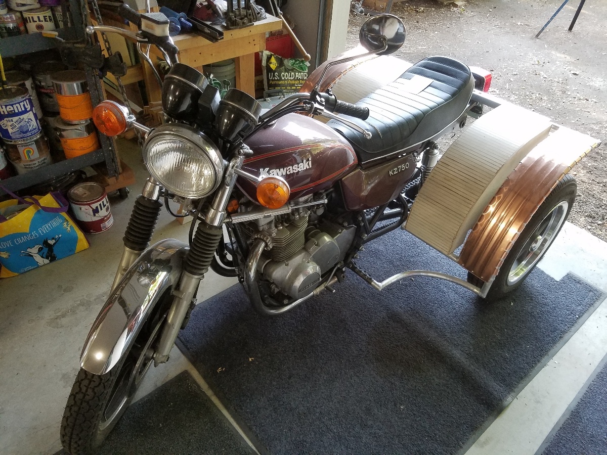

I built a trike a couple of years ago. It's not as radical as yours but it's fun to ride.

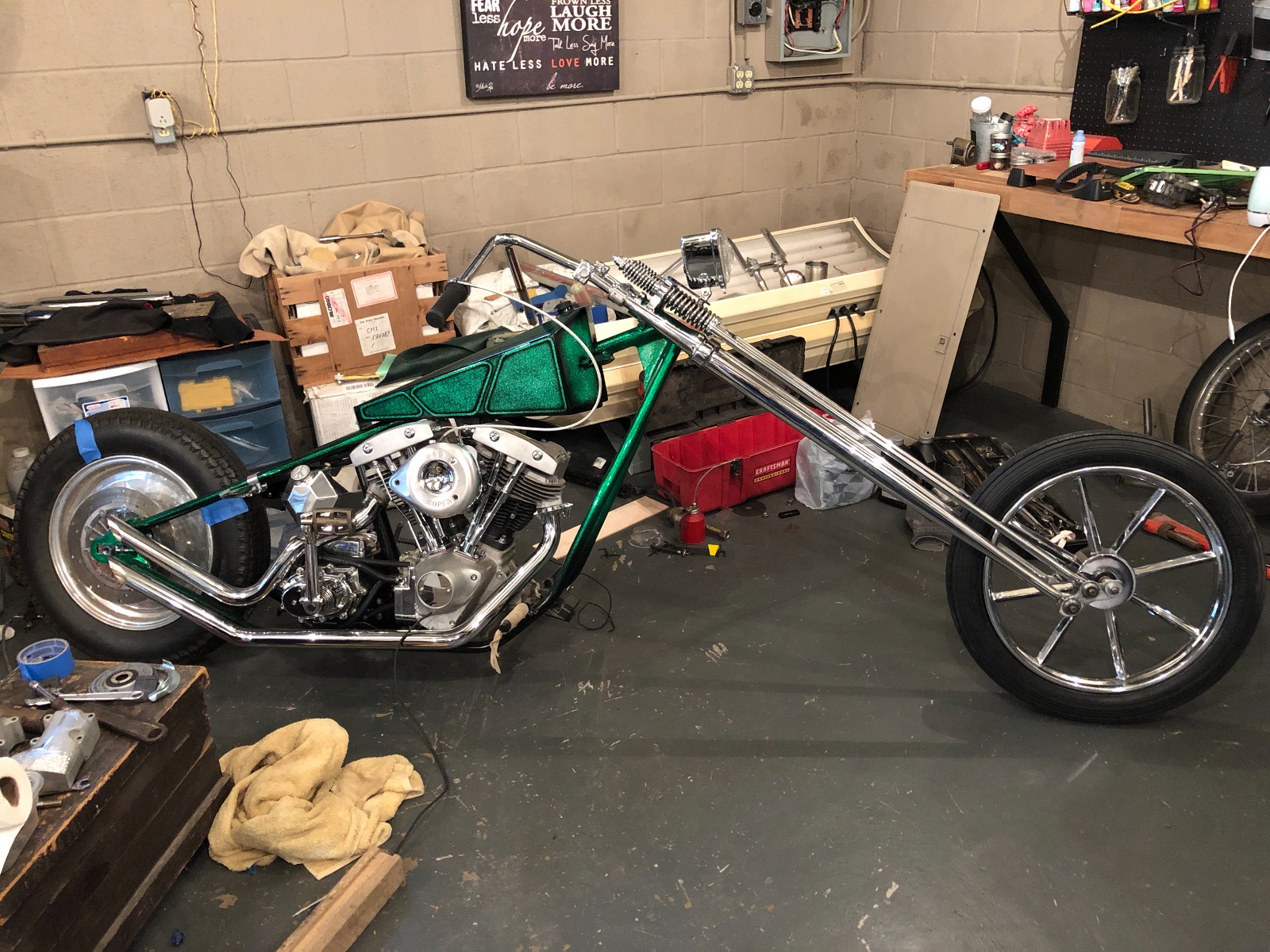

Thats a cool trike KZQ ! I am just extreme, heres a pic of my shovel so you get more of my taste.I don't have any good pics of her finished.Excuse the shit in the back I was moving the basement all around and doing some wiring.

That's a dramatic looking machine ShankKole,
Unfortunately the roads here in Oregon aren't in good enough shape for me to ride over with that rear end.
How does an extended front end like that handle? I often judge the geometry of a front end by how much force I have to put into the bars to hold the front end up while in a turn. An old Schwin bicycle or perhaps an old Triumph Trophy have the best frame geometry, meaning that it may take effort to move the bars but none is required to hold them in any given position.

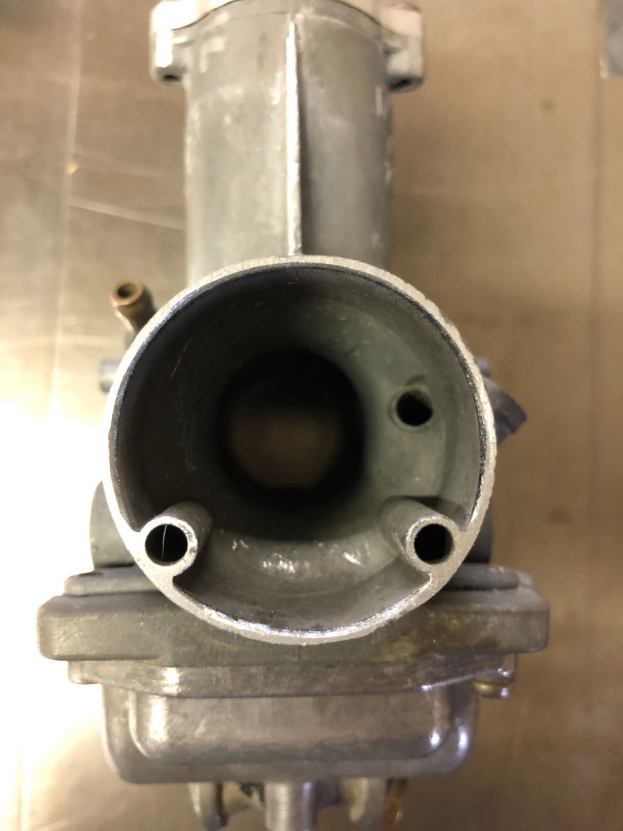

Ha... how the shovel handles well,the deal is the trail which most stock bikes are 3-6 inches and that is at 9 in the pic.With the bars on a hard angle they turn into a lever which here decreases force needed to steer. Trail as draw a line straight through the neck and level line down from center of axle( for those who don't know) Now it handles effortlessly straight and stable when cooking down freeway ( baker 6 spd in 4 spd case helps the old tractor get to that speed)and slow pimp when turning ( you drive it like what it is, folk art when slow and freedom when fast) That California long bike look from the 70s was when guys were CRANKED up and driving states away for the hell of it to party and fight. Got a tired old road king for comfort till the trike is doing wheelies with a gel seat !! I am no timid soul who cares if others like my ride, but truly appreciate shared knowledge and will try to share info and build details that may help others. Here is where some big handed mofo tightened the band clamp too tight. it tapped it out with a 1 inch hickory dowel and hammer.Then sanded the face flat with 400 grit paper laying on a hard flat surface rotating a quarter turn every pull across until flat then smoothed the edges.You can see the difference between stage 1 and 2 of cleaning.

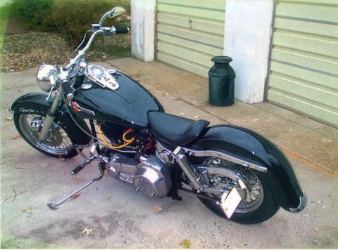

Im not much of a fan of trikes but yours has great...proportions I guess is the word. Id like to see details on the frame.
I built this 76 FX back in my twenties (late 90s) from custom parts and mid 50s FL stuff. I modified every part on it in one way or another.
