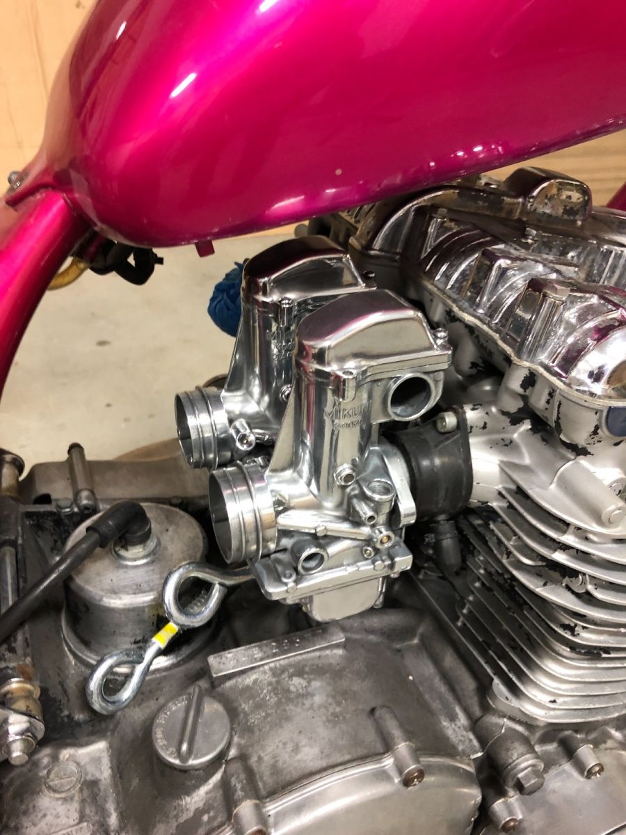

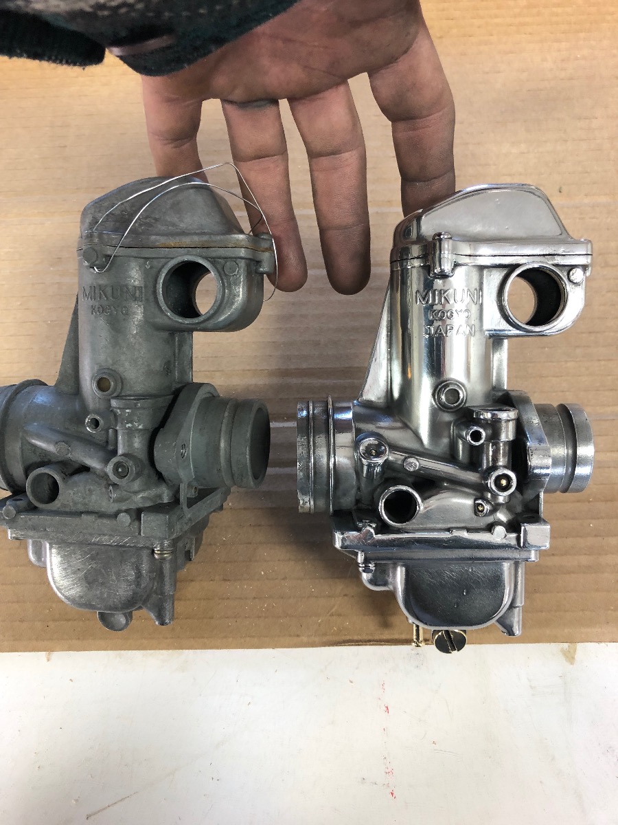

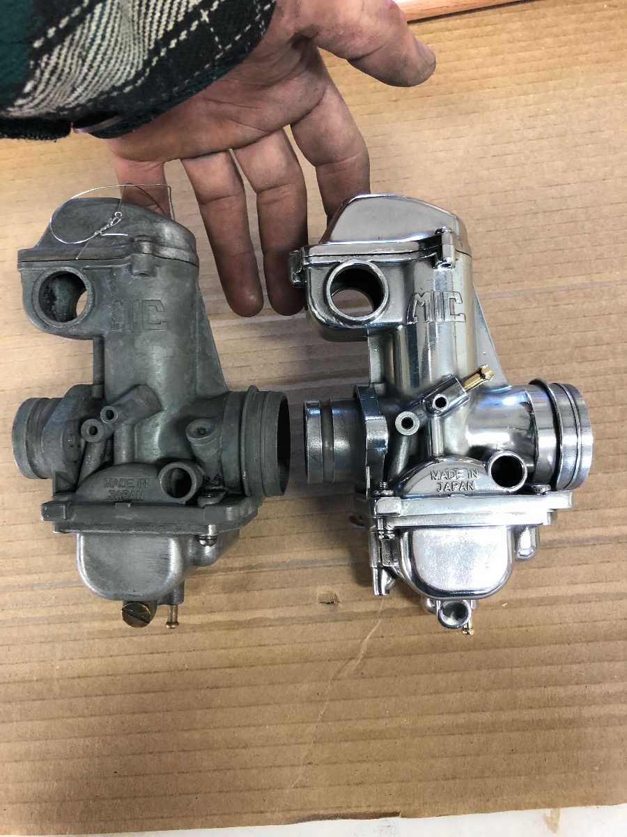

Nice shovel Kawie ! thanks for the compliments as well everyone.I got one carb close to ready for sonic cleaning, guess which one? man these castings are rough they won't get as shiny as some parts but they are closer to cool !

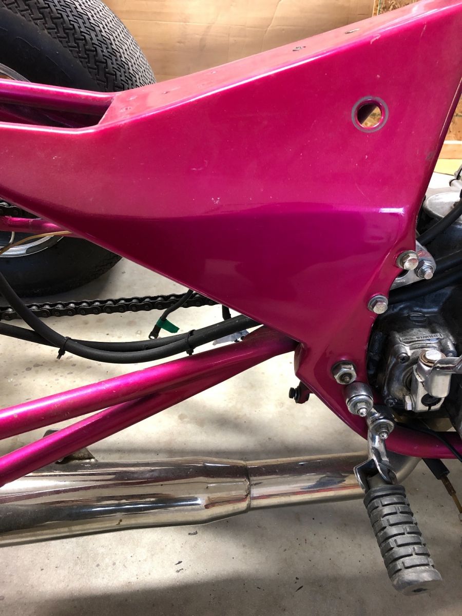

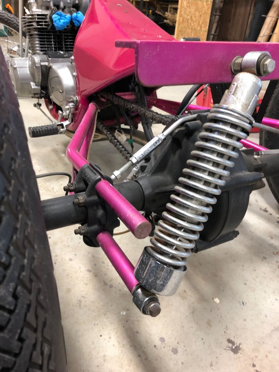

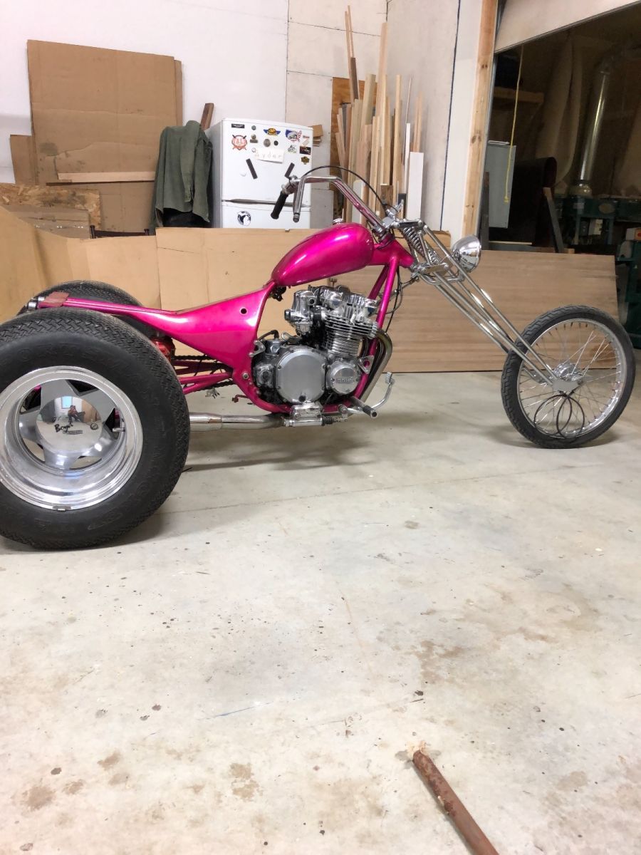

I don't know how this thing ran ! compression at 110-90-125-120. We shall see inside next week.A lot of questions on the rear end from all so, its a 1951 harley servi rear end, flipped I just have noticed. So I have drain holes facing up, no good but can be addressed. The swingarm is modeled after the servi swingarm then welded to what I assume is a cut up original kawi mount.Some pics

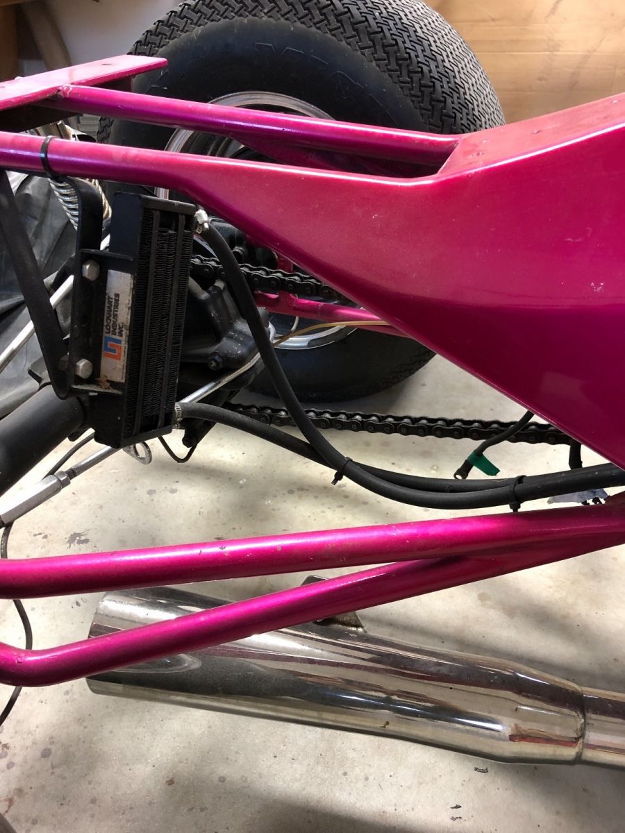

The oil cooler was mounted to the seat box thingy sorry its in the view.

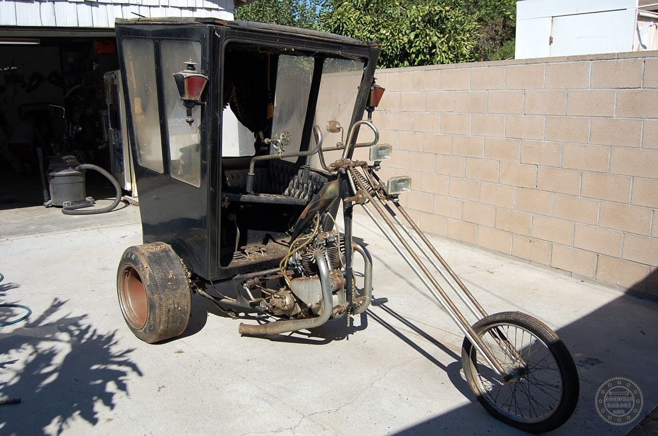

found thsi pic on the net awhile ago,munsters special shed or funerals!!!!

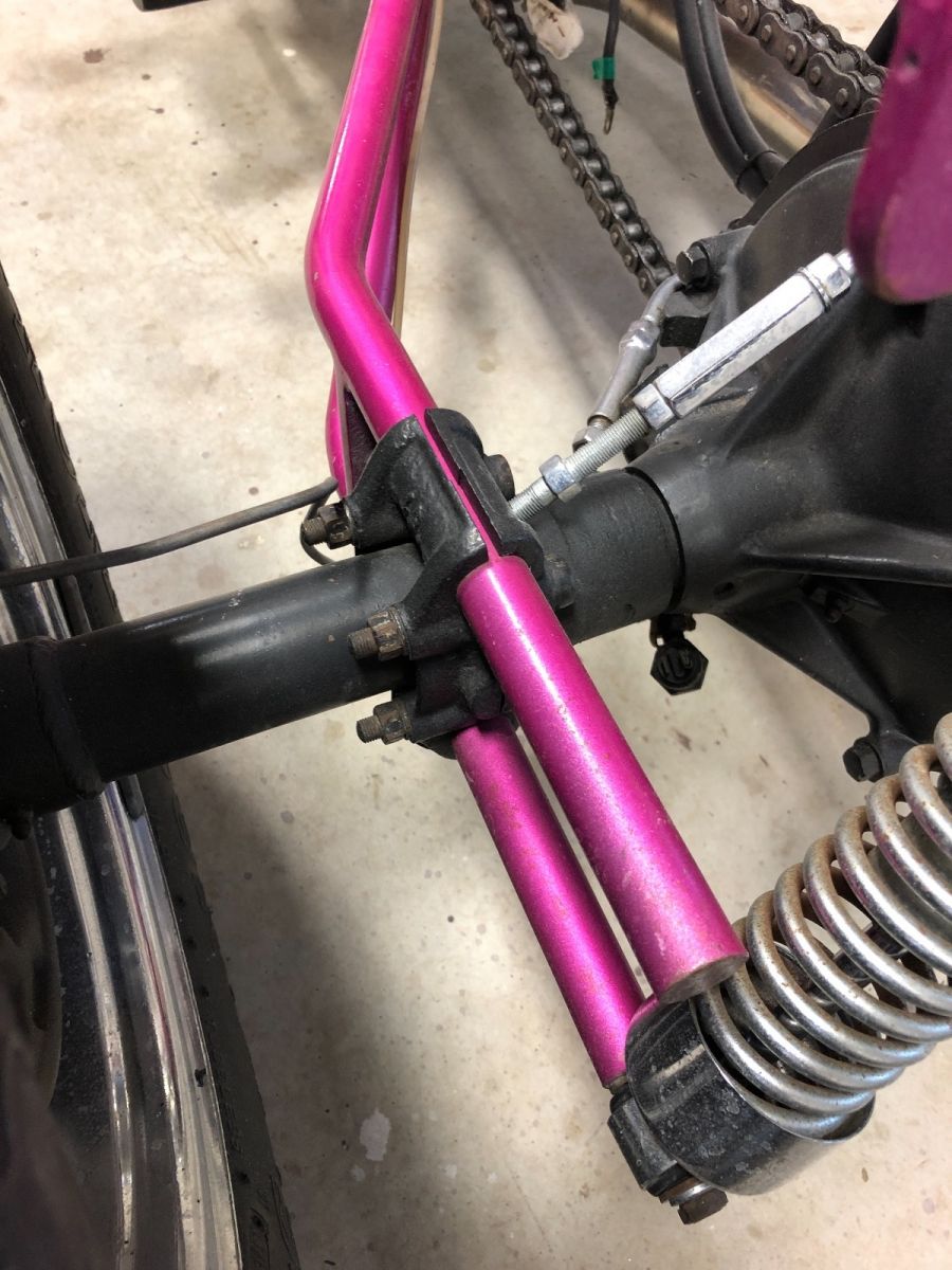

By raising the rear about 2.5 inches it levels the stance more, I will need to shorten the girder spring as well, due to the light weight on the front end its stiff for this application. There used to be a guy close that would adjust spring length of any size and re heat treat them for cheap, gotta track him or search the webs. I am making a rear reinforcement plate to help reduce twisting of the swingarm with the axle width at play.This will also be the new shock mount point on swingarm. Two shiny Mikunis barely sitting look nice though!

Nice work straightening the mouth of that carb.
I wonder what the dude was thinking when he installed the rear end upside down?? :silly:
