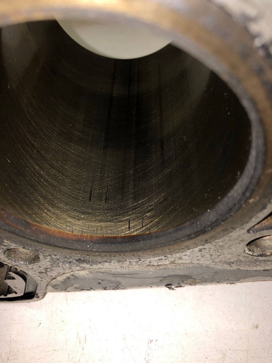

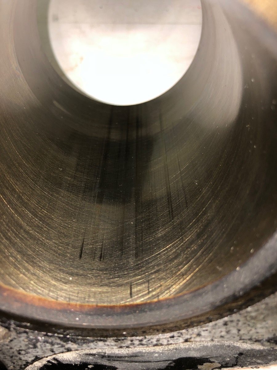

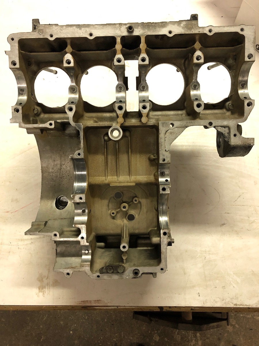

looking dirty ,not screwed up after more investigation.Im hoping to just refresh the top end and reinforce the bottom end. Im now thinking build dream engine on another block next winter after I have more feel of what a standard power Z feels like in this trike.
  • Shankkole
  • Shankkole's Avatar Topic Author
  • Posts: 306
  • Thanks: 151
Re: 1974 kz trike
18 Feb 2020 08:37
#819529

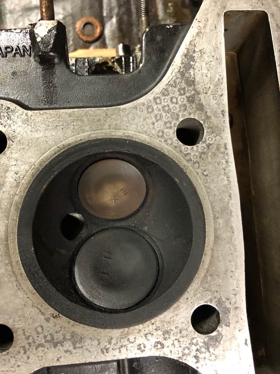

So I do have the 900 crank with 1000 jug and head. It looks like a re hone and some rings , the pistons are fine.I have adjustable cam gears, still need to measure cams to see if they are stock or reground.Im stripping the frame now for welding, finishing.I am looking into rear sprocket options as well for gearing down, for my bottom end pull I am looking for. No cracks in cases found yet. Since I am thinking a spare engine will be purchased for a power build, do I need to do ape main studs etc, or should I hold my $ for the hell raisin motor? I have not found too many bad parts just some age and gunk. Thanks for the help!

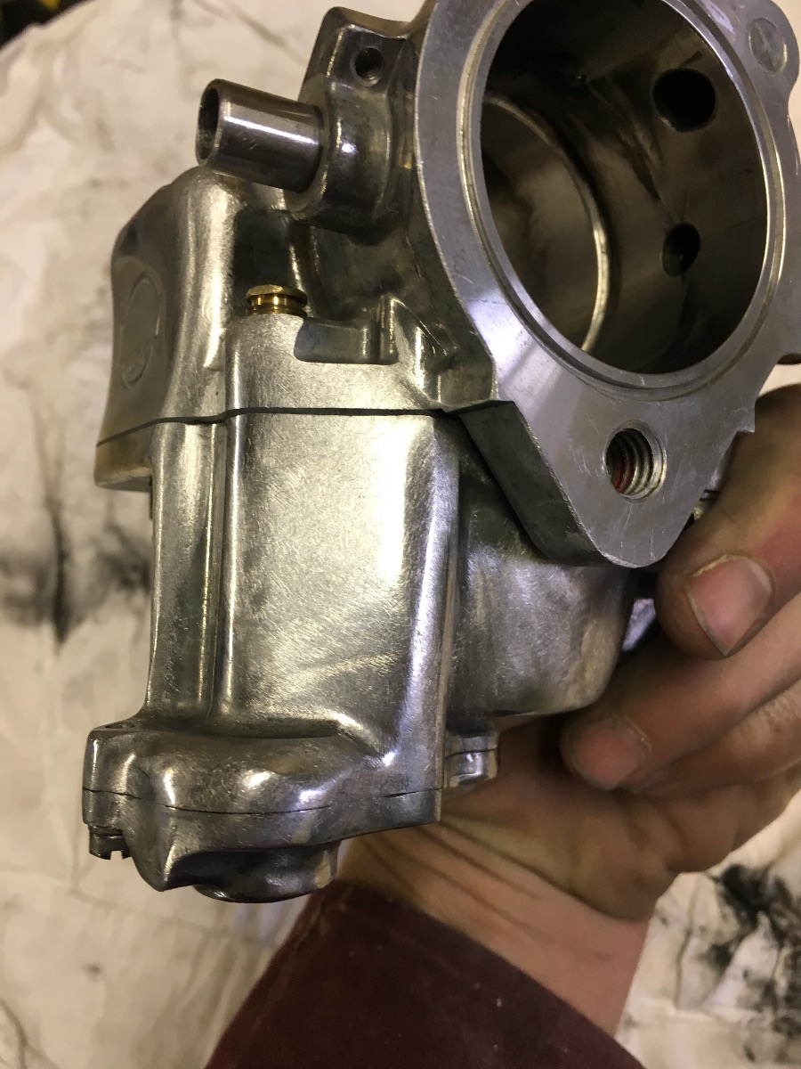

I have decided to not reshape. I don't want the purists to send me negative vibes! Really though most of the lines are already pretty smoothed just some slight mating of separate pieces and removal of casting lines.I think it would be cool to polish the cases but I want to leave the vin pad as is (really nice clean numbers and pad so I will let them tell there age).I am having the hardest time deciding the engine color combo there is the grey,the black, the shiny and there is so many good examples out there but I cannot lock down my thoughts on this one. I know I overpost but thats how much crap is in my head ! Hope everyone makes some money and gets laid today!

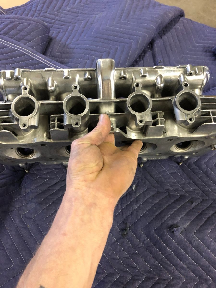

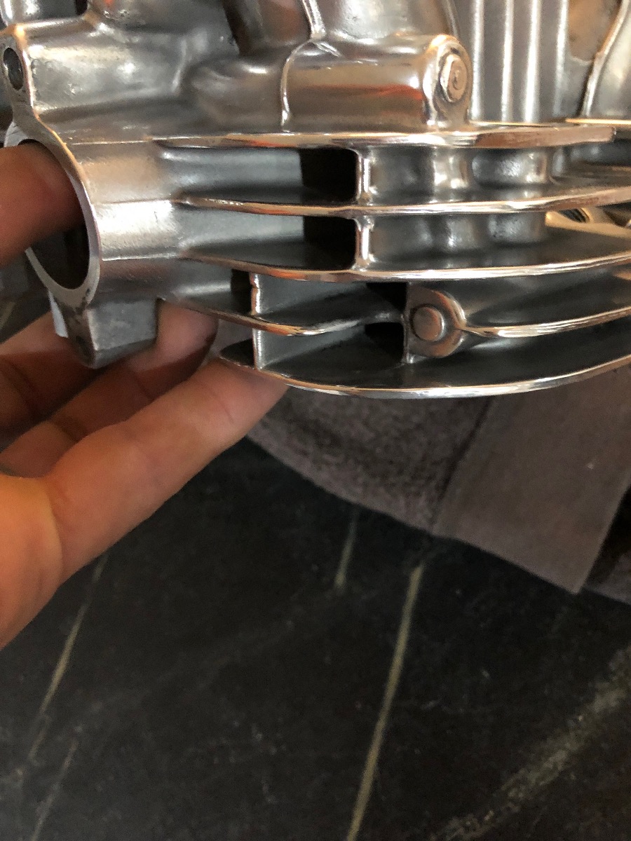

I only took sharp overcast edges off.Here it is sanded down with 400 grit, then scotchbrite pad, 400 grit again and first round of buffing to see all the damage and decide how far to clean up then start the real buff.

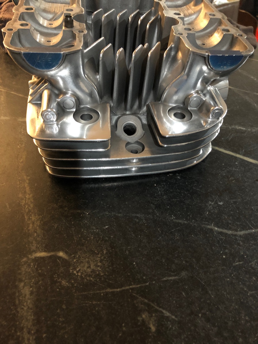

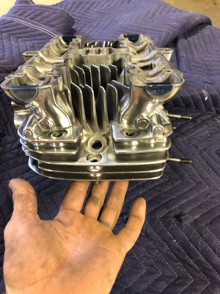

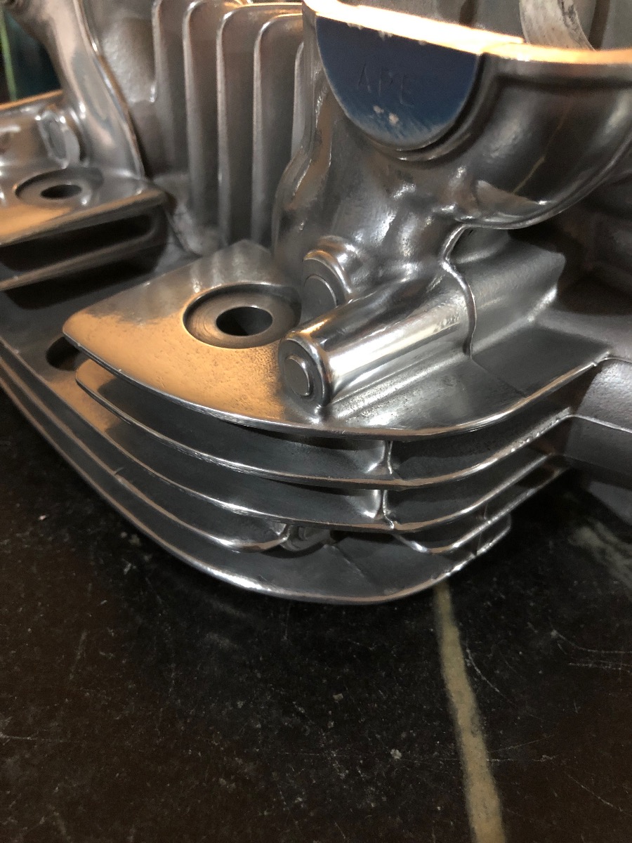

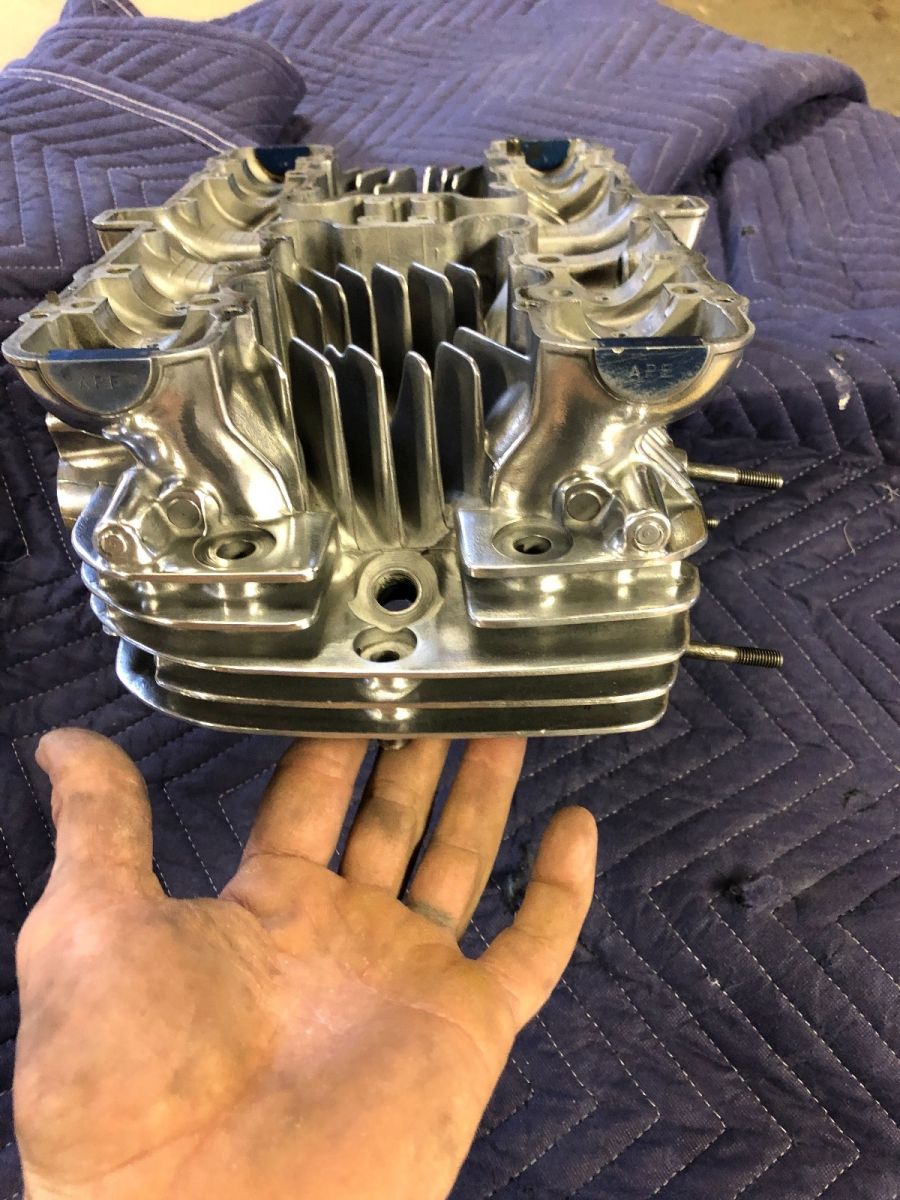

To calm the worried ,here it is.and I think where it will stay.I really like the rough polish, I would call it.I think this will fit my look but keep the edge of the KZ( and I don't have to sand it down for another twenty hours and polish twenty more). I bet I have 12 hours into stripping, plugging, cleaning, repeat.on the head at this point.

Nice. Polishing, when well done, is really tedious work. I was envisioning an almost melted look, flowing with the wind..........
