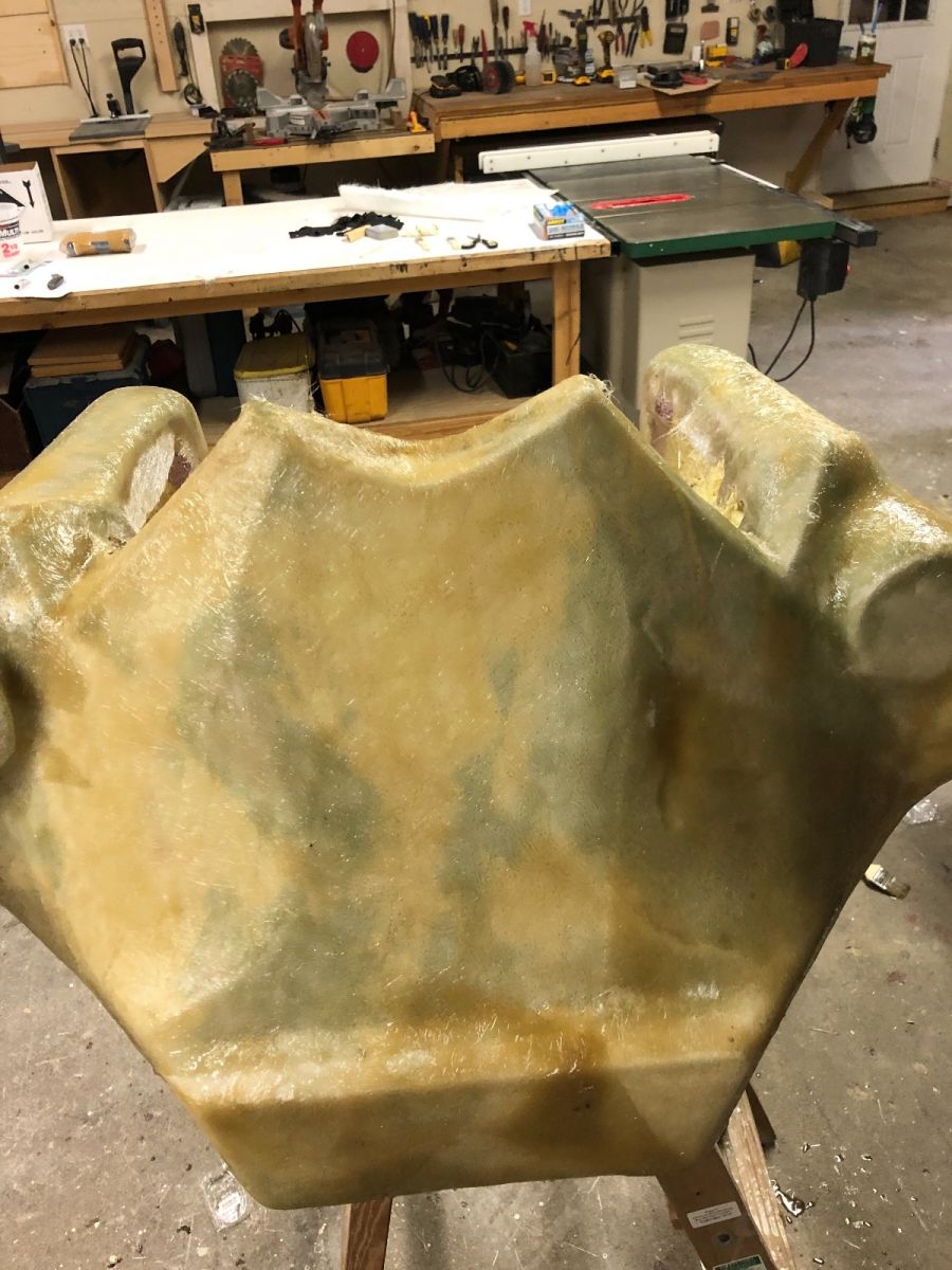

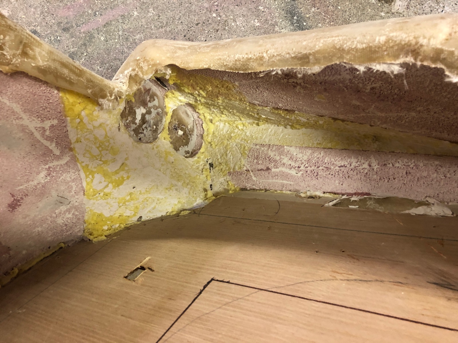

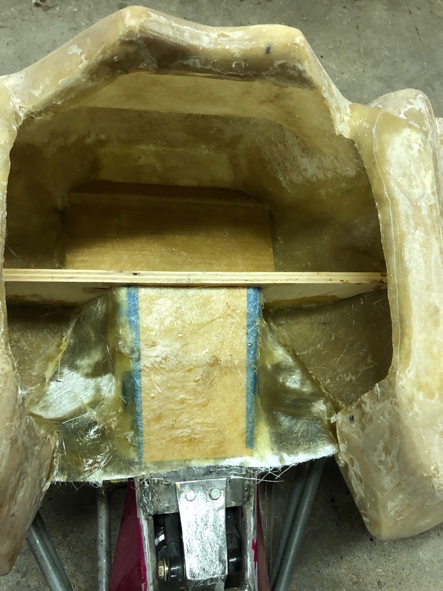

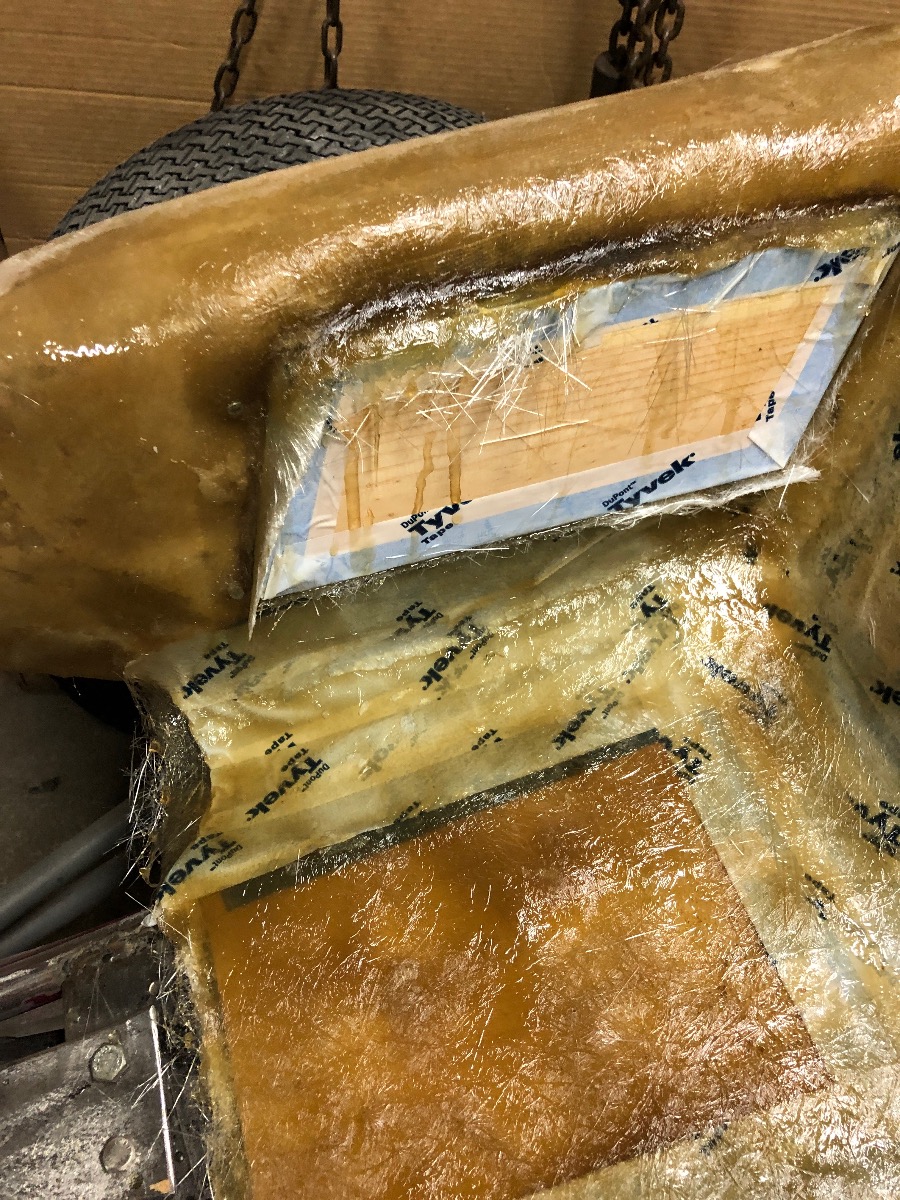

laid another mesh layer then a weave layer.removed the foam and mud form with any hand tool that fit to chunk it out. I need to wash the inside out with TSP and acetone then add reinforcements and an inside layer.Here is it rough sanded with 100 grit and it only weighs 20 lbs right now.

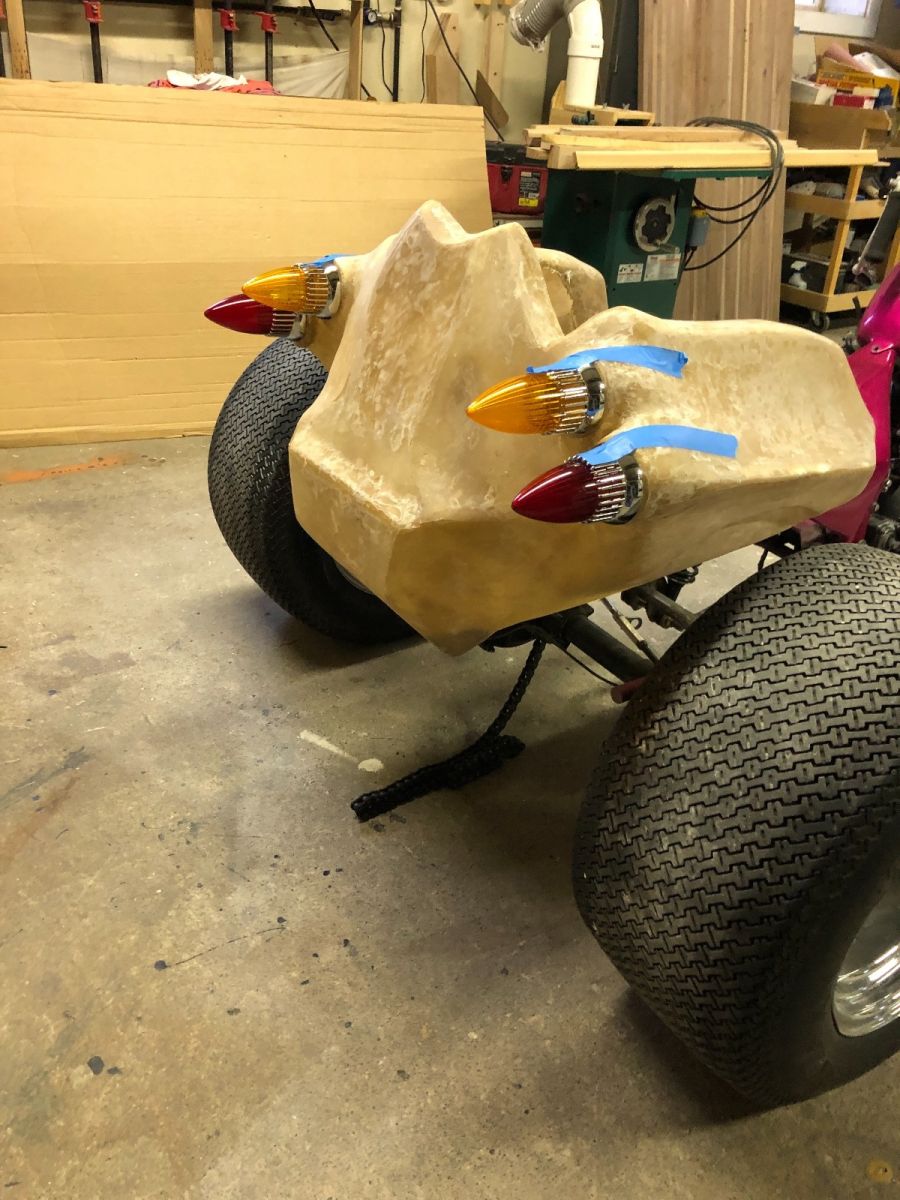

Also ordered the 59 caddy taillights and some chrome PC for the rear axle.

The reproduction caddy lights look great, even taped on. I have some fun options in the works, we shall see if this thing goes to insane level.works busy this week but hope to finish tub by the weekend.

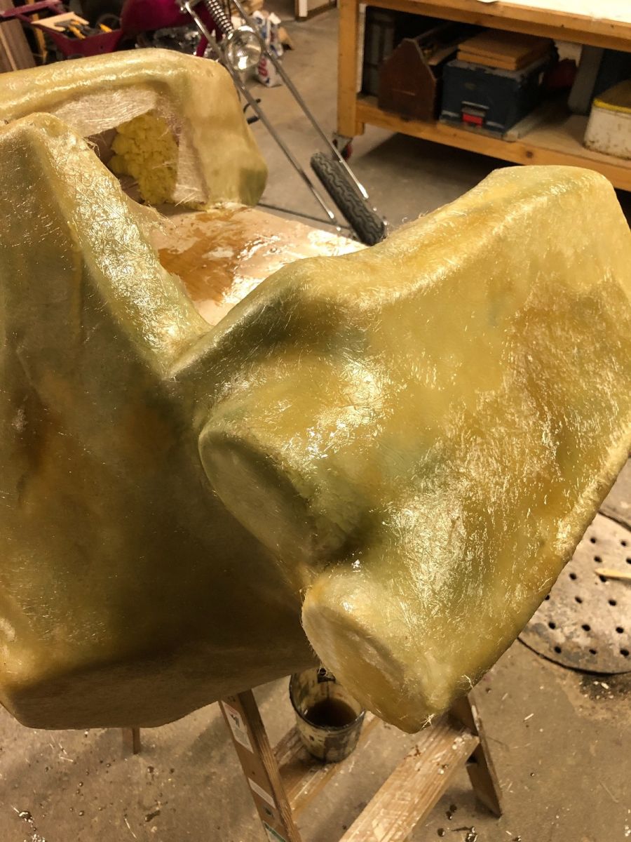

bottom of tub roughed after cleaning.

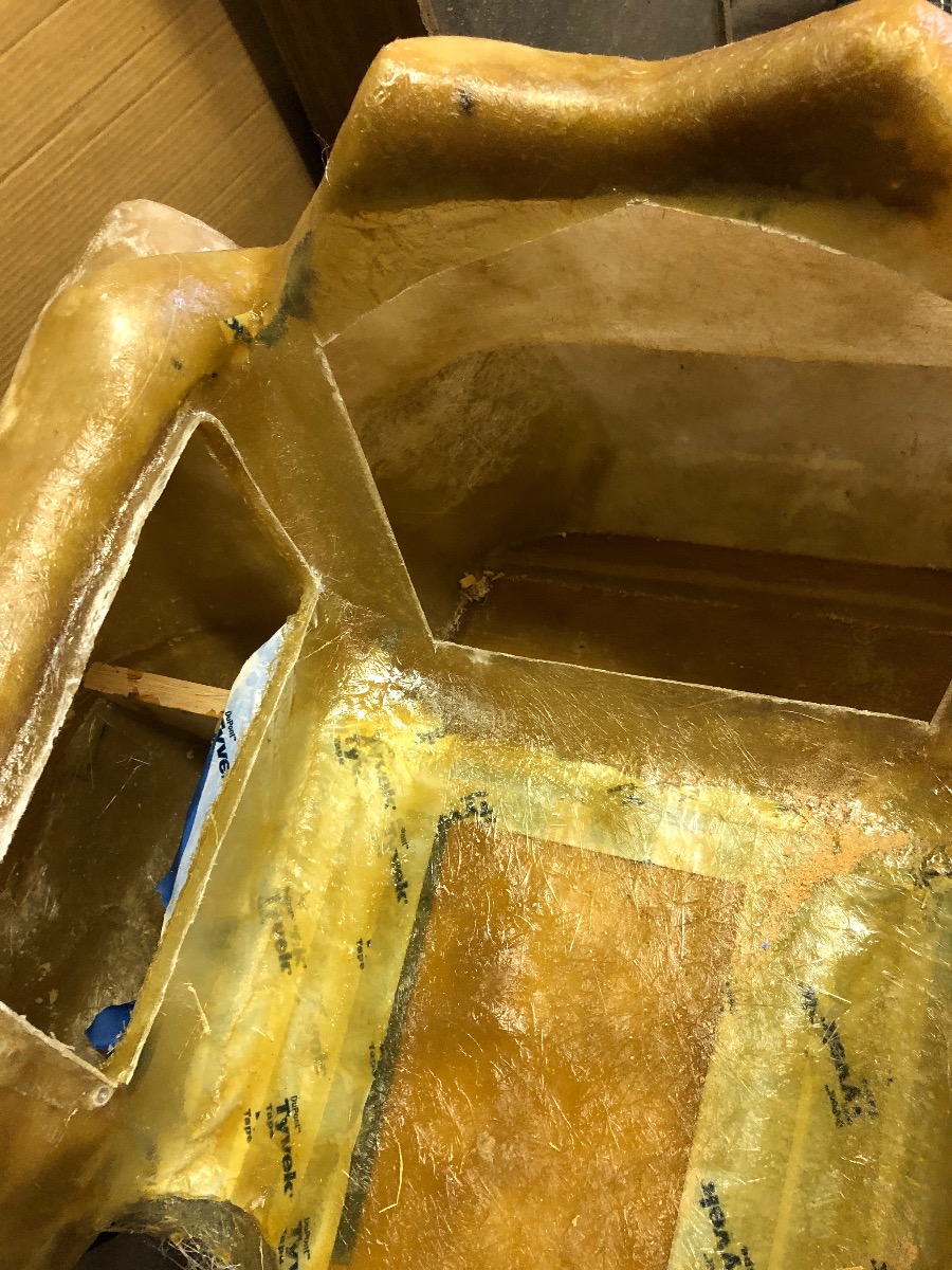

Top of the seat tub laid.

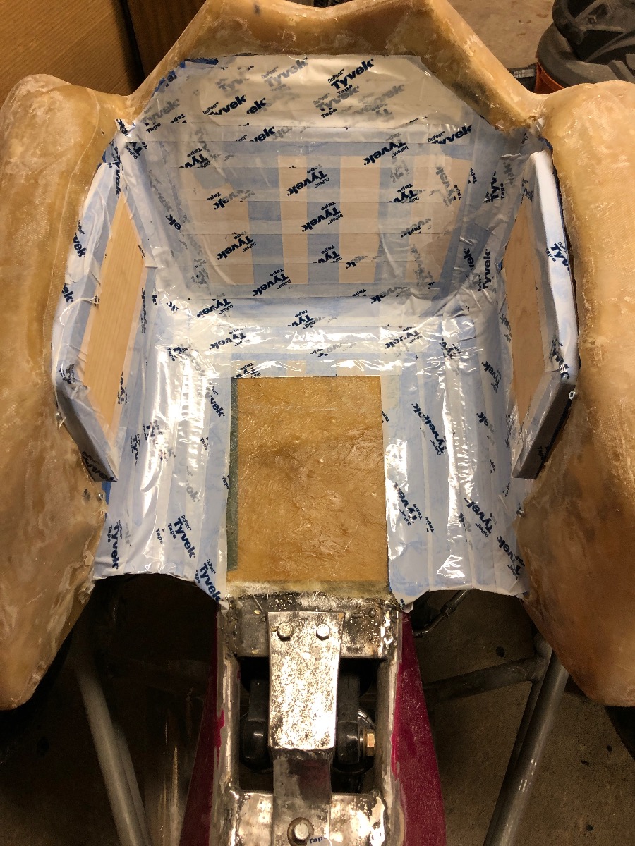

The plywood forms are removed, seat/trunk cut out, along with side doors .
