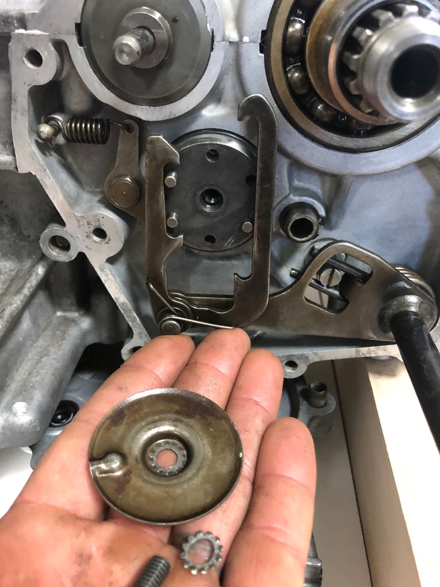

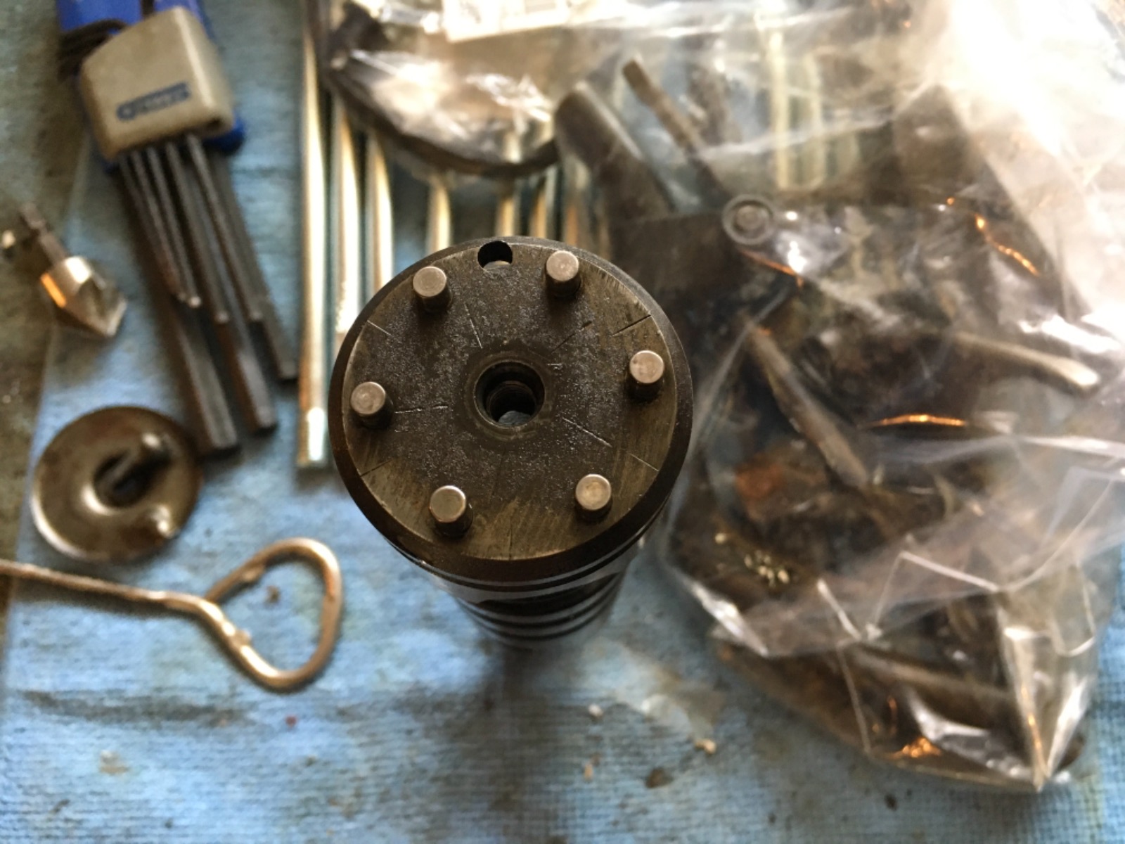

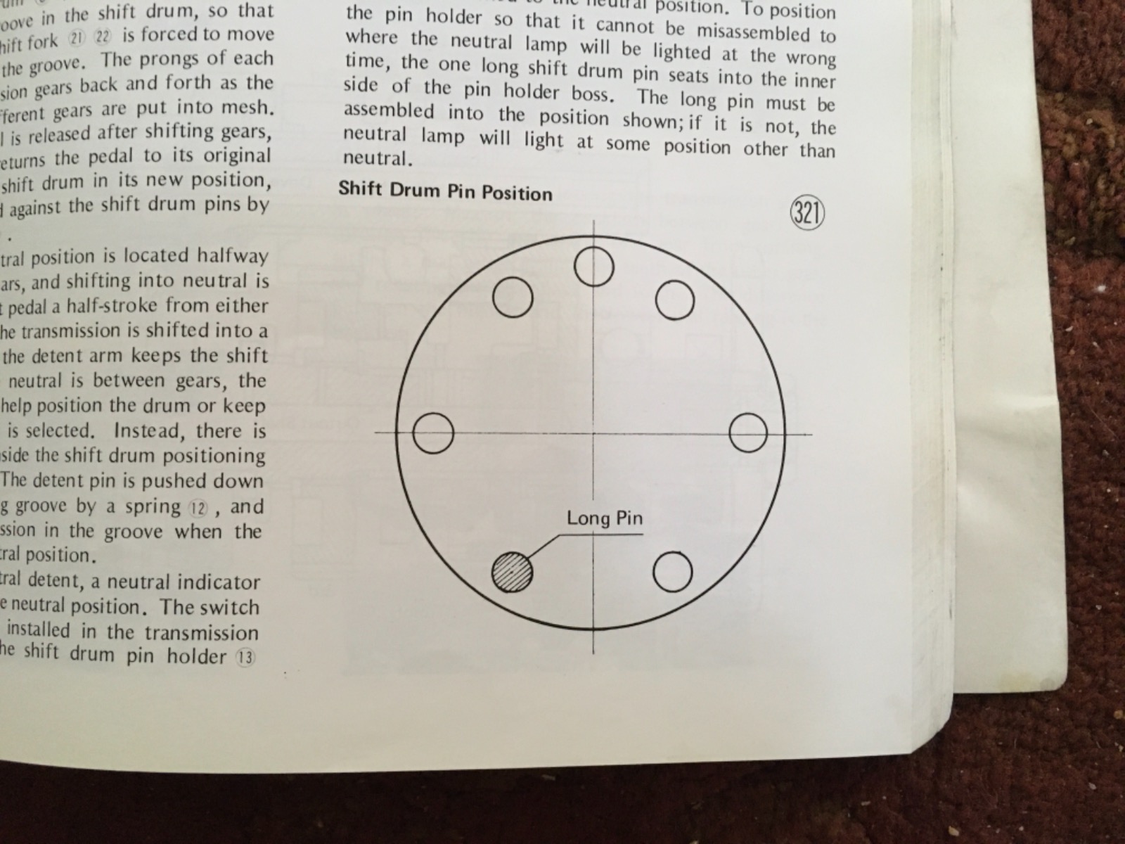

OK, Re assembly is underway. I cannot find which hole pattern these little steel rods for the shift mechanism go, there are 7 holes (one indicating N) and in all my disassembly pics I got nothing. I have 3 ,with one being slightly longer (1-2mm) than the others.Please help, cause I want this in my frame by Monday night.

Im not sure if I am missing some / or  if they are in the right position.

Your missing pins.5 short one long.

The best I can find the long pin should be at 9:00.

Thank you Matt!!
  They are found, installed, and moving on.

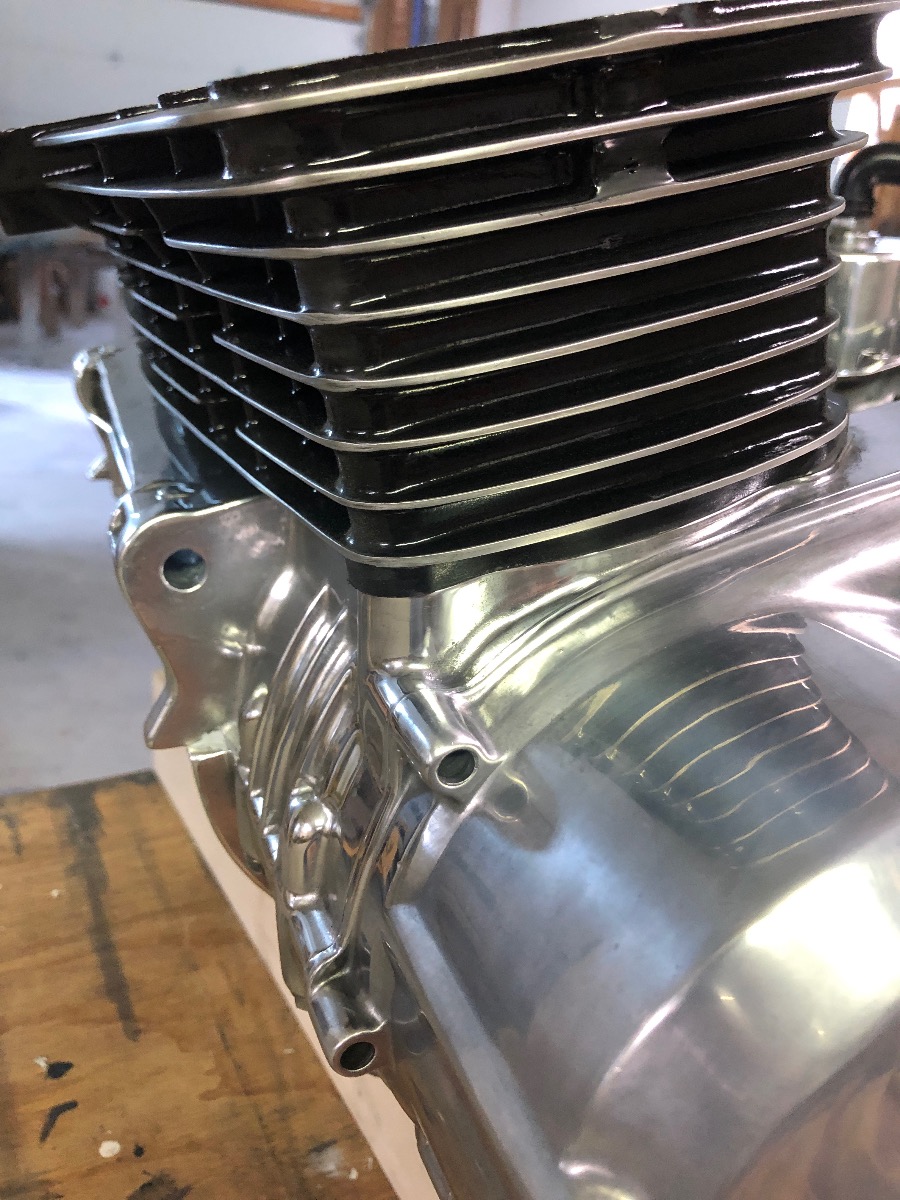

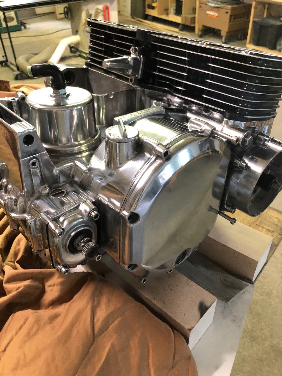

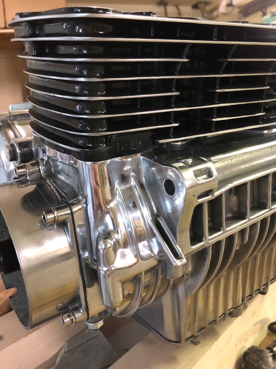

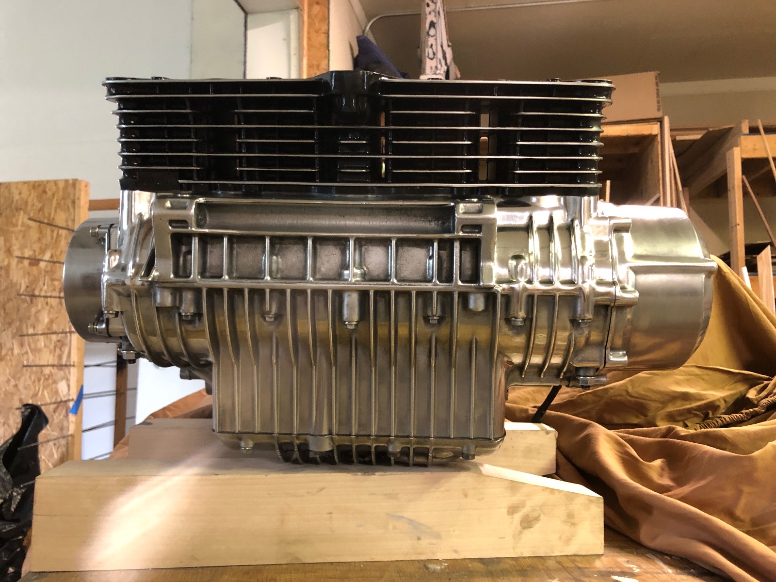

Work is still crazy, along with kids stuff every night.I Got her ready to check ring gap and install these sweet jugs.I used a glossier(VHT) black, and polished fins for this,the black helps the polish shine. I am reading up on decreeing cams on 30 threads from this site(hahaha) they are all helpful.

more
I expect a few chuckles on my maple leg temp engine polish stand(hahaha).

Great job, so far, Brad!  That motor's gonna look sweet sitting in that trike.  Carry on!

Thanks Mike, I am torn on doing the head black with polished fins as well now.I really like the Black and am leaning that way.Engine install mid week, then top end.Also thanks to Patton    out there riding in the sky for all the posts and info I have read of his.
