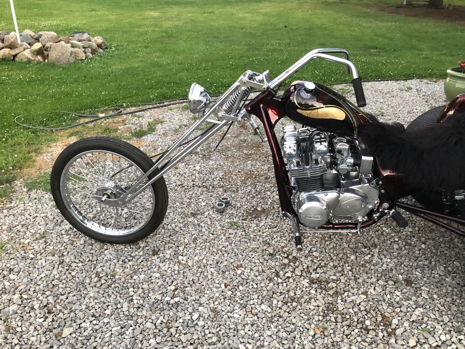

Well My Business got swamped(still is) which is a good thing.My family, camping ,sports ,etc kicked my Arse, so my dearly loved trike has sat.I am about two weeks from starting back in on her, I feel I have a good week of cleaning and going back over all my "to do" list. I am hoping to get ready to set the cams, then load her up.Then promptly take her to where a cool old Kawasaki gear head, can oversee this rookie, so I don't screw the poodle. I have had several warnings from some kick butt members as to respect this step of assembly.

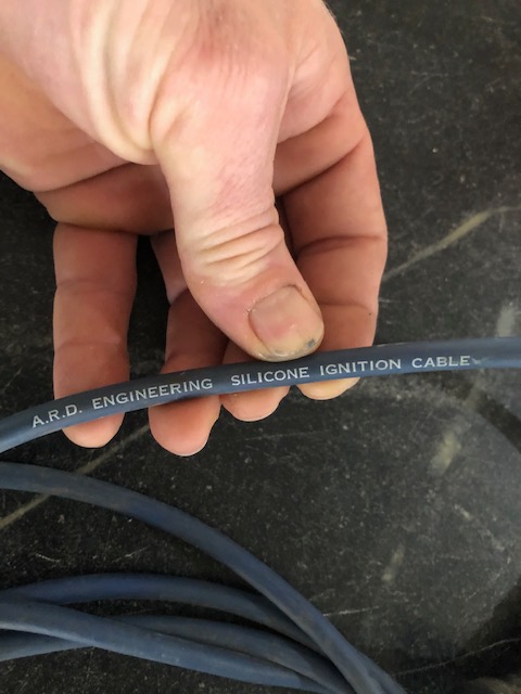

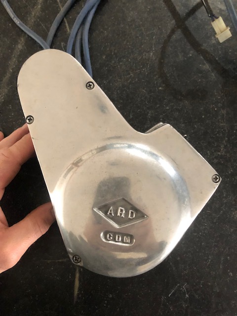

Hey all I wanted to say Thanks to wheelhop, for this Gem.

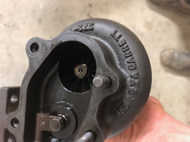

Also there is a Garret turbo headed my way, followed by a vintage mr turbo plenum, and an electric fuel pump. ........... you see where I'm going?
I freakin dig the ARD mag & set up!

The ARD is looking good Brad, glad it went to a good home and a super cool project.

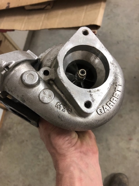

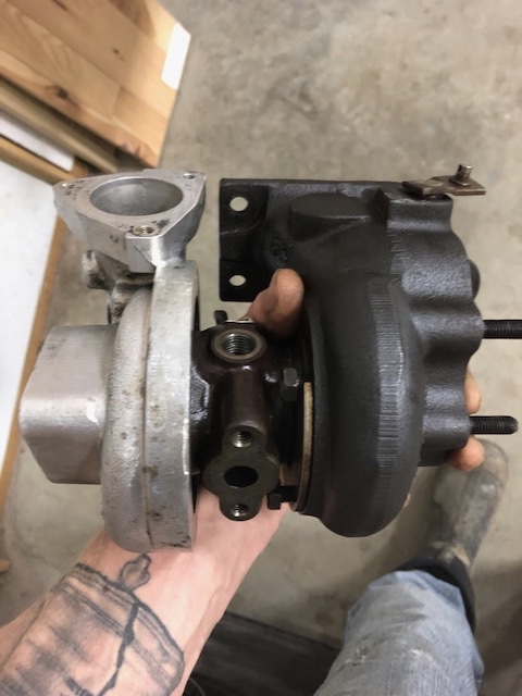

Since I have room to add an auxiliary oil tank.I am thinking of setting up the turbo to have its own oil source, separate from the engine.Does anyone see an issue with this? Seems I could put some Really good synthetic in the turbo, but I don't like them in my old bikes.I see issues with the wet clutch set up on the Z's and some of this synthetic oil for sure.

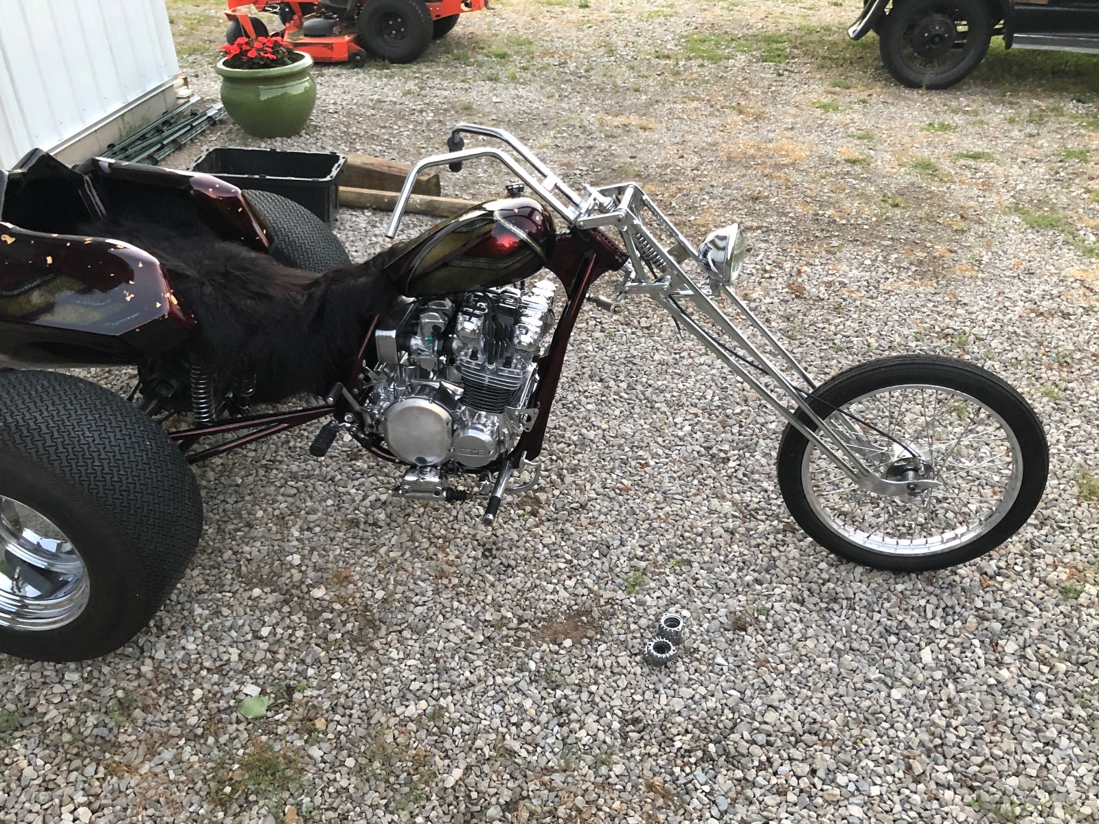

Turbo is supposed to be delivered tomorrow. I have found a ceramic rebuild kit already so I may do a draw through or a blow through.We will see when I locate what goes where this weekend. original condition of the old girl
I do intend on adding a chute and some "wheelie" bars.No belts though.

Separate oil system would be a cool feature. Just remember to feed from the top and drain from the bottom .
Turbos rely on flow , not pressure. Les and I saw a setup once that fed from the bottom . The seals are not
meant to stop leaks from a full bearing center section /
Enjoy
Enjoy
