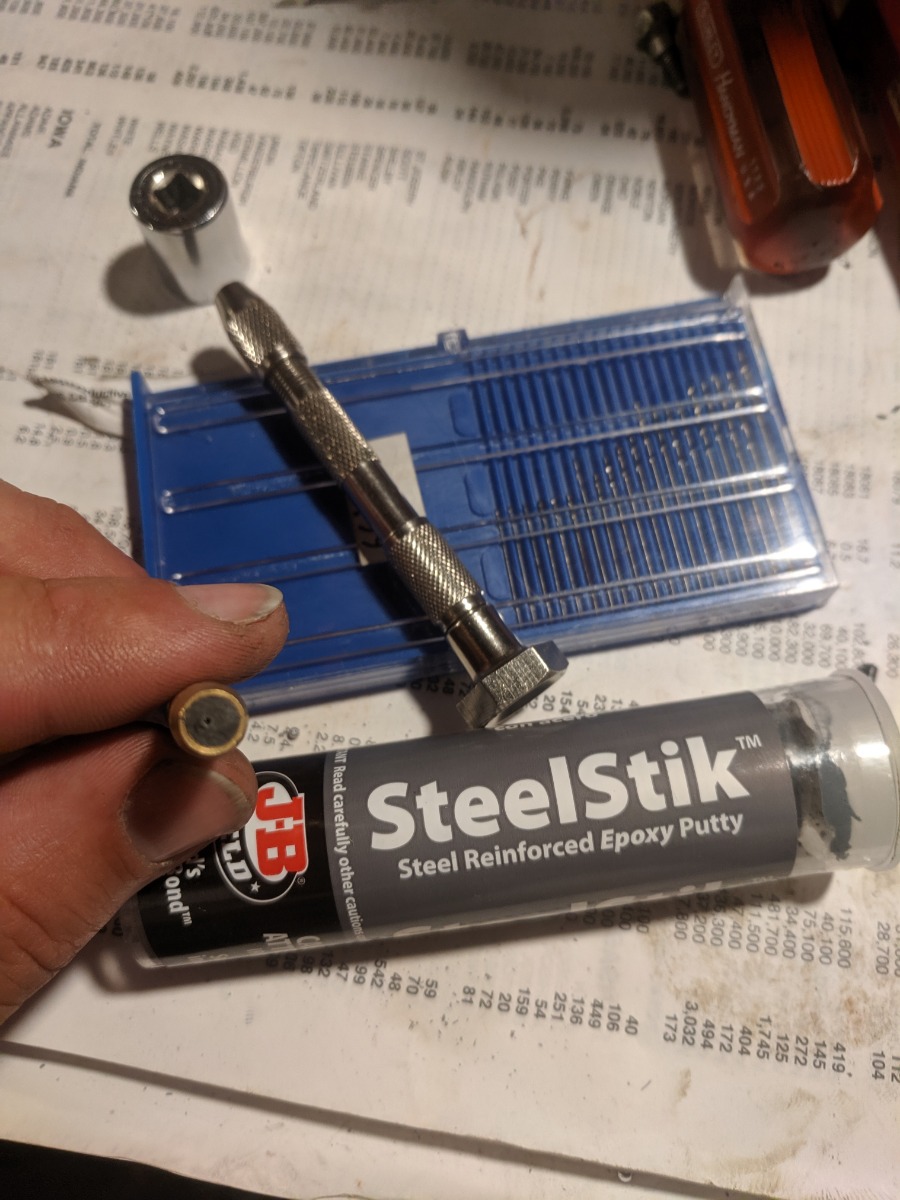

Made some diy restrictors for my carb sync bottle guages. Haven't tested them yet. Put this bike up for sale. I'll work on it until it sells.
One other thing, I can't figure out why the bike pulls right when I apply the rear brake. Where's my issue? Thanks again guys

Re: Starting a rusty '82 KZ750
13 Jul 2019 18:39
Could be a bad wheel bearing.
- Posts: 8403
14 Jul 2019 11:48
Or a loose rear axle
- Tvag06
- Posts: 116
15 Jul 2019 16:11TexasKZ wrote: Or a loose rear axle
I think the castle nut needs some tightening. Thanks!
