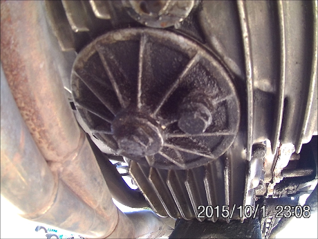

I have a problem tho maybe someone can help me with. Like an idiot, i realized when i did the oil change I forgot to place the spring back on the filter assembly [it had fallen into the motor oil and I didn't find it until I drained the pan
1. is this a problem until next oil change? Or do I have to get it in there.
2. if i have to take out the filter and reassemble with the spring, do I need to drain the oil out first to avoid a huge mess?
Thanks for any help folks.

If it's like the bigger bikes only a small amount of oil will come out. It has to go through the oil pump to get to the filter and you can take the small bolt off to drain what little oil is in it. I'd put the spring back in now.
