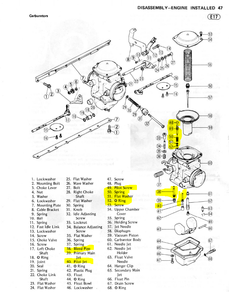

Like I mentioned earlier, you have to remove the pilots, bleed pipes, pilot screws (and spring, washer, and O-ring) and clean all the parts and passages. Light must pass through the pilots and bleed pipes or the bike won't run right if at all. You can NOT clean these parts and passages by shooting stuff through the carbs.

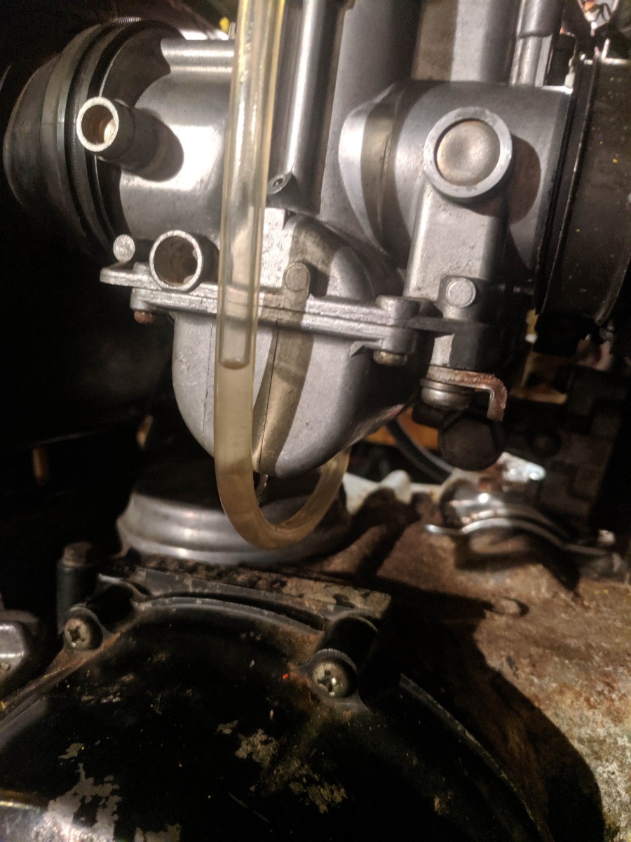

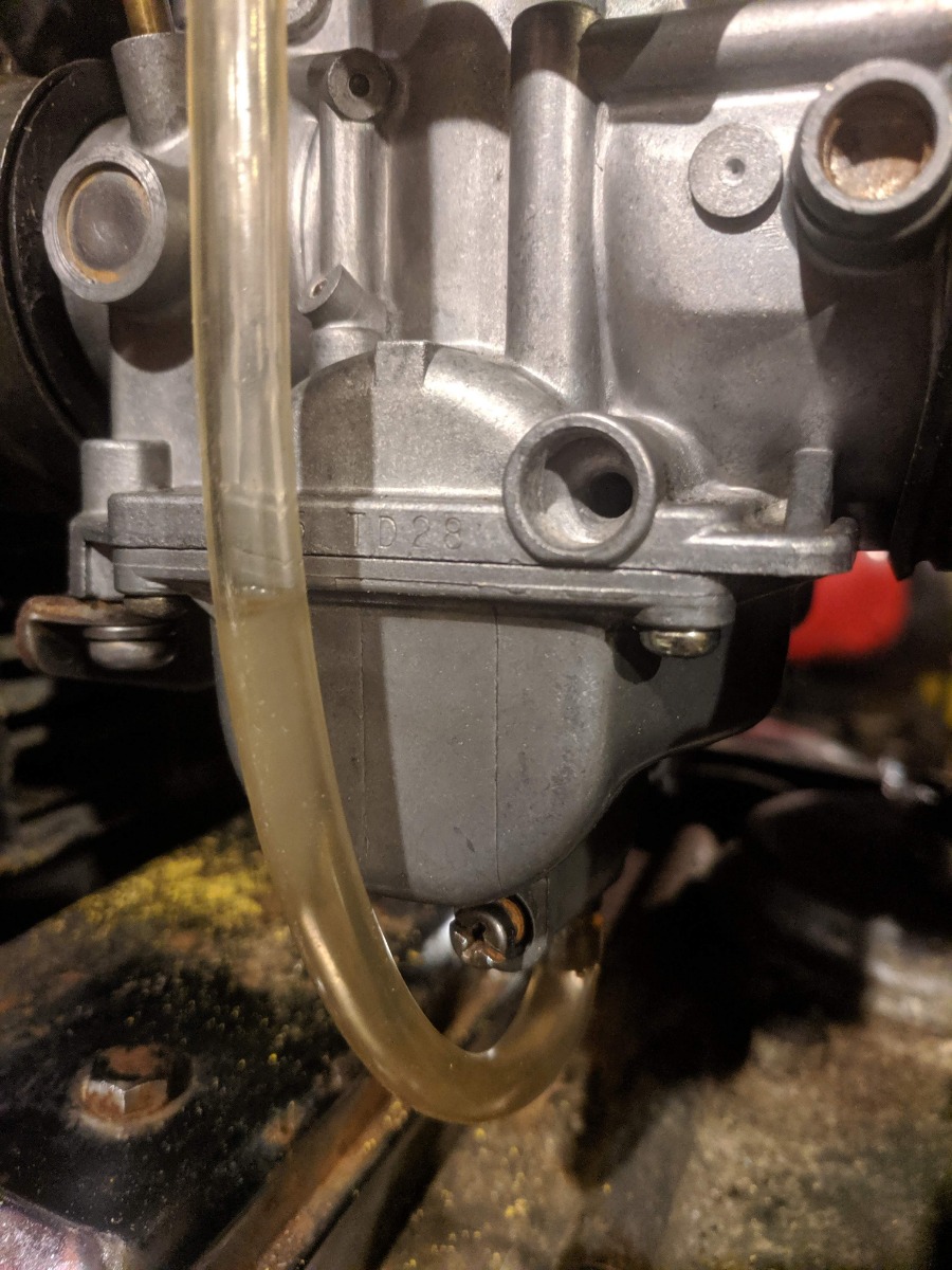

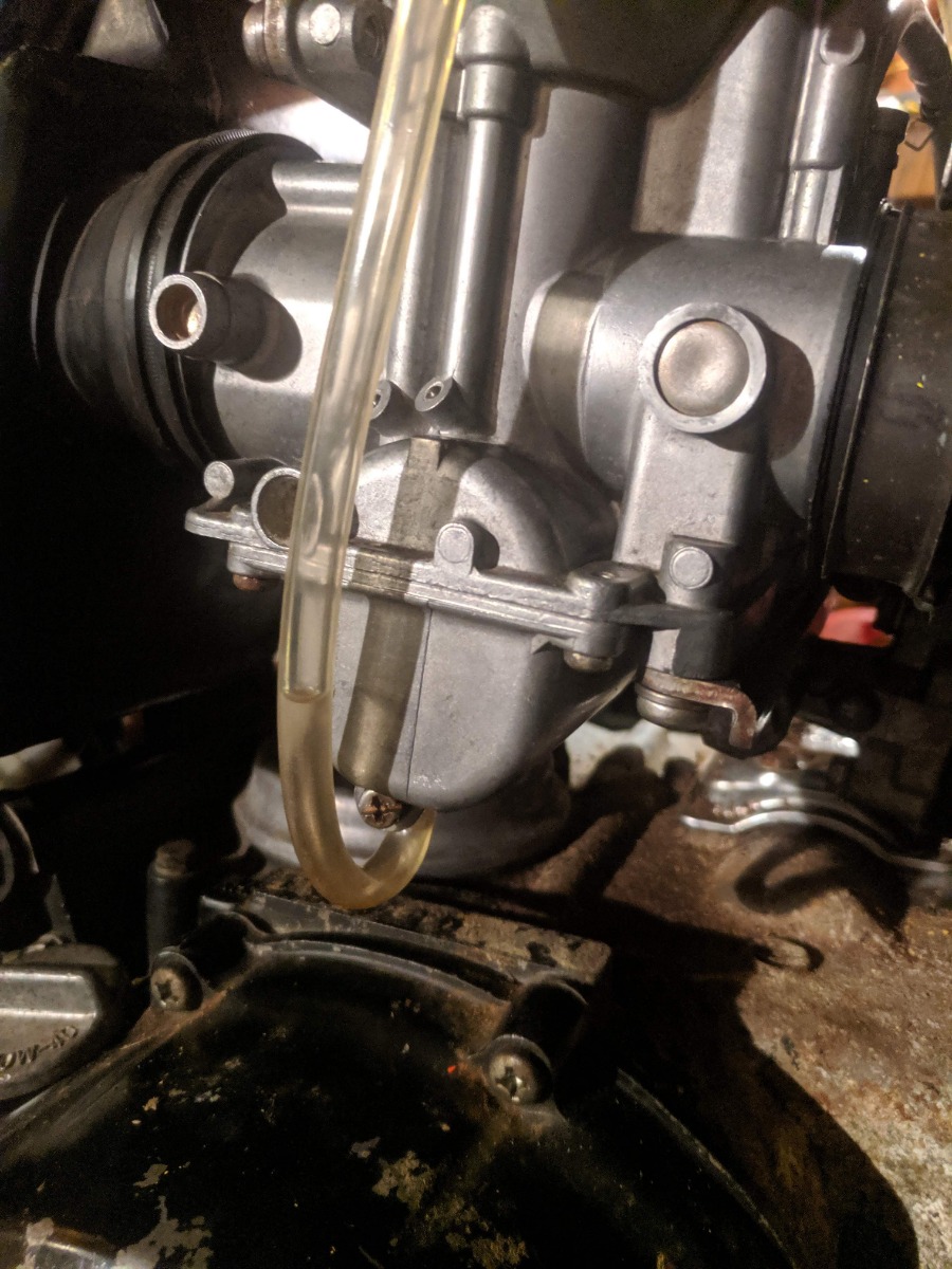

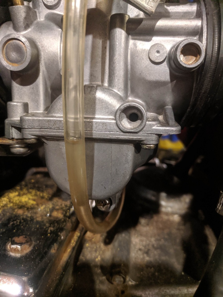

Pulled carbs again. Broke them down again. Pulled all brass and sprayed all circuits to ensure clear of debris again. Reinstalled. 1 & 2 firing, 3 firing intermittent, 4 no fire. Fuel level test results below (1 , 2, 3, 4). My adjustments to the tangs on the floats clearly did not work. Help.
'80 KZ440D - Stripped for rebuild -
kzrider.com/kunena/11-projects/611352-st...ng-a-rusty-80-kz440d
'04 Suzuki DL650 K4 V Strom
Last edit: 18 Jun 2019 20:11 by Tvag06.
- Posts: 8205
- Thanks: 3577
Re: Starting a rusty '82 KZ750
19 Jun 2019 06:18
With the fuel level so low that means the float is set too high. Did you bend the float tang down by mistake? Another option is that the float seat bore so to speak is rough and the needle isn't moving smoothly up and down in it. A piece of rolled up gray scotchbrite pad smashed down into the seat with a small screwdriver will polish up the seat. Also, when you removed the bleed pipes and pilot jets did you hold them up to a light to make sure the orifice is open? It's critical that you visually verify that the tiny hole allows light to pass through. Lastly, did you verify spark on #4?

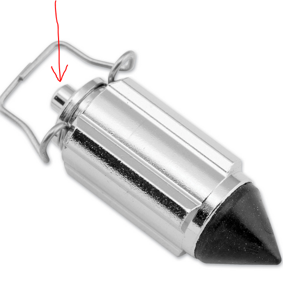

1. Tangs are set considerably lower in 3 & 4 than in 1 and 2. If the carbs are right side up, I pushed the tangs down). The floats on 3 and 4 are topping out before they even fully depress the little springy nub at the bottom of the needle. (pictured below)

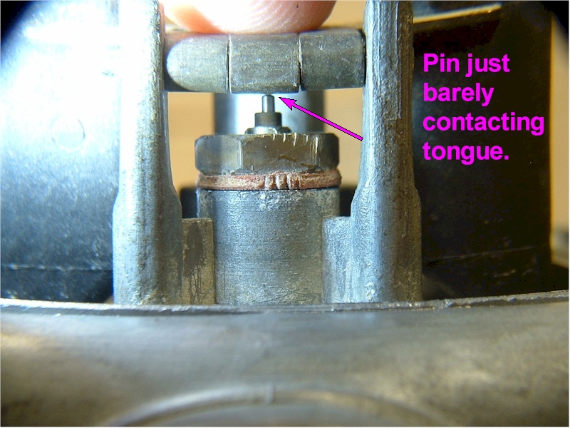

Just to get a starting point for the float high:
Position the carb Body to an angle so the float tang barly contacting the needle valve pin and do your measurment.
Last edit: 19 Jun 2019 15:42 by Scirocco.
- Posts: 8205
- Thanks: 3577
19 Jun 2019 15:46Wrong carbs. OP has CV34 Keihin's. That info is for Mikuni's.
19 Jun 2019 15:50
Thanks Nessim for the info, just miss he has Keihin carbs.
