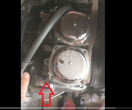

26 Jun 2019 07:18

26 Jun 2019 07:36 - 26 Jun 2019 07:38What happens if you plug that vacuum port that you have hanging open?

Yep, that´s it. Let´some extra air in and lean out the A/F Ratio = backfiring.
Looks like some more plugs are missing.

Just making sure your paying attention gentlemen. Yeah... That's it. :blush:
