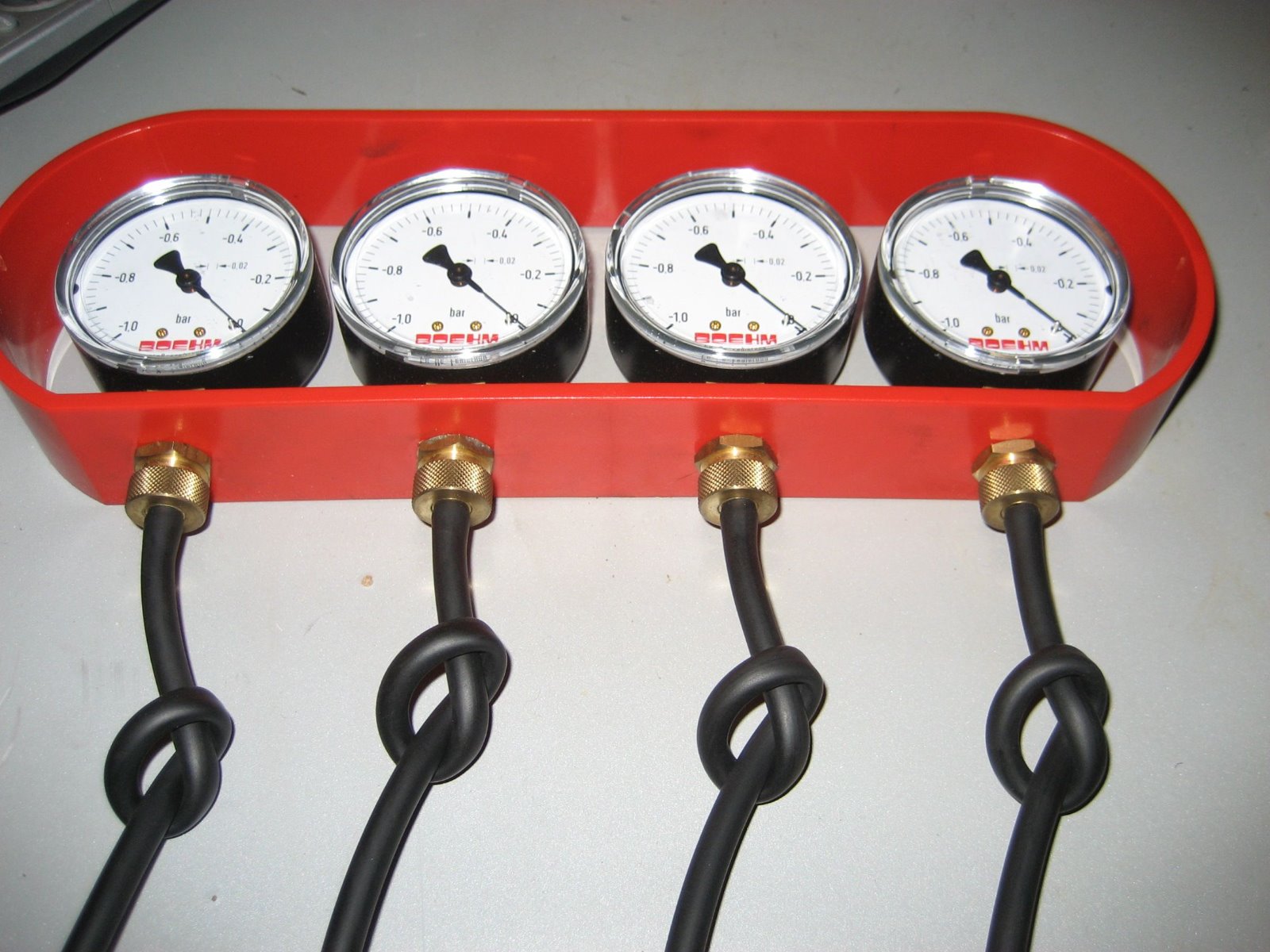

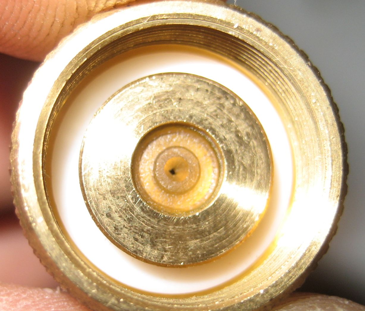

Your vaccum sync gauges need some restrictors to flatten out the vaccum pulsing.
Don“t use the gauges without any restrictor or you will destroy or de-calibrate them.
My sync gauges have adjustable restrictors to minimize the needle shaking.

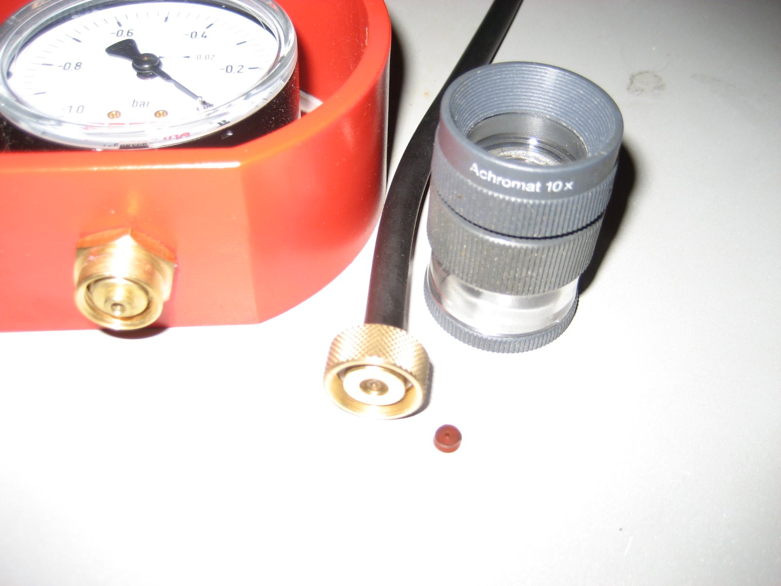

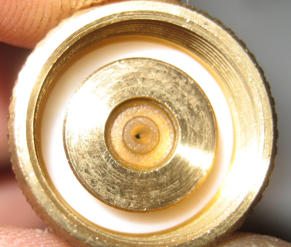

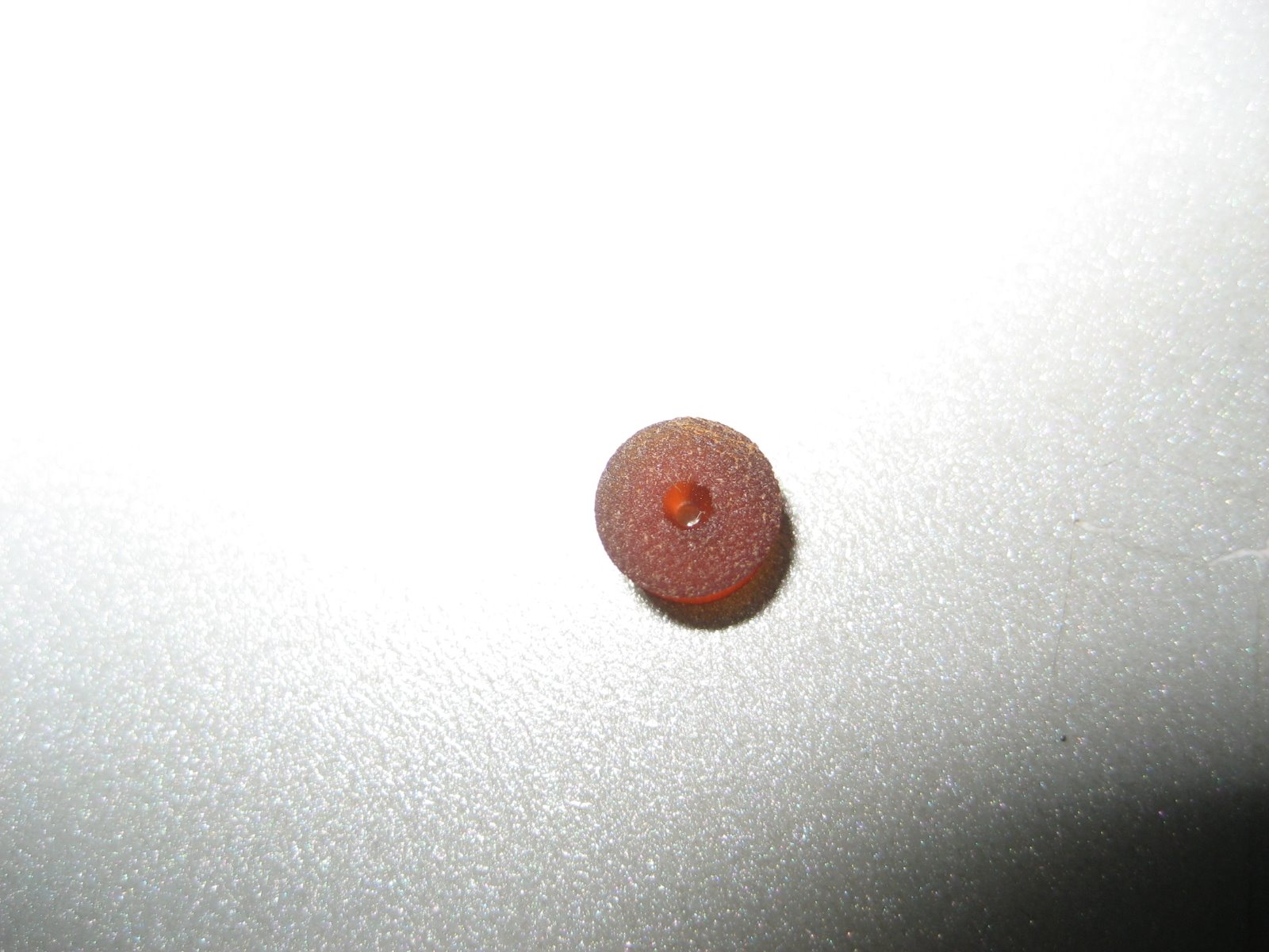

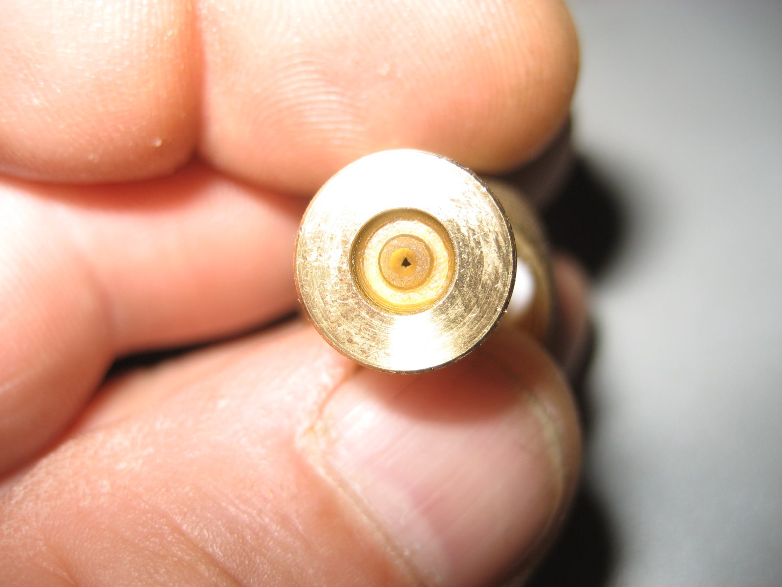

Some pics of the internal parts of the adjustable restictor mechanism
If you turn the adjuster you qweez the rubber washer and minimize the bore.
bore ID of the spare rubber washer is 0,10 mm !!!

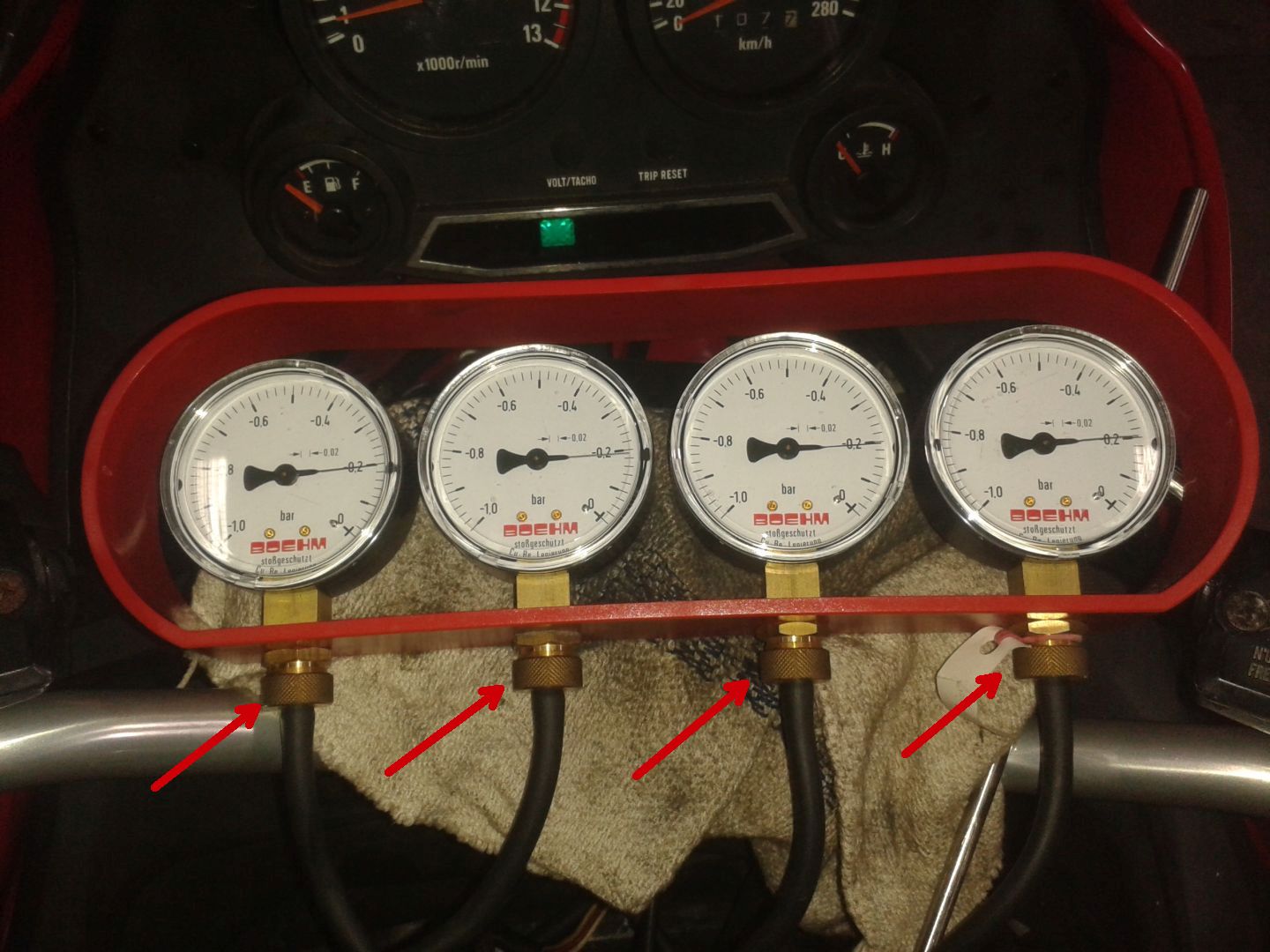

30 Jun 2019 15:16Thanks. Where do these mount exactly?

Ended up using the brass restrictor/adapters that came with the air guages and coupled them with my water bottle system. I liked my adjustments to be more fluid (pun intended). With screwdriver/socket combo tool that came with the kit, I was golden. Using that tool was like night and day over a wrench and screwdriver!!

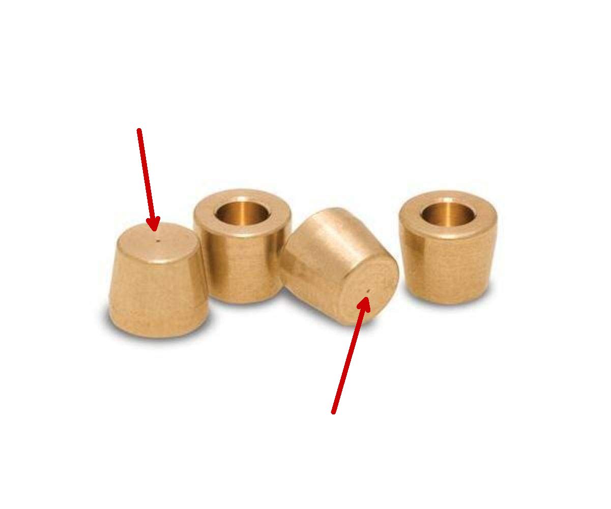

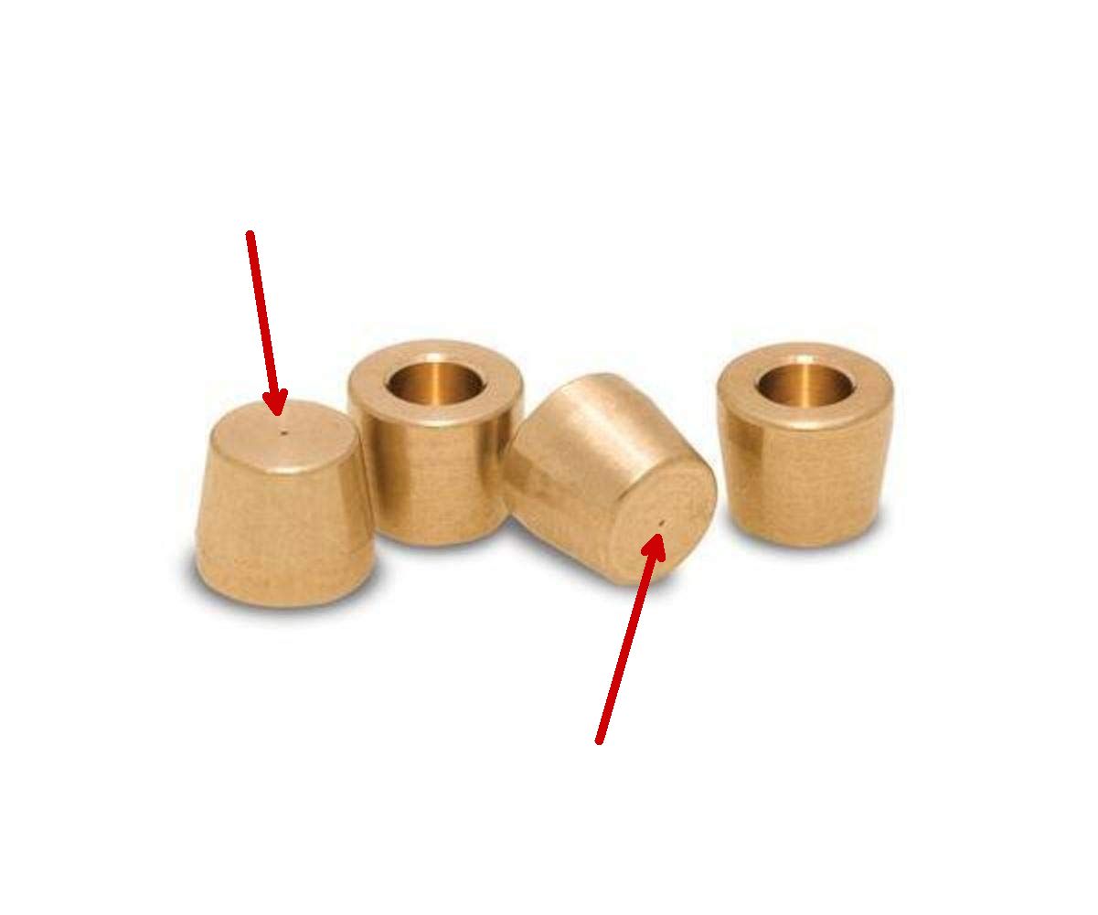

Like Scirocco shows in the photo with the brass thimbles...
It's important to have really small diameter restrictors in the hose end nearest the engine.
This isolates the volume of air in the tubing from the air in the manifold. This prevents the sync apparatus from affecting the vacuum in the manifold, and also smooths out the pulses to the gauges.
The restrictors don't need to be identical as long as they are much smaller than the tubing. Their openings need to be clear and clean. And the material needs to be rigid so they maintain their shape during the high-vacuum pulses. Some cheaper plastic ones flex under vacuum and that can affect the reading a bit. Having dirt or debris in the restrictors that affects air flow in one direction more than the other will also affect the reading a bit.
