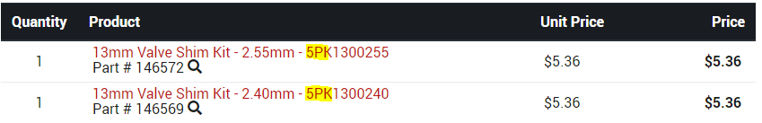

Can get a 5 pack of 13mm shims for $5 and Table B2 - Valve Clearance Adjustment Chart recommended I get 2 of each of the 240's and 255's based on my measurements and current shims. So I purchased 2 five packs from DennisKirk and with shipping that came to $18. Sold.

06 Jun 2019 05:42loudhvx wrote: That is a good deal!
Got lucky with the shim sizes needed for correction. Now lets hope these do the trick.
