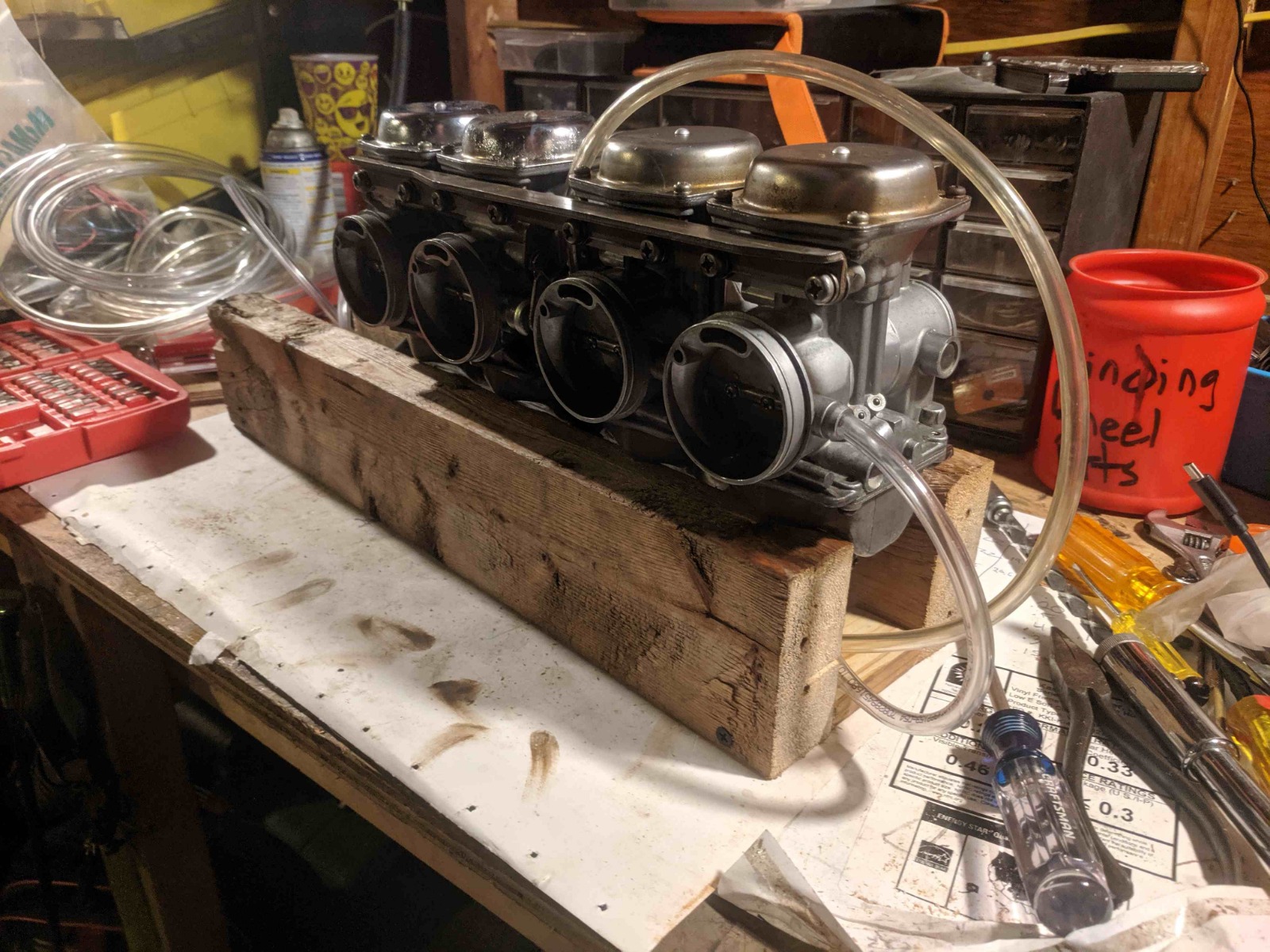

Ok. Made a stand for the carbs so I could verify the fuel height when on the bench. The float heights listed below corresponded with the fuel levels as you would expect. With the lower float heights of 3 and 4 those bowls had higher fuel levels. So what's happening when the carbs are on the bike (on its center stand)? I just don't know.
