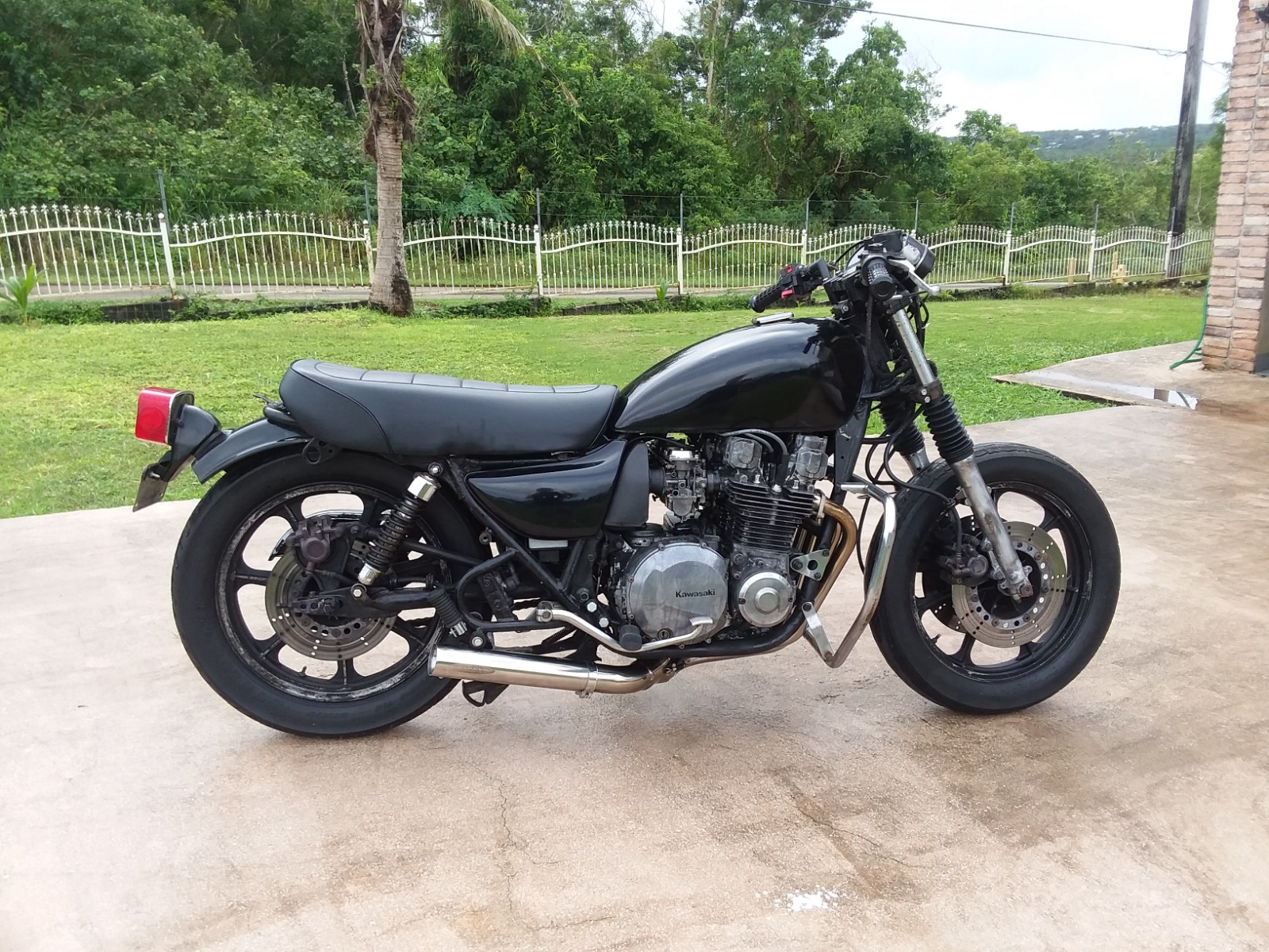

23 Dec 2018 15:34 - 23 Dec 2018 15:38Jimbo302 wrote: This bike had no mufflers, when I bought it
Isn't this your bike pic from the first post you made on this topic? Mufflers!

25 Dec 2018 15:11 - 25 Dec 2018 15:12old_kaw wrote:
No offense is being taken here my friend. I was just unclear why anyone would run open pipes on a bike that had mufflers, then saying it had none when you bought it. I kinda figured they had to be rusted out, or you would have reinstalled them. Of course, you never know what "upgrades" people will come up with while "improving" these old bikes.
c
The head pipes were the only good part of the old exhaust system. I saved them for possible future use.
The bike did not idle or ride when I bought it.
So, installed the header pipes as a quick temporary exhaust while testing carbs, clutch, brakes, etc.

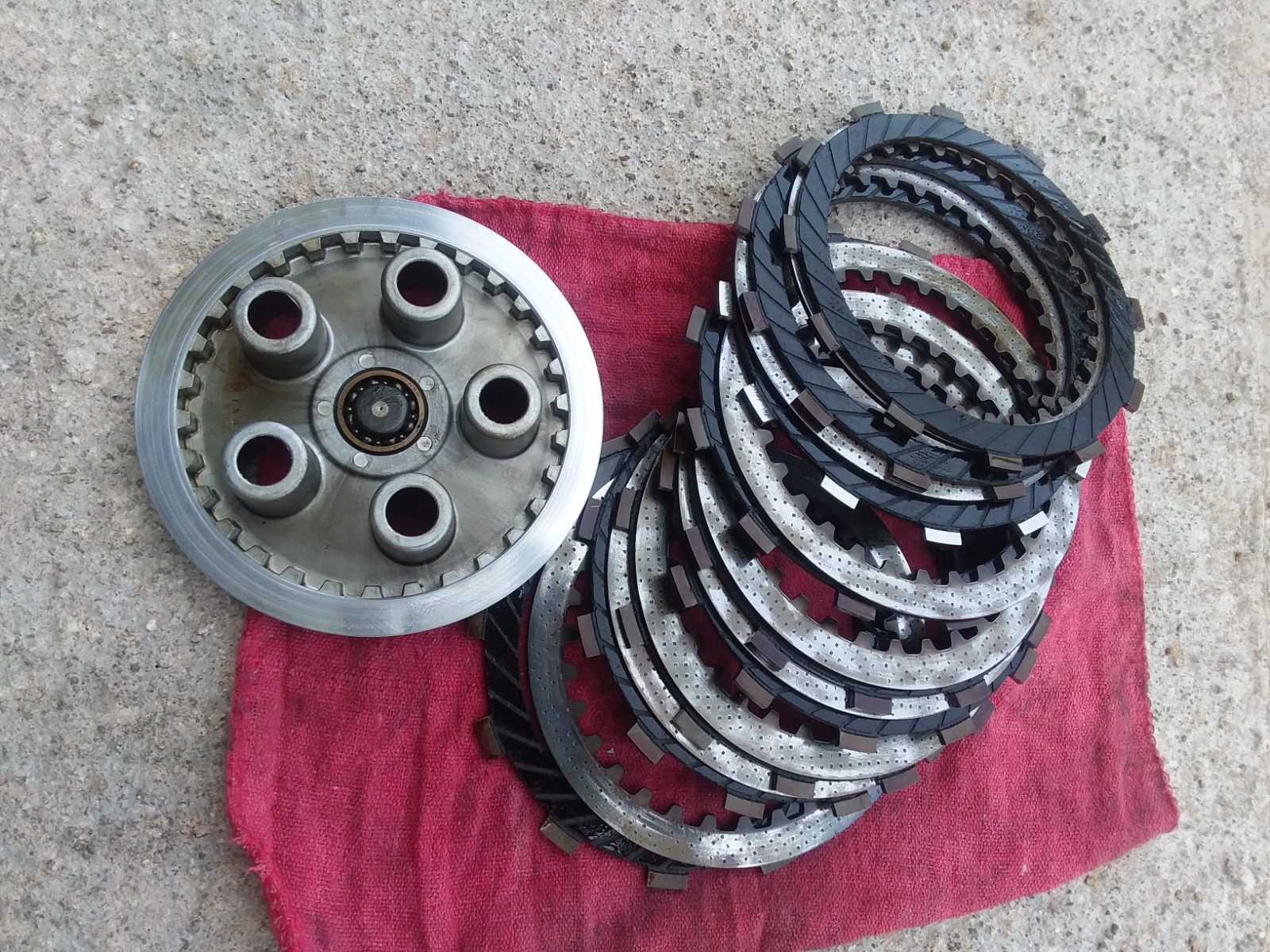

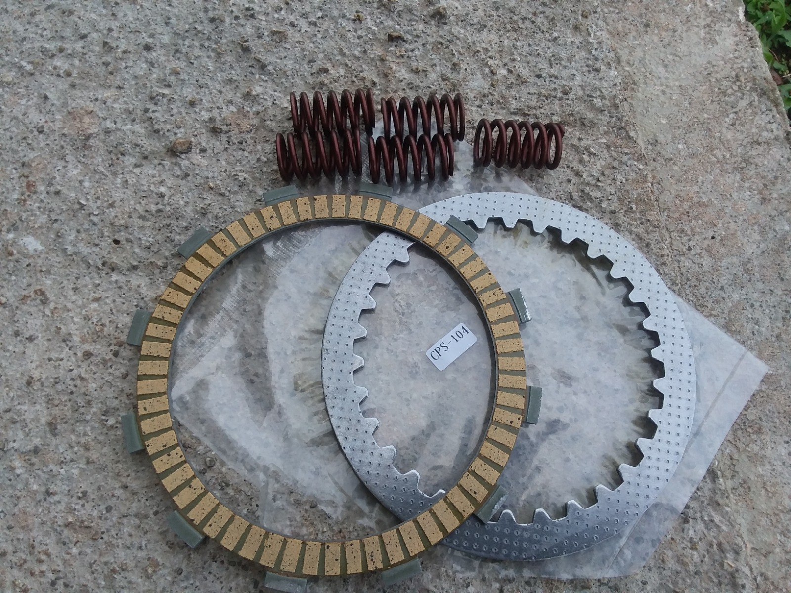

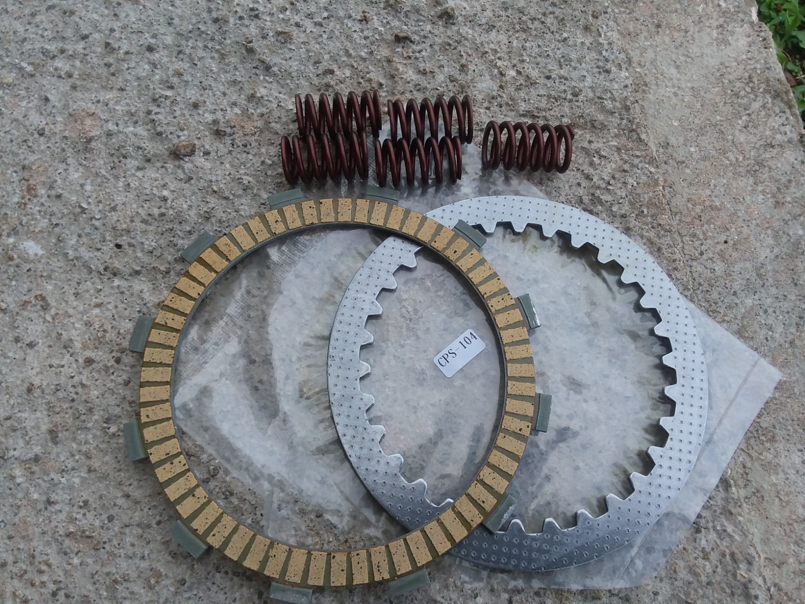

I pulled the clutch and it actually didn't look too bad.
I installed the new kit and reset the clutch rod. It does seem to grip a bit more.

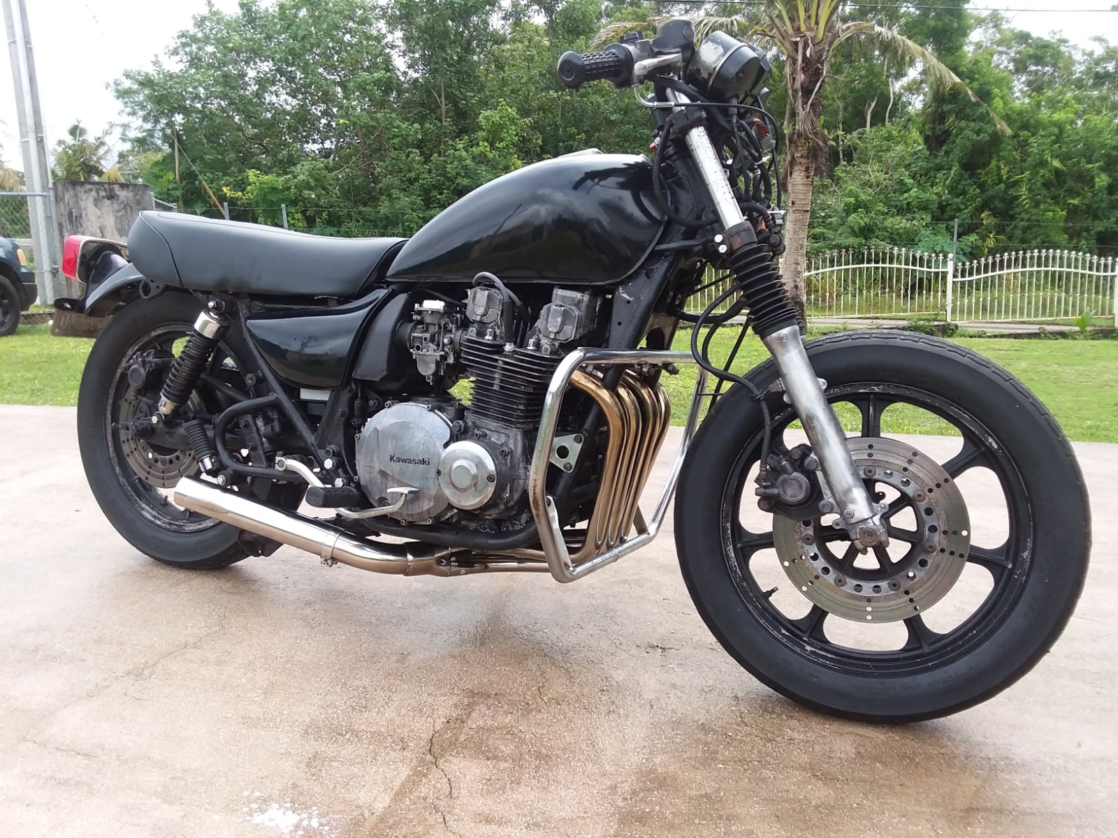

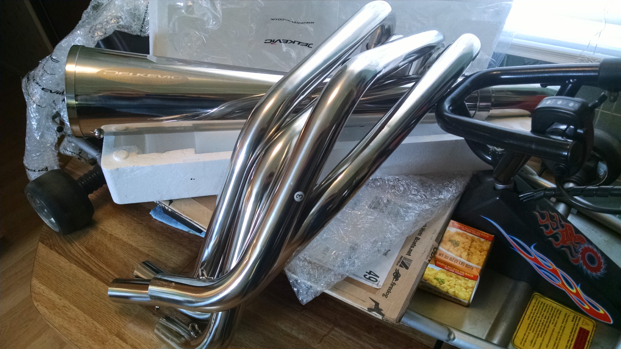

I put the Delkavic exhaust on and it sounds nice. It is a bit louder than I was expecting , but still very reasonable.
I initially turned in the mix screws to 1 1/2 for a starting point.
After a quick ride I found a stutter in full throttle mid range and slower high rpm pull, even though it shot up to 80mph quicker than I need it to.
The low end and half throttle pulls provided "diesel truck" like torque, though.
I'm going to need to fine tune them to get full throttle pull and top end power right.
I tuned each individually while idling and found a nice solid idle. I didnt note each adjustment but they are all out further than two and a half turns.
We'll see what that feels like next time out.
