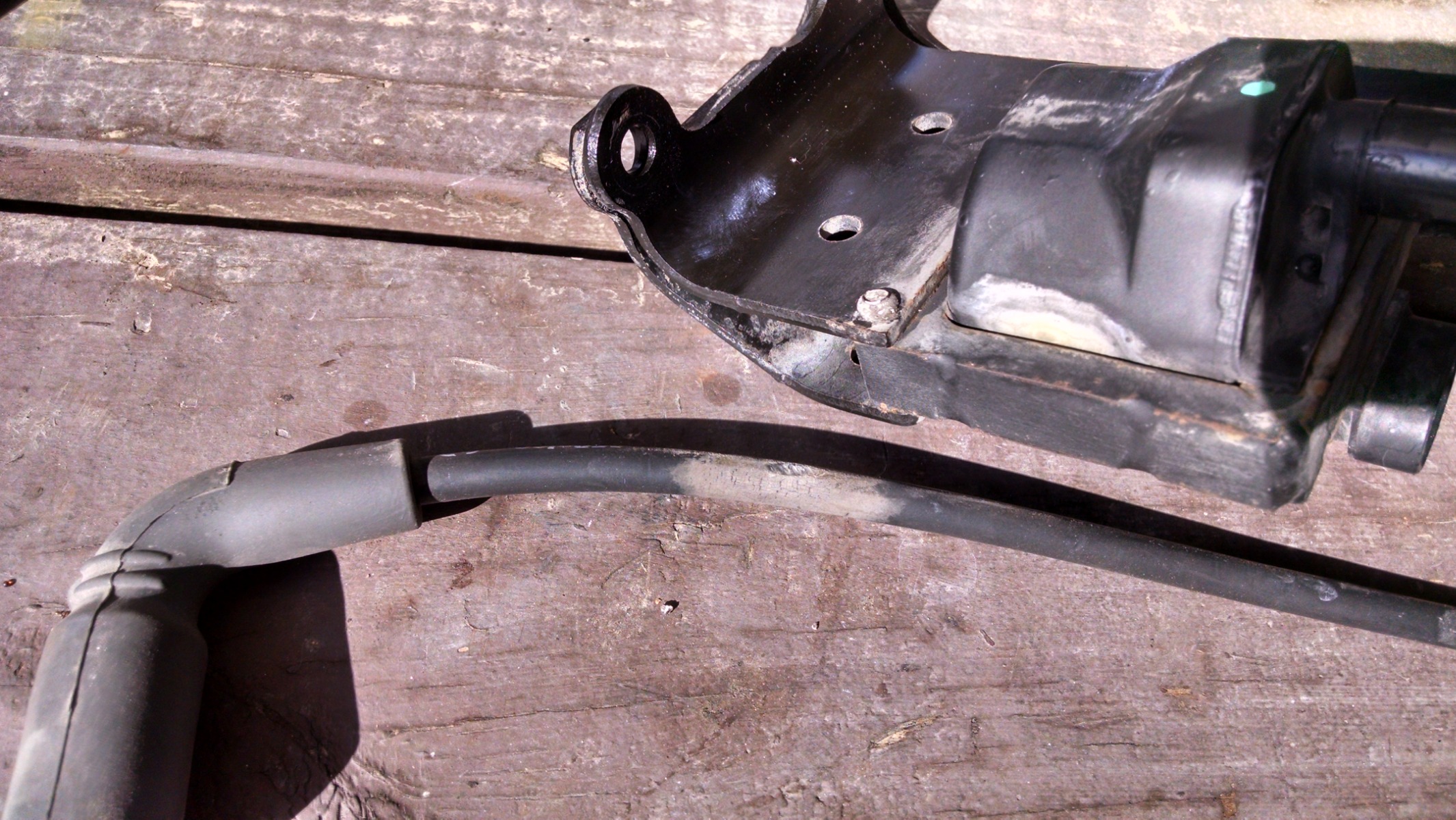

Those look to be the wrong wires anyway Jimbo. That bike should have solid core wires with NGK resistor plug caps and non-resistor plugs. (5K ohm caps) The solid core wires poke onto a nail looking pin in the coils and the NGK plug caps have screw onto the solid core wires.

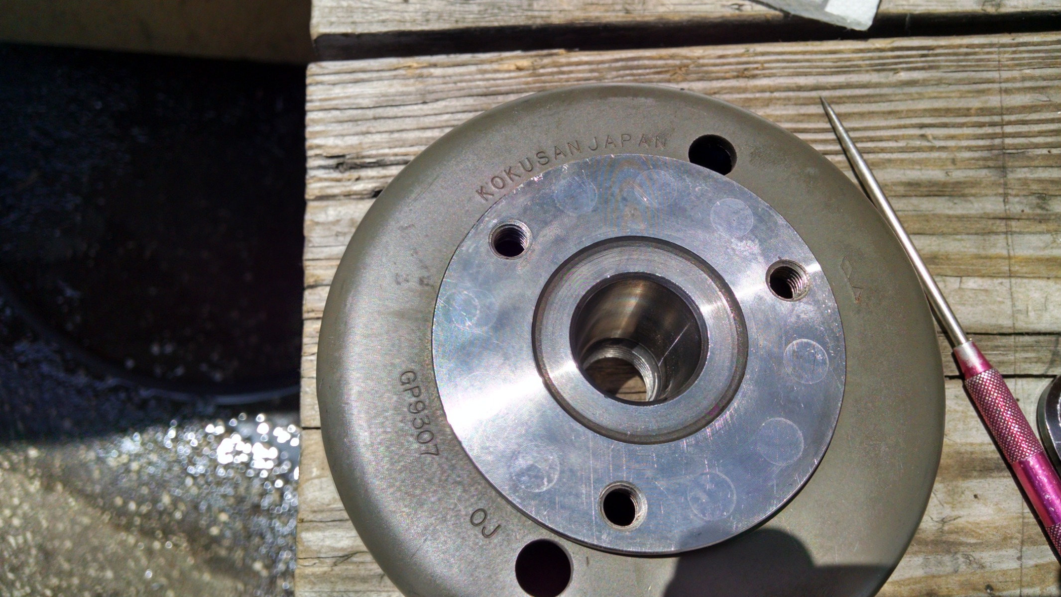

The starter clutch is a common problem, and is intensified on bikes with high miles and / or starting problems. Another common problem is that the 3 bolts holding the clutch to the rotor work loose, and rattle producing a curious noise on the left side. The rotor was a royal PITA to get off of mine, and I cringe at pounding on that pressed together crank, but I had to, give it a good smack to get that thing off.

I changed mine (83 KZ1100), the thread is the same for the rotor as the harmonic balancer puller I bought from harbor freight. All of my usual thread checkers were to small to be able to tell you the thread size for it. I cringe thinking about it, but I used a small impact on the lowest setting to get the rotor off. Use a torque wrench to put it back on. It's been working fine since. I used 1/4 nylon rope on cyl. 1 to lock down the engine, it probably took like 5 ft. at most.

Yep, they are cheapo replacement wires to replace the cracked originals.
That is exactly the issue with the starter clutch. I'm gonna have to figure out what parts I need for that.

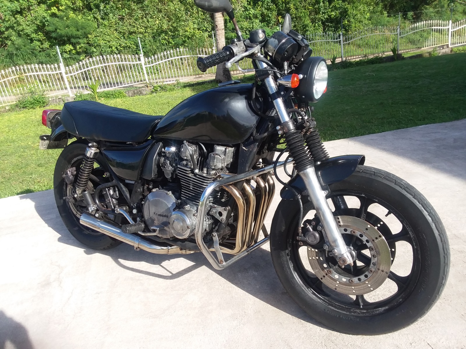

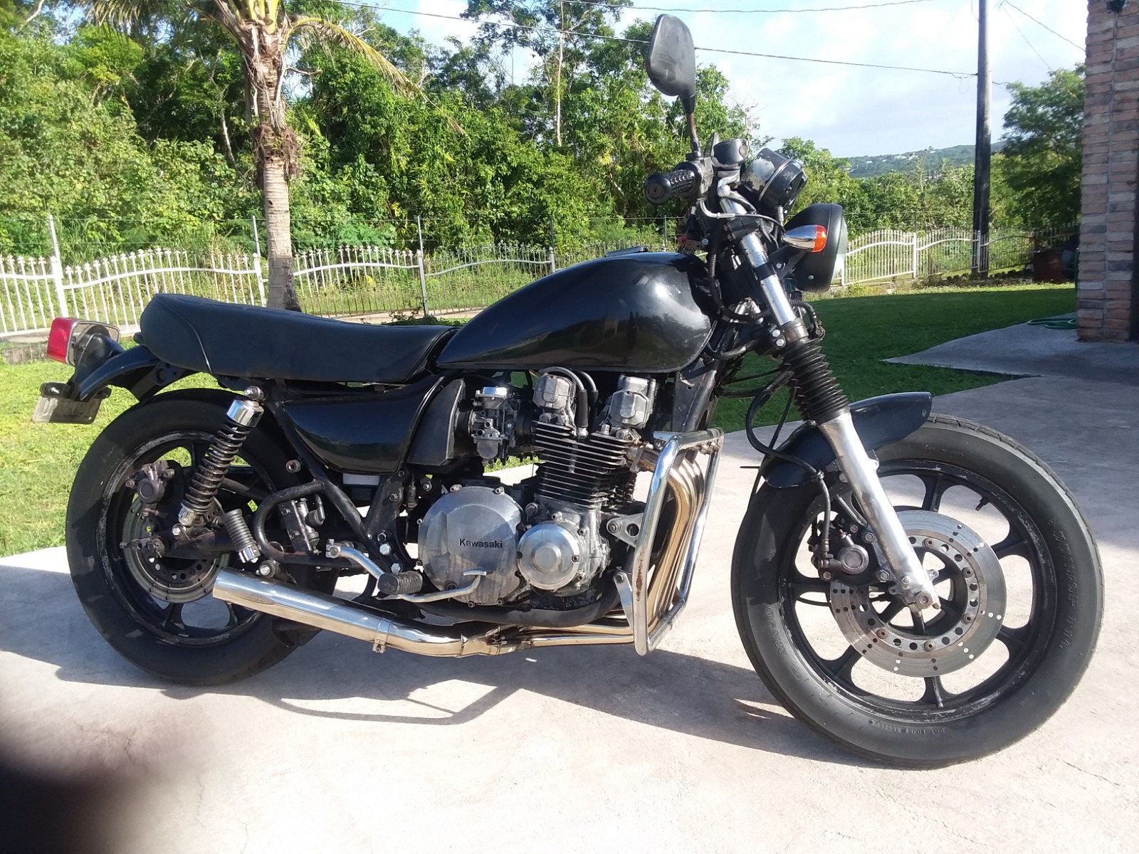

All it needs is a tail piece and maybe a couple fenders.
They have roller / spring kits for the starter, except the ramps and the race tend to wear too.
The ignition really needs to have the proper secondary resistances. Electricity is lazy and tends to take the path of least resistance. Since this is a waste spark system, 2 cylinders are affected by ignition electrical misfires. If the ignition coil pulse finds less resistance by arcing internally, than it does to the plugs, it will arc a path inside the coil, and not look back. At this point the coil is ruined from using the wrong ignition parts. You probably found the cause of your high rev misfire right here.
THEN< all of the "advice" to put on that modestly priced aftermarket system, when all that was initially needed was the proper replacement parts.
What came first? The wire arcing open to the dip tube, then the coil? (from my truck)

04 Jan 2019 08:53SWest wrote: All it needs is a tail piece and maybe a couple fenders.
You mean the "duck bill"?

I had ordered a KZ900 tail/seat cowl "duckbill" off eBay, but at this point it looks as though it may be lost in shipping.
