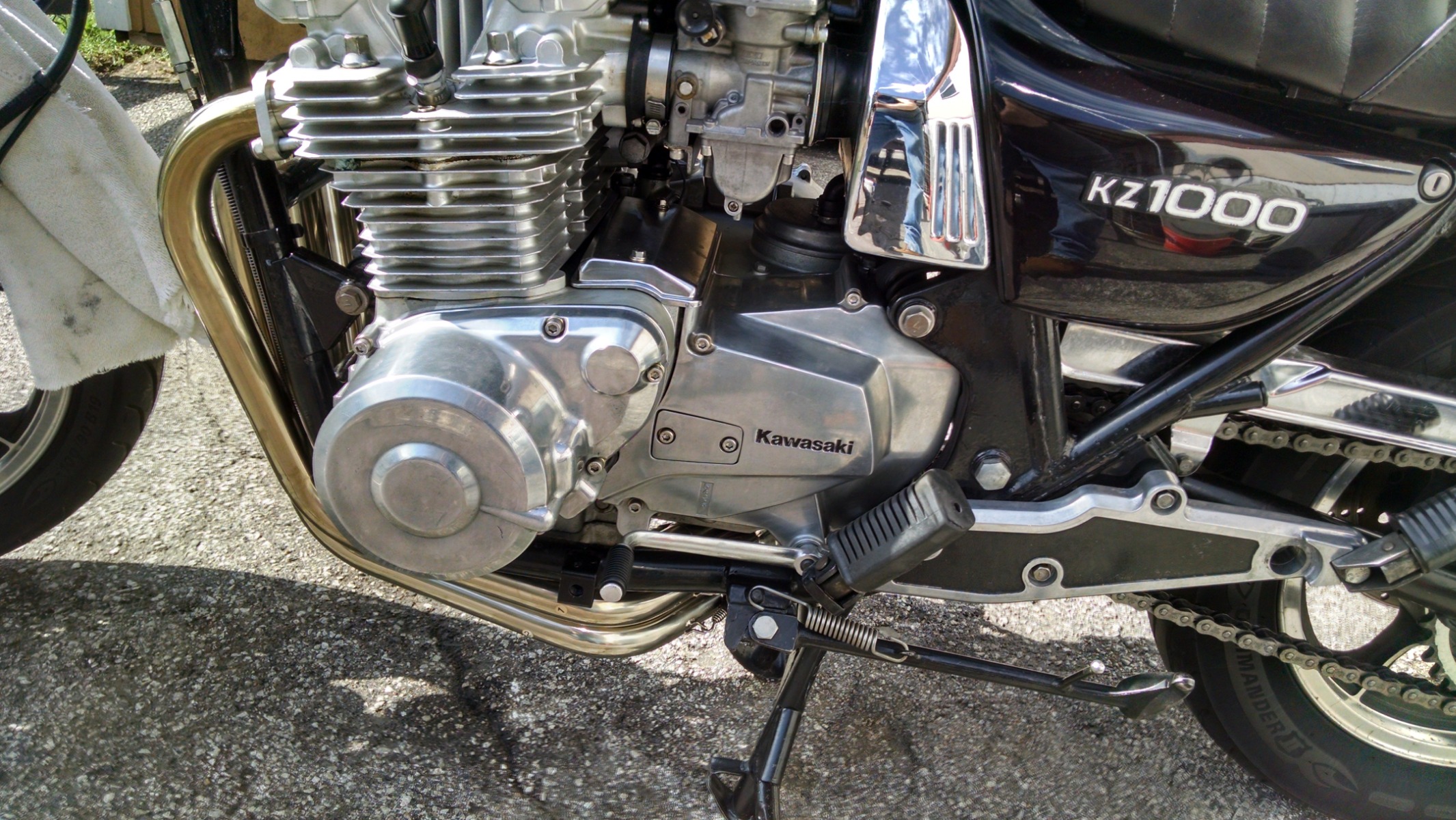

I adjusted the mix screws and 1,2 and 4 liked 3 turns out , while 3 was happier at 2 out and didnt drag the engine down when turned lower.
The low end power is solid and revs well, but full throttle pulls seem choppy until the rpms rise. I'm gonna have to dig back into the carbs.

Lookin good there Jimbo!
Don't sweat the screw settings, but I do look for consistency on their settings. because if there is too much difference, it could indicate other problems such as a partially plugged passage, leaking carb holder, valve not sealing etc.

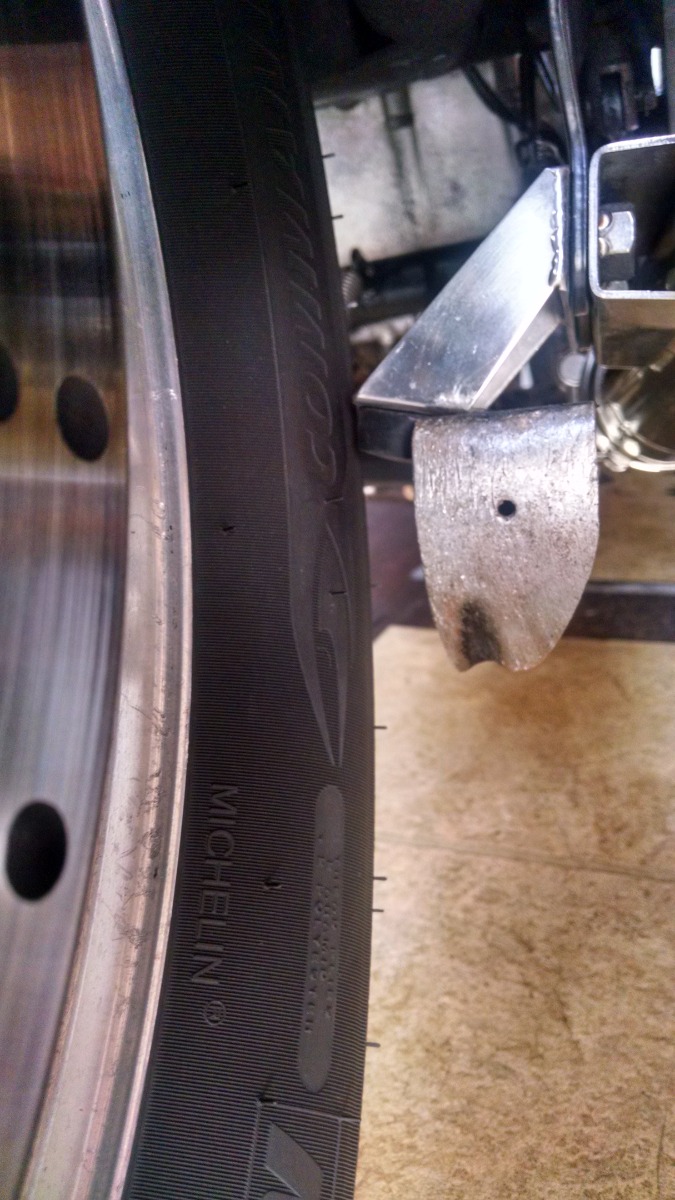

02 Jan 2019 14:10 - 02 Jan 2019 14:12What poish? lol
It's hibernating. I haven't even looked at the bike in a few weeks. I may get it out next Sunday since a high in the 60's is forecast.
I need to fix this:

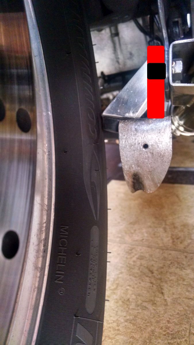

Yep, easy peasy. Fabricating in the cramped, cold 10X10' shed, not so much. Nowhere near as easy as MS painting it in.
