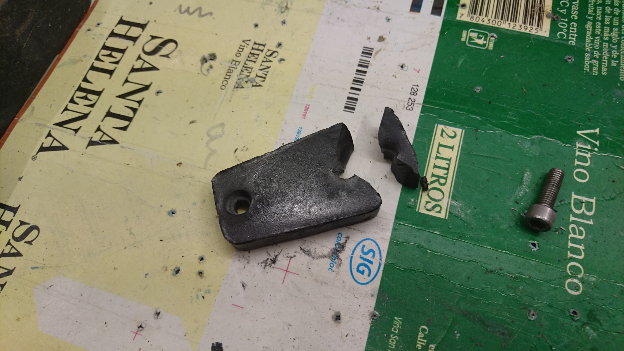

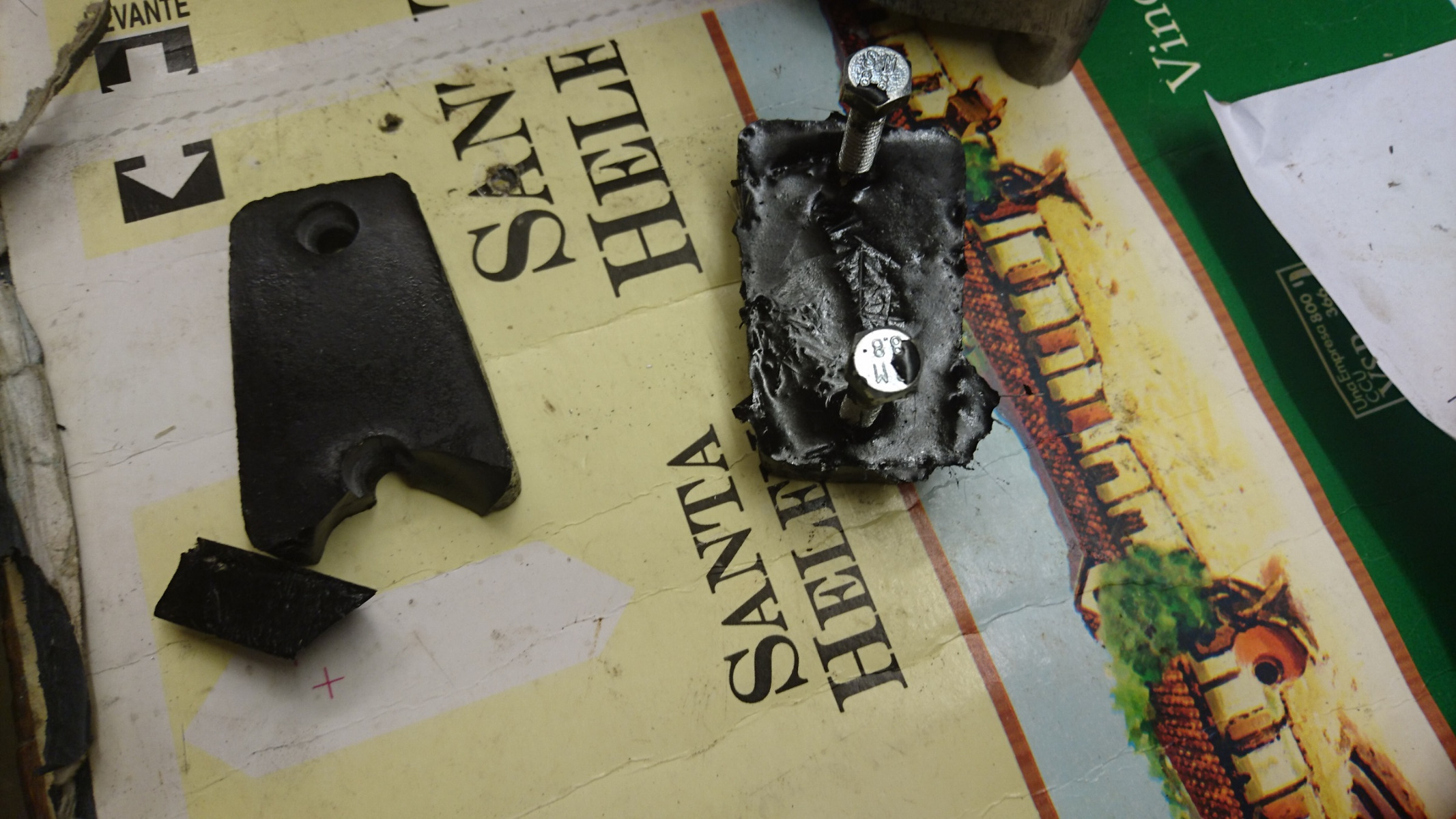

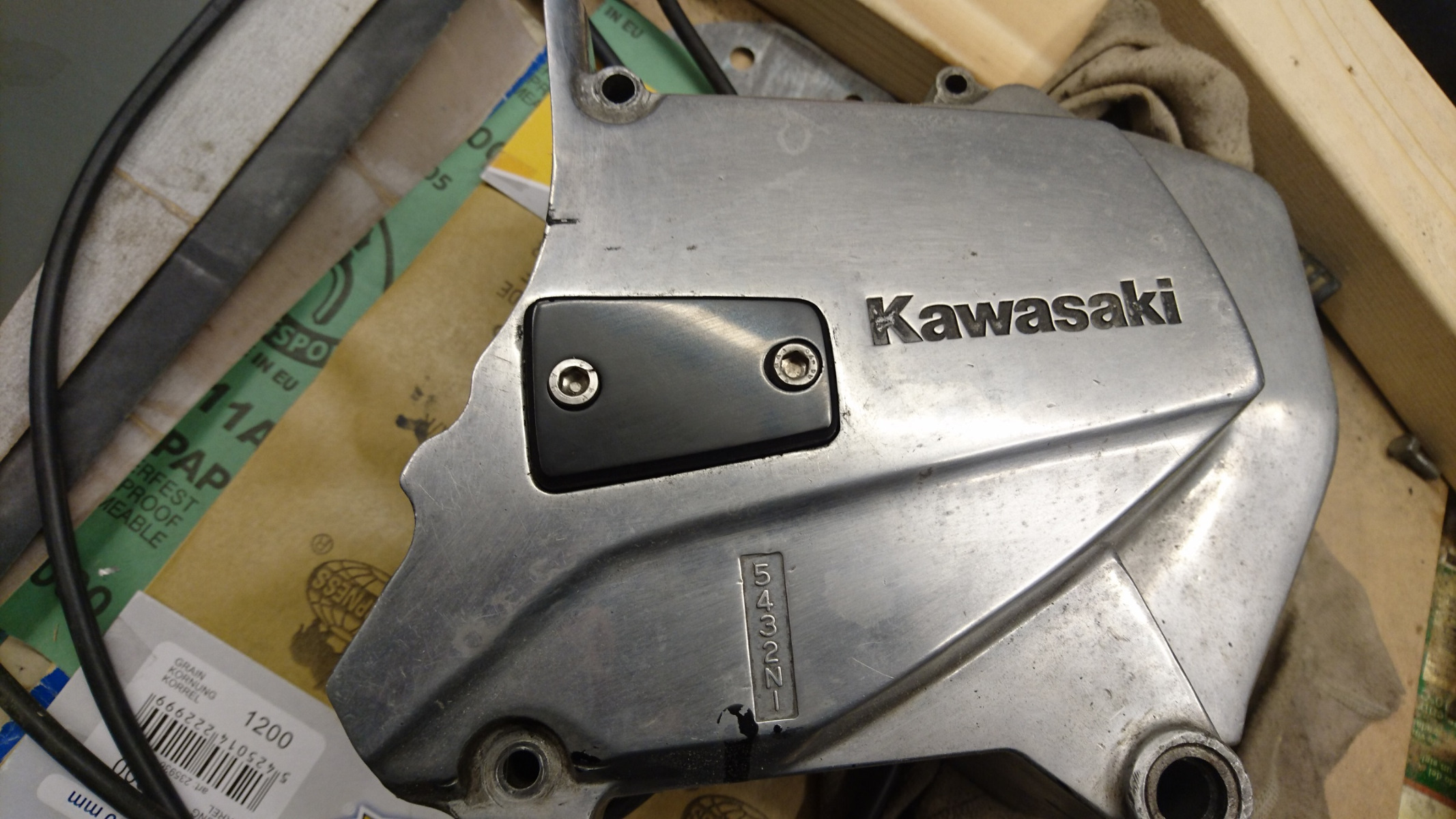

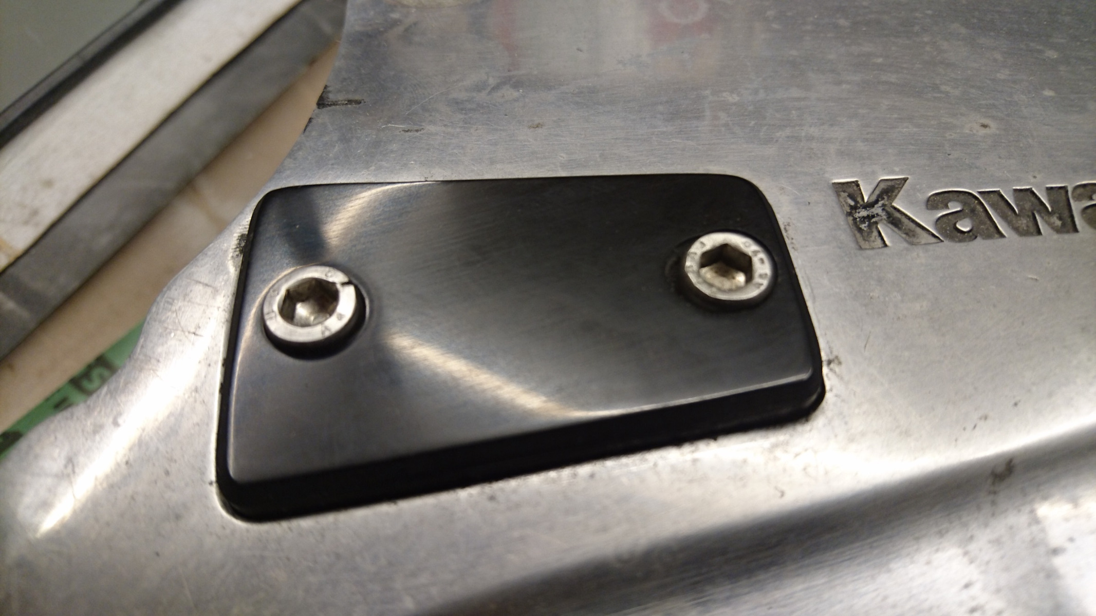

The problem is though,Polyester is pretty brittle and without the fiber in it, this can happen;
Other products are available,I know and far better suited for this but I had the polyester left over, so I did the whole process again but this time I stuffed it with fiberglass.
Not as beautiful, but a good bit stronger. I sanded it back,drilled and countersunk the bolt holes and fitted it (very carefully).
Ill polish it up eventually, when I get round to it.

i like that you had go at the cable end and the clutch adj.cover.
not necessarily the way i would have gone about it.
but you have opened my eyes to a couple different ways of doing things that i may be able to incorporate into future repairs.
btw,are you a member of advrider.com/ it is a good resource and place to make connections for that tet/tat/rtw adventure ride you are planning.
keep us posted,

Nice job on a cable and cover. I hope the cable end stays put for many miles.

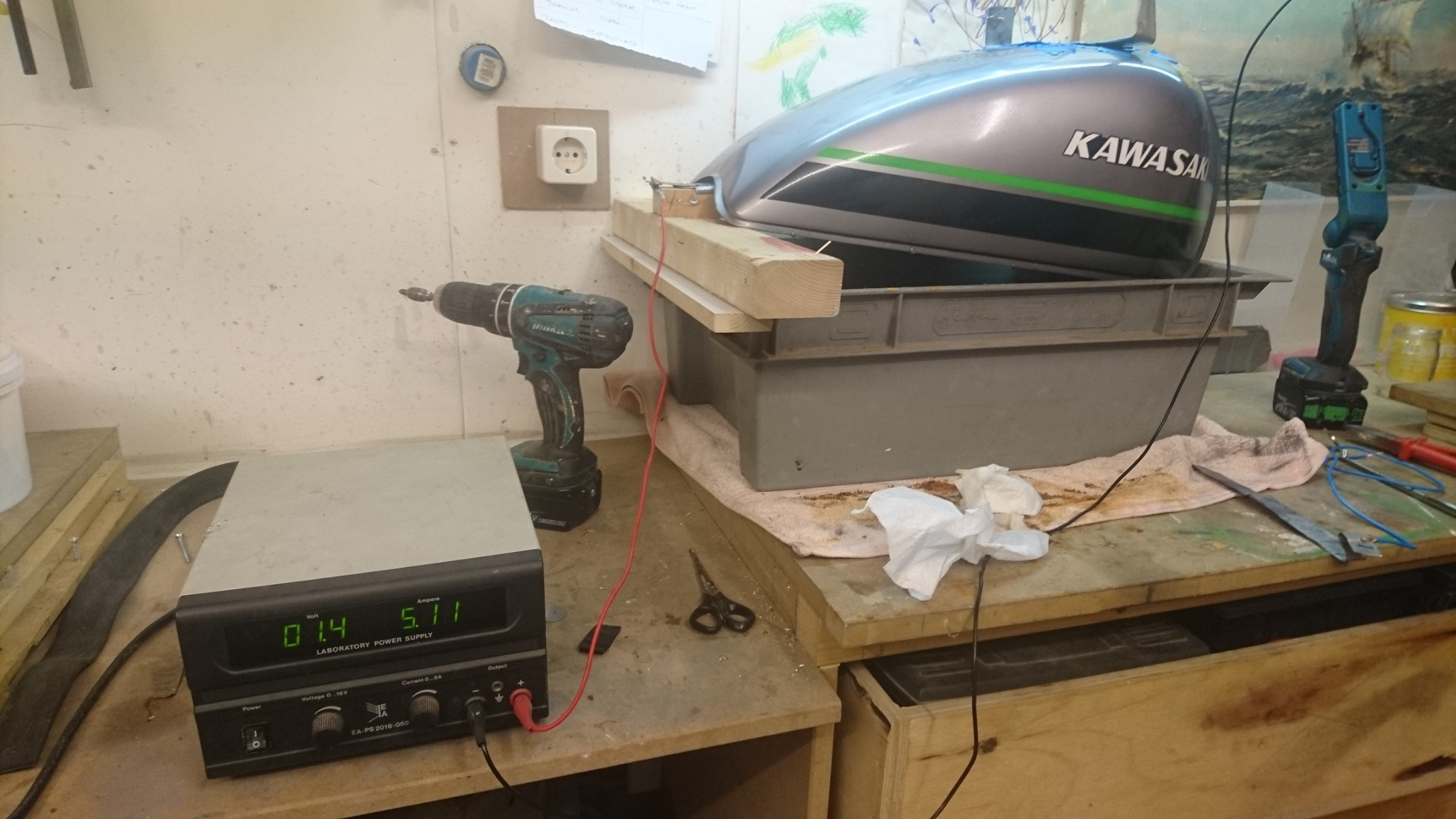

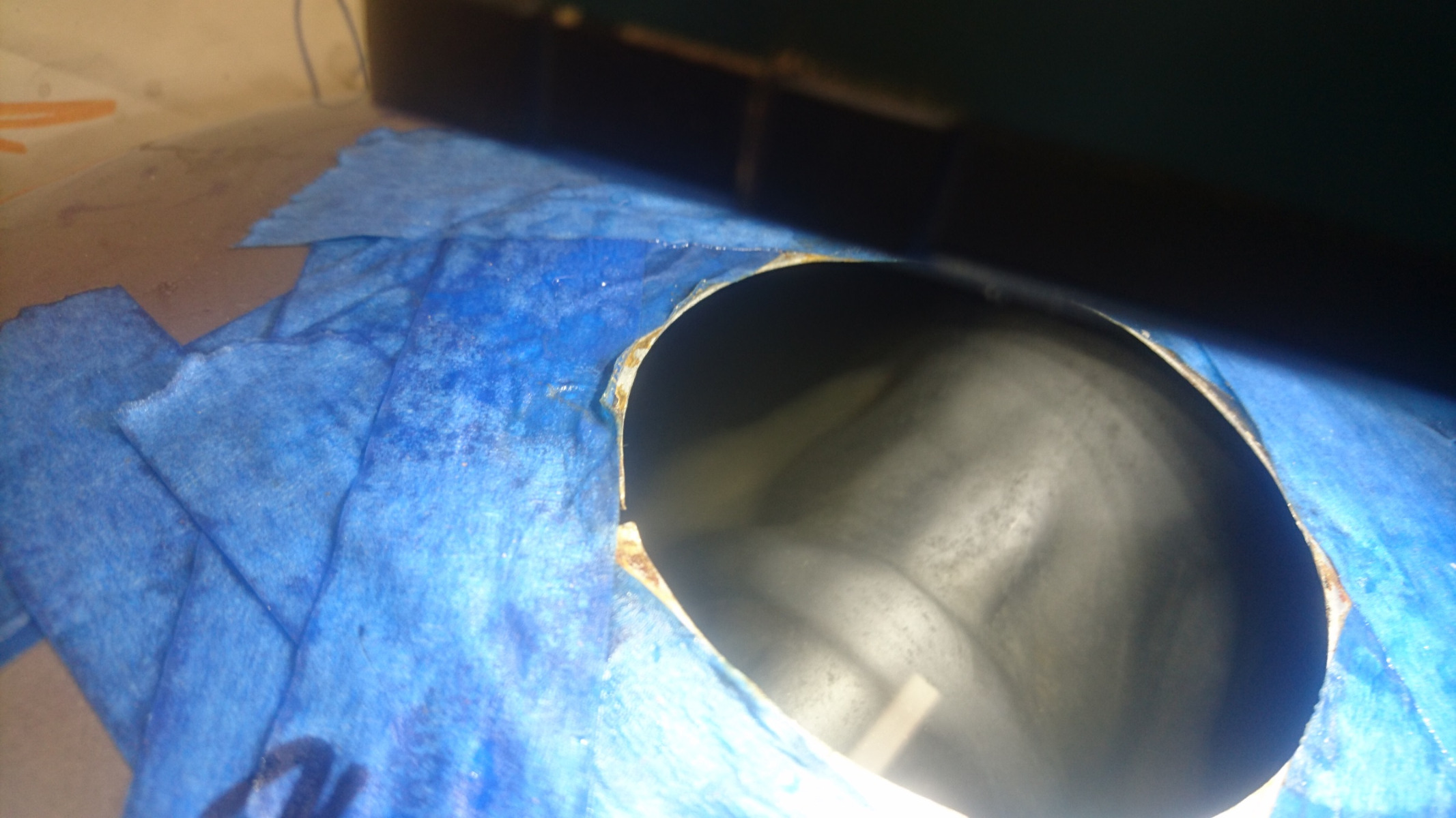

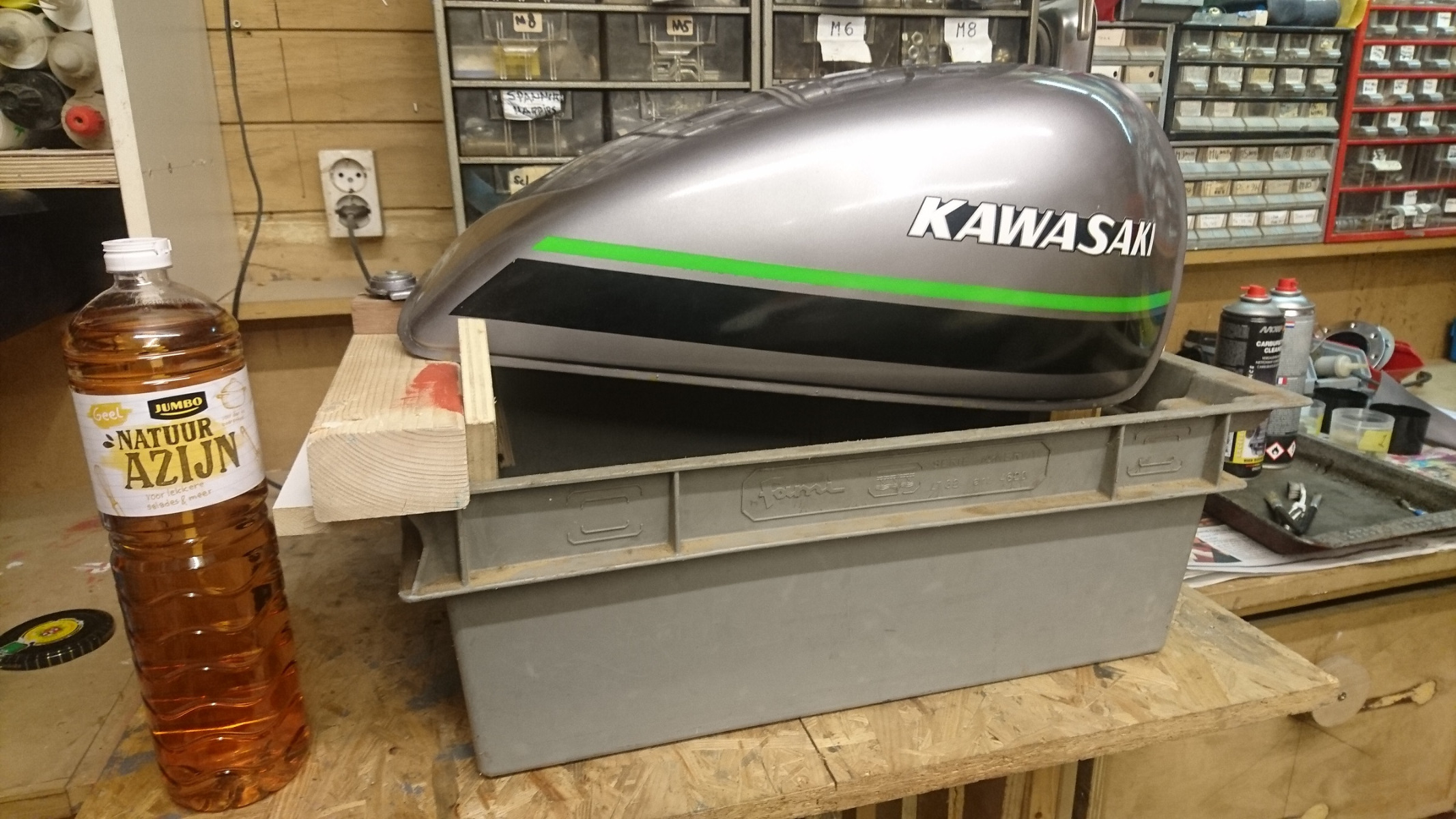

I did quite a bit of research into plating the tank. Nobody on the internet had had a go,as far as I could find. A lot of people said that it couldnt be done but couldnt give a good reason why. I dsicounted the Faradys cage problem as I reckoned if you can strip the rust off the inside with electolysis, why not the other way round?. Getting the tank totally clean is also not such a big deal. Done it before.(Though other problems lay therein!) So, in the name of science,I decided to have a go at it. What have I got to lose?

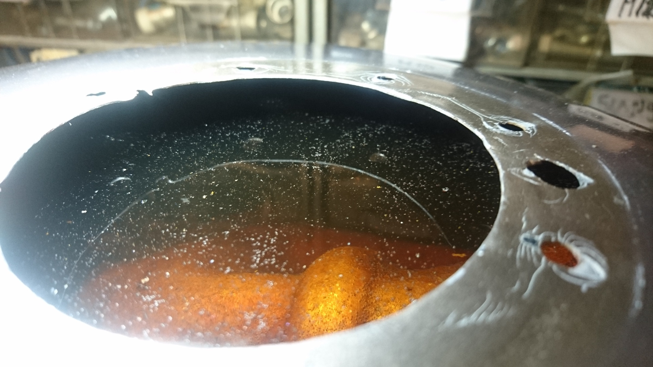

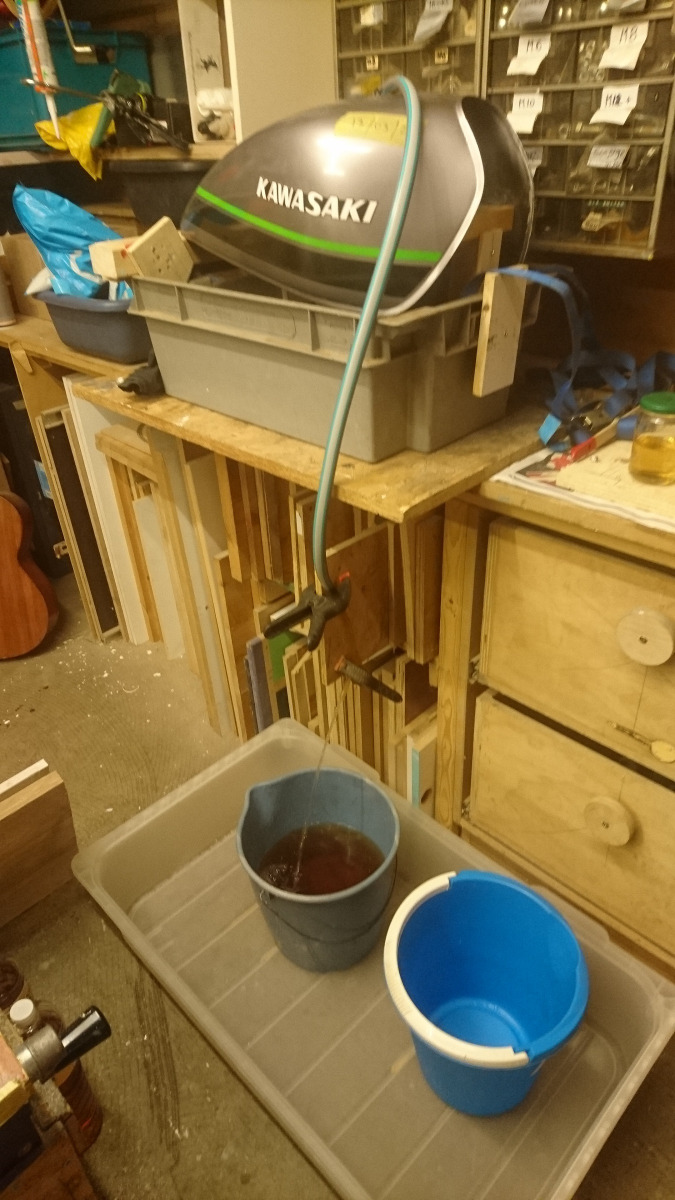

First thing was to clean it out and get the rust out. Ive had success in the past with brown vinegar.
A very messy process but it works.
The problem though!! Is that normally,I would rinse it out with soda to neutralise the vinegar then spray it with WD40 to stop the flash rust. This is no good for plating as it needs to be rust free AND grease free. So,I ended up with flash rust.
Fuel tap was just a case of stripping,dipping,cleaning,polishing and reassembly. Carbs also pretty much.Though I did end up re-plating a lot of the smaller bits. I also invested in a powdercoat set up and thought it would be rude not to treat the tops and bowls to a nice powdercoated finish. Thats all done now. and Ill post some photos when Ive finished reassembly.
So,now just the tank!!

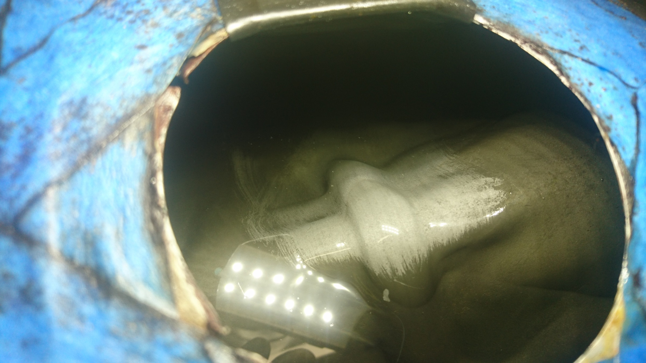

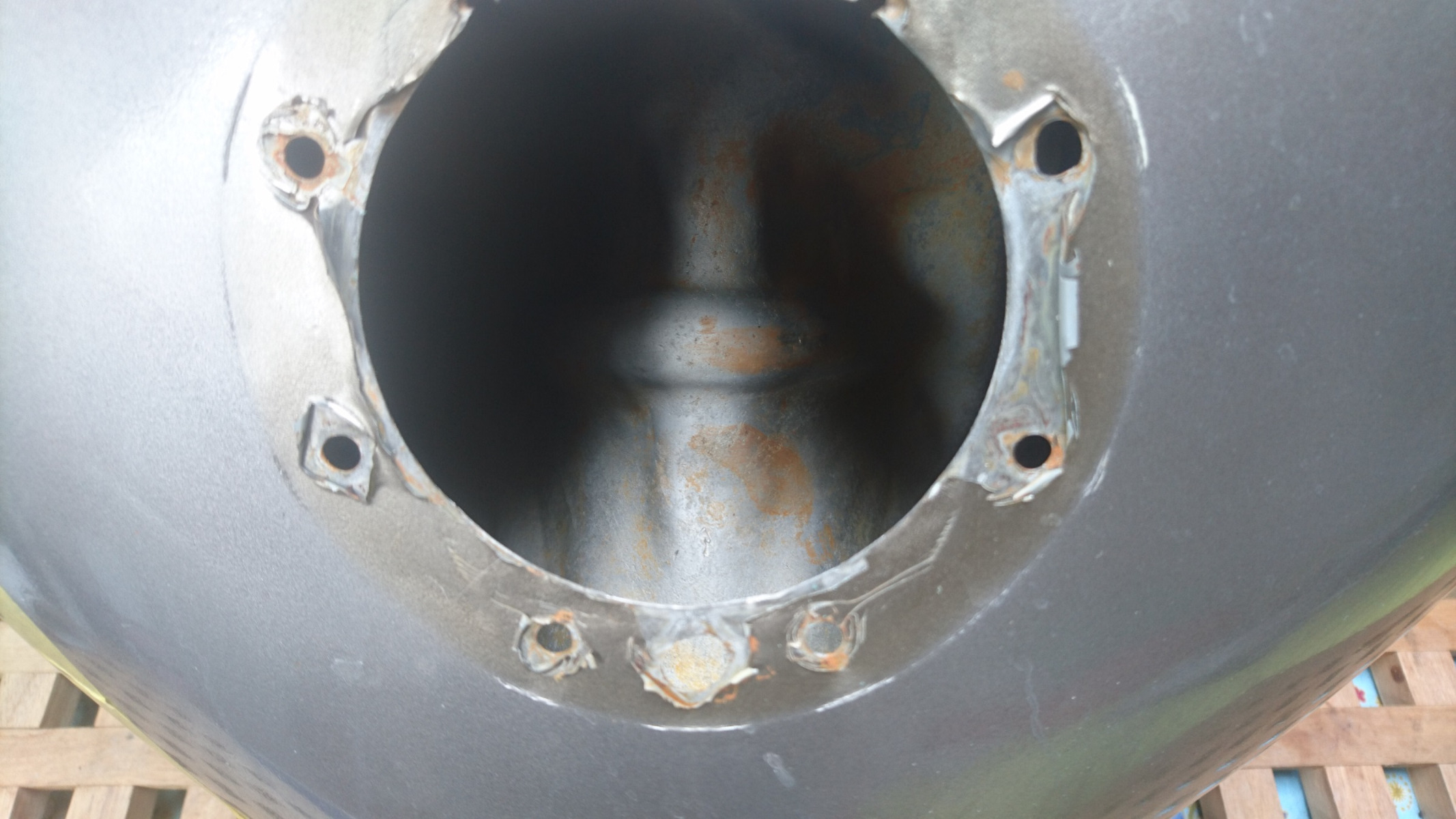

Well,I have to say I tried this a few times.Trying different things after the final flush.Stuffing towels into it,putting it on the radiator,A hair dryer. Nothing worked. Always flash rust starting to appear almost instantly.

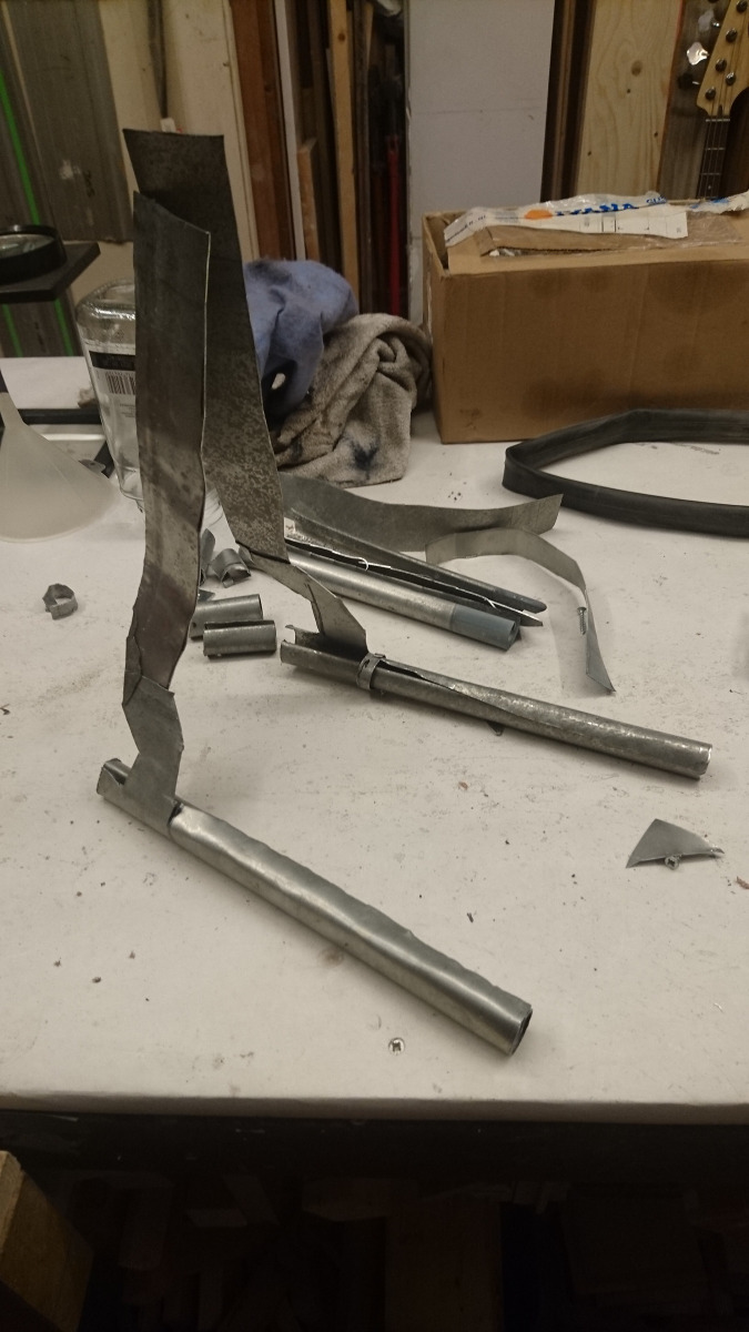

Eventually,I figured that the only thing that might work would be to dump the electrolyte straight in after the final flush.Not giving the air a chance to hit the steel.Of course,I was doing the flushing out in the shower upstairs and the plating down in the basement,so, once the electrolyte was in it (filled to the brim) I had to get it downstairs without spilling it everywhere.
Once I managed that, the anodes went in very carefully and I connected everything and got the power on.
Well, To cut a long story short. At the best,I would say it was a partial success!
In other words it didnt work. I was convinced that it still COULD work but not by me. I know that there are a lot of factors at play in plating, Electolyte makeup,temperature,voltage/amperage,timing. Im sure the amount of stuff I know about plating is far outweighed by the stuff I dont know!
Anyway,I didnt give up on it.I became a bit obsessed with the idea.I wanted to know why I couldnt do it. So, looking further,I discovered that there are 2 different processes for plating. The first,what I was doing,through electolysis, the 2nd, a hot dip type of thing.This is used for heavy steel construction,gates,lampposts,street furniture,thing like that. It involves dipping the piece in a (very) hot bath of chemicals. I found a local company that does this and asked them about my tank. They said that as the temperatures are so high and the tank steel is so thin, that chances are it wouldnt survive.They were willing to try it though!
Then I found a guy in the north who does electroplating for a living and he explained that the main reason I cant plate the inside of a tank is that the the anode needs to be the same size or bigger than the piece being plated!
So,there you go.I got my answer,which Im happy with but It doesnt help me with my tank!

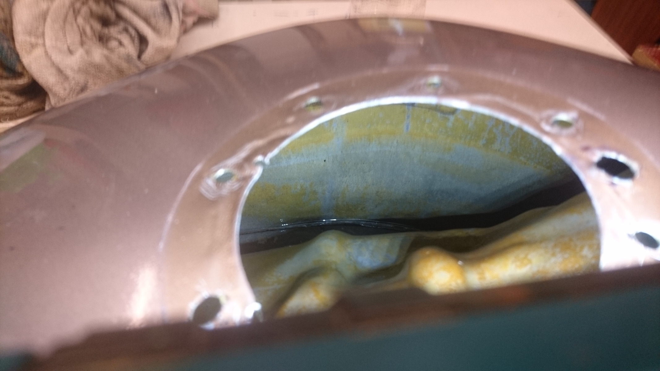

Hi Davido, is there a specific reason why you are going this route as opposed to installing a tank liner. I ask as I am about to start an 82 ltd Resto-mod build (I stumbled on your build thread last year and loved what you had done with your CSR)

28 Mar 2022 11:51A tank liner seemed to be the only option and Ive heard too many nightmare stories about them. Sure there are people that have had great success with them but for every positive story there seem to be a lot more negative stories. From what I understand, IF it goes wrong, that's it. You can say goodbye to your tank.So I was looking for an alternative. I had some success plating small brackets,nuts and bolts etc,so I thought why not. Scale it up and have a go at the tank. Its a non destructive process (thought the vinegar knackered my paint!)Hi Davido, is there a specific reason why you are going this route as opposed to installing a tank liner. I ask as I am about to start an 82 ltd Resto-mod build (I stumbled on your build thread last year and loved what you had done with your CSR)
If it works,it would be a cheap and durable solution and there would be great rejoicing amongst those afflicted with rusty tanks!!
But. It didnt work.
