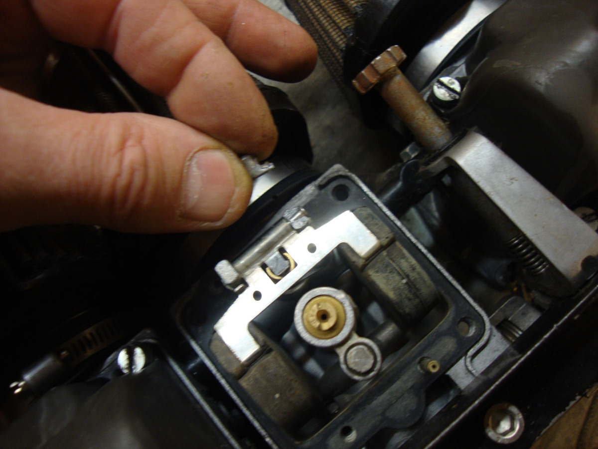

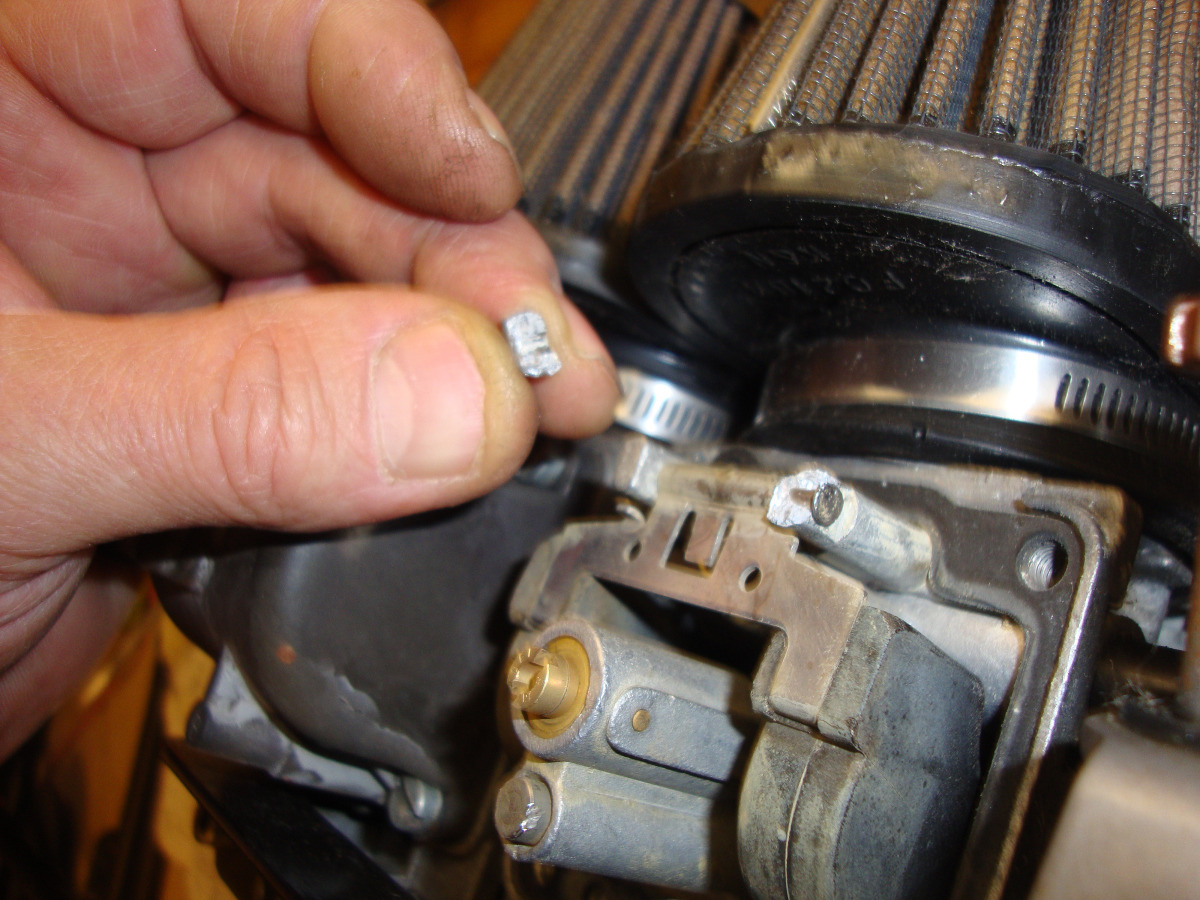

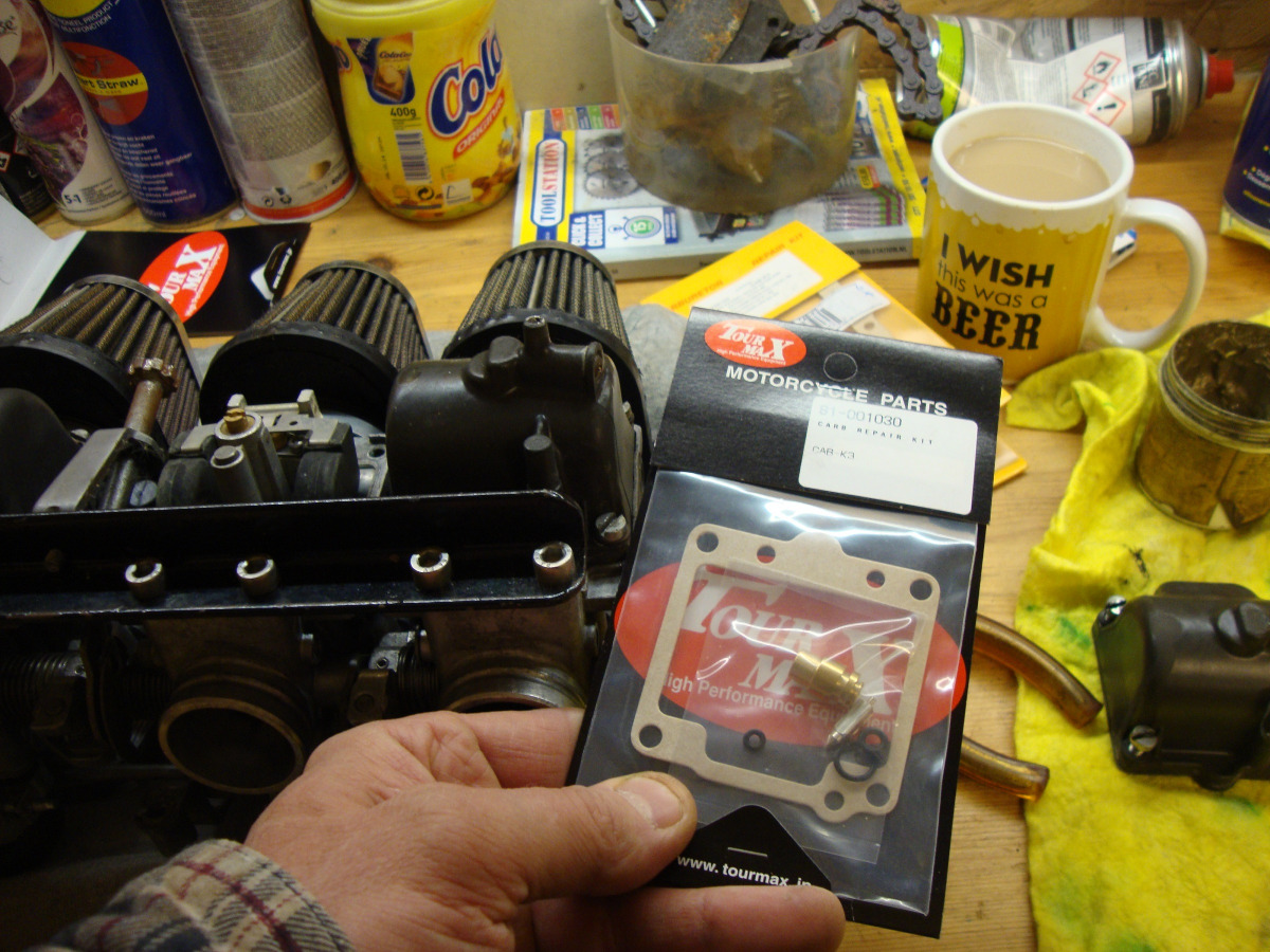

So, I reordered the float needles and they came in a couple of weeks ago. I had some time/inspiration to have a go at them today.
While I was busy fitting them, I was thinking about a photo someone had posted of his broken float pivot post( I think you would call it) and his question of what to do? How to fix it?
What a bummer,I thought. Glad I dont have to deal with that!!
So,being 2017,the universe saw its opportunity.
Lucky bugger that I am, it didnt break all the way off and there is still enough meat on it to hold the pivot pin. So, Im hoping Ive gotten away with it. Time will tell.

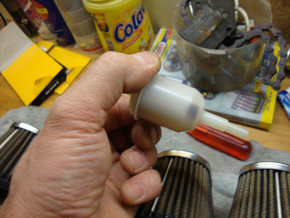

Also I noticed this
My tank is not as clean as I thought it was. This could explain why my vacuum tap is jamming open. What to do about it though.What is a fool proof way to clean a tank?

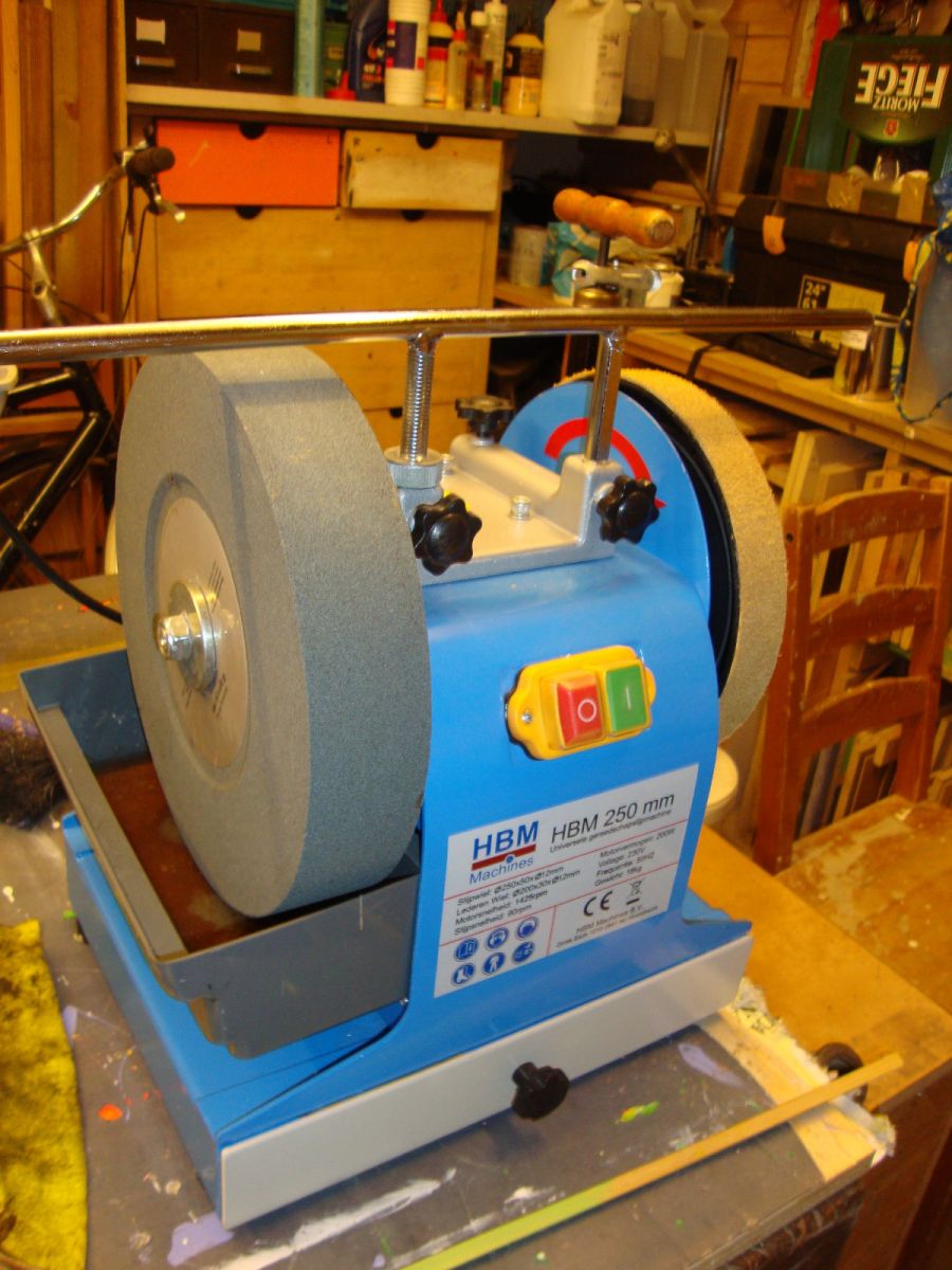

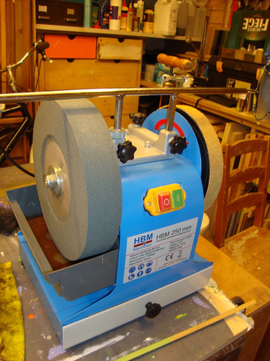

and on a different note.I bought myself a present (finally)
I can now get them pesky chisels sharpened up .

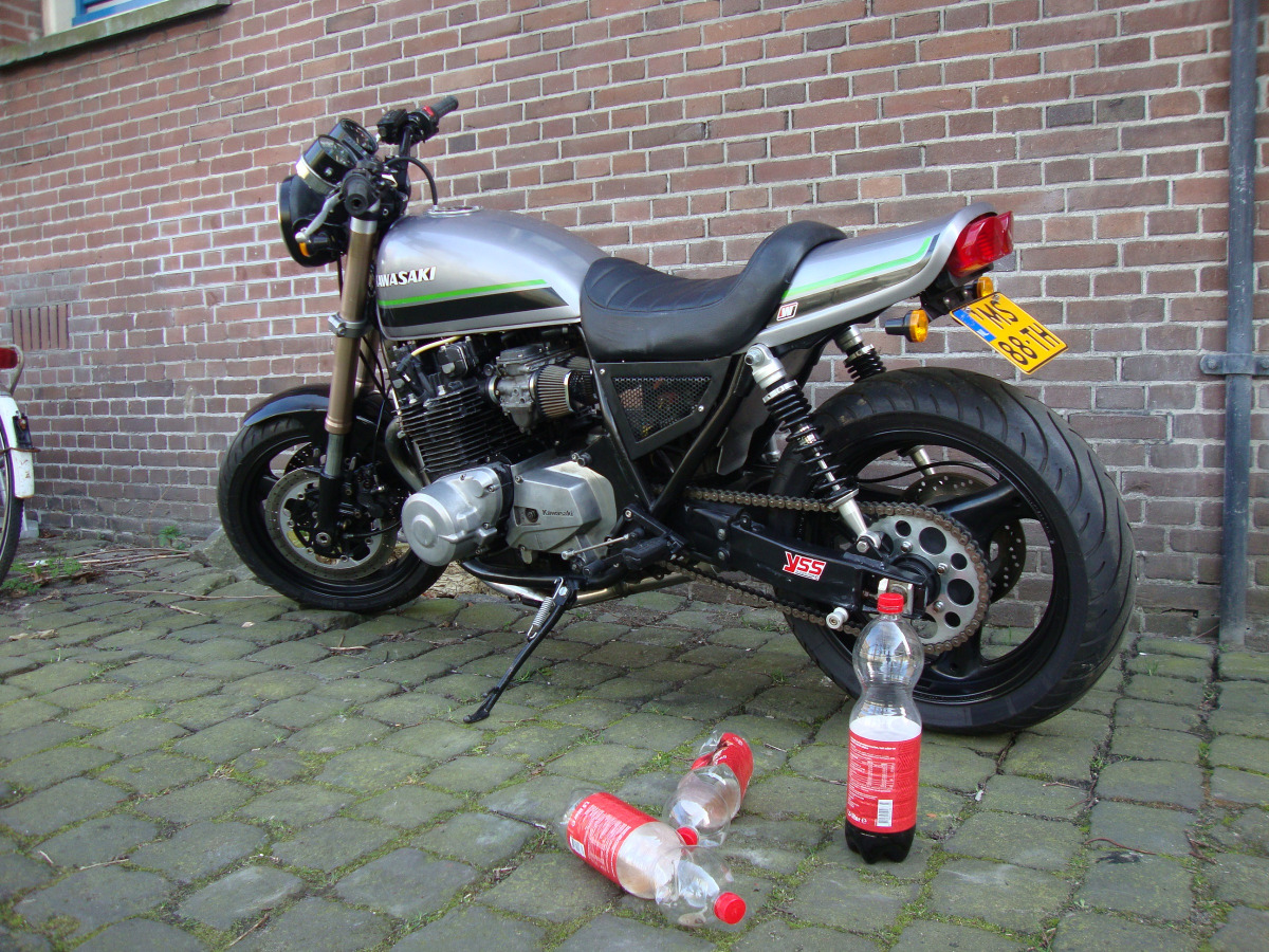

Strange that something can brake of at such a place where there is no force or vibration.
I cleaned my tank with Coke (the drink not the powder)
Filled it up with 18 ltrs of the cheapest i could find and let it stay for a couple of days.
Flushed it a couple of times with gasoline and looks brand new.
Eric

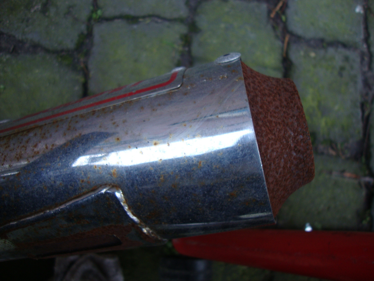

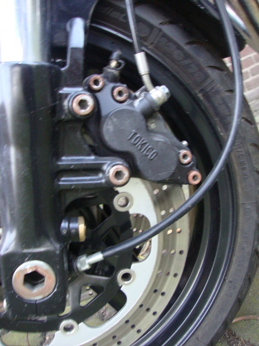

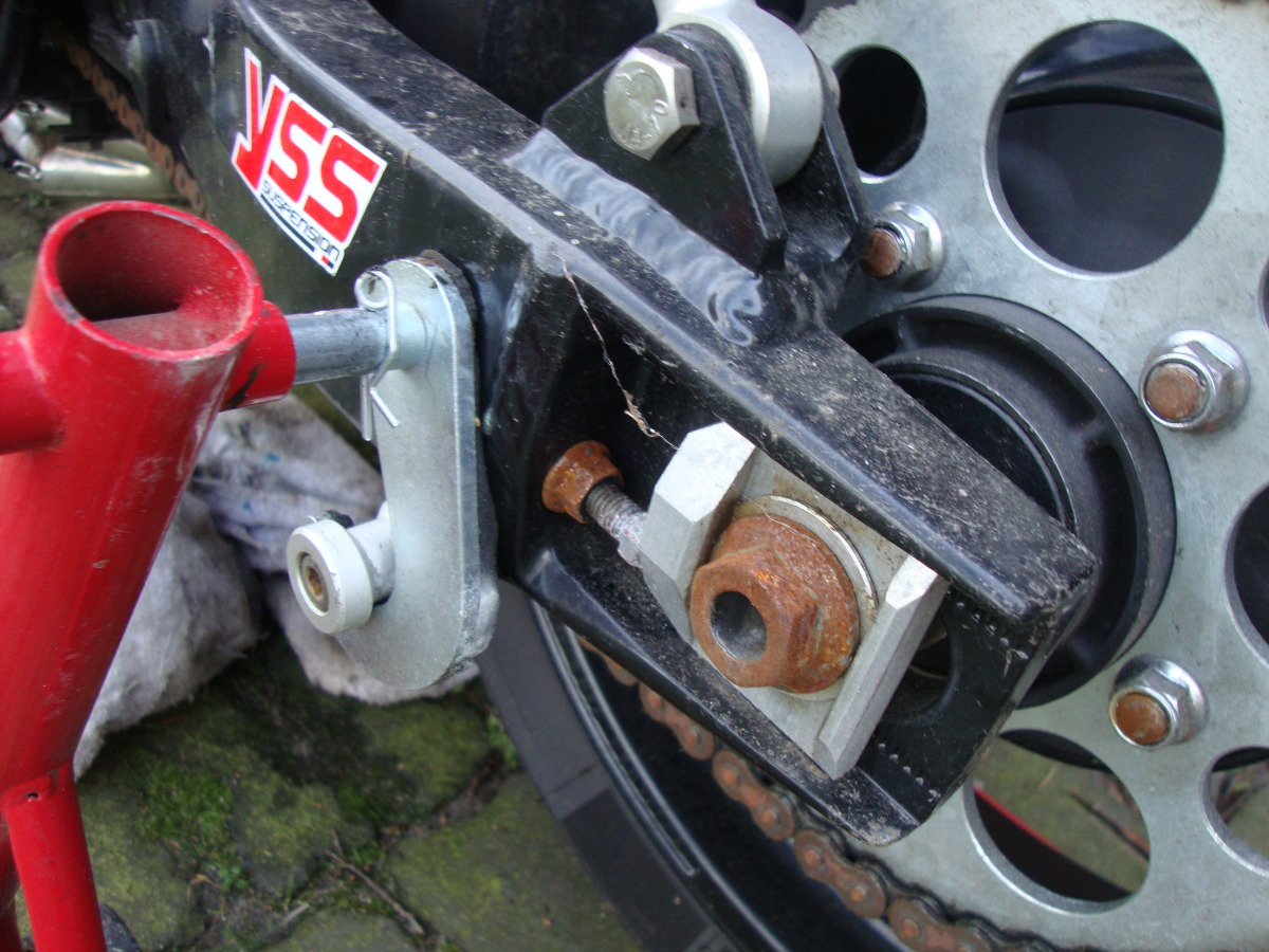

Hey Eric, the post in the carb broke because I was trying to pinch up the pivot pin after installing the new float needles. Totally my own fault. As for the tank, I already cleaned it with brown vinegar (Lidels finest),flushed out with soda then a quick misting with WD40. It should be spotless. Then again, I spent some time giving it a well overdue wash the other day and I found this;
Very disheartening.
Also,this is how the rest of the bike was looking;
I gave it all a good wash but I wasnt going to fuck around repolishing nuts and bolts on the street,in Holland,in December!!
So I dabbed a load of vaseline on the worst offenders,a bit of oil here and there and the bike has now gone off to storage for the winter.
So, thats it. No more Zedery for me until the springtime.

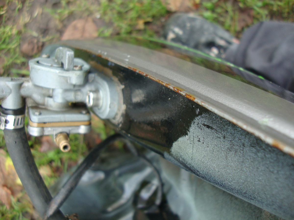

Spring has sprung. The bike arrived back from storage the morning and as I had a day off,I got stuck right in.
On the to-do list, the fuel system is the big job. The fuel petcock wasnt shutting off and fuel was pouring out of carb No. 4, all over the engine,making a mess of the uncured PJ1 on the crank cases. A good clean of the petcock and a rebuild kit didnt sort it out. I replaced the float needles in all four carbs and put the bike in storage.
I reckon the problem is rust in the tank (though I did clean it with vinegar which seemed to work well and it looks clean enough. I cant think of another reason for the vacuum diaphram to stick open,other than dirt getting in there.) Today,I pulled off the petcock and the fuel level sensor and plugged the holes and this time Im going with cheap cola. See how that works. Ill give the petcock another clean and polish tomorrow. Ive been advised to flush the tank out with diesel ,after the cola has done its job.If that dosnt work,I have no idea what else to try (apart from a Non Vacuum petcock)
