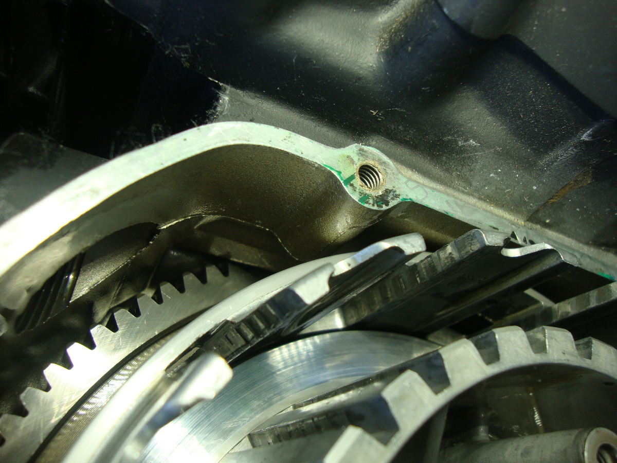

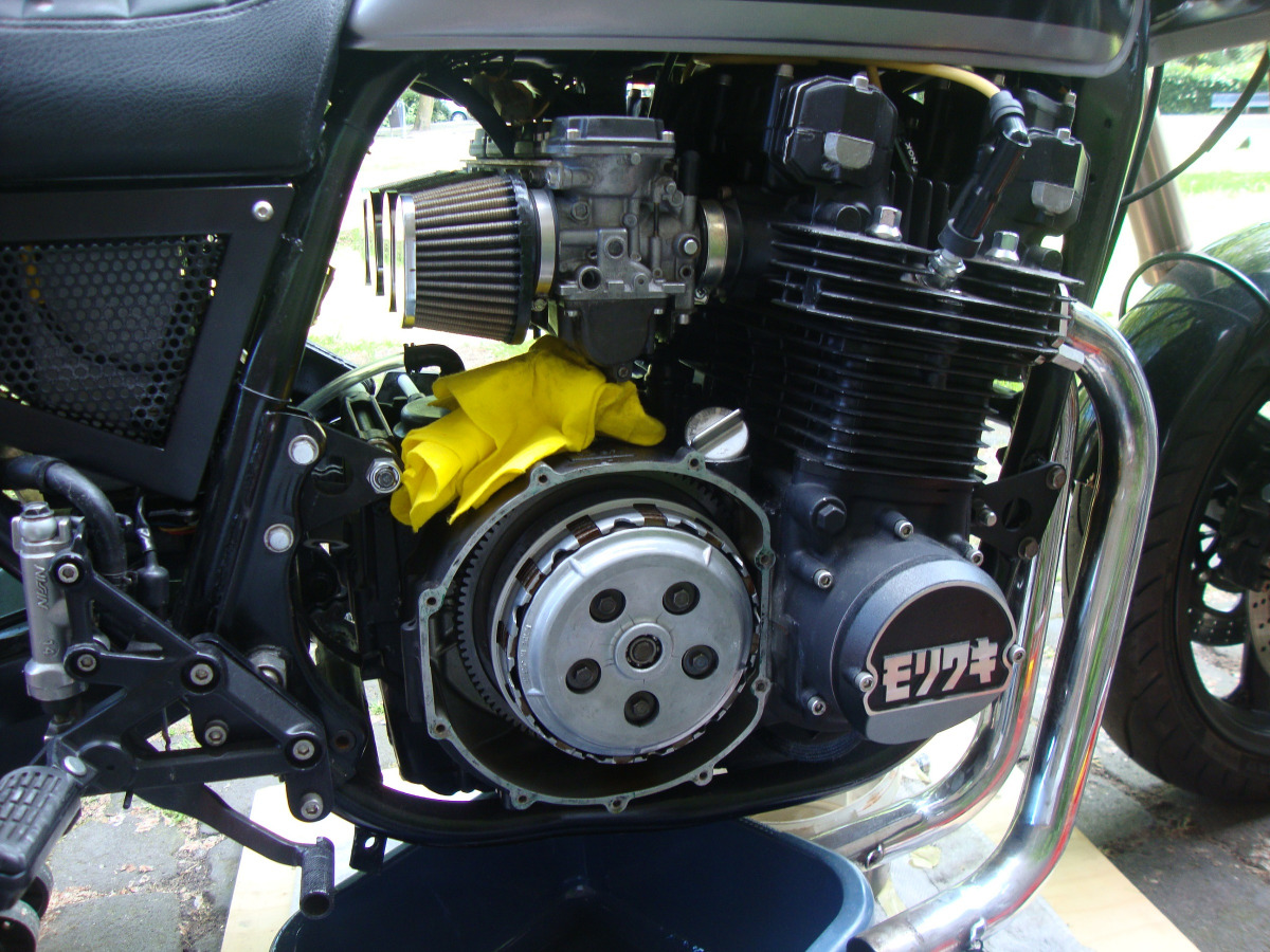

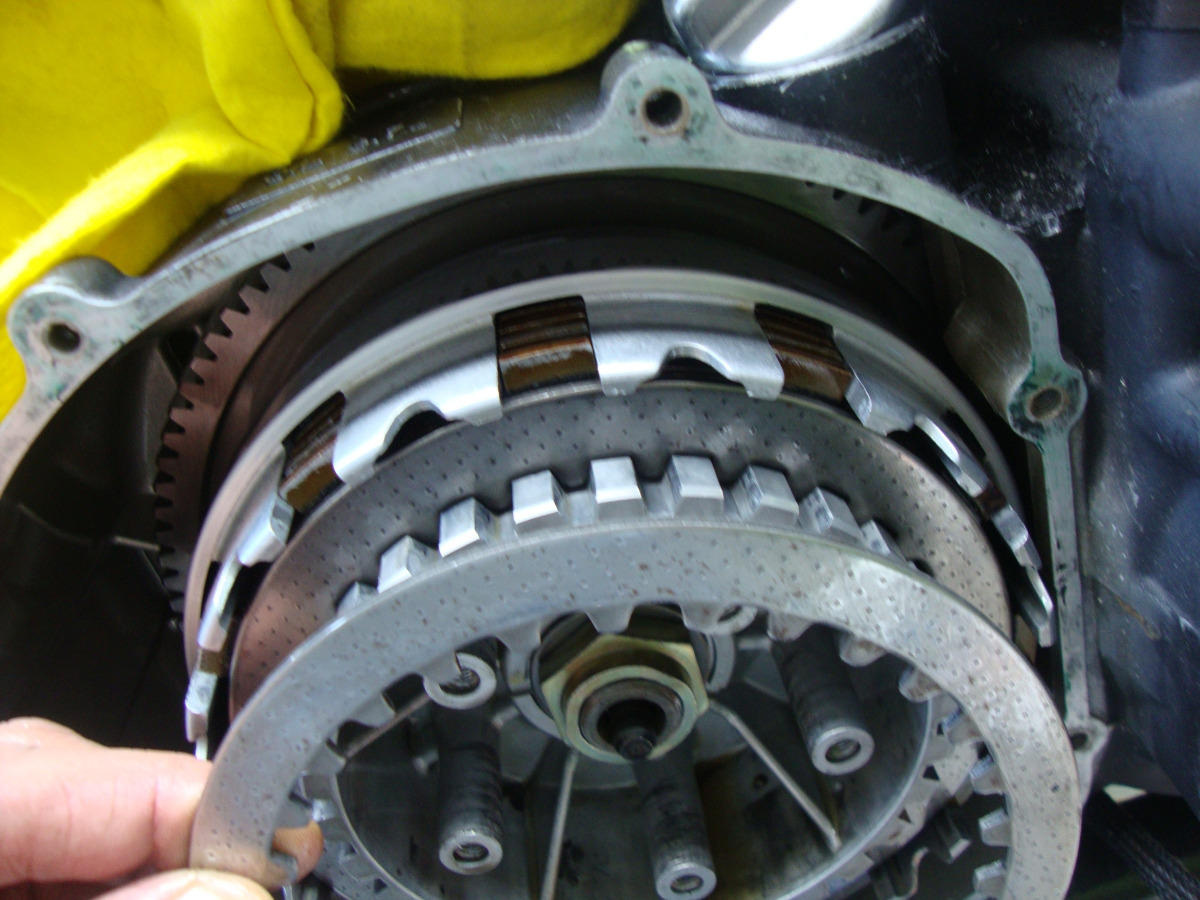

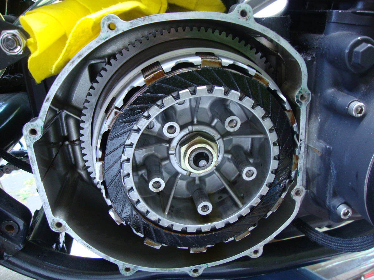

Ok,so swapping the cheap oil for better quality has not done anything noticable to improve the clutch action. Its still quite heavy at the lever and dosnt like to go into neutral.
As I posted before,I have been playing with the spacing of the hydraulic piston, but I cannot find a sweet spot.So,its time to open up the clutch and see whats going on inside.
No shrapnel,everything looking clean enough.
The pressure plates seem to be going in the wrong direction according to my Clymer. Anybody know how important this is?
2 steel plates beside each other?? That cant be right????
Some grooving on the basket.Not too deep but I want to get rid of it to be sure.
Problem now is,I dont have a 30mm socket or a clutch holding tool so I cant pull the basket of to work on it!!!!
So opinions on the direction of the grooves on the pressure plates and the 2 steel plates side by side? There are no pressure plates side by side and the stack starts and ends with a pressure plate (as the Clymer says).

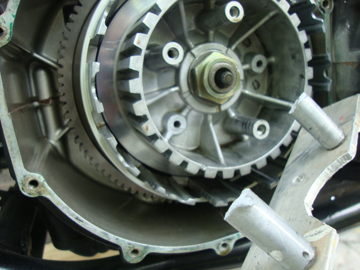

the extra steel is common practice to help stiffen up an old clutch.
the frictions going that way i wouldn't worry about.all the ones i have seen had radial grooves.
a rag wrapped around the clutch basket and an air impact is usually sufficient to break the clutch nut loose.

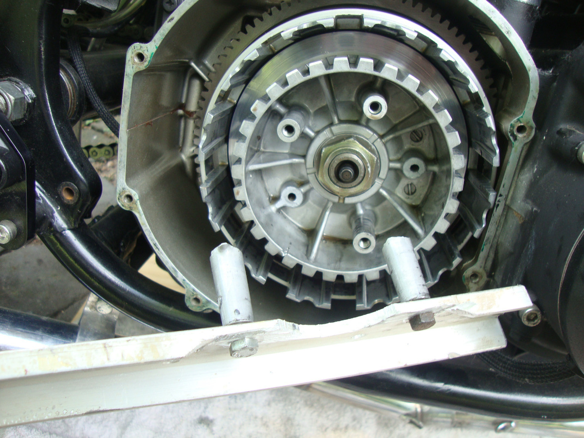

I like the idea of the rag and the impact driver but this time I went for the aluminium bar bolted onto the spring mounts
Its the only way to go if you want to snap off a couple of spring mounts!!!!!!!!!!!!!

well now you know why you won't be doing that again :sick:
tough lesson.
the extra plate would account for the heavy lever.
the trouble finding neutral is imho likely the pins and the claw that rotate the shift drum.or possibly the shifting dogs.
p.s. take that extra plate and weld a handle onto it and voila clutch holding tool.
