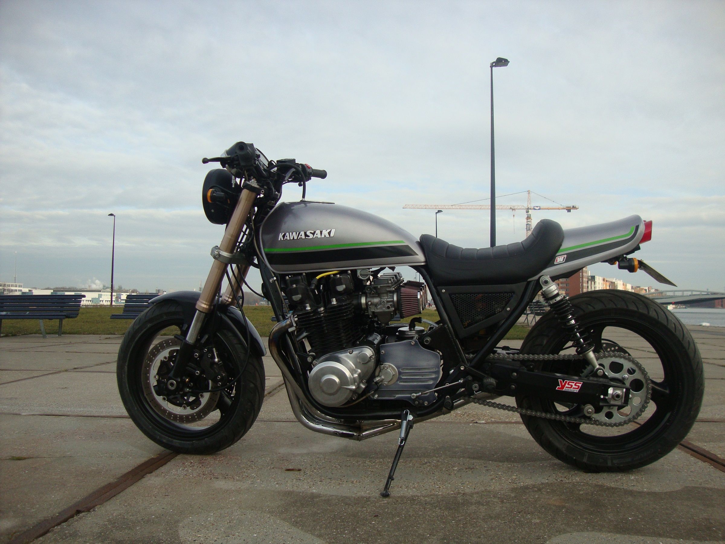

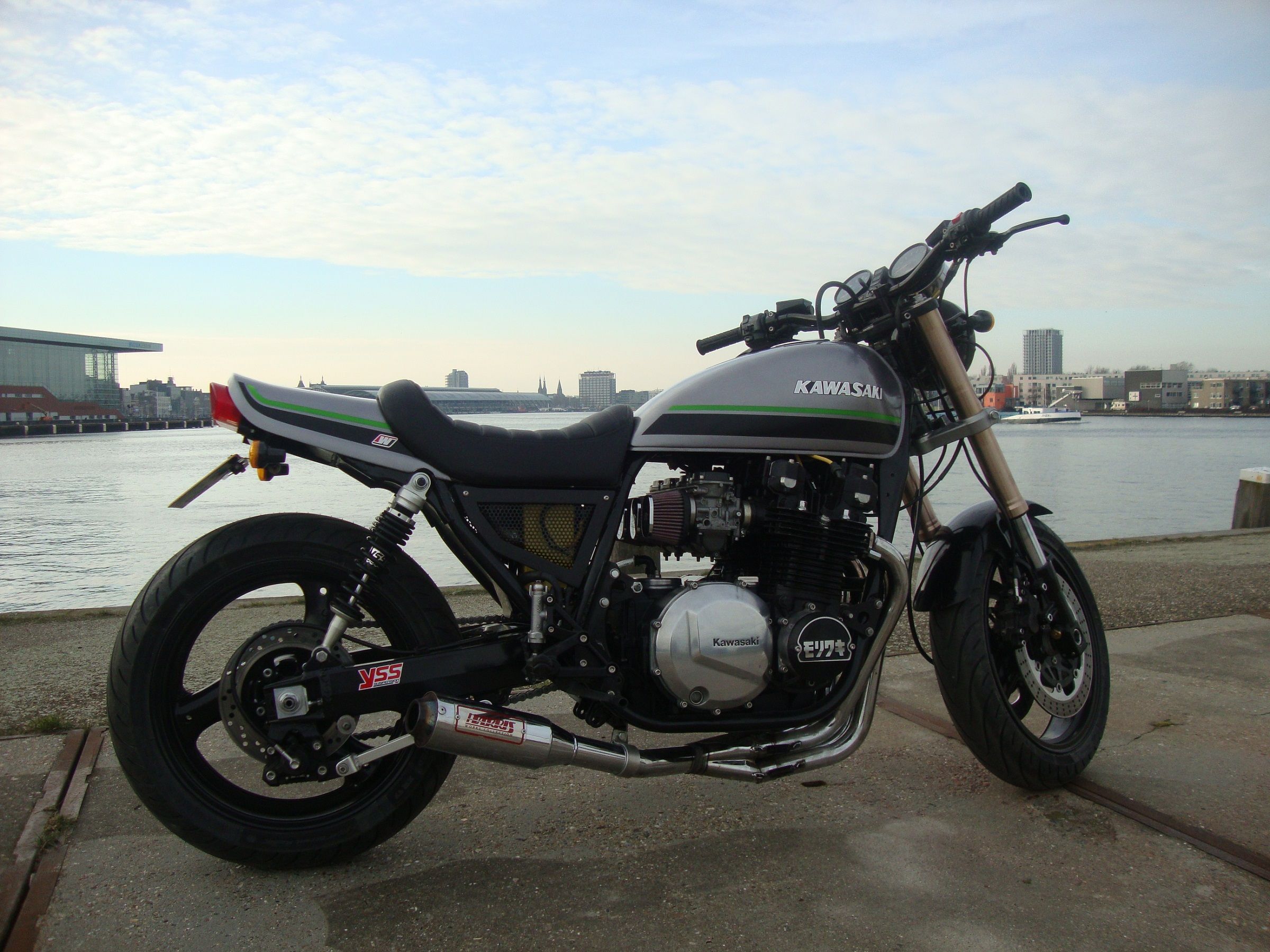

Great job, stickers are the finishing touch.
Total package is top notch.
If it runs as good as it looks you'll be okay :laugh:

the bike turned out very nice!

Im Loving It !!!! :woohoo:
Nice Job !!!! :laugh:
Now Back To Work and get that Sweet Ride On the Road

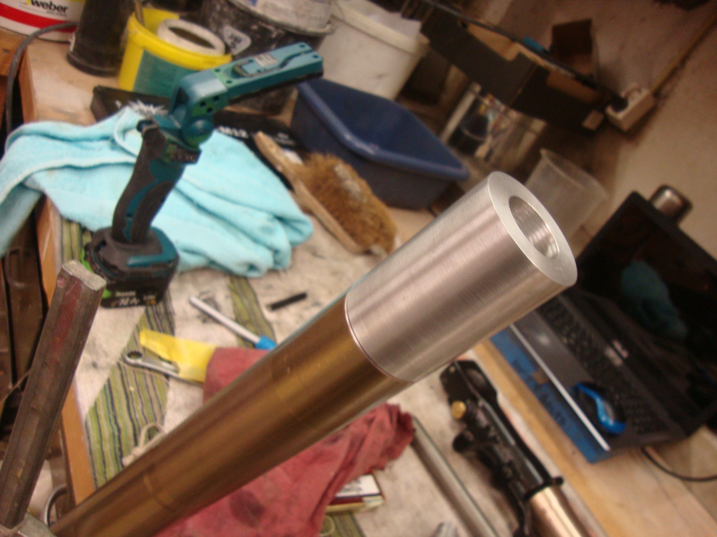

The bike is WAY too low. The first bump I hit peeled a nice layer of chrome off the bottom of the pipes.Got to look into Zed1015s damper rod extension and maybe also some fork extenders.

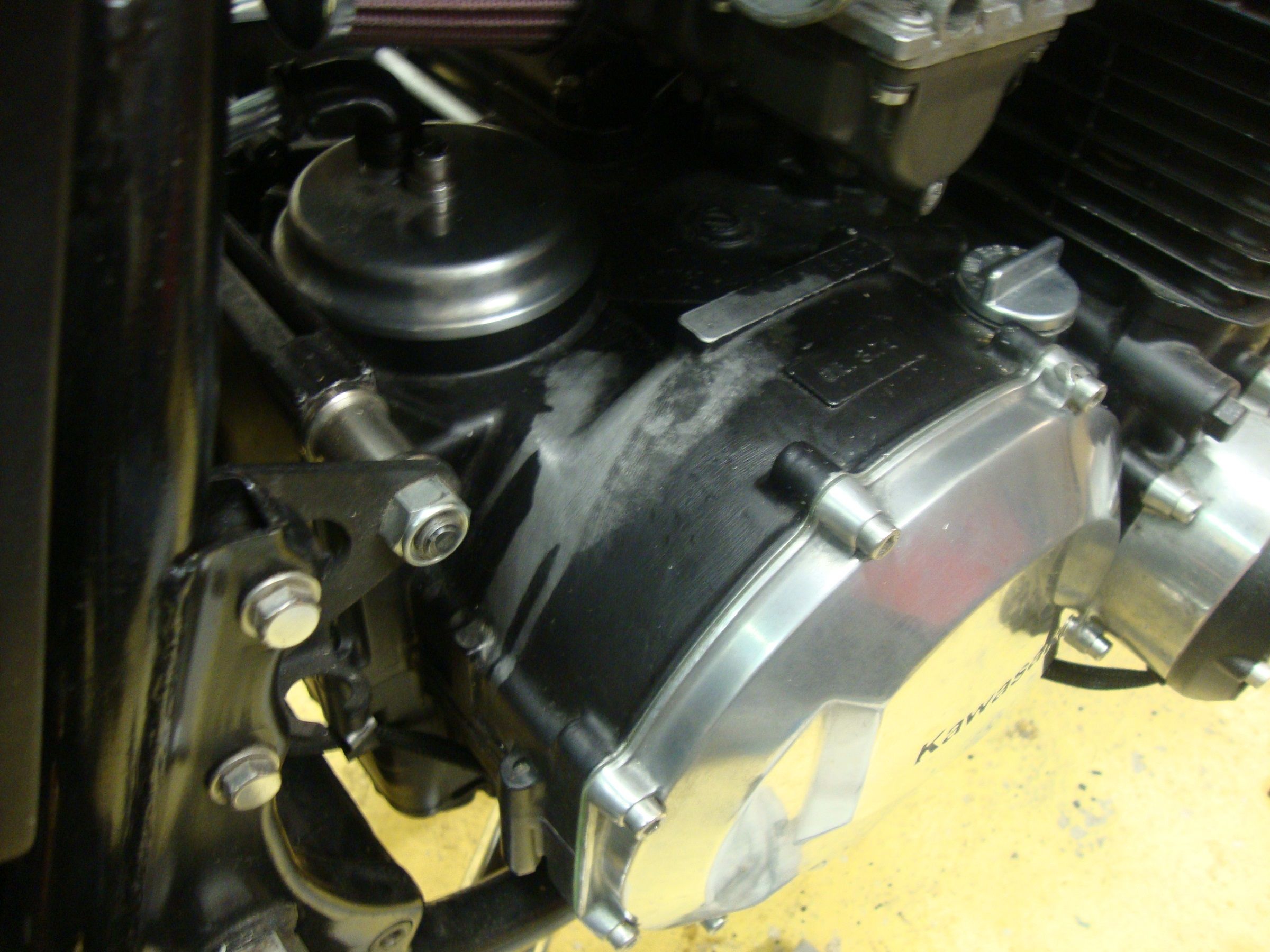

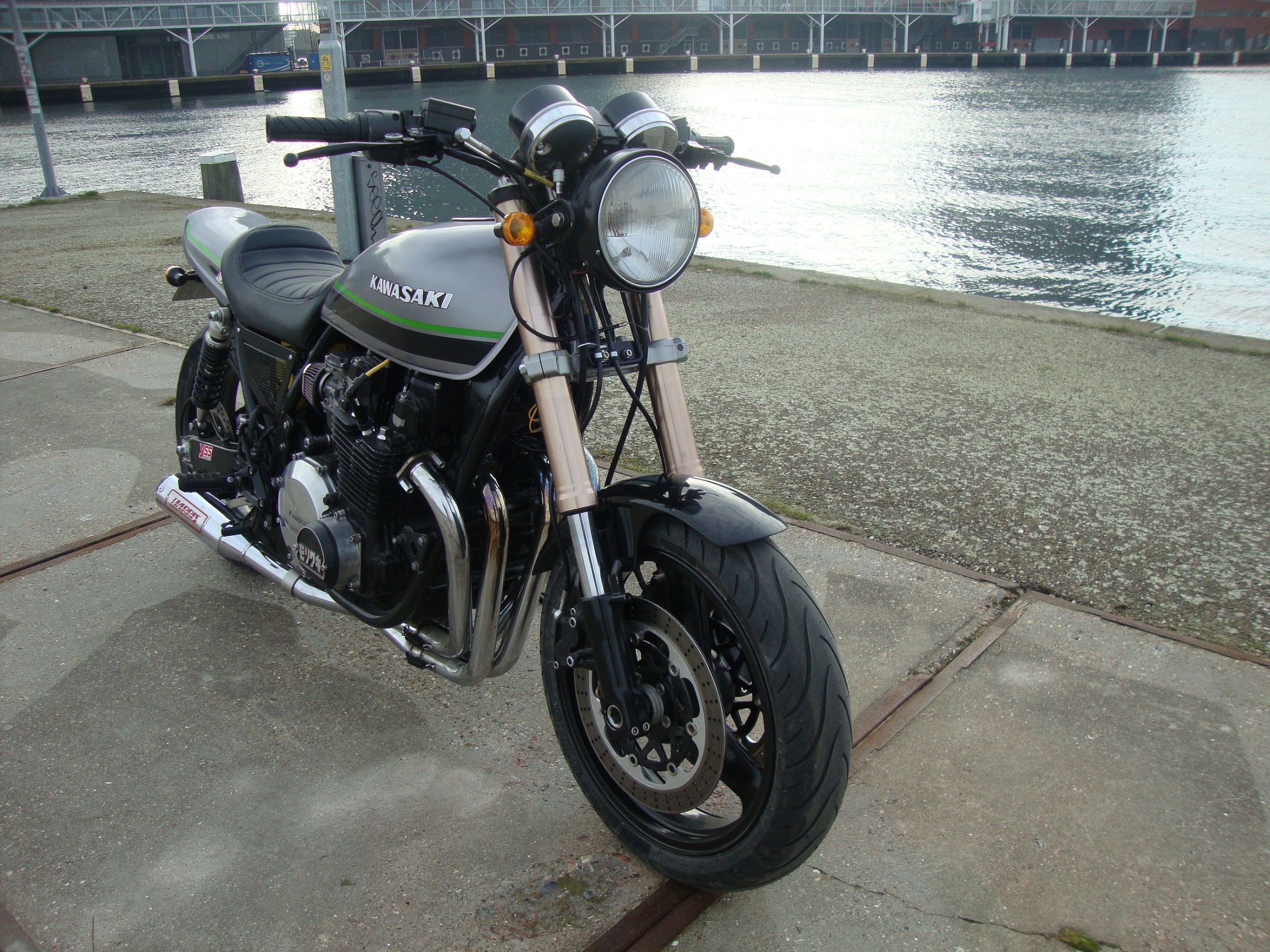

I spent some time going through the nuts and bolts today. I think Ive got everything tightened up enough (No torque wrench). I did discover a bit of fluid on the left hand front brake caliper.Dont know if its weeping or maybe just some residue from the bleeding. I also noticed a bit of incontinence by the clutch push rod.I think its time to pull the clutch apart and see what its looking like.
I took it out for a short run this aftrenoon and noticed that the oil light comes on at idle but goes out as the revs rise! Anybody got an opinion on that?
I also banged the exhaust again,going over a bump!!!!! I took some nice pictures though.

Nice pics David from a great bike.
How is the handeling? Any surprises?
Eric

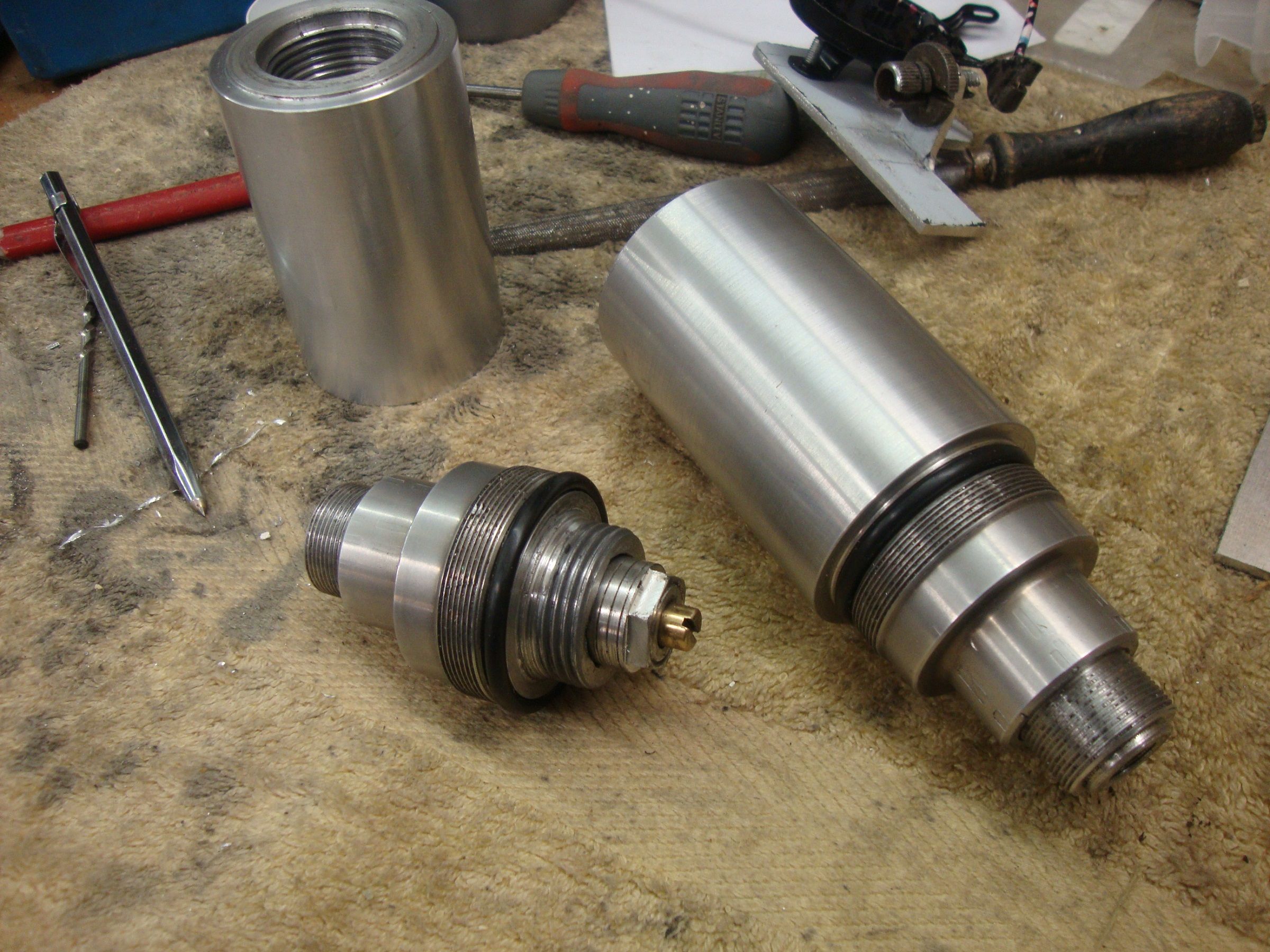

All I can comment on so far, is at low speed.,It does seem to turn into the corners nicely but the most noticable thing is how the exhaust hits on any kind of raise in the road!! There was a guy from Rotterdam that makes fork extensions for upsy dupsy forks.He used to advertise on Marktplaats but I cant find him anymore
I know a local guy that might be able to make something similar.Ill go talk to him this week.
