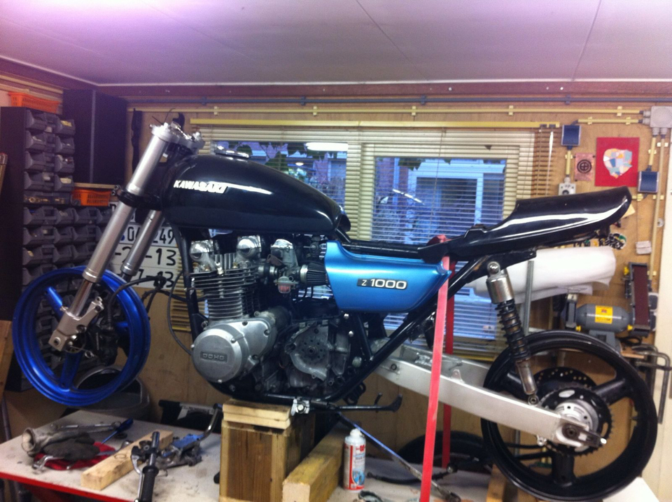

Ok. Nuther swingarm ordered off t'interweb. ( very cheap). Ill chop it up and see whats possible. Cant see any way around it. Ill keep the old one on for now and crack on with the rest of the build. If I can get the new one to work,Ill get some new shock mounts made up and welded on. A bit further out and maybe a bit back as well. More time and money. Live and learn.

Your project is coming along well.
Would using shorter shocks bring the chain up enough?
That is if there is enough clearance above the wheel.

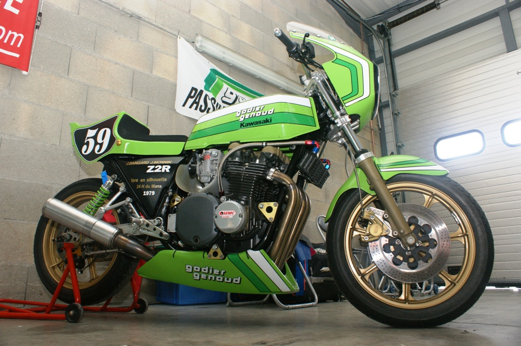

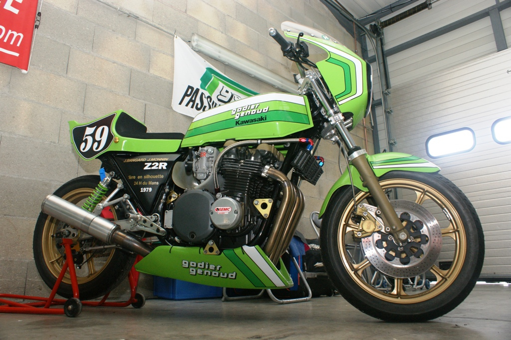

i'm sure it's prolly nuthin you wanna do but :whistle: .
but i've seen guys raise the engine for cornering clearance.
this is the first pic i've found to demonstrate but have seen several of the Japanese do it to kz's they we're road racing.

Rstnick, I have to check the clearance twixt wheel and undertray and the travel of the shocks that I have (theyre on the lowest setting already),Ill do that this weekend. It might be a possability but Im going to have a go with the replacement swingarm and see how much clearance I can gain from ginding the edge out of it . ( Ill take some photos)
Leon, Youre talking about major surgery there!!! No idea how that would work and with this frame,I wouldnt waste the money. I would rather strip everything out of the bike,put it all into storage until I can save the money for a Harris,Spondon or Bakker frame.

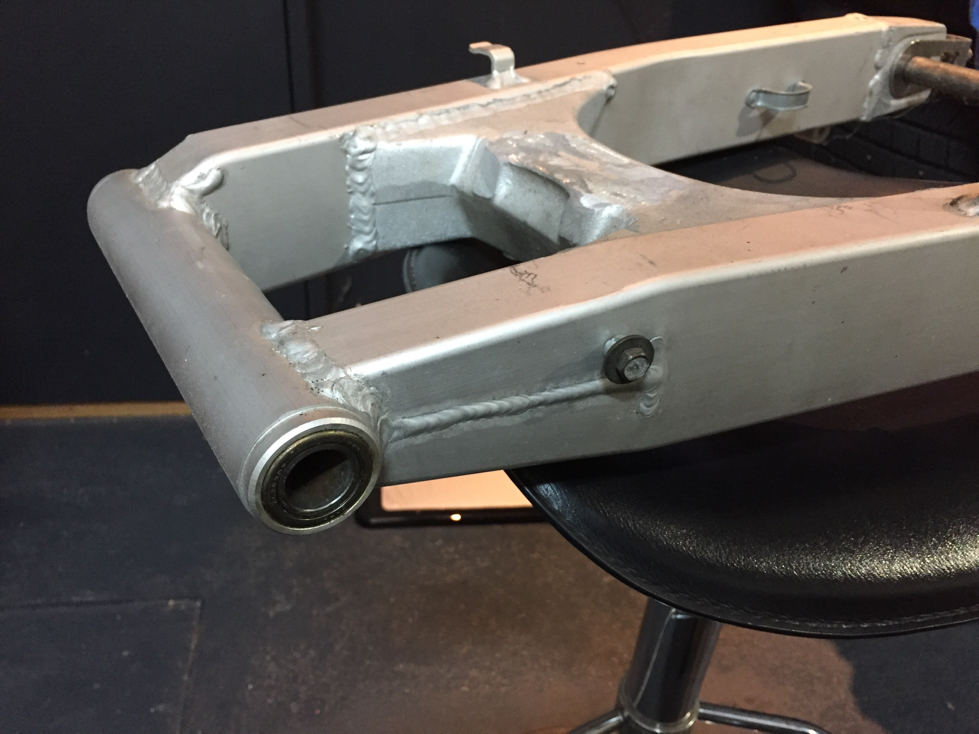

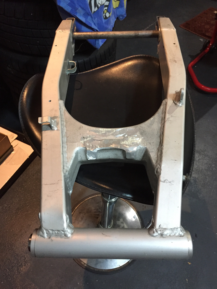

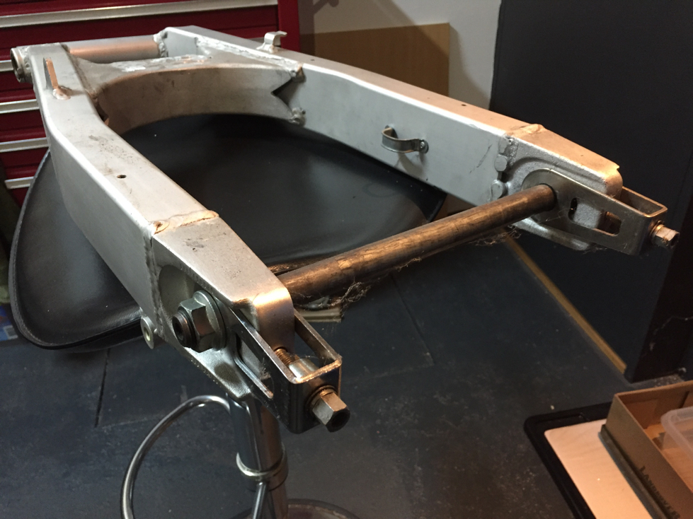

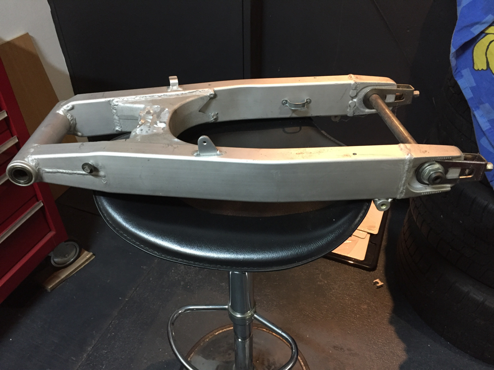

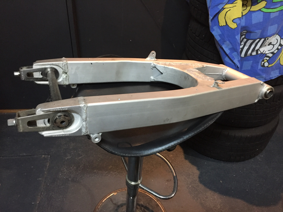

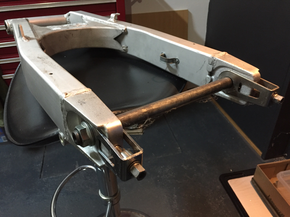

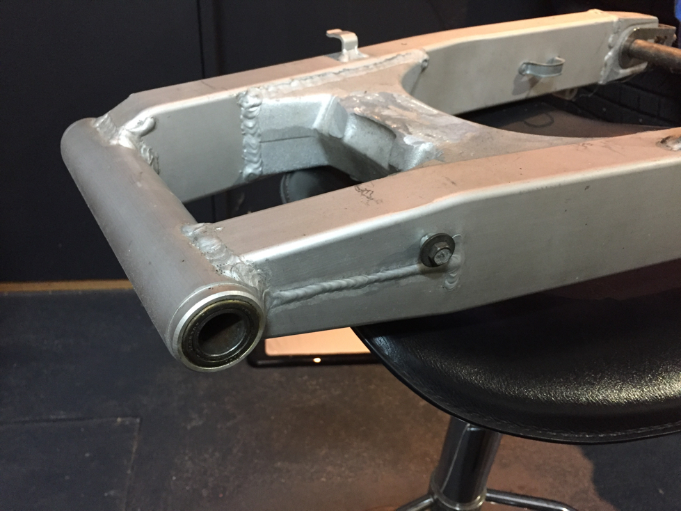

12 Dec 2016 13:36
This is the swingarm.
I am not gone use it so you can have it if you want.
I don't know from which bike it came but for sure it was a single shock.
You have to make/buy brackets and can put them as far back as you can.
Eric
