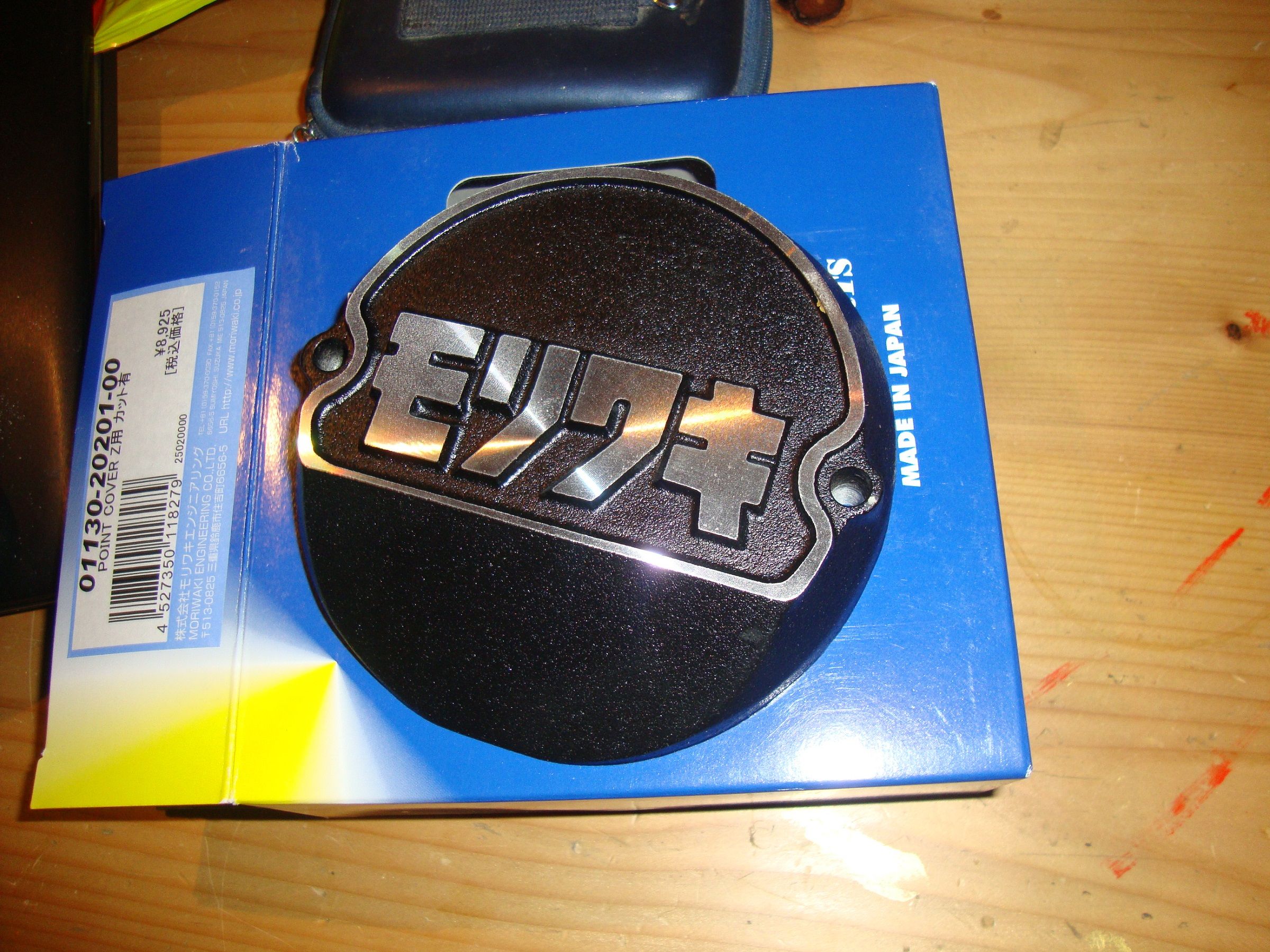

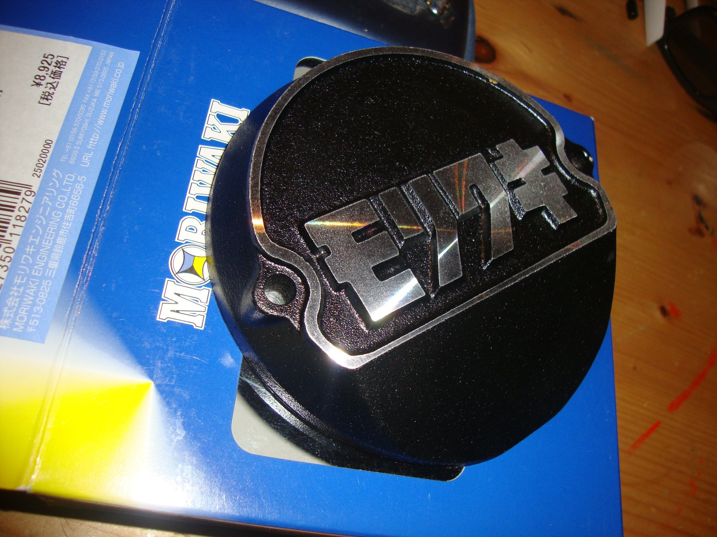

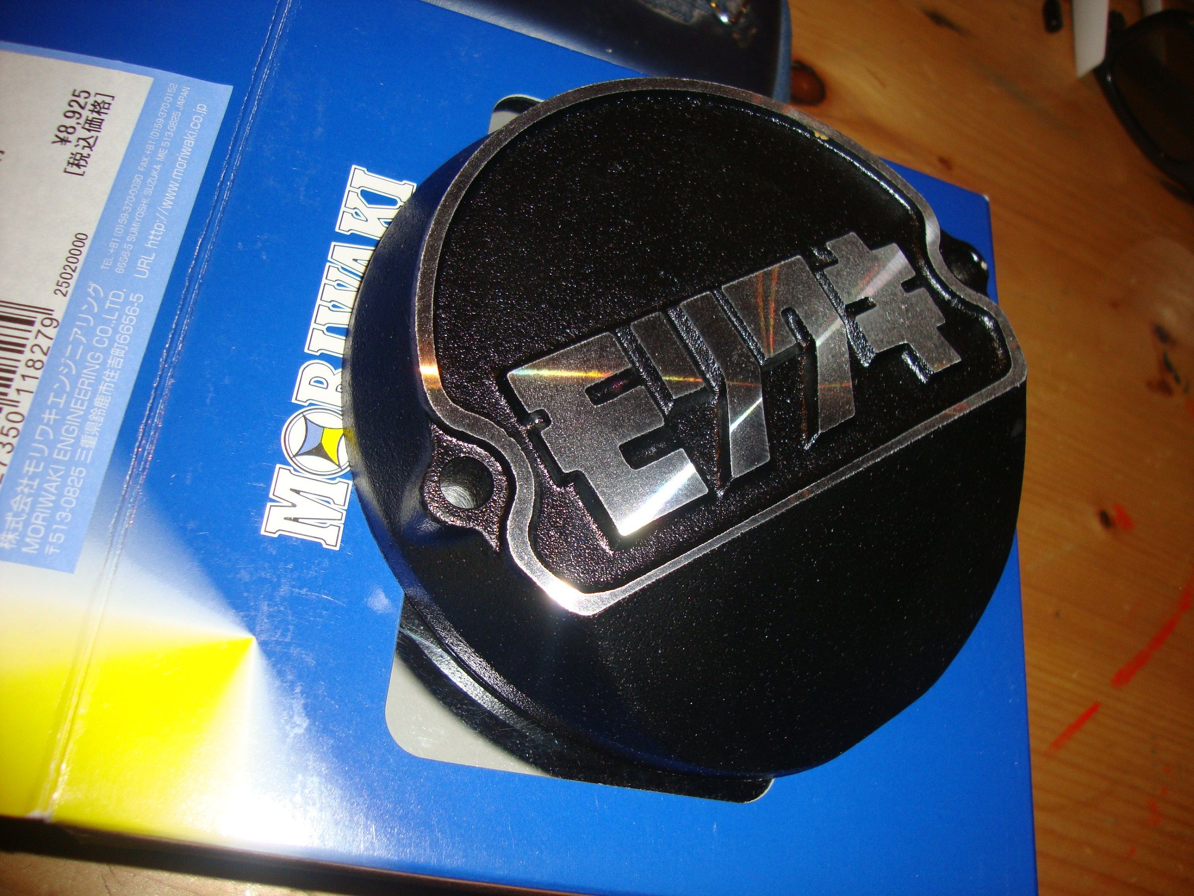

Oh and the posty brought me this
Bling Bling.

Nice Moriwaki's
When are you planning the first start?

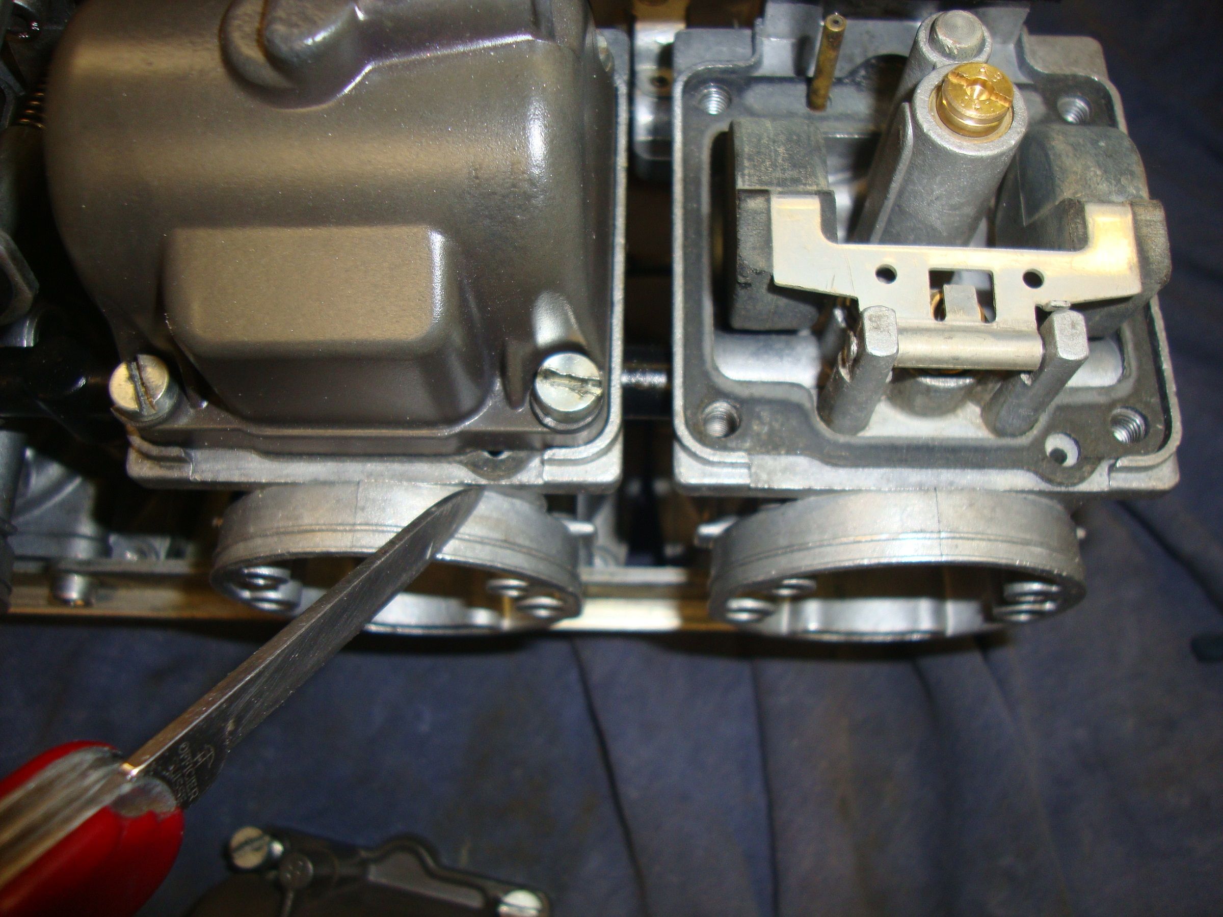

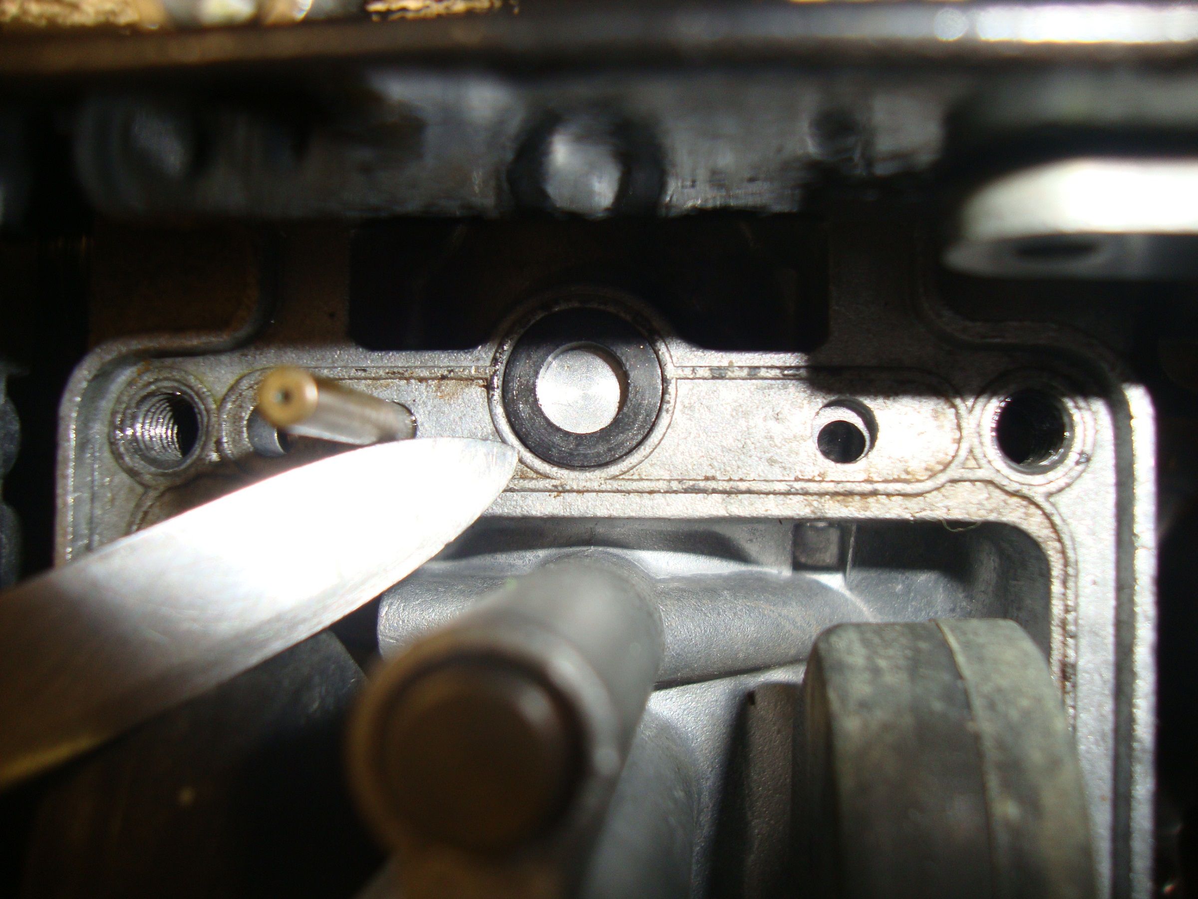

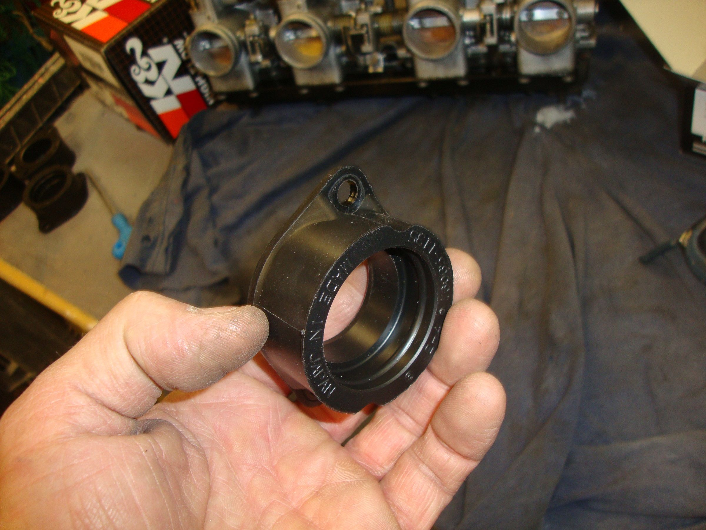

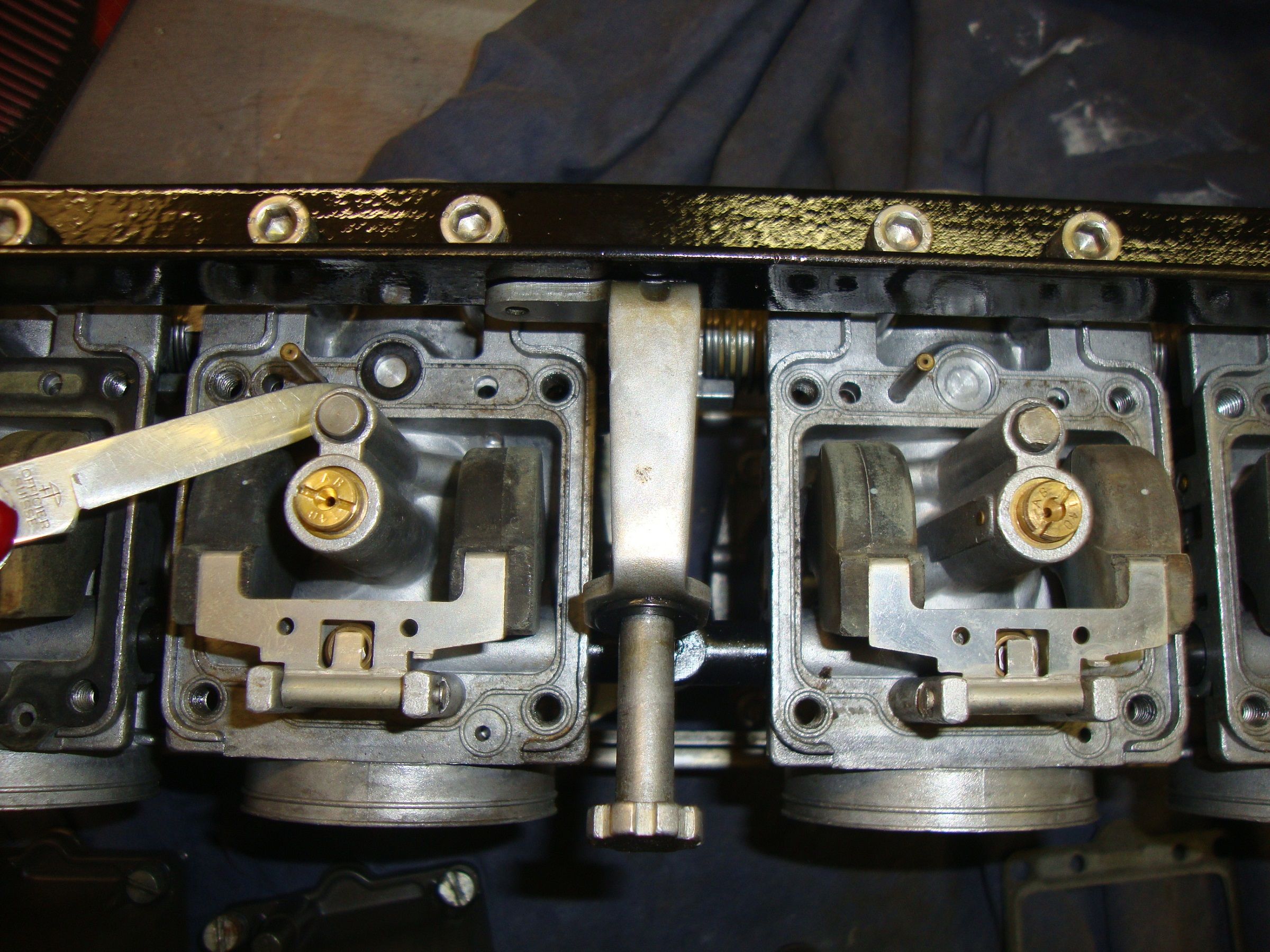

Got the jets yesterday so Ive been busy sorting the carbs.I got some nice new rubbers to make things easier for mounting
Any ideas on whats going on here? Seems to be a hole that is exposed. Is that normal?

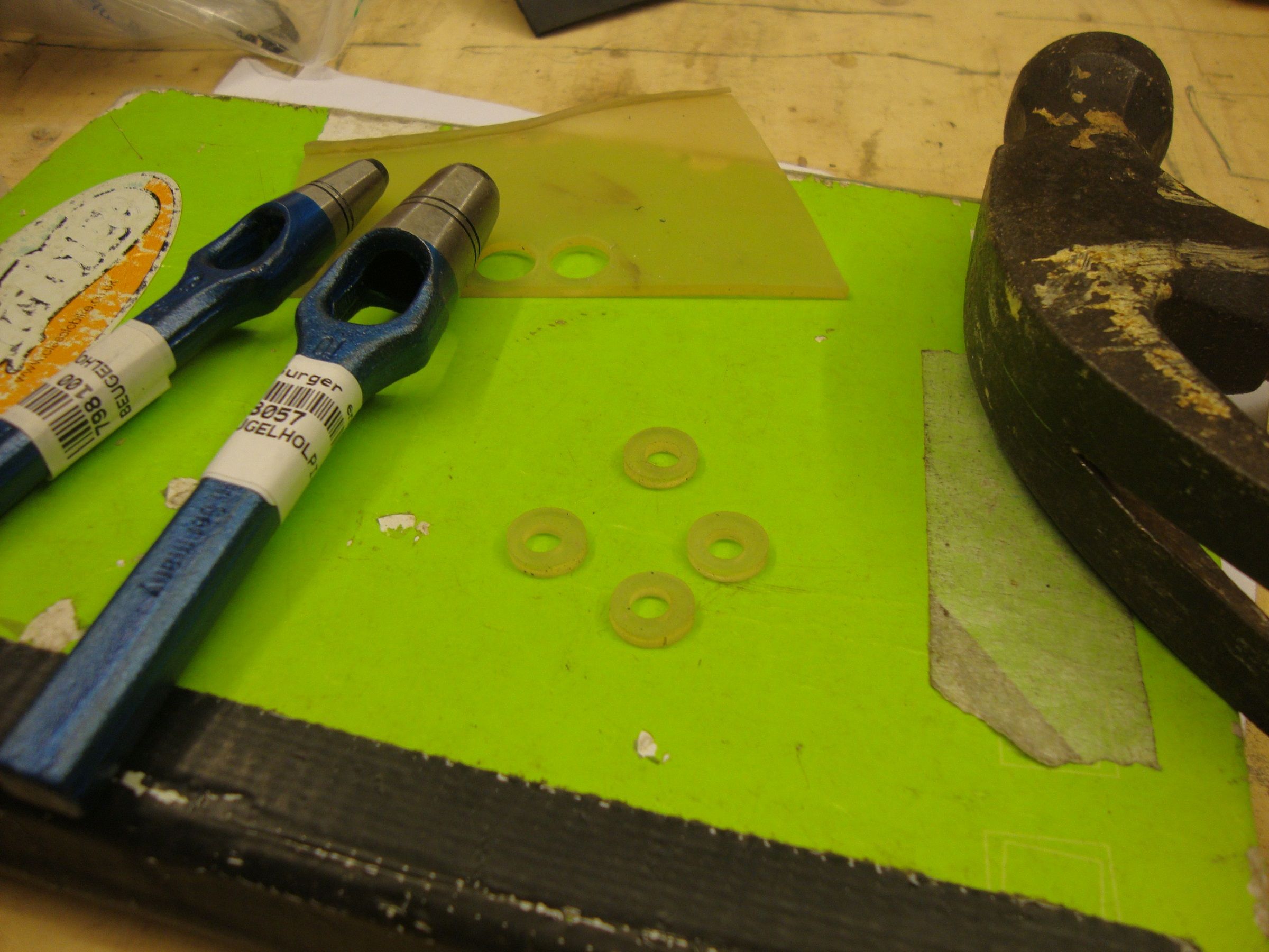

Another question. What are these rubber rings for? They sit in a recess under the gasket with no apparent use.Can I do without them??(Im missing 2 of them)

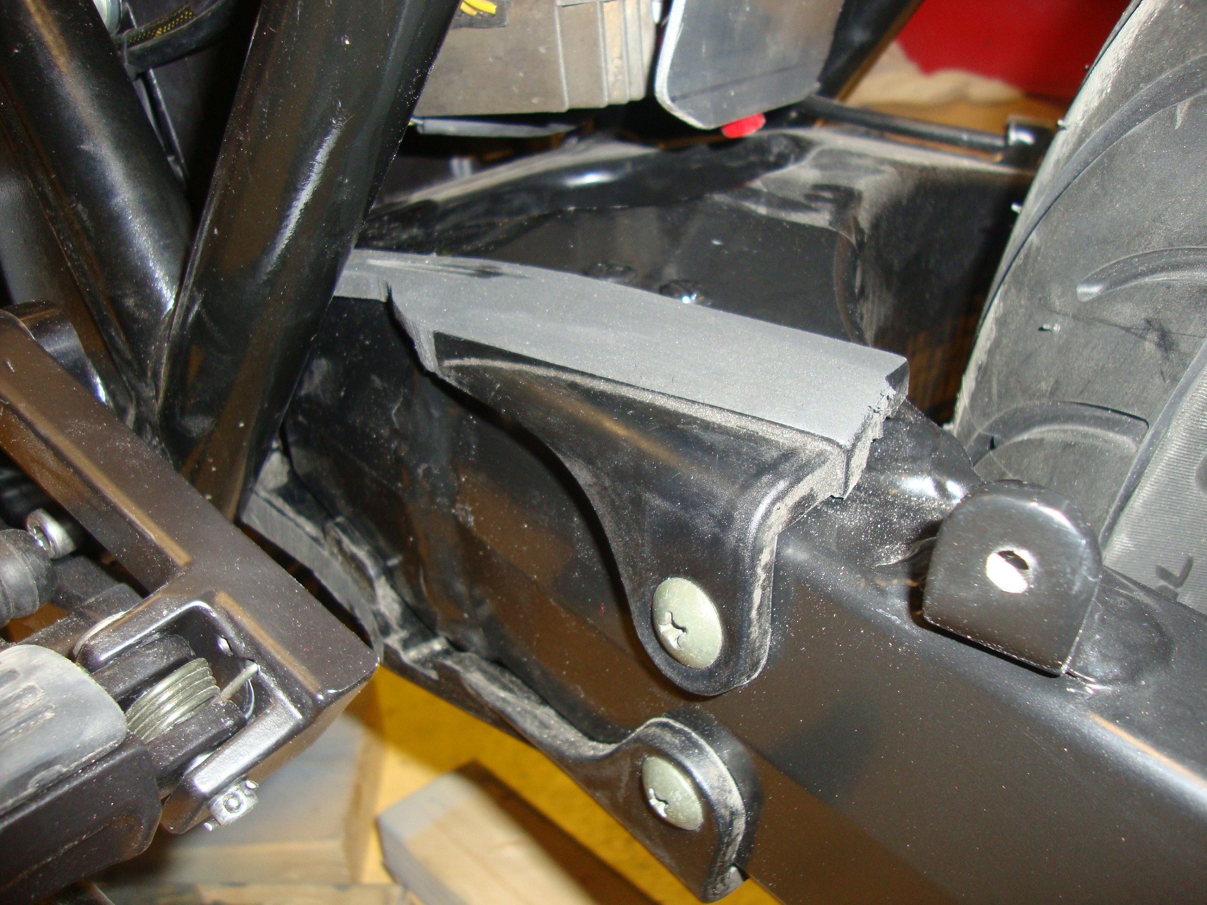

I also fitted the chain guide(?) Swingarm protector(?). I ground it down with a belt sander to make it as slim as possible. Ill use it for now until I get the swingarm situation sorted.

i just put my carbs together and also had some holes in my new gaskets where there was nothing in my carbs.
I think there is a difference between european and American carbs and that he gasket packege is universal.

Ok but any idea on those rubber rings/washers ? They arent regular o-rings as theyre flat with straight sides.The recess that they fit in has nothing in it,no hole,no channel,its not connecting anything.The float bowl gasket covers over the top of it.
I cant close up the carbs until these are sorted. The question is, Do I fork out more money and orderthese things or can I do without them?
Or could I make my own by trimming back some larger rings?How acurate would they need to be? I have NO IDEA as I have NO IDEA what they actually DO!!!!

I think you may have your carb bowls reversed from opposite sides based on the square housing facing you in the picture, maybe?
Check the brass tube that it goes into that tunnel area in the center of the bowl.
Good luck.

That looks like where the check valve for an accelerator pump would be if you had pumpers. I wonder if some po got some generic rebuild kits and just put them there not knowing why. I would totally be tempted to ditch them and be happy.
- Posts: 8403
Re: CSR1000 Project Build
09 Jan 2017 04:50
Ok, that was wrong. I looked at the thread about VM24 pumpers and see that the check valv is on the same side as the float valve. On the side in question, there is a large tube sticking down that your carbs do not have. I bet Mikuni used avfairly generic cast that could easily be modified for a variety of carbs, and what you see is the spot for that tube.
Again, I vote for tossing the seal, having a beer, and going on with life.

Ah TexasKZ. Just the sort of advise I need. In fact looking at the Official Kawasaki workshop manual,It does indeed say'Toss the seal,have a beer and go on with life'.I found it in the carburetor section.
Anyway,what you say makes sense,that its some sort of redundant part of the casting.That explains why theres nothing going to or from it. I did have a look at buying the washers and,for 4 of those useless little buggers it would cost euro3,50 each.Plus shipping,Plus tax comes to a grand total of euro27,23!!!!!!! I kid you not.
As I was on the way home from work,I had a McGyver moment and nipped in to one of my favourite shops.. euro 20,00 for a couple of punches.Now I can make hundreds of useless rubber washers. This time next year Ill be a millionaire!
