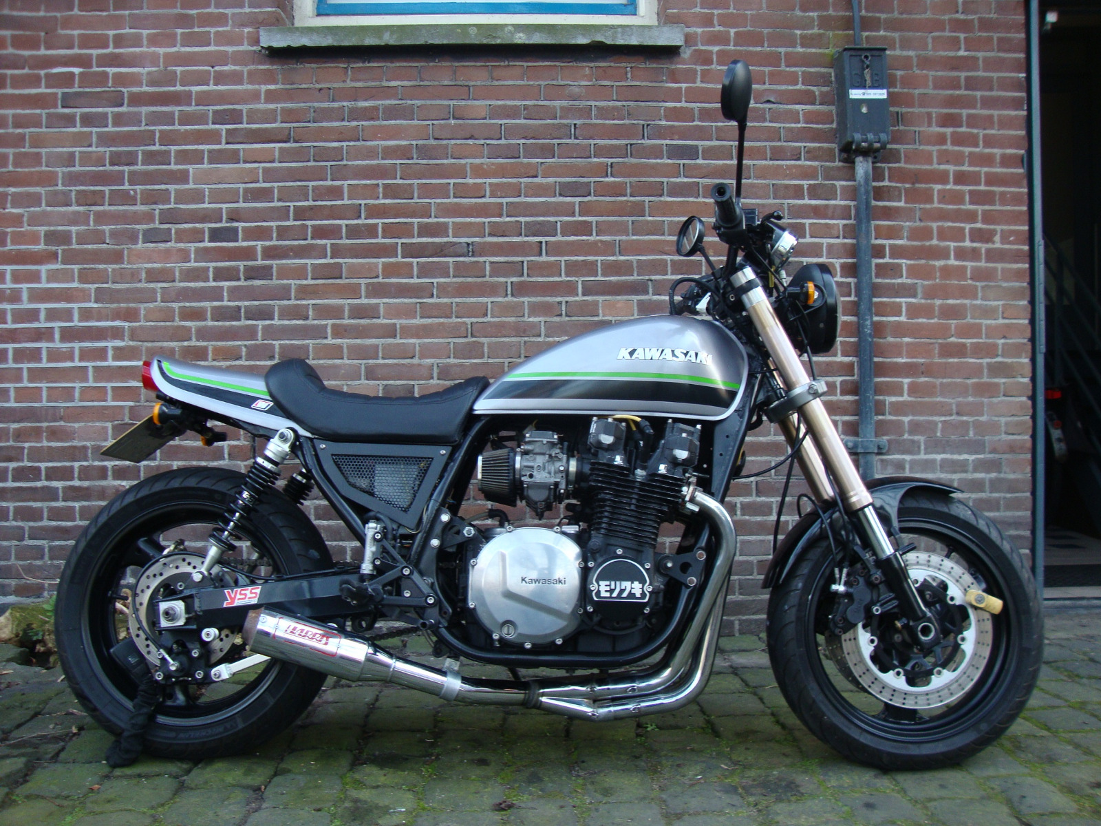

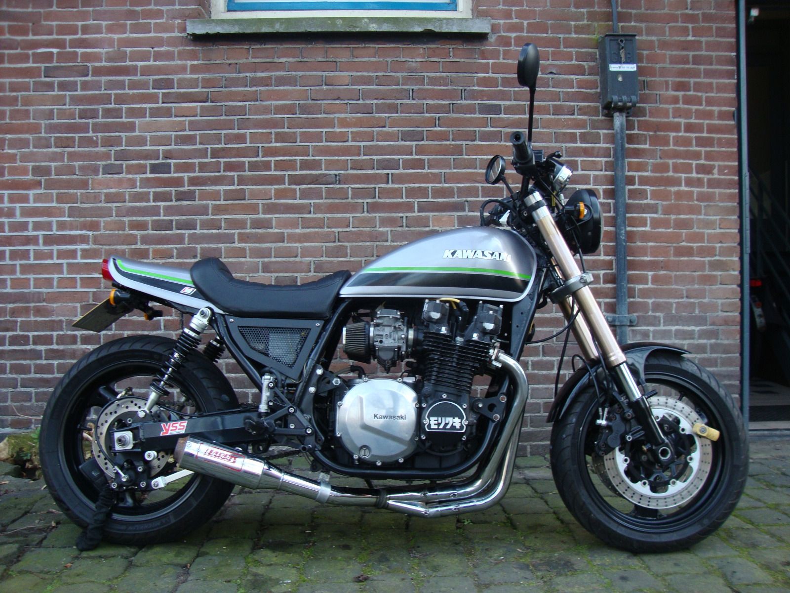

Spring seems to have sprung here in the lowlands. A cracking day today. I didnt put the bike in storage this winter,its just been sitting outside on the street, under an overhang on the building next door,so, out of the rain but exposed to everything else. Today was cleaning day ( #1) . A good scrub behind the ears. The worst affected was the exhaust. a second hand 1980s job that I got off ebay. The chrome was already a bit pitted and worn in places and the top of the down pipes where they fit into the head, have no chrome. The rust was really starting to blossom, so that got a good polish. It came up ok. Tomorrow,I want to pull the downpipes off and give them a good going over. I cant get at everything when its on the bike. The paint seems to be holding up really well ( My first attempt at painting) and a bit of Turtle wax brought that up lovely. Very happy with it. The powder coating on the wheels and swingarm looks good with no chips or bubbles.The engine is a real mess though. The engine cases are oxidizing and the PJ1 is knackered.Apart from the mess where fuel took it off, theres a small oil weep from the head ( I think) and thats taken more paint off. The rest has oxidation showing through. Itll be a repaint this summer im afraid.
Other than that,its not looking bad at all (especially for a bike thats sat outside all winter). A bit more cleaning tomorrow and that should be it sorted. Oh and it started up no problem.
