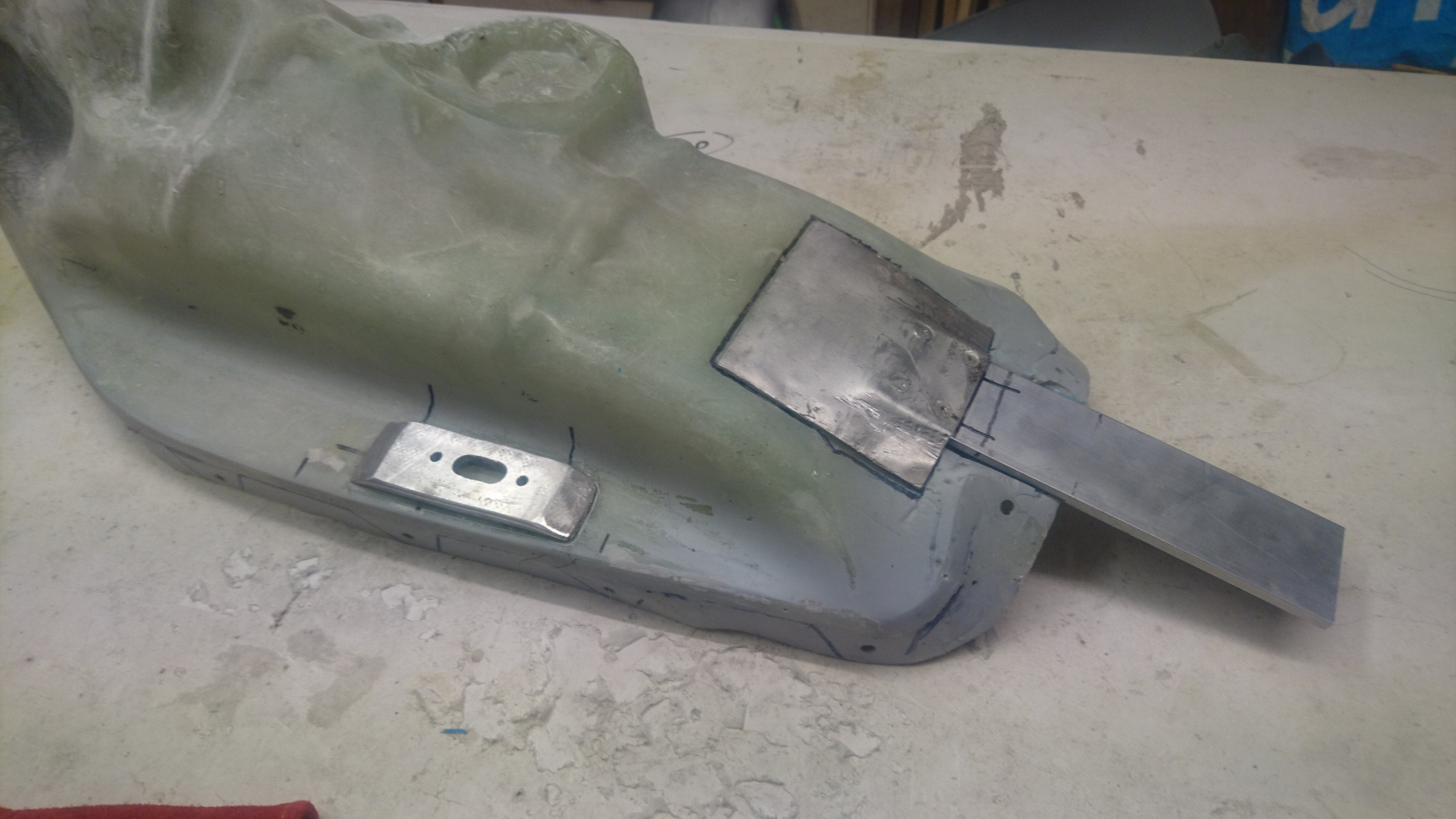

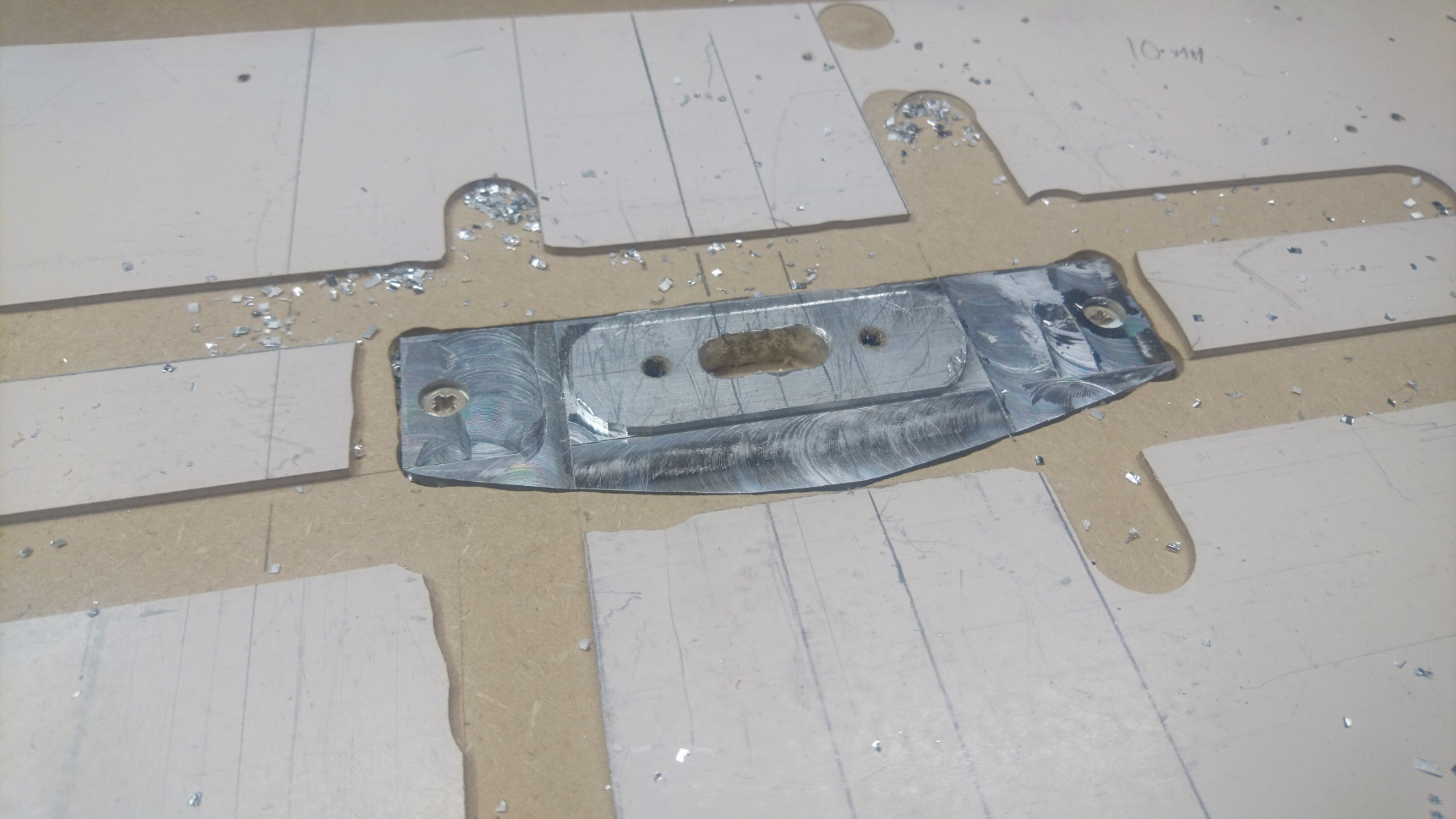

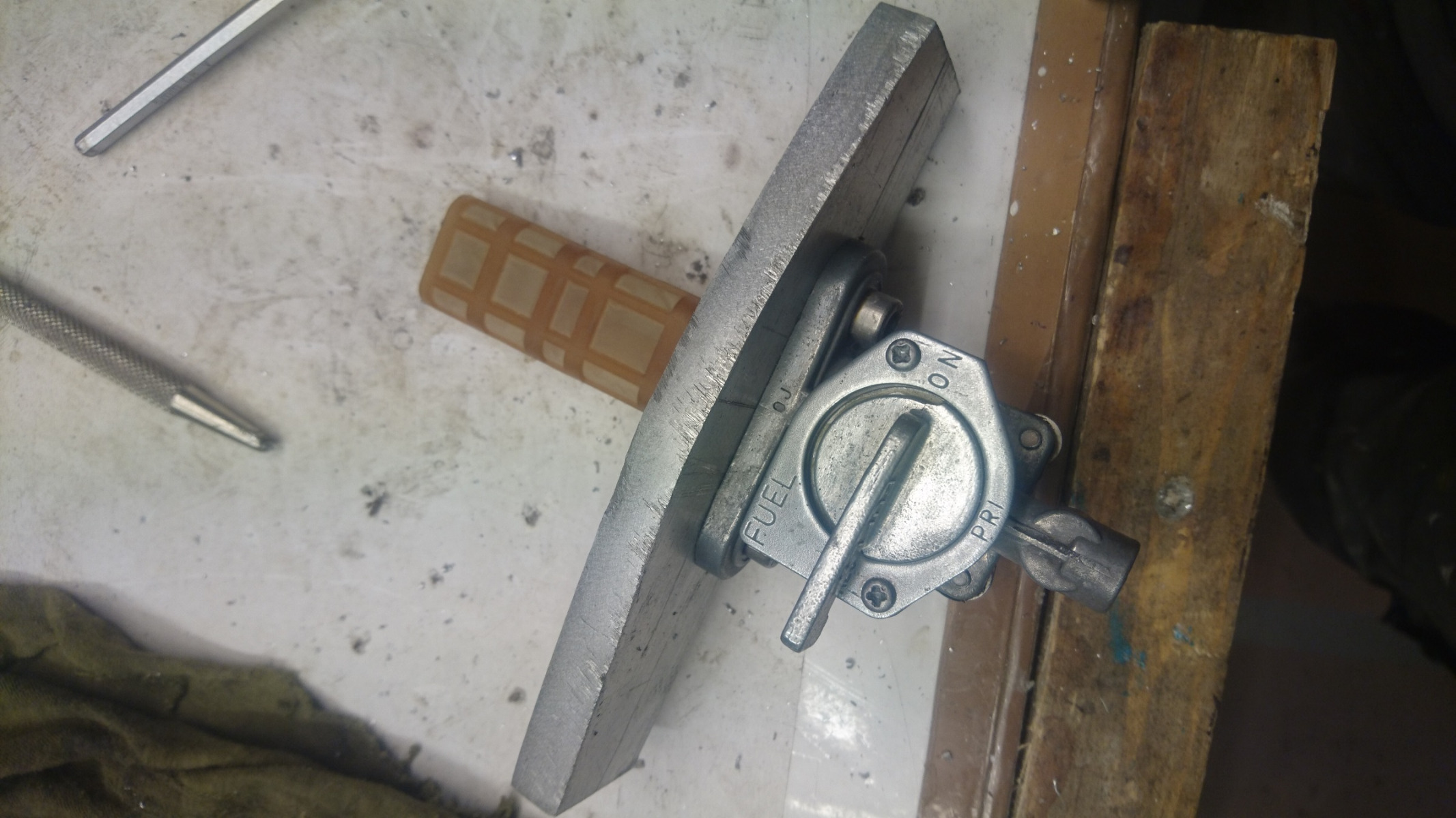

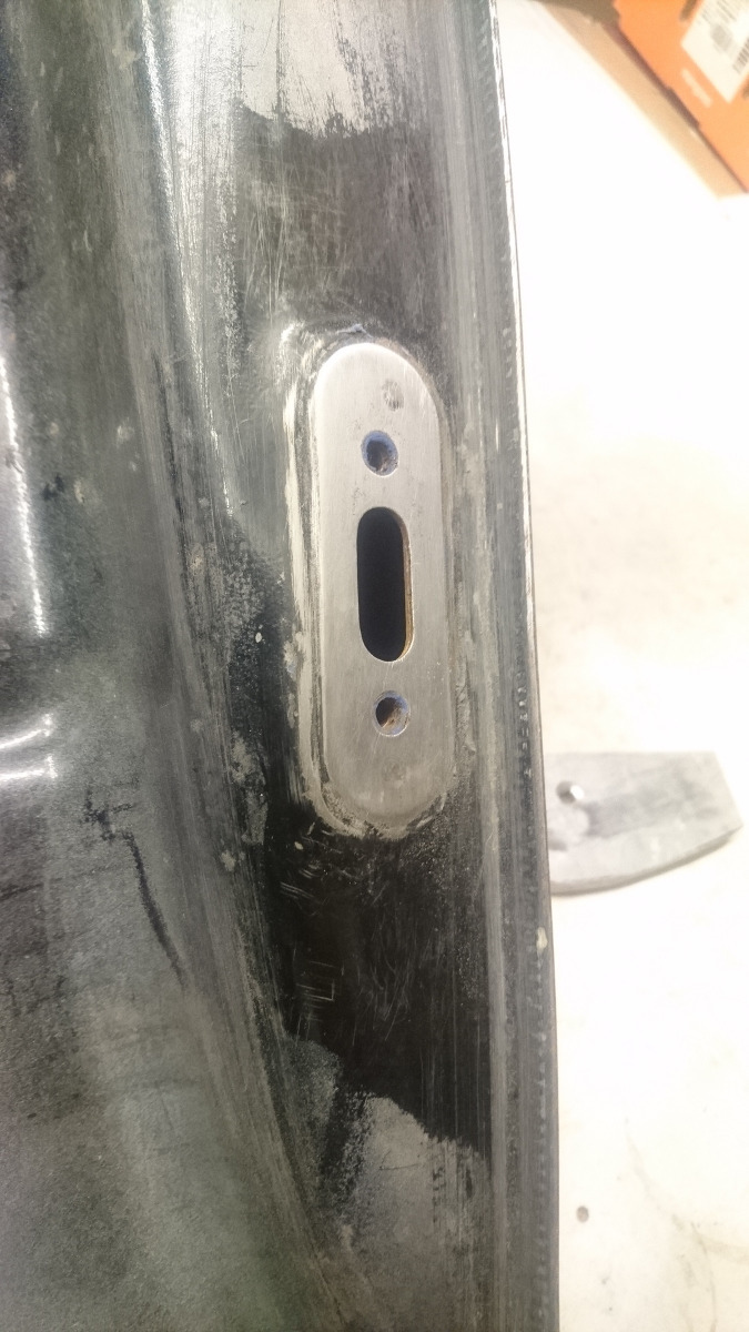

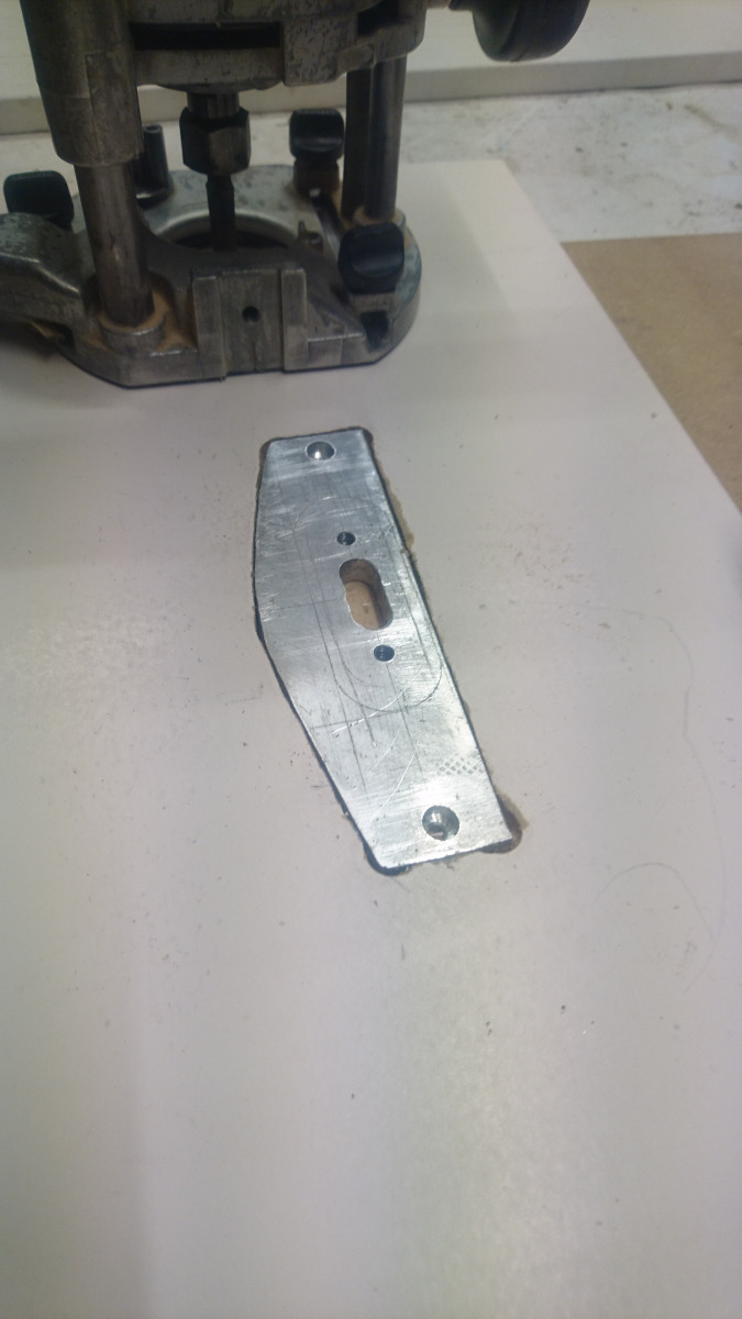

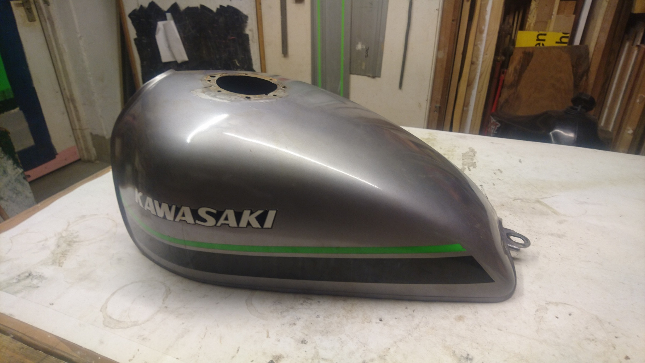

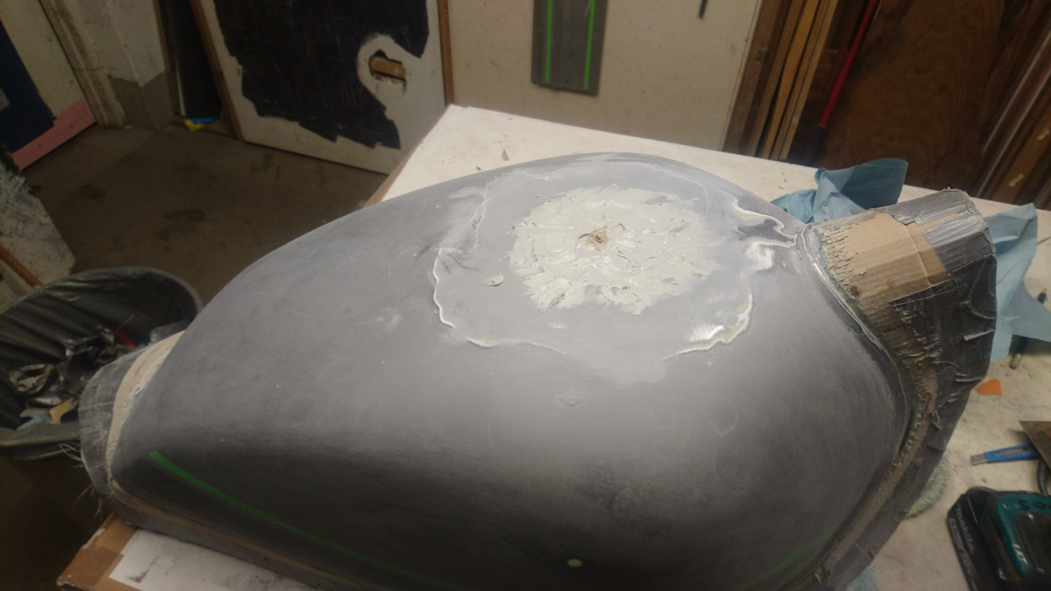

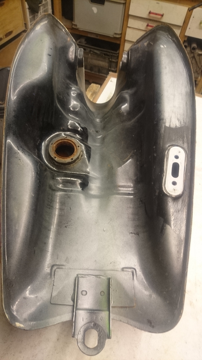

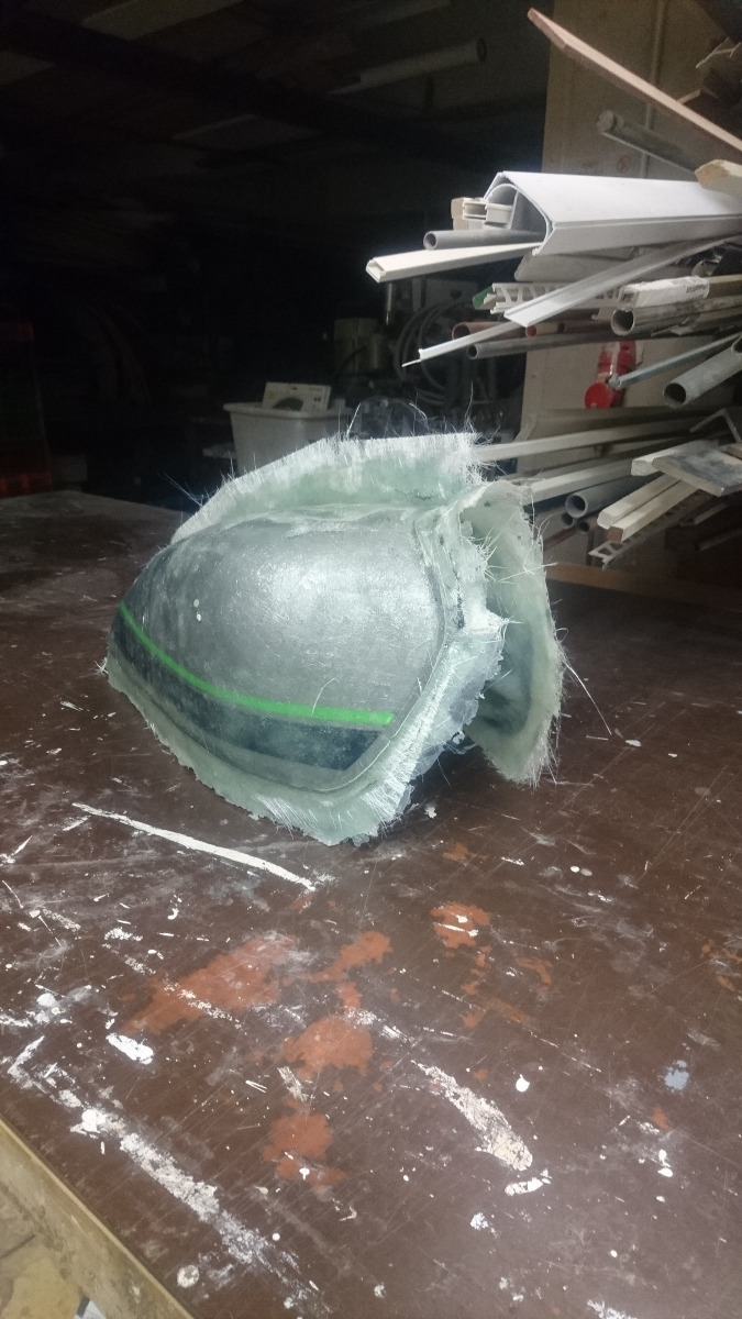

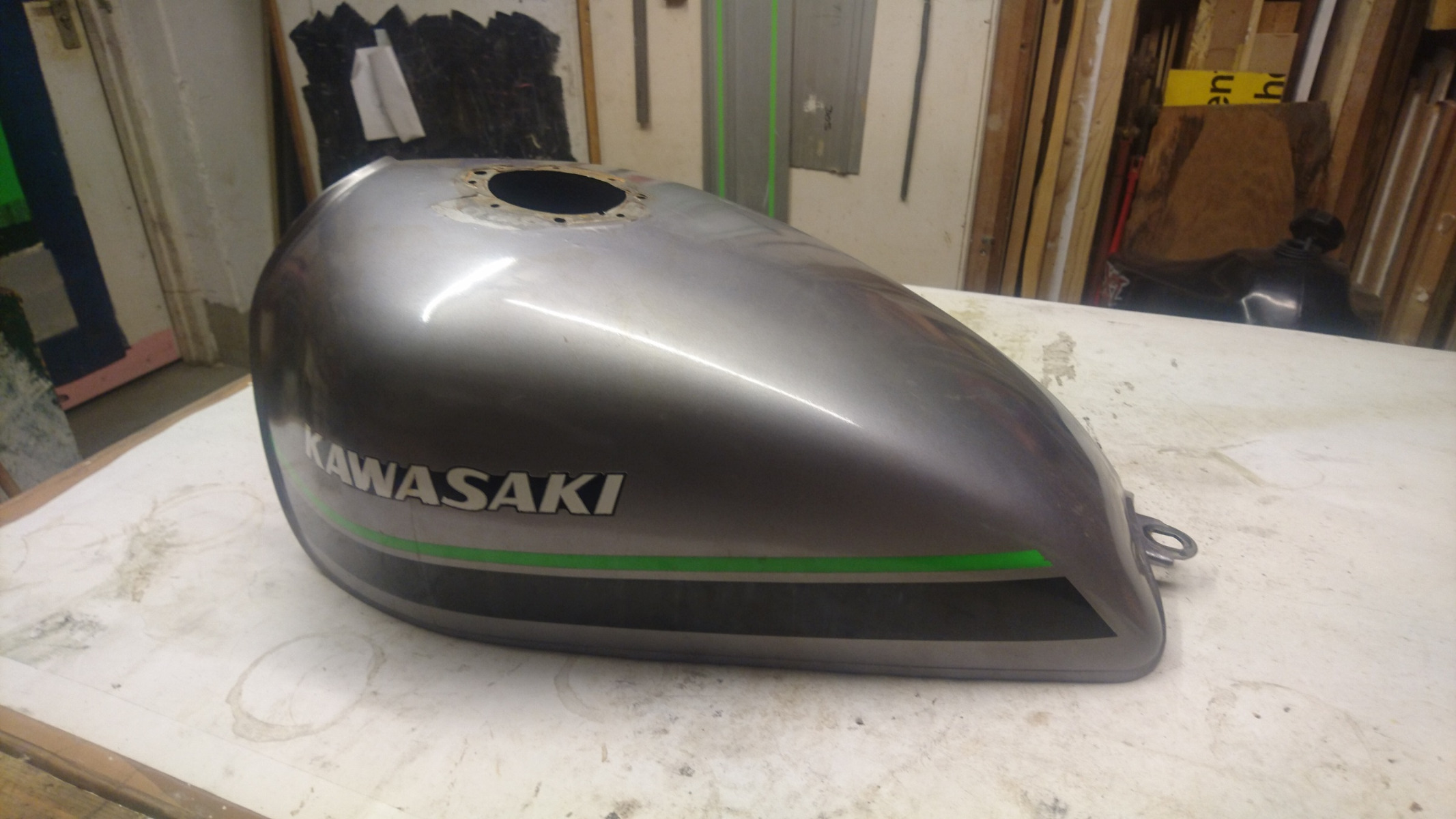

Ok. Thats something to think about.I might end up going the tank liner route in the end,though It will be the last resort. Ive been busy with another possible solution. I thought id have a go at making a new tank from Carbon Fiber!!!
No idea if its going to work but I don,t see why not. If it does work, no more rust in the fuel system. Eva Eva!
If not,I'm sure it'll be a mess.
I found an epoxy resin that is meant to be fuel resistant, heat resistant and with a high abrasion resistance,so that sounds like the stuff to use. The problem is that it mentions the heat resistance on the spec sheet,but I cant find anything about fuel resistance. I've emailed the company and I'm waiting for a reply.

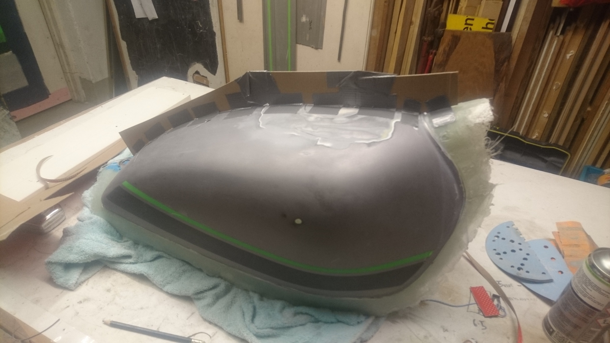

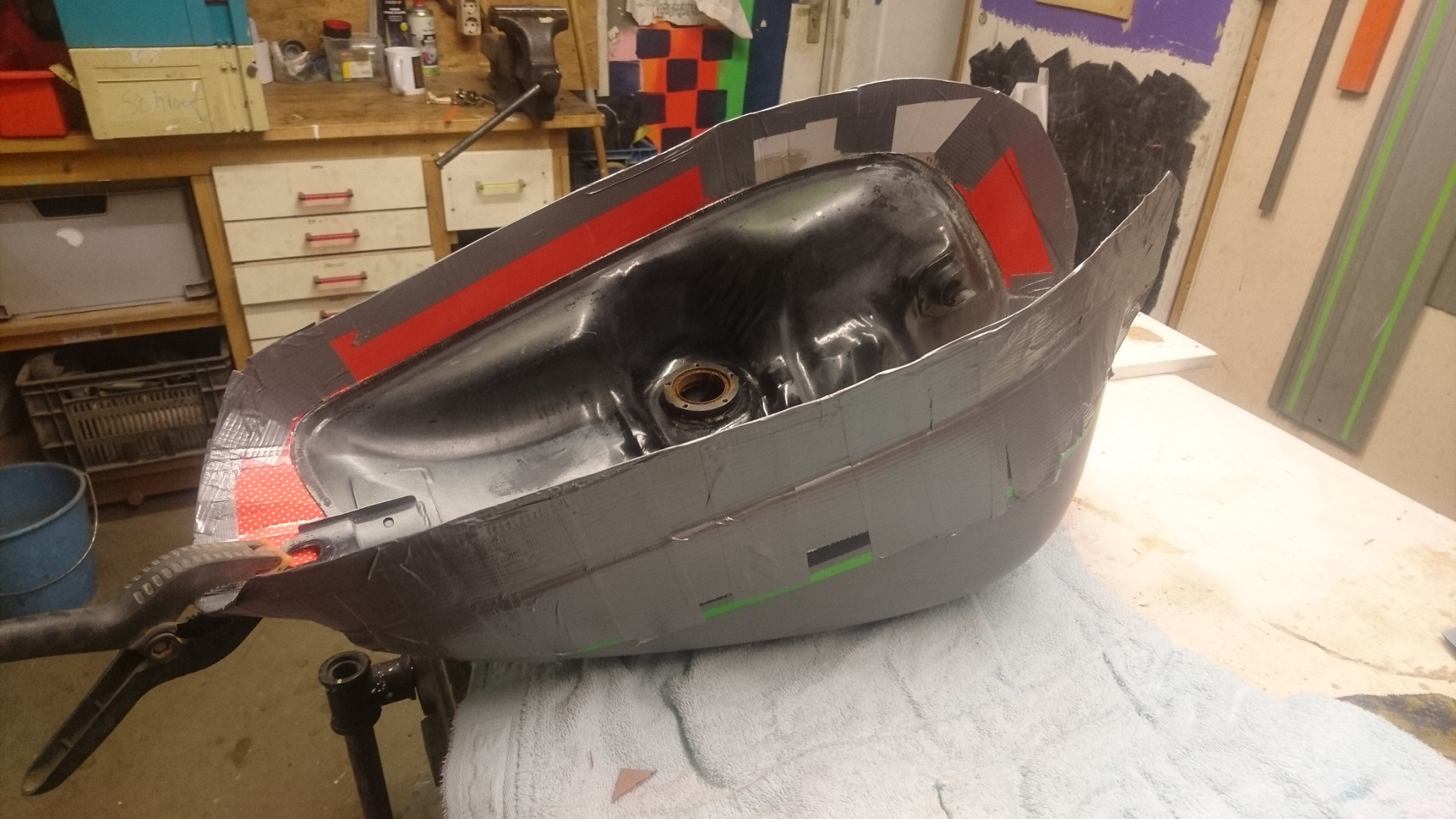

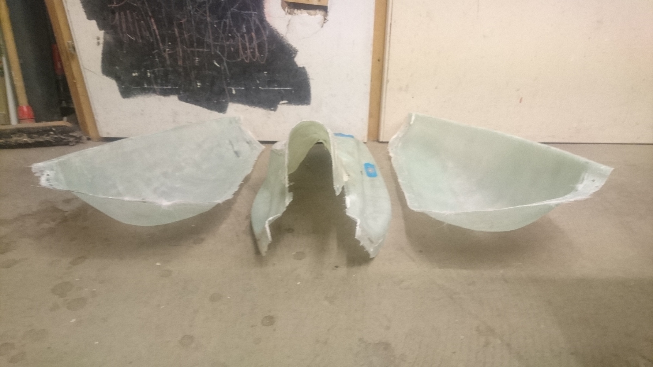

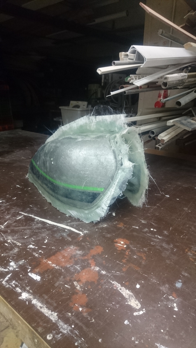

In the meantime,Ive been busy making a fiberglass mold of the tank and figuring out all the details Ill need to sort.
Its not as straight forward as it might seem. It is quite an awkward shape and there's all the hardware to think about. The rear mount the front mounts,the fuel tap and the filler cap.

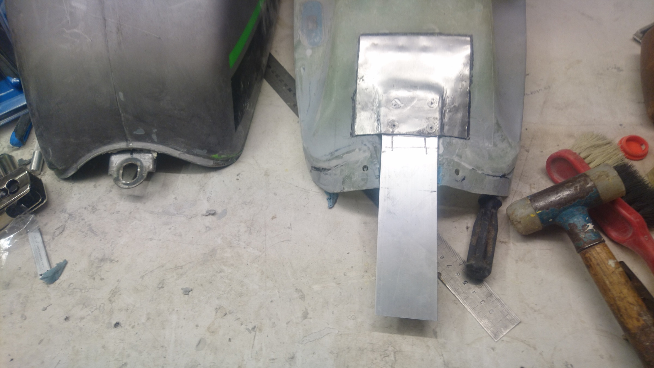

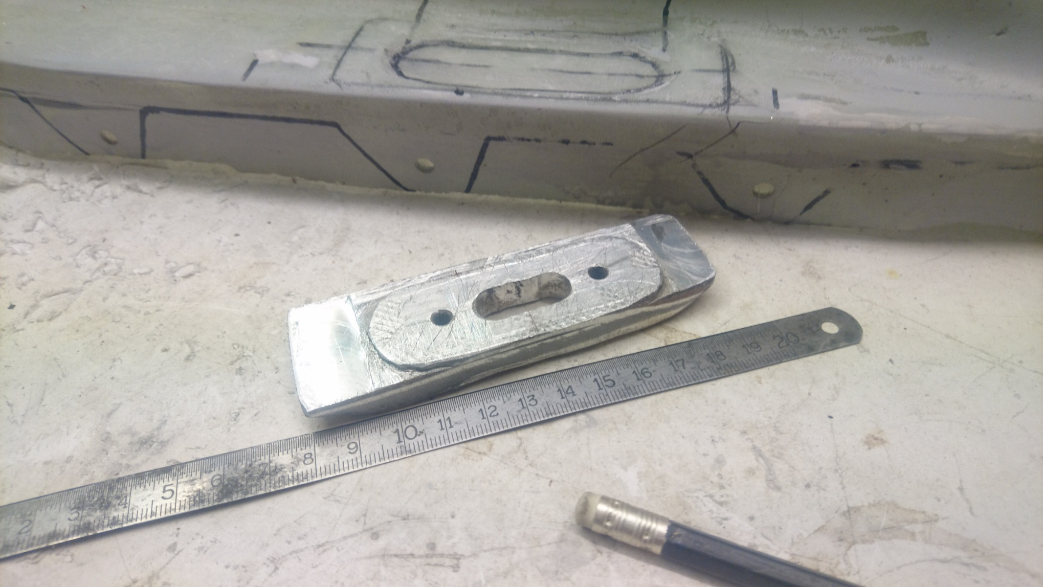

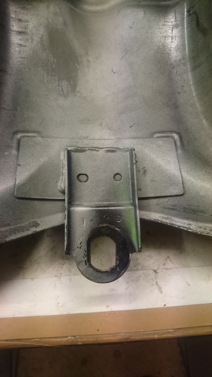

For the rear mount,I riveted a strip of 8mm alu onto a 2mm plate to spread the stress.I made a recess for it all in the mold but it will be fitted at the end when everything is together.

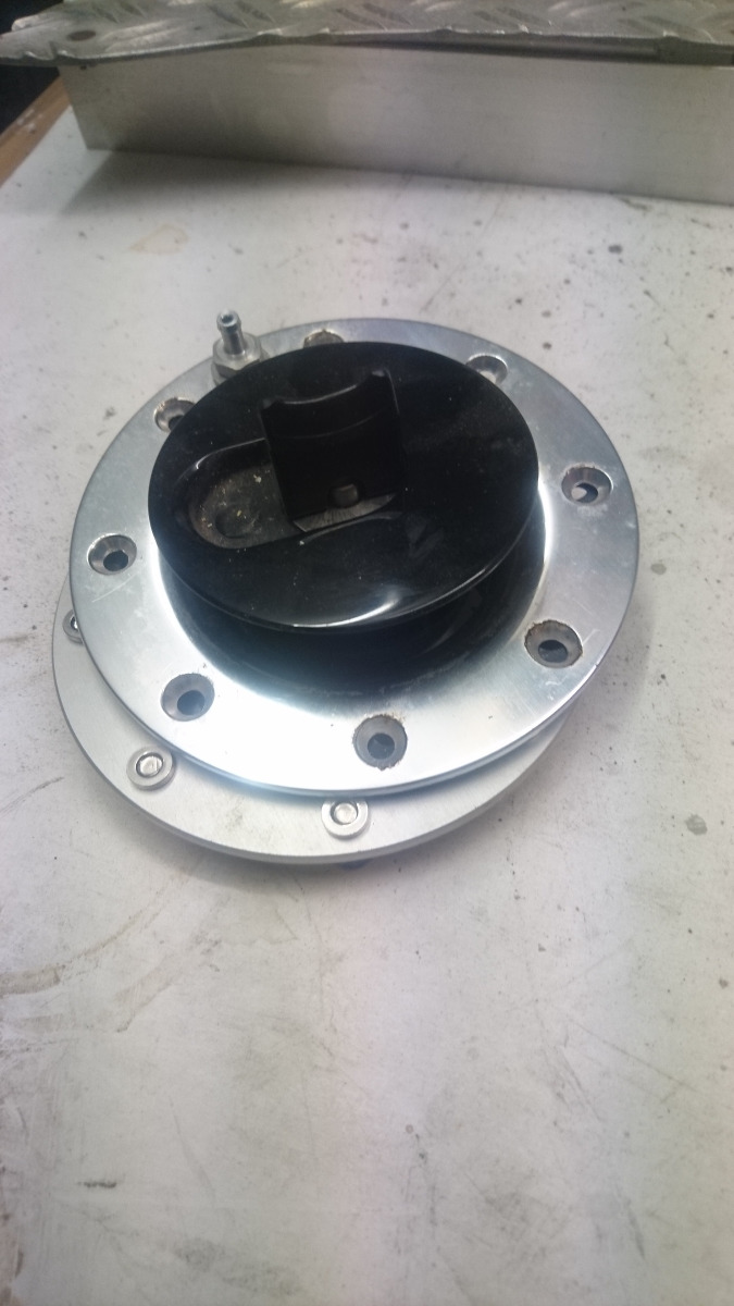

For the fuel tap, I drilled out another piece of 8mm (maybe 10mm) tapped the holes and routed it to fit nice and snug in the mold.
I'm still working on the fuel cap recess. Not figured it out quite yet. I've prepared the mold to accept the front tank to frame mounts but they wont be fitted until the bottom of the tank is cast.
The idea is to cast in two pieces the pretty much glue them together. Easy peasy.What could possibly go wrong?!

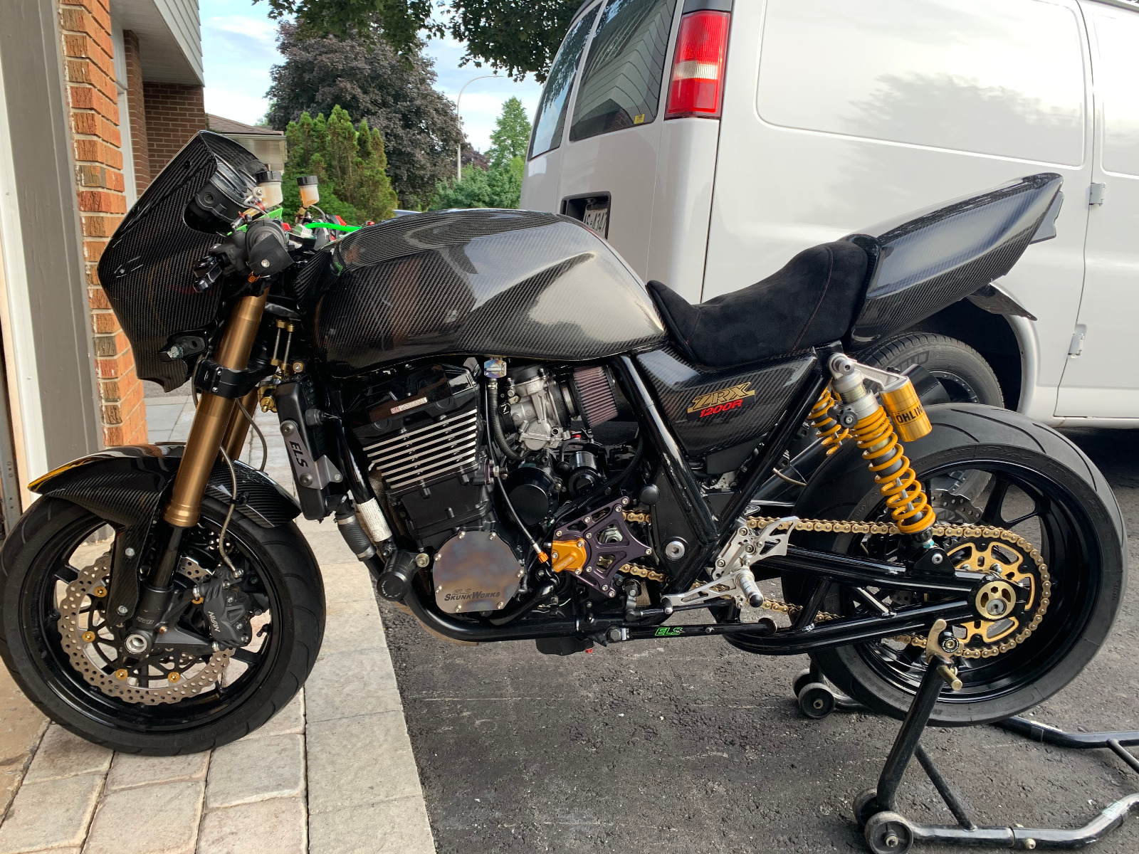

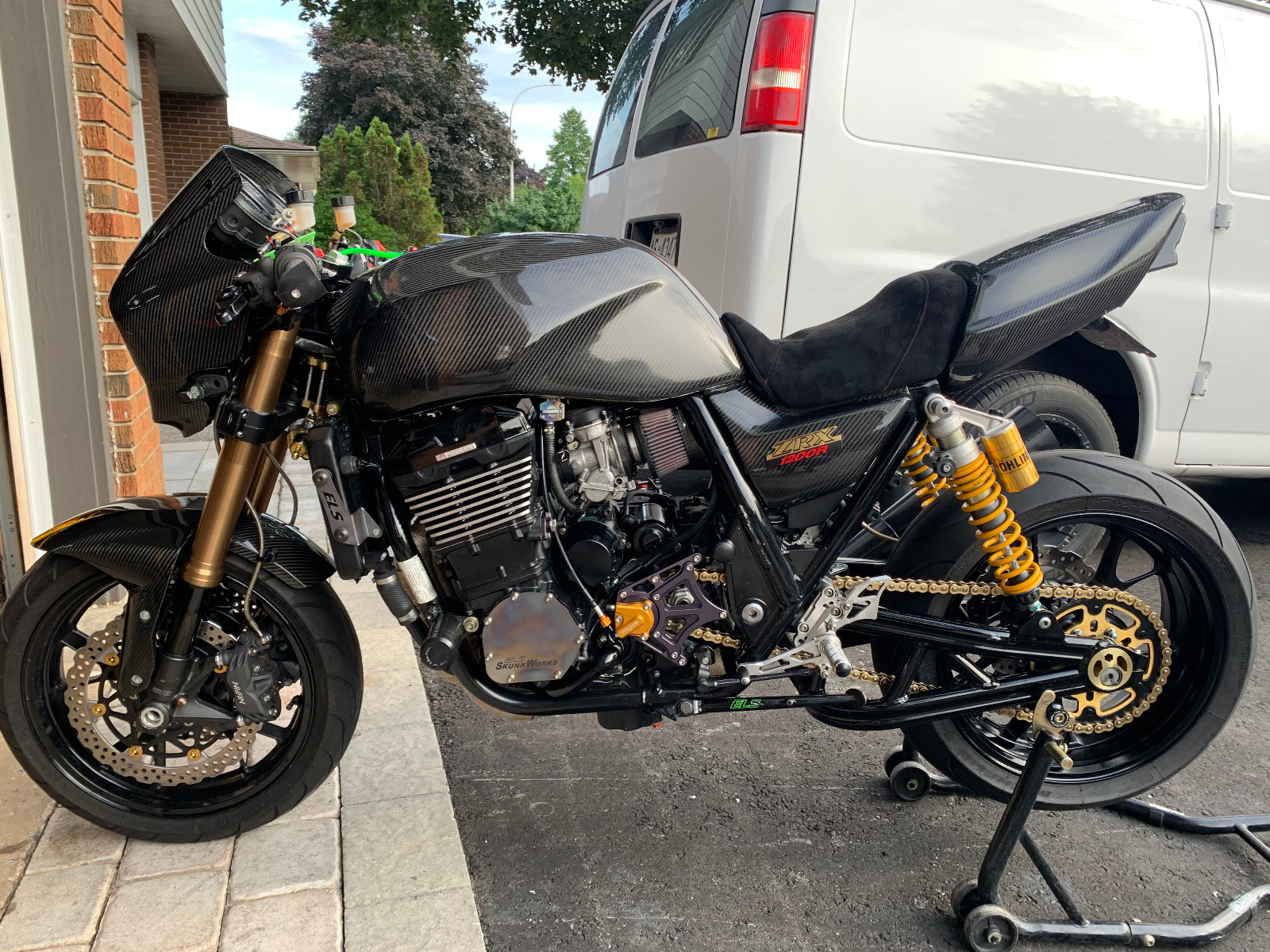

A guy over at ZRXOA made a carbon fiber tank. Carefully reading that thread may help you avoid some of the pitfalls he encountered.
The thread is titled, Carbon Fuel Tank Build. The user name is Peter.

05 Apr 2022 08:39A 'BIG' thanks for that, TexasKZ. A great link to a fantastic thread. Exactly what I needed.A guy over at ZRXOA made a carbon fiber tank. Carefully reading that thread may help you avoid some of the pitfalls he encountered.
Like I said earlier,I was waiting on a reply from the company that makes the resin I was recommended.(Smooth-on). They replied today saying that the product is NOT fuel resistant,they would not advise using it and they don't produce anything else that might work!!
I'm almost at the stage where my molds are finished, just some final sanding and cleaning up, then they're ready to go. So that was quite a blow,to be honest .I'm now questioning everything I've been told by my supplier.
Then I saw this post and sat down to read Peters thread.Lots of info and ideas.Even more,the fact that someone else has actually done this has given me a boost.I'm going to try and get in touch with this guy. I have lots of questions.
