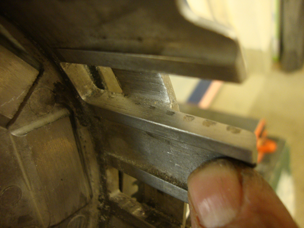

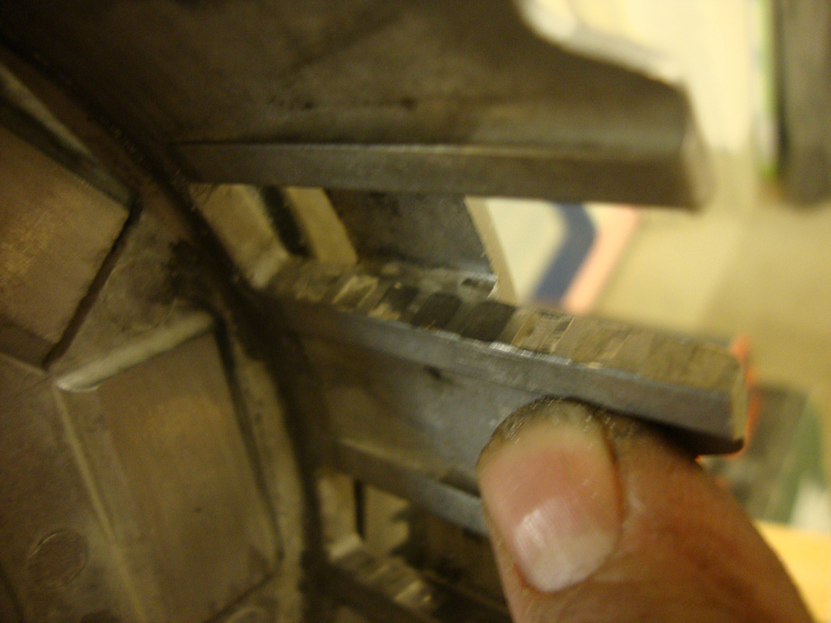

I had a go at filing down the grooves in the tabs on the basket;
Not sure how far to go with it. I dont want to take too much off.Any suggestions?

I think I paid 15 or 17 bucks for a EBC clutch holder tool on Ebay that works great ....... I wouldn't go to much farther on filing those grooves either might be getting too much slop already.

glad the rags and impact worked for you
you just want to get those grooves smoothed out that's it.

OK,grooves filed down (just enough,I think!) Inner basket replaced, new friction plates,new springs,new push rod,steel plates checked (all good) ,extra steel plate(!!!) discarded,and everything bathed in good qaulity oil.
