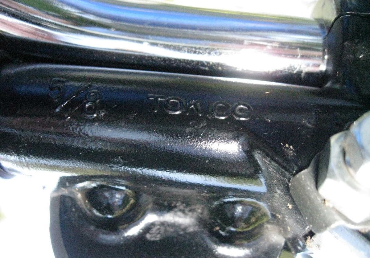

didn't see anyone answer your master cylinder question. 14mm is what you want for the dual disc front.

Ronin wrote: didn't see anyone answer your master cylinder question. 14mm is what you want for the dual disc front.
WRONG!!!!!!
The KZ bikes need a 5/8" bore master cylinder for dual front disk brakes! Ed

Its not a question between dual disk and single disk its the ratio between flow and amount of handle motion, with the 6 piston brakes you need to move more fluid with the same handle swing as before. I will just buy a master cylinder from the ZX7, removing the guess work. Still have to figure the disks out anyway, stock ones aren't going to work too well. Its going to be tough.
