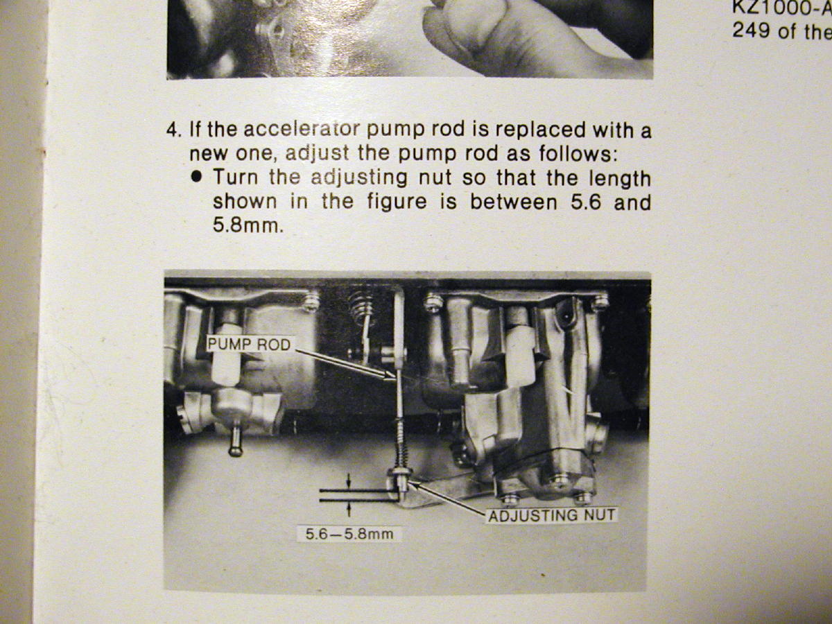

Looking good. Looks like your carb pump rod needs adjusting though.

11 Nov 2013 11:35sbc1320 wrote: Looking good. Looks like your carb pump rod needs adjusting though.
Do you know what I look for to adjust it?

12 Nov 2013 05:44peavylotus wrote:sbc1320 wrote: Looking good. Looks like your carb pump rod needs adjusting though.
Do you know what I look for to adjust it?[/quote
I just did a set and I left mine with about 3/8" thread showing like they were when I started on them.
I want to say I seen in my book that it supposed to have like 10 mm of thread showing which would be right there with the 3/8" I have on mine. I will look in my manual when I get home today.

12 Nov 2013 19:50The threads were a little buggered but a quick dying of the threads and checking with a caliper. The caliper looks a little short but I re adjusted the brass nut to be set back to 5.7mm after the picture
